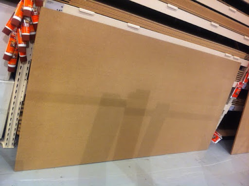

Got some sheets of 18mm mdf for starters ;)

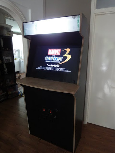

Re: Scratch Slim Marvel vs Capcom [Collecting Parts + Mockups]
« Reply #14 on: July 01, 2011, 09:55:05 am »

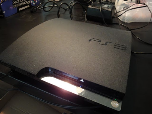

tested the screen and its great for its price, very happy with it.
Nice thing is that when i put on the main power switch of the cab the TV goes on and on hdmi video input, that is one less concern!
Game attract mode working
testfitted angle and height of screen
and cp height
All powerd by this beauty
I am happy now with the decision of the shape, and LCD placement angle and height.
I can start woodworking  :cheers:

« Reply #17 on: July 02, 2011, 04:10:28 am »
The attract mode seems to work!  :laugh2:
I really like that you've chosen a console instead of a computer. So much faster/better IMHO. How do you like the JLF's?

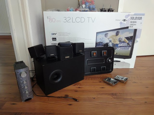

Yep, ps3 boots in 2 seconds, the tv turns itself on and setsitself on hdmi , so that part will be easy.
havent tried the JLF yet, but they feel good, still dubbing on going bal or bat top
Yes mame and other emulators run like a charm on the ps3, and some nice PSN games are available. And mvc3 on the ps3 itself  :cheers:
Still testing the speakers wondering for a 5.1 setup somehow or just put front left  + front rear together on one side and same for right. and maybe put the center in the middle..
Or i could do, in the speaker panel, front left, center , front right
and below the screen, rear left, rear right.
I got the speakers for almost nothing, thats why the strange 5.1 , otherwise i would buy a 2.1
The sound is pretty decent for this old audio system. and for 5.1 ps3 and psn games i could make things interesting.

i decided for the speakers now. 5.1 setup doesn't add much value, this set cant output stereo to all 5 channels.
And with this decision i can keep the LCD in its case, its brand new so keeping it as it is is great for warranty issues.

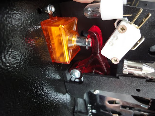

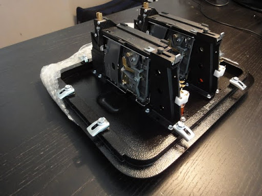

Got started on the coinbox, it took 0,25$ at first but now 0,50 euro :)
To do this just Fidel with all the screws a bit and at some point you get the idea and it drops correctly.
And i added 2 microswitches to the push to eject buttons, these will reprecent the select button of the ps3 controller
PUSH TO SELECT  :angel:

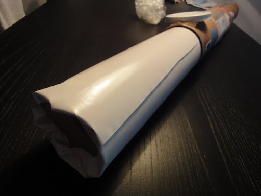

My laminate also came in, its high pressure laminate with mat nero black effect 0,9 mm thick.
Comes with protective plastic , ordered at www.klushandel.nl

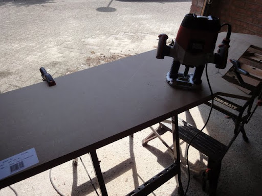

Time for my woodworking

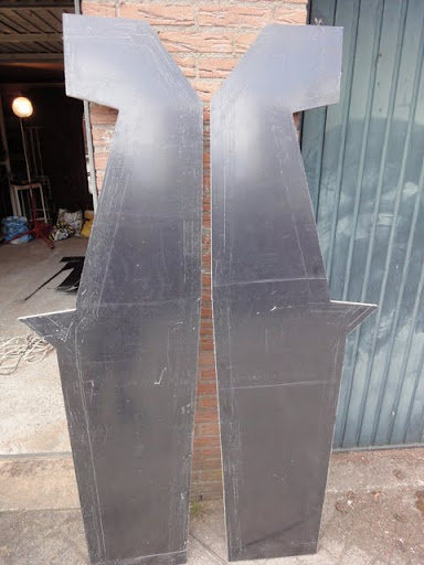

Here's my new spot to build this thing, not a balcony like lasttime but a almost empty garage
Finalised my drawing and it was time for my saw..
First cutting with my electric handsaw
Then using a router and some straight pieces of wood to get the lines smooth.
Remember, buy a lot of clamps, they are your best friend  :D
First side done
Place it on top of the otherside piece of mdf and follow the lines
Rough cut it
Then flush router it !
Snow time
Twin sides as a result for today

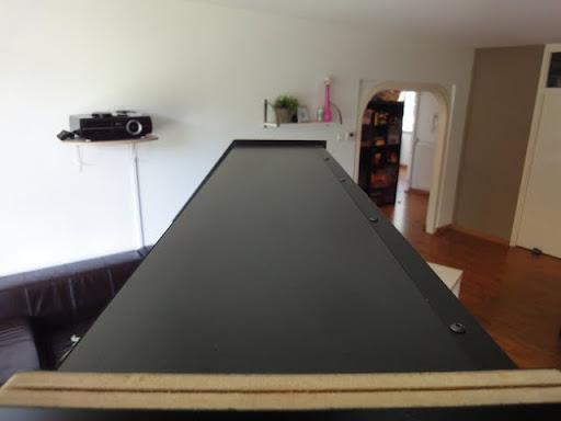

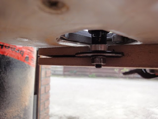

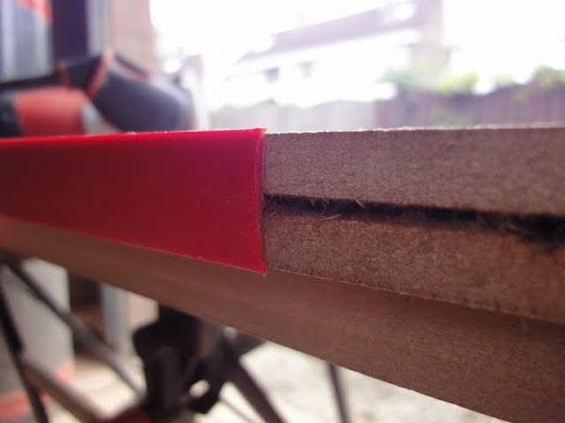

Today i made the t-molding slot.
First try the router at some scrap wood, to get the slot just right
18 mm mdf, + 0,09 mm laminate + 19 mm t-molding = flush
There we go
All done  :D
Then i made a third sidepanel as a template to router out space in the inside laminate as Woodshop Flunky did on his American Ace cabinet.

Interesting.  I've never seen laminate applied quite like that.   Did you cut the laminate to size before you used the flush trim bit?
First applied glue to both sides mdf and the laminate, then placed them on top.
then while its drying i cut it with a knife in the middle and then flush router it.

Today a lot of hard work and little progres..
i made the template for the laminate, measured a lot of times for the pine holders
Then router out the space on the inside laminated parts
It was really hard because i didnt have the correct bit, mine was to long for 18mm mdf template..

that routing was a pain, its dept for the pine wood was more then just laminate, also 2mm mfd, so dust everywhere.
my bit was to long to just scrap off the laminate..

Prepaired the lcd panel holes for the vesa mount and coinbox got drawn out to cut.

I have been able to get the cab standing today  :applaud:

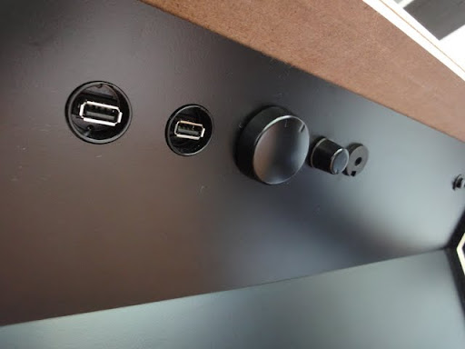

After i montaged the front coin box panel i added the volume control panel, it needed a trim , so i placed a mdf plate and made it flush with a router.
Flush
here some pics of the cab standing.
Thats it for today.  :cheers:

Re: Scratch Slim Marvel vs Capcom [11 July - Standing, Fat but slim]
« Reply #37 on: July 11, 2011, 06:10:34 am »
So, any chance of this falling over? It's very slim. Looking forward to more updates.  :cheers:

  • Posts: 822
  • Akira!
    • ModMyBox
« Reply #38 on: July 11, 2011, 06:22:20 am »
Till now it feels really solid, and the subwoofer and lcd will make it even more heavy. Lastly its against a wall.

p.s. To get back at the if its stable enough so it wont fall point. The cab is really heavy now with these 32" wide panels.
bottom back plate is killer
Time to finish the wheel construction soon.

Picked up my new speaker set. Logitech Z-2300, i had the same set in my old cabinet. And it sounded super.
The dtt3500 will be shelved for a while  ::)

I also recieved some plexi samples. i think i will go with this one
Gray, 49% Transmission, transparent, UV absorbent, high-gloss surface, 3 mm
http://www.plexiglas-shop.com/NL/en/plexiglas-gs-allround-4aql41br8z4/plexiglas-gs-allround-grey-7c14-gt-dic33ry3pgp~p.html
its strong and very good quality, darkness seems ok to me when i hold it up to my monitor.
Also i been lurking around the ps3 and 360 area. I know its not the right way, but the ps3 scene releases of psn arcade games arent comming out because of the new key encryption.
And for now people can hack games into working on 3.55 firmware, but this will bleed to death i think..
A xbox 360 jtaged one has all the advantages, all the arcade remakes, and full mame (ps3 handles only 60% at the moment, no donkey kong for example)
then there is the point i wanted to include a ps3 webcam behind the plexi for move games, especially shooters like the shoot or time crisis series.
also i have the ps3 and joysticks, but no jtaged 360 (got one here but not working yet, some solder via's are broken off to dump the nand).

And started on the Sound, I/O panel
Made a small opening with this bit
And used the router to cut out the rest
Routerd out more space
Then you get this effect

Also I fitted the plexi for the marquee this weekend and finished the bezel.
Marquee 2 x 3mm plexi highly transparent (Clear: 92 % light transmission), UV absorbent, high-gloss surface, break-resistant
Alluminum h shaped holder and some metal glue
Holder shape , it has 8mm space for the 3mm mdf + 1mm laminate + 3mm plexi  :cheers:
bezel
bezel + plexi + holder
Fits perfect  :applaud: Still has protective plastic on it, ill remove it when its in my home

Sound i/o panel is done, it will be placed below the cp and its angled
Also i made this lpt cable to connect the i/o to the cp
For the i/o panel i first cut the panel to size and laminated it
Then routerd out the laminate and made holes for the panel
Then started to make the cables for the street fighter fight pad, i extended the switch for analog to digital switch (pad,L-stick,R-stick)
And the turbo button and led
Finished
2 x usb, volume and bass control and headphone socket
Led and push button to enable turbo for any action button in 3 different speeds (hold turbo and tap disired action button 1 2 or 3 times ) hold turbo + action button to disable
The led will show if its on or off
And switch (3way) to switch between arrowpad, left stick and right stick
backside
Lpt socket goes to cp

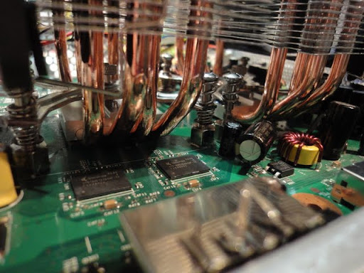

Found myself a nice jtaggable console  :applaud: These things are hard to find in good shape.
This xbox has only run for 5 hours from the previous owner. Its a old xenon type xbox 360, so it doenst have HDMI, but i still have from my old xbox a kick ass quality Monster Xbox 360 Component cable
It came only with optical , so i soldered stereo pluggs to the mainboard.
Then i also soldered
-The nand-x controller for jtag
-12 volt for large 3.5 inch hdd compatabilty
-removed the risistor microsoft uses to disable jtag with an update
-extended powercable for the dvd drive
-added some fans
The xbox is running fine now and i am installing and trying all sorts of software.
Also did some stress testing with all the extra fans, its keeping it cool (dont want a rrod)
Replaced main fan with this
Additional fans (added some resistors to them to keep them silent)
Extended power, sata, hdd and audio connecor
2TB hdd, way overkill i know. but they are so cheap atm, its 5400 rpm low power consumption and silent
This hdd had some known error with possible data missing, there was a firmware update for it. Make sure if you get one you check it before using.
I also tested the speakers for the stereo sound, it produced a hum and little buzzing. Good thing i tried this first before mouting it into the cabinet. I rewired some GROUND wires and its gone now  :applaud:

Finalised the woodworking for the most part.
Things left to do
- artwork
- wiring
- installing all components
and the whole control panel still left to do. But i decided on the design and now i can make artwork for it.
Installed 2 noctua fans for airflow
And brought the cabinet inside and cleaned it. Picture flood :applaud:
note : switch looks like its not straight, but it is  ;D
Next to wire it all up and finishing the artwork, then work on the cp

Xenon xbox 360 heat problem solved  :applaud:
Bought 2 x Cooler Master Hyper 212 Plus
I wont recommend this to anyone, the CPU coolers i bought didn't fit at all, the xclam system that came along with it was to big , had to cut all the legs by 1 cm
Then drill new holes in the clamps, also needed to remove more metal from the clamps so it would fit at many places.
Then extended some Capacitors that were in the way of the heatpipes of the coolblock
Added arctic silver as CPU/gpu past instead of the what came with the CPU cooler.
With my old cooling setup i was getting 65-75 degrees in the cab
First i tried 12 volt, that was really cool, CPU and gpu didn't get above 35 degrees loaded
but the sound was terrible lol, like a vacuum cleaner
Then tried 5 volt, that was giving me CPU at 55 degrees and gpu at 42 degrees
Finally settled with 8 volt, giving CPU 48 and gpu at 35 degrees
Well i am happy with the result.

That's not a slim 360.  :laugh2: Nice work.

Hey awesome build sofar. Where did u get the ports for the usbs and the power cord port in the back bc I wanna do the same.
Martijn
  • Posts: 822
  • Akira!
    • ModMyBox
Re: Scratch Slim Marvel vs Capcom [5 Sep - A Sign Of life]
« Reply #111 on: September 06, 2011, 02:30:26 am »
The power socket is something i just got from an electronic store, or you can buy them online from www.arcadeshop.de in europe.
The usb and headphone are http://www.neutrik.com/uk/en/dataconnectors/204_1047652869/USB_productlist.aspx

Aqualyricist:  I got a computer power port from a dead lcd tv, worked great.  Can usually find a dead monitor, tv, or power supply to recycle one of those from.  Will not have the fusing or rocker switch that Martijn installed of course.

@TopJimmyCooks Thanks. Good idea. I just recycled 1 off a psu and soldered it to the smart strip.
@Martjin thanks for the usb info. I found a dealer here in the US w/ free shipping for $6.00/ea

Recieved a new volume pot for the creative speaker set, i bought the set second hand and the main pot could turn and turn, and some volume balance problems. Gonna replace it this weekend.
Drilling template, i went with the generic version of the Vewlix shifted layout. Got it from http://www.slagcoin.com/joystick/layout.html
Why did i choose this design, well i placed my fingers on the cabinet and printed some layouts, this one felt best for my use.
Ready for drilling
I have to note, i bought the Sanwa JLF sticks from arcadeshop.de and used their mounting plate details http://www.arcadeshop.de/images/specs/arcade-jlftp8yt-mounting.gif
Its not correct
The size is correct
but the drilling holes arent
Just have to make sure i dont make a mistake here.

Not much of an update but i wanted faster dedicated network connection on my cab , plus the xbox has xlink for online play and i needed  faster ftp transfer.
Got a cheap chrome utp connector
Painted it black
And installed it on the backside near the power socket

« Reply #141 on: October 09, 2011, 11:47:26 pm »
I debating doing something similar to what you did to route out the inside laminate.  I'm just having a little trouble visualizing exactly what I need to do.  What type of bit did you use?
I'm thinking I need something like this -
http://www.rockler.com/product.cfm?page=25160
Yes thats the correct bit, you dont really need to make the template perfect, make the gaps a bit wider so you have some working space.
Or just dump the whole idea of removing the laminate, and just glue pine holders with screw from outside to inside (and inside to outside if you want), if you gonna laminate the outside it wont show a mark..

OP, where did you get the RJ-45, USB and power connectors? Those really make your cab look professional and I want to do something similar.

Finnaly completed my cabinet. Here are the pictures. Pictures where taken with a Nikon D3000, i have to say the pictures came out a little to bright  :dunno
I would like to thank Scott from gameongrafix.com for his excellent support.  :cheers:
Cabinet is 99% done (there is no 100% in cabinets  ;) ) just waiting for the xbopx 360 scene to come up with new mame and fbanext

It's looking amazing. The artwork and overall look looks way better than any factory produced arcade cabinet (wood) that I've seen. The JLF's looks like they aren't properly mounted though.
Sanwa
Joystick mounting height: 23mm-24mm between the bottom of the ball top and the top of the control panel (reference: Paik)
Joystick top panel hole: 24mm diameter circle (plus or minus a few millimeters will work too)
Standard button hole: 30mm diameter circle
Small button hole: 24mm diameter circle
Snap-in button depth (standard and small): 2mm-4mm panel thickness

Thanks you all, could you explain this Emphatic? I mounted the plates as high as possible with flush screws
  • Posts: 2019
Re: Scratch Slim Marvel vs Capcom [14 Nov - Finished]
« Reply #154 on: November 14, 2011, 12:18:33 pm »
The shafts are about 1-2 cm taller (from plexi surface to balltop) than they're supposed to be. Hard to say exactly from your pics.
Some proper height examples:

Ah thats no problem, short just looks silly to me on a cab, maybe on a fightstick
  • Last login:Today at 04:34:18 pm
« Reply #156 on: November 14, 2011, 02:58:25 pm »
Lookin' fresh!  :applaud:
I do agree that the joys look a bit too high. Take a look at any of the candy cabinets, or Vewlix control panels. You'll notice Emph's height example is the same. There should be enough space for two fingers right under the balltop, while holding it with your thumb, index, and middle fingers in a comfortable rest position while the side of your hand is resting on the CP surface (that is, without straining upwards to hold the balltop).
It might be too late to change it, but if you're happy with it, then all-the-power-to-ya. Maybe you have big paws though...  ;)
Yes, it's all about the comfort really. For longer sessions, I think this can actually do damage to your wrists.

Yes a video will come soon, before the weekend i think
here are some shots

(...)Mounted the JLF plates(...)
I was wondering about this way of mounting the brackets.
Does it not create a gap that is only covered by the cp overlay, that someone could poke a finger through by accident?
/nano (...and yes I've started my build again, how is your new box coming along? ;))
Use plexiglass over the top of the control panel.
Martijn
  • Posts: 822
  • Akira!
    • ModMyBox
« Reply #224 on: April 10, 2017, 02:25:33 pm »
the top is covered with laminate, nd the cp art. Good to see you back

Hi
You should consider using 16mm MDF instead and a 7mm laminate as well
11/16" T-Molding (17.46mm) will fit. You also need to take the artwork thickness into account when routering the the slot, as this will add the the over all thickness as well.
Hi Martijn,
You have laminated both sides of the side panels, I wanted to do this as well with 0,9 mm HPL you used but the 19mm T-molding doesn't flush entirely ( 18mm MDF + 2 x 0,9 mm = 19,8 mm ) , so 0,4 mm sticks out on both sides. How does this look on your Cab ?
And where did you get the perforated plate for the backside panel ?
I'm making a combination of your curved Streetfighter cab and the slim Marvel vs Capcom, work is still in progress I'll make a new Project Anouncement soon with photo's.
