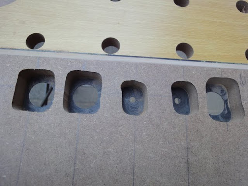

I really like how you trimmed the volume control panel with you router.  :applaud:  I wouldn't have thought of doing it that way right off.  I'd have struggled with my tablesaw for a while for sure.
Nice job! :)
Sjaak
  • Posts: 706
After i montaged the front coin box panel i added the volume control panel, it needed a trim , so i placed a mdf plate and made it flush with a router.
What kind of router bit did you use to do this?

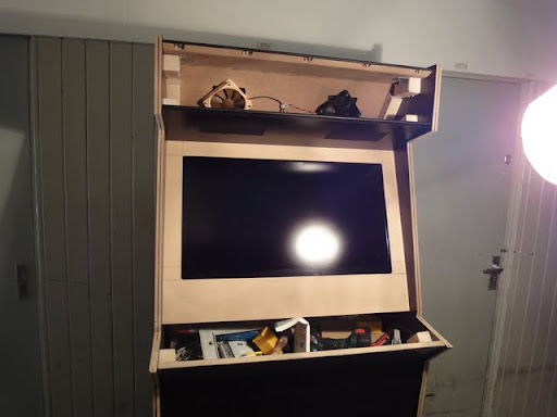

Little update  :)
I testfitted the lcd and it fitted just as i hoped  :applaud:

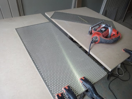

And i finished creating the airvent and speaker holes and grill.
Air vent hole
And speaker grill

That metal mesh stuff you used looks nice.  Anyone have any idea where to get this in US/Canada?  I have looked at local hardware stores but nothing has turned up.
SNAAKE
  • Trade Count: (+29)
  • Posts: 3583
Re: Scratch Slim Marvel vs Capcom [11 July - Standing, Fat but slim]
« Reply #47 on: July 15, 2011, 01:17:45 pm »
ebay. search "metal grill arcade" or something. I bought some while back.

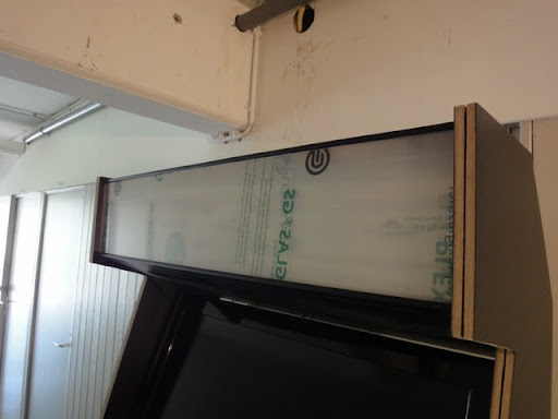

And i installed 2 silent fans for the air grill

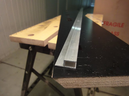

Next i worked on the marquee holder top piece.
I measured 6mm plexi gap
Routered out some laminate
made holes on 5 places, i drilled through the mdf and marquee holder
Then add these suckers
I glued them, there was no room to hammer them in ,i was scared it would crack the mdf or laminate
After a few minutes i removed the screws cause maybe the screws would be glued to
And you get this as a result
End shot for today

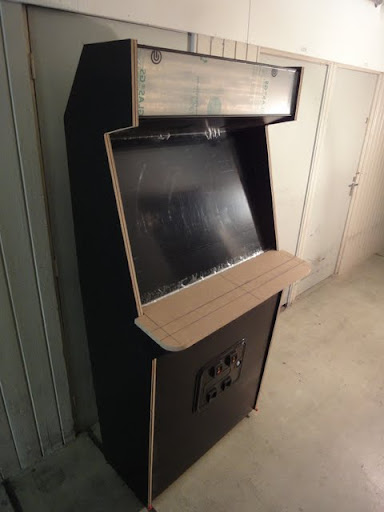

Thanks and here some more i did today.

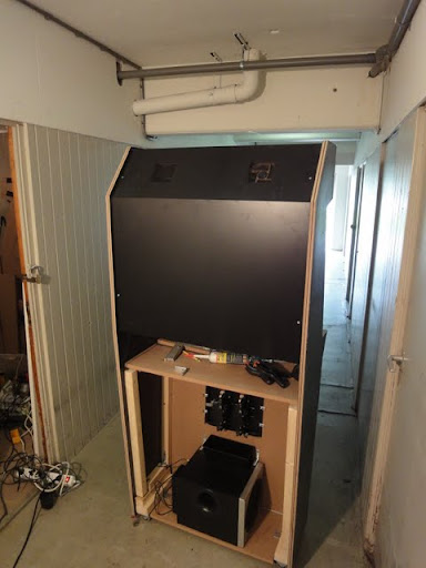

Installed the subwoofer, it barrely fits  :applaud:
made the second marquee holder, this one is glued
Nice  ;D
Speaker panel mounted
Created a bezel
Routing
Fits perfect !
laminated it
End shot for today
I can almost move this one inside  :applaud:

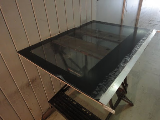

I also recieved some plexi samples. i think i will go with this one
Gray, 49% Transmission, transparent, UV absorbent, high-gloss surface, 3 mm
http://www.plexiglas-shop.com/NL/en/plexiglas-gs-allround-4aql41br8z4/plexiglas-gs-allround-grey-7c14-gt-dic33ry3pgp~p.html
its strong and very good quality, darkness seems ok to me when i hold it up to my monitor.

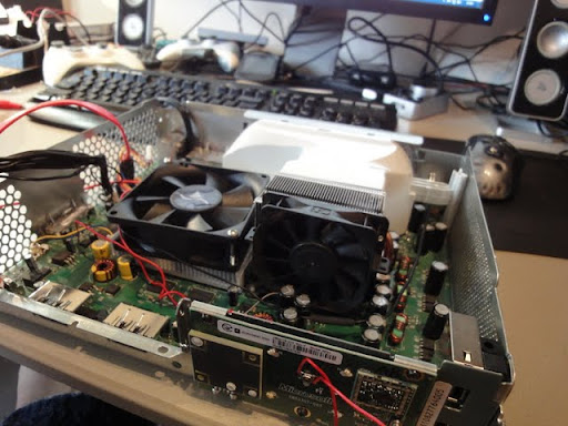

Also i been lurking around the ps3 and 360 area. I know its not the right way, but the ps3 scene releases of psn arcade games arent comming out because of the new key encryption.
And for now people can hack games into working on 3.55 firmware, but this will bleed to death i think..
A xbox 360 jtaged one has all the advantages, all the arcade remakes, and full mame (ps3 handles only 60% at the moment, no donkey kong for example)
then there is the point i wanted to include a ps3 webcam behind the plexi for move games, especially shooters like the shoot or time crisis series.
also i have the ps3 and joysticks, but no jtaged 360 (got one here but not working yet, some solder via's are broken off to dump the nand).

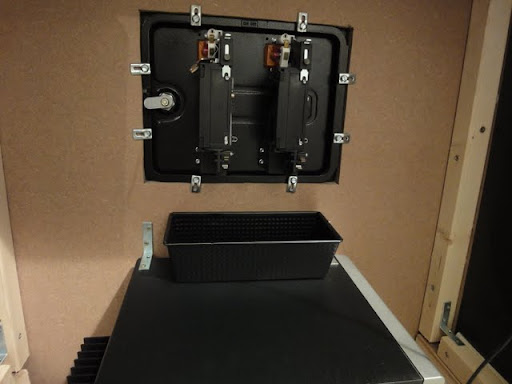

Found some more time this morninge, holiday is almost over..  :o
Did many little things like :
painted a coin box made from a baking bowl
Added a marquee light holder, it will be covered with aluminum
And created a bezel for the speakers for light
painted speakers
laminated the sides
Thats it for today, and some final shots for this day..

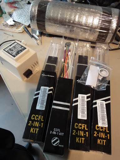

I found a great deal in a local electronic shop on 30 cm dual ccfl's white, 2 euro a piece, he had only 4 left. I took them all.
They must have be laying there for some time, they have very dusty packing.
And got a free 2.5A 12 volt power block and some alluminum role  :applaud:

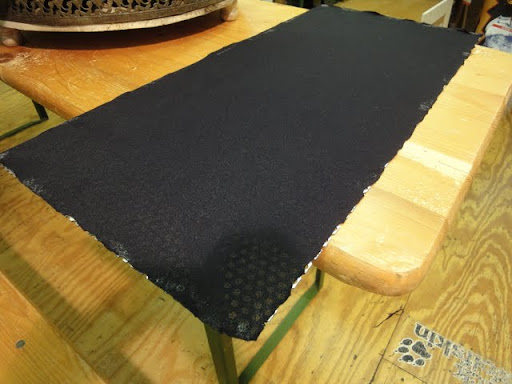

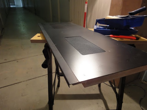

I finished making the back Subwoofer/Airvent Grill  :applaud:
After painting the grill with satin black spray (primed first) i used speaker cloth to wrap it.
I used quick glue to hold it , placing the cloth , clamping it down ( use something soft on the painted side as the clamp would make marks)
Result :
Now it can be placed on the backpiece.

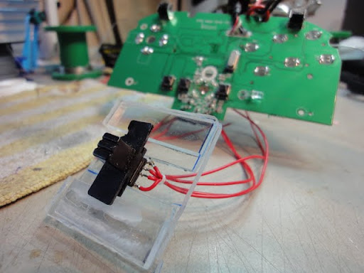

Also got 2 Madcats Street Fighter Fight Pads for controlls for the xbox 360.
I will be using the turbo and directional to analog stick (L/R) Switch as well

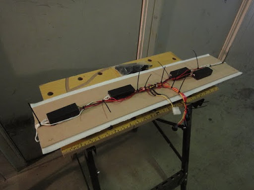

Installed marquee lights, note overlapping alluminum, they come with on off switches.
They are a lot, 6 x 30cm ccfl. But i remember from my old cabinet i had 2 x 50cm and it wasnt enough.
This cab is 30 cm more wide and if needed i can turn some on or off and even move them, they are with velcrostraps (came with the ccfl)
And started on the Sound, I/O panel
Made a small opening with this bit
And used the router to cut out the rest
Routerd out more space
Then you get this effect

And finished the back panel
On the last picture you see the speaker grill going till the bottom, thats because with routing the botom latch of mdf broke, it was to thin. i fixed it like this.
I didnt have enough laminate for such a large panel to redo it.

Then there is that 1 gamepad is broken, arrow to the left doesnt work. Hope i can fix it as it was a 2ndhand controller. Lesson here, test before opening  :banghead:
The 2nd gamepad works fine, i was working on something to make the smd small connector for changing 4way to left or right analog stick
Here was the first idea
But i found this little gem, its a strong arcade abuse perfect switch
And works great switching between controlls

Also I fitted the plexi for the marquee this weekend and finished the bezel.
Marquee 2 x 3mm plexi highly transparent (Clear: 92 % light transmission), UV absorbent, high-gloss surface, break-resistant
Alluminum h shaped holder and some metal glue
Holder shape , it has 8mm space for the 3mm mdf + 1mm laminate + 3mm plexi  :cheers:
bezel
bezel + plexi + holder
Fits perfect  :applaud: Still has protective plastic on it, ill remove it when its in my home

Didnt find much time this week to work in the storage on the cab, but did some electronics instead.
messy testsetup
Found myself a nice jtaggable console  :applaud: These things are hard to find in good shape.
This xbox has only run for 5 hours from the previous owner. Its a old xenon type xbox 360, so it doenst have HDMI, but i still have from my old xbox a kick ass quality Monster Xbox 360 Component cable
It came only with optical , so i soldered stereo pluggs to the mainboard.
Then i also soldered
-The nand-x controller for jtag
-12 volt for large 3.5 inch hdd compatabilty
-removed the risistor microsoft uses to disable jtag with an update
-extended powercable for the dvd drive
-added some fans
The xbox is running fine now and i am installing and trying all sorts of software.
Also did some stress testing with all the extra fans, its keeping it cool (dont want a rrod)
Replaced main fan with this
Additional fans (added some resistors to them to keep them silent)
Extended power, sata, hdd and audio connecor
2TB hdd, way overkill i know. but they are so cheap atm, its 5400 rpm low power consumption and silent
This hdd had some known error with possible data missing, there was a firmware update for it. Make sure if you get one you check it before using.
I also tested the speakers for the stereo sound, it produced a hum and little buzzing. Good thing i tried this first before mouting it into the cabinet. I rewired some GROUND wires and its gone now  :applaud:
