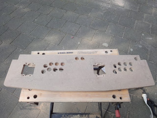

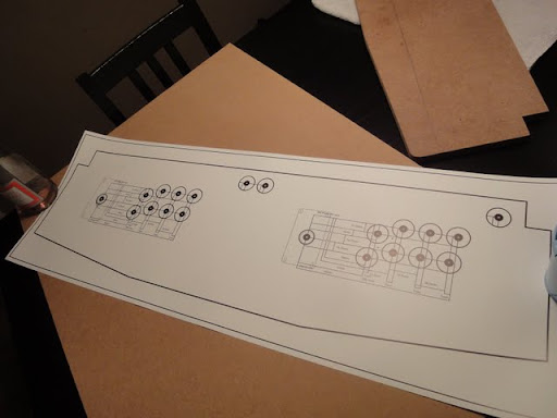

Drilling template, i went with the generic version of the Vewlix shifted layout. Got it from http://www.slagcoin.com/joystick/layout.html
Why did i choose this design, well i placed my fingers on the cabinet and printed some layouts, this one felt best for my use.
Ready for drilling
I have to note, i bought the Sanwa JLF sticks from arcadeshop.de and used their mounting plate details http://www.arcadeshop.de/images/specs/arcade-jlftp8yt-mounting.gif
Its not correct
The size is correct
but the drilling holes arent
Just have to make sure i dont make a mistake here.

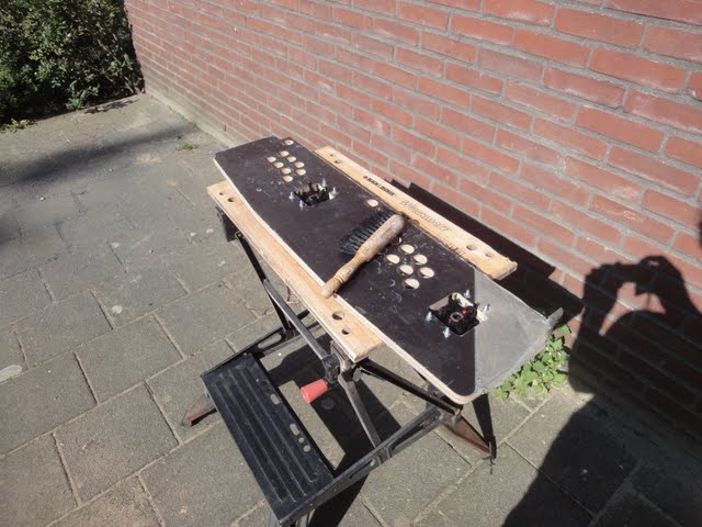

I added m5 bolts to the joystick plates and made them flush
And started drilling the cp

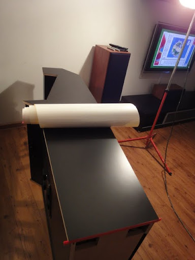

Placed the cab on its side and cleaned with amonia and then apply the artwork

Finished drilling the holes for the control panel  :applaud:

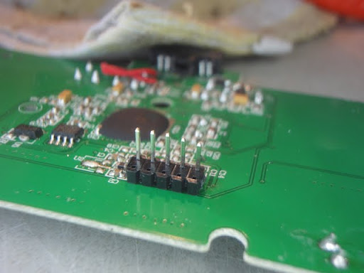

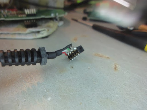

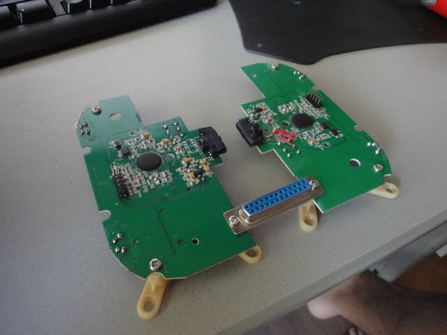

Started to work on the Madcats fightpad pcb. I removed the cable and added a pin socket to the board
And added a female connector to the madcats usb cable
Cute  :angel:

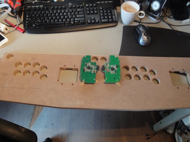

I worked on my control panel some more  :D
I never thought i would have had so little space for all the buttons joysticks & pcb on the panel. I had to move stuff around a lot to get it to fit.
In the end i got it right.  :applaud:
First i had to cut the little pcb pets up once more  :-[
With the pcb moved all the way to to top it could fit just right.

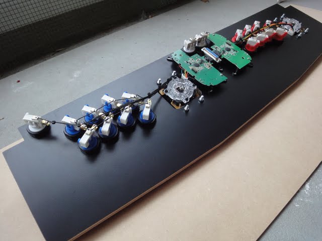

Mounted the JLF plates
laminated both sides and opened the holes up
The nicest way was to place the lpt socket like this
But then the cp wont fit anymore plus i couldn't get the lpt connector in the socket
WONT FIT :(
So i had to move the lpt more around. I centered it vertical. That way it would fit and i could get the lpt cable in.
And i started wiring
Pcb soldering
Result  :applaud:

Just to add the LPT is used for
- Player 1 turbo on off (2 wires)
- Player 2 turbo on off (2 wires)
- Player 1 turbo LED (2 wires)
- Player 2 turbo LED (2 wires)
- Player 1 Left analog stick / Right Analog stick / D-Pad Switch  (4 wires)
- Player 2 Left analog stick / Right Analog stick / D-Pad Switch  (4 wires)
- Player 1  Select Button (Xbox 360 Back button) (2 wires) (Going to the coin Box)
- Player 2  Select Button (Xbox 360 Back button) (2 wires) (Going to the coin Box)

Martijn
  • Posts: 822
  • Akira!
    • ModMyBox
Re: Scratch Slim Marvel vs Capcom [6 Okt - Control Panel Wiring Done]
« Reply #140 on: October 08, 2011, 04:52:30 am »
Yes soldered every connection. I am a soldering freak  :laugh: and yes bended the JLF 90 degree, i used a dremmel and a bit like this
and dremmeled the top white plastic of untill the coper pins started showing, and i took a plier and bend all the pins up in one move
