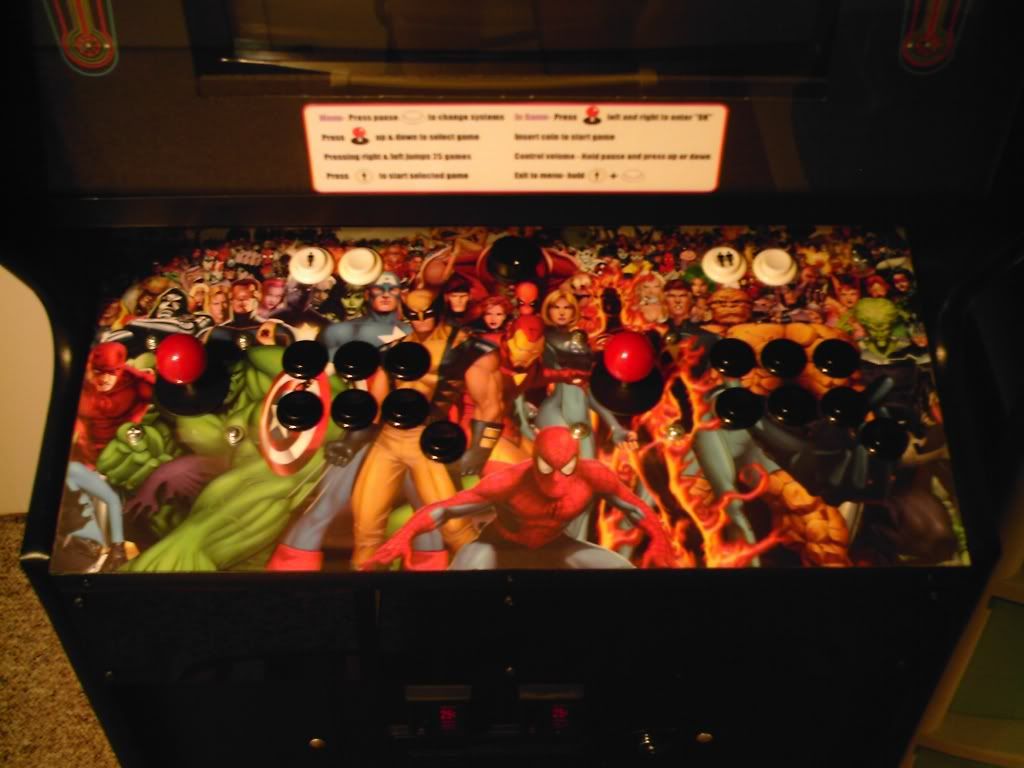

Well, the one that I did that way no longer exists. It was a swappable panel for my cab and I messed it up (drilled the button holes too close to each other).
This is my current CP. I need an updated pic, since the buttons are now multi-colored, and as you can see, these are not as close as I described (because this is the first CP I did, before the swappable one I trashed...)
In reply to your new mock-up, I like it.

Another revision.  I decided to move all of the playable controls up as high as possible to get plenty of palm space.  Everything else is in the middle as tiny buttons, including player 1 and 2 start.  I'm not sure how many buttons there will be in the middle yet, but this is the general idea of what I'm thinking right now:
I think you might've went too high. I know it's only an 8" distance you're working in, but maybe bring the player controls down an inch, bring back the full size buttons for the player starts, and line the admin buttons along the top. Here's a quick mockup:

Personally I'd go with 7 button layout, and use a shift function for the other admin functions (6 is way to many buttons even if they are small)
I think Ginsu is getting close, here is my slight tweak of his tweak
« Last Edit: July 16, 2009, 12:03:38 pm by Bender »

Yeah, I'm not a fan of even that many admin buttons, but it seems to be what he wants, so I just tweaked them slightly.

I put the admin buttons (besides start and insert coin) on the side of the CP on Player 1's side.  That way it you'll never have to worry about them getting in your way, and only Player 1 has access to them.

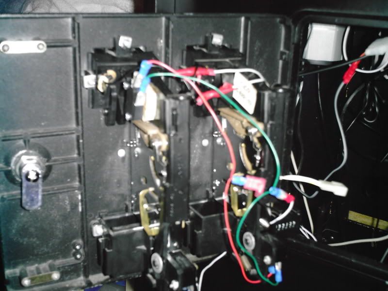

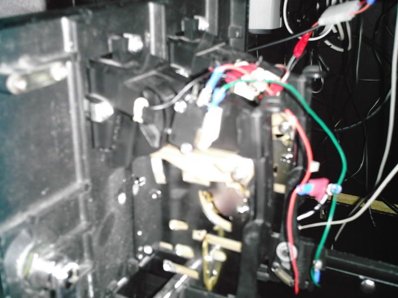

I rigged up a microswitch behind one of my rejects and used that for credits.
These pics suck, so you can't even tell what's going on in them, but what you're supposed to see is a microswitch mounted on a small bit of wood that is gorilla glued to the coin chute. Everything still functions as normal, except now when you press the player 2 reject, it engages the switch (and it can still reject a stuck coin).

Finally got around to using my new ratchet quick-connect crimper.  WAY WAY WAY better than the junky Radio Shack one that I was using! :)
