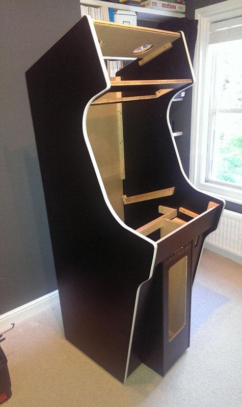

I'm starting on a new cabinet called 'Blip'. This is to fill the gap left by the sadly departed ‘Terminus’ which I foolishly moved to a not-quite-waterproof shed. Doh. At least I managed to salvage the parts.
This is one of those cabs that started with a name and then the design sort of evolved from that.  When I did a search to see if anyone else had already used this name for a cabinet I came across this tabletop game from 1977.
Whilst the game is supposed to be pants (I’d never played it) I love the retro style of it so I’m using this as a basis for the cabinet graphics.
My original plan shape-wise was for it to be based on Moon Patrol but a bit less ‘blocky’ so I started from that shape and added a few curves and tweaked the angles a bit to match my height. Whilst it doesn’t resemble Moon Patrol as closely any more I think it still retains the classic shape which I want for this cabinet.
I’ve got my hands on a shallow 25” CRT for this build and will be using a coin door to try and ‘keep it real’. It will also have some modern jiggery pokery with servo sticks, a light gun and swappable panels - assuming I can get them working without too much of a headache.
Anyway, obligatory renders follow. If it looks closer to this render than a 6ft high box with nails poking out of it I’ll be very pleased so if anyone has any questions, criticisms or suggestions then please post ‘em. I’m fairly thick skinned so can take it…
I also don't have more than a few hours a week to work on it so it's probably going to take me a few months to complete it

« Reply #14 on: January 27, 2014, 07:21:04 am »
Just a small update as I’ve actually started something now.
The profile of the cabinet is quite shallow and I was a little worried that the TV wouldn’t fit so I’ve started by decasing the TV and putting it into a frame – then I could see if I need to change the plans at all.
Did all the usual – discharged with a screwdriver/croc clip combo and took a ton of photos to make sure I knew where everything went.
Quickly realised that even without the frame (which was pretty heavy) a 25” tube still weighs a decent amount so had to be very careful moving it around and into place.
I’d estimated this to take about 5 hours. In the end it took 10 which I have a feeling is going to be the norm for this build!
Turns out that it will fit ok but I’m adding another inch on the back anyway just to give me a bit of leeway and allow more air to circulate just in case.
Next job will be either the sides or the speaker panel – depends on the weather at the weekend and if it’s too cold to be outside or not!

It’s standing!
So I finished the remaining panels and laminated those. Added the furring strips and did a dry build to make sure everything fits as it should.
I’m pretty happy with the way it looks so I’ll take it apart and glue it together properly and then start mounting the electrics - then its onto the two control panels.
I still need to prep the control panel overlays for printing and finalise the design of the marquee but it definitely feels like the home stretch now.
