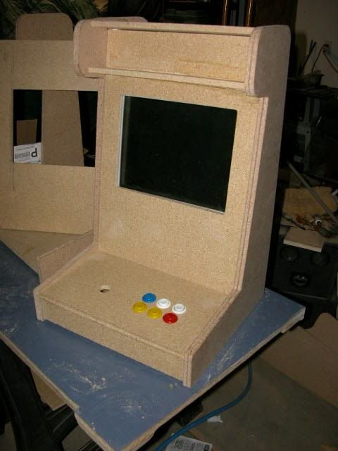

My little brother Stevie loves music and probably has 2 or 3 hundred cd's.
After seeing Mountains jukebox, I got the idea to make one for Stevie.
And like Mountain, I am on a tight schedule. Stevies birthday is next Saturday and I hope to have this juke done before then to give him as a present.
First of all, let me say that this juke box was inspired by Mountains juke project, and is a blatant rip off of his juke.
But I would also like to say that my wood working skills are no where near that of Mountains, so I dont expect my project will be anywhere close to as nice as his, so please dont compare it to his.
There will be some major differences between this juke and Mountains.
First of all, I plan to use some pretty good sounding speakers, so I had to make room for them. I am using Creative Inspire T-3100. IMHO they sound very very good.
Also, I had a 15" ELO CRT touchscreen that i bought off ebay a couple years ago. It is heavy, and takes a lot of rear-end room, so my juke had to be a lot deeper than Mountains.
I also plan to include a CD-rom so Stevie can put his CDs on it.
I know there are some great looking Jukes that folks have made on here, this is my first, so if it turns out a fraction as nice, I will be happy.
First, the computer Im using is a ASUS A7N266 with an AMD 900 MHZ processor.
60 gig harddrive and 256 megs DDR ram.
Here it is on my dining room workbench..
Here is a pic of the monitor and speakers:
I cut out the marquee area using the router jig I made for my rotating monitor project:
Here is a close up of the marquee area:
Here is a test fit of the monitor:
Here is the front with the cutouts for the speakers:
The separators between the speakers are pressboard in that pic. I later cut those out and used MDF to seperate the speakers.

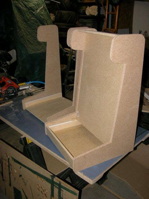

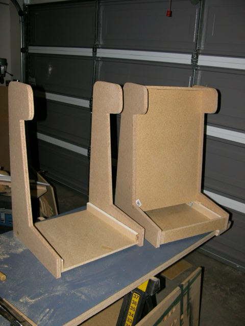

Ok, here is a pic of the rib attached to the front panel, also you can see the mounting bolts for the monitor and the small bolts for the marquee retainer.
I am using 1/4" carriage bolts with MDF spacers to attach the monitor with. I will be using 4 L brackets on the monitor.
My marquee retainer will be 5 plastic bathroom mirror hangers. They will attach to the small bolts, clamping against the plastic of the marquee.
And here is the monitor pedestal, which also happens to be the speaker box. (Notice the shim made from a wooden yardstick?)
Here is the front panel sitting on my workbench. I am ready to apply the 1/8" black plastic. (Plan to that in the morning.) You can also see the bottom of the speaker box better.

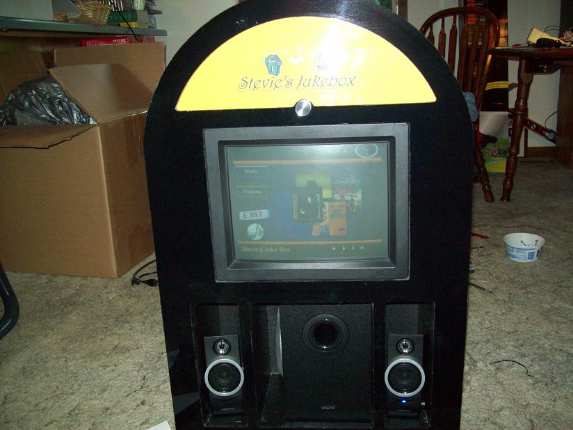

Got the black plastic glued on. It went on pretty good. Im letting it setup for a couple of hours before I move it so I can have room to work on the back panel. According to instructions, it will probably need to set up for a couple of days before I start whacking away at it.
The cement went on good, but the fumes it puts off made me a little light headed.
Sorry I didnt get any pictures. Its just too hard to take pictures while Im doing something I havent done before.
Plus I didnt want to risk getting cement on my camera.
At first, I had planned on just dropping the plastic on top of the front panel, since I had plenty of room around the edges, but a little voice told me I should use wooden dowels to separate the two pieces until I am sure they are lined up. (Thank God for the little voices!).
I ran out to Walmart last night and bought 3/8" dowels. (5 of them).
I did a few practice runs before I applied any glue. Its a very good thing I had the wooden dowels. I think I would have been in big trouble without them, since 2 out of three times I got the plastic way off center.
Using the dowels allows you to slide the piece until it is positioned where you want it.
I dont think there is any turning back after the two cemented pieces touch.

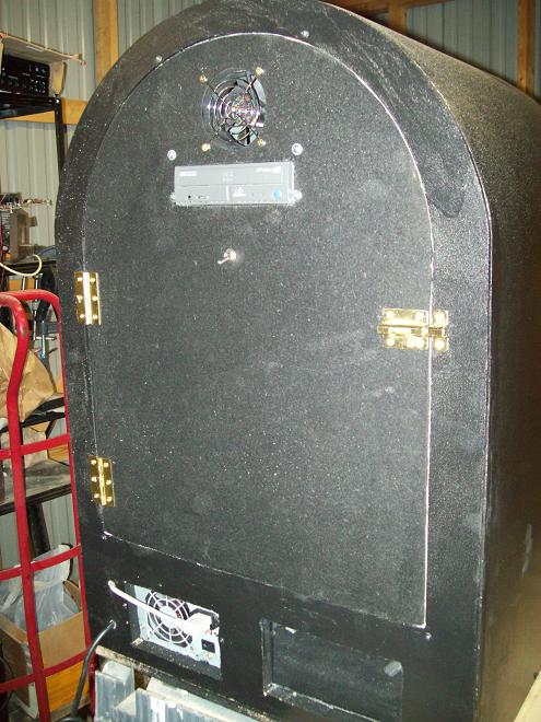

Got some more work done today. It got too hot out in the shed so I had to quit until later this afternoon.
Here is the back, door is cut out and T molding slot is cut.
Here is the front panel with the plastic. This is just before I started trimming the plastic.
Notice the router table I threw together out of scrap pieces of MDF. (Thanks Mountain for the idea.)
I like the way this homebrew table works. I have decided that a factory made router table is now on the Christmas wish list. Notice the 3 in one oil for the trim bit bearing.
And here is the speaker box, before trimming.

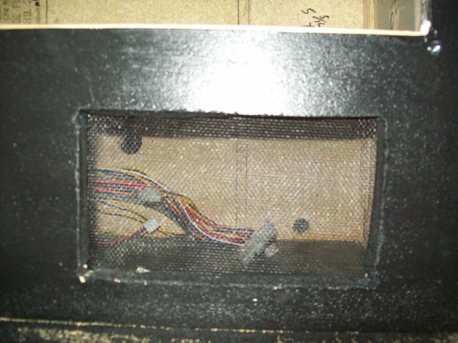

I started by drilling 1/2" holes in the plastic with a paddle bit. I ran the drill fast and applied pressure slowly.
I drilled one in the marquee area and one in the monitor area.
I also drilled the hole for the volume pot shaft at this time.
Notice the practice hole I drilled first in the outside corner. Never hurts to test first.
I also drilled holes in each speaker panel.
After drilling the starter holes, I started trimming the access plastic. Here is the laminate trim bit in action.
I drilled out the inside panels one at a time, just stuck the hole I drilled earlier and put it over the router bit. Then just went around the inside edge.
Here is a pic of the finished product:

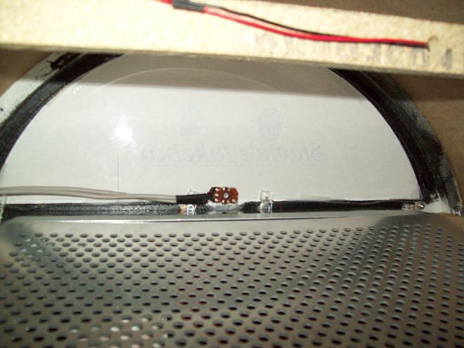

Here is the pot I intend to use for volume control..

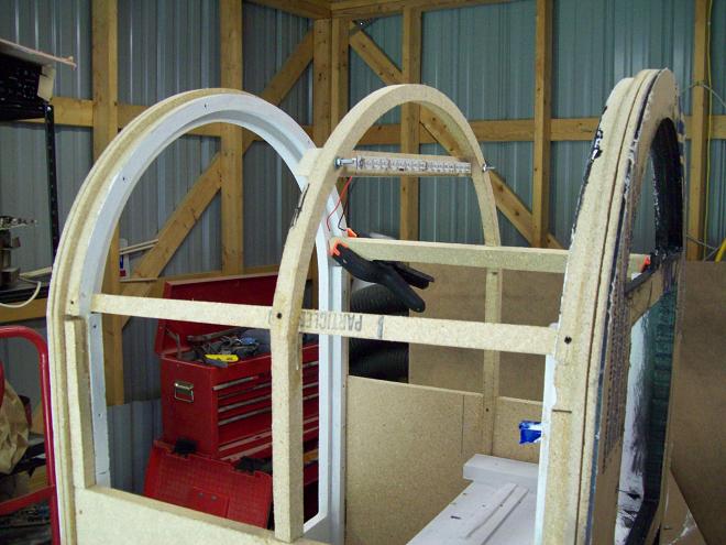

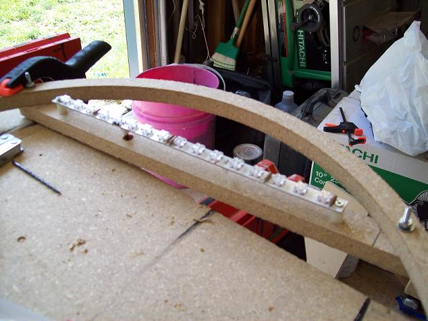

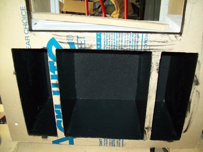

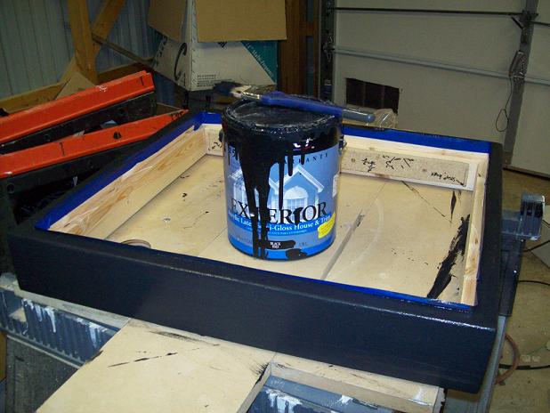

Last night I applied primer to most of the parts. I figure that since its going to be so close when assembled, id better paint what I can now.
Today I got the first coat of black paint on the marquee frame and the speaker boxes.
I also painted the bottom plate and applied primer to the back plate (I forgot that piece last night.)
I also bought a 8' 2X4 at 84 Lumber.
I plan to saw out a L shape in a corner of it. Hopefully when this part is finished it will give a base for the Juke to sit in.
The base will go around the bottom of the juke, maybe I will try to router a curve to the outside corner of it.
The aim here is to have a solid base, that kinda looks like quarter round.

I test fitted the bottom, front, and side panels today. (Sorry no pics, but I will get some soon.)
I need to do a little tweaking on getting everything square.
I have found that i do not like working with pressboard. I dont think it was intended to be used in projects like this.
It is not very strong, and a screw will bust it if you go too deep.
I guess if you covered it with laminate it would be much stronger. But only the front of this project will have laminate.
Oh well, that pretty much answers my question of using it as an alternative to MDF in arcade cabs.
I think on  my next one (for the wife), I will use 5/8 MDF.

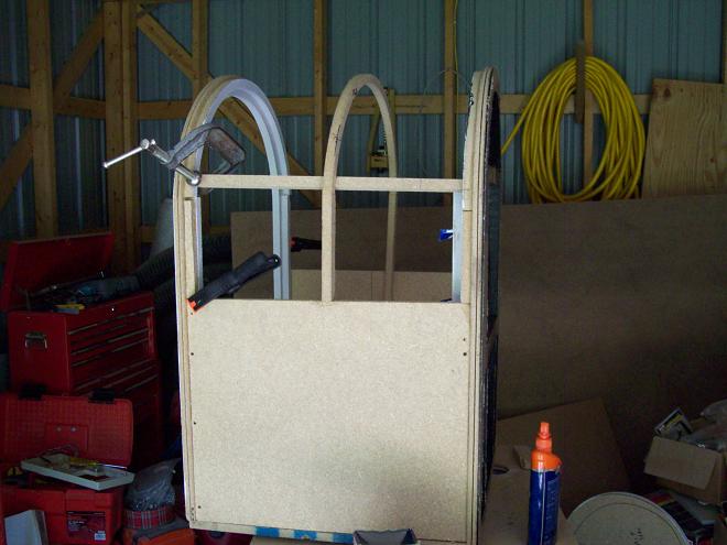

Ok, here is a picture of the ribs and two braces. The top center brace also served to mount the marquee light, which is a LED strip from Groovy Game Gear.
(I have tried to keep these pictures in order, but they probably are not).
This next pictures proves they are not in order.
Here is a side panel, and a brace:
Here is the speaker box. (I touched up teh paint in the corners later).
Here is the back of the speaker box. Notice how teh back panel extends to both side panels to aid in bracing them.

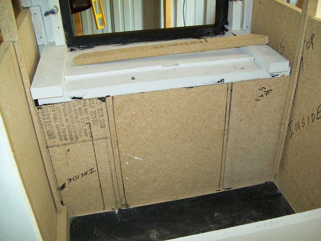

Here is a picture of the center rib, with top brace and marquee lamp installed:
Here is teh back of the marquee installed. Notice the mirror clamps I used to hold the marquee in.
The volume pot is attached to the marquee.

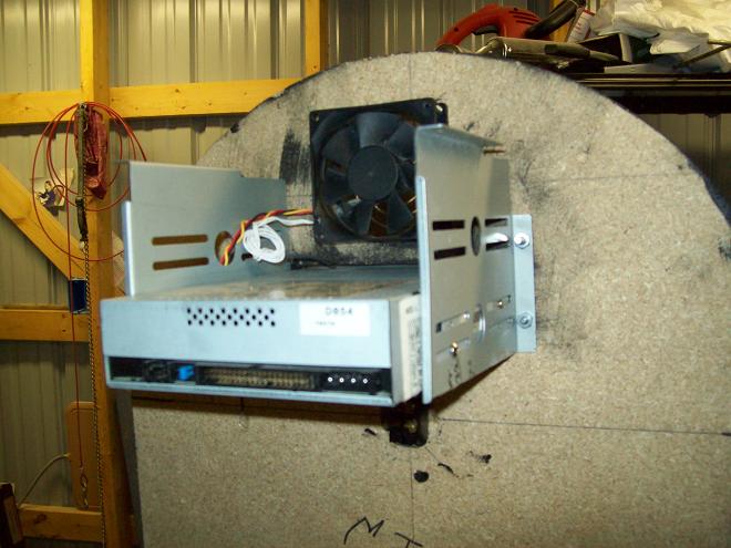

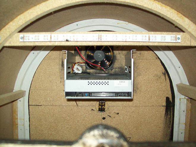

I mutilated an old PC case to get the mount for my Cd ROM. Here is a picture of it and the back case fan. The fan is a variable speed with a temp sensor.
Here is picture of the CDROM/fan as viewed through the marquee opening.
Here is the back, with a lot of dust on it:

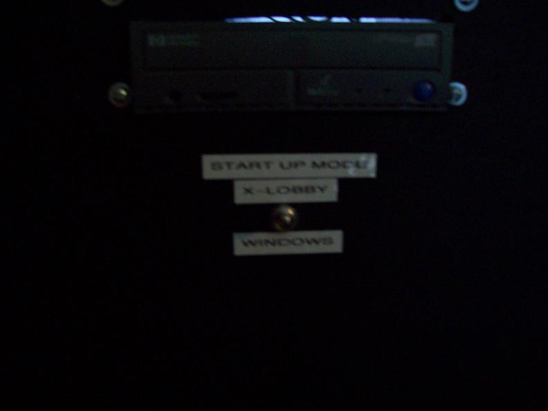

Here is a dark picture of the CDROm and the startup mode switch:

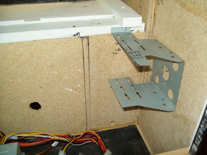

Here is a picture of the hard drive mounting bracket: (cut from the Cdrom bracket):

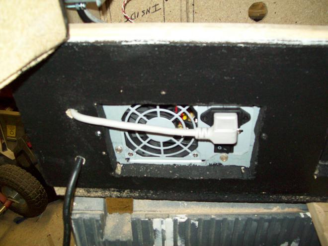

This is the back with the power supply fixed to exhaust air. I used a 90 degree power cord to connect it.
Notice the AC power cord coming out of the case. I touched up the paint a little on this part later.
This is the air inlet opening. it is covered on the inside with black vinyl screen:

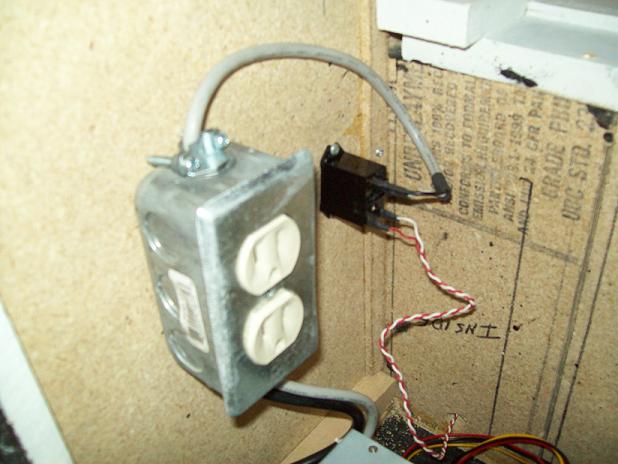

Here is the power switch setup. the relay turns on the duplex outlet. The monitor and speakers will plug into the outlet. The power supply cord is hardwired to the AC power cord inside the duplex "handy box".
Here is the base. (And a very messy can of paint!). I made the base out of a pine 2 X 4.
It has an L shaped cut on the inside for the juke box to sit in. I was going to route a rounded corner to the top outside edge of it, but I ran out of time.
Notice the scab on the back? I cut one two short so I had to cut in in two and put a piece in between.  I used teh scab to hold it all together. That piece is in the back of the juke, so it's not noticeable.
And here is the finished product.
This was before a good dusting and cleaning the plastic to remove my finger prints.
I put 3/4" chrome T-molding around the front and back edges, but I didnt get a picture of that. The chrome t-molding looks really good, and really improves the over all look.
I am using X-Lobby for the juke software with windows XP as the OS.
The switch in back allows one to choose whether to startup in X-lobby or Windows when the machine is turned on.
This is accomplished by switch grounding one pin of the printer port. I wrote a small app that starts X-lobby if the switch is in a certain position on start up.
This switch will allow Stevie to boot to Windows where he can rip his Cd's to the jukebox when he wants.
I still need to order the long IDE cable for the CD rom, and tidy up the wiring a bit.
