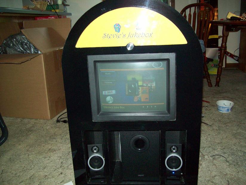

My little brother Stevie loves music and probably has 2 or 3 hundred cd's.
After seeing Mountains jukebox, I got the idea to make one for Stevie.
And like Mountain, I am on a tight schedule. Stevies birthday is next Saturday and I hope to have this juke done before then to give him as a present.
First of all, let me say that this juke box was inspired by Mountains juke project, and is a blatant rip off of his juke.
But I would also like to say that my wood working skills are no where near that of Mountains, so I dont expect my project will be anywhere close to as nice as his, so please dont compare it to his.
There will be some major differences between this juke and Mountains.
First of all, I plan to use some pretty good sounding speakers, so I had to make room for them. I am using Creative Inspire T-3100. IMHO they sound very very good.
Also, I had a 15" ELO CRT touchscreen that i bought off ebay a couple years ago. It is heavy, and takes a lot of rear-end room, so my juke had to be a lot deeper than Mountains.
I also plan to include a CD-rom so Stevie can put his CDs on it.
I know there are some great looking Jukes that folks have made on here, this is my first, so if it turns out a fraction as nice, I will be happy.
First, the computer Im using is a ASUS A7N266 with an AMD 900 MHZ processor.
60 gig harddrive and 256 megs DDR ram.
Here it is on my dining room workbench..
Here is a pic of the monitor and speakers:
I cut out the marquee area using the router jig I made for my rotating monitor project:
Here is a close up of the marquee area:
Here is a test fit of the monitor:
Here is the front with the cutouts for the speakers:
The separators between the speakers are pressboard in that pic. I later cut those out and used MDF to seperate the speakers.
More to follow!

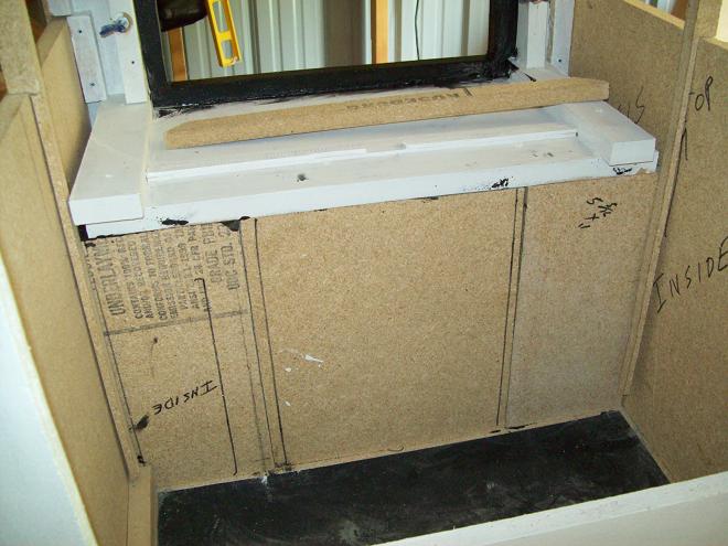

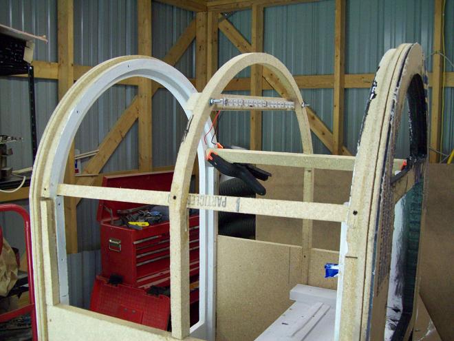

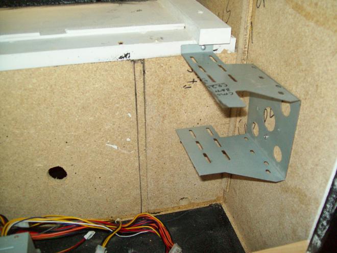

Ok, here is a pic of the rib attached to the front panel, also you can see the mounting bolts for the monitor and the small bolts for the marquee retainer.
I am using 1/4" carriage bolts with MDF spacers to attach the monitor with. I will be using 4 L brackets on the monitor.
My marquee retainer will be 5 plastic bathroom mirror hangers. They will attach to the small bolts, clamping against the plastic of the marquee.

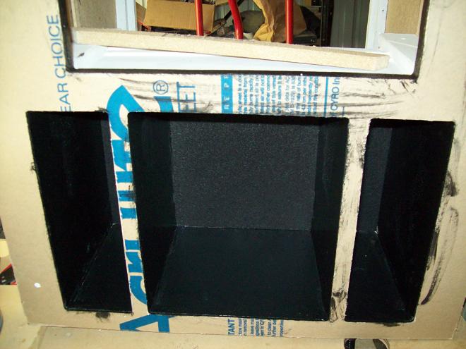

And here is the monitor pedestal, which also happens to be the speaker box. (Notice the shim made from a wooden yardstick?)

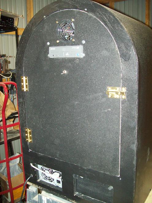

Here is the back, door is cut out and T molding slot is cut.

And here is the speaker box, before trimming.
I started by drilling 1/2" holes in the plastic with a paddle bit. I ran the drill fast and applied pressure slowly.
I drilled one in the marquee area and one in the monitor area.
I also drilled the hole for the volume pot shaft at this time.
Notice the practice hole I drilled first in the outside corner. Never hurts to test first.
I also drilled holes in each speaker panel.
After drilling the starter holes, I started trimming the access plastic. Here is the laminate trim bit in action.
I drilled out the inside panels one at a time, just stuck the hole I drilled earlier and put it over the router bit. Then just went around the inside edge.

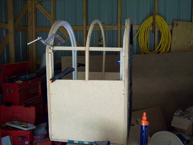

Ok, here is a picture of the ribs and two braces. The top center brace also served to mount the marquee light, which is a LED strip from Groovy Game Gear.
(I have tried to keep these pictures in order, but they probably are not).
This next pictures proves they are not in order.
Here is a side panel, and a brace:

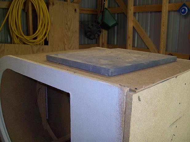

Here is the speaker box. (I touched up teh paint in the corners later).
Here is the back of the speaker box. Notice how teh back panel extends to both side panels to aid in bracing them.

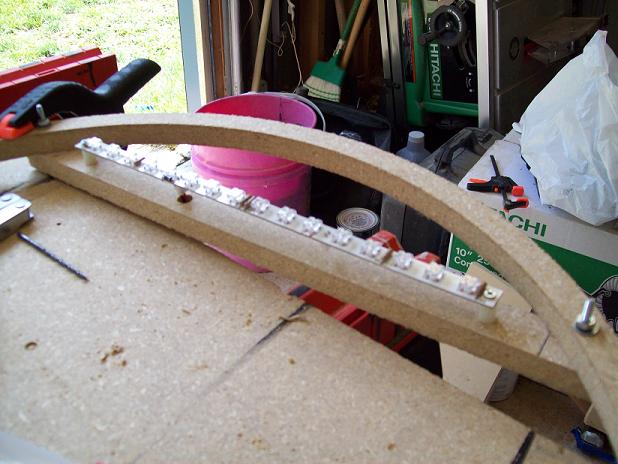

Here is a picture of the center rib, with top brace and marquee lamp installed:

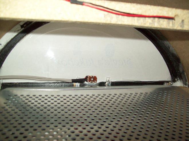

Here is teh back of the marquee installed. Notice the mirror clamps I used to hold the marquee in.
The volume pot is attached to the marquee.

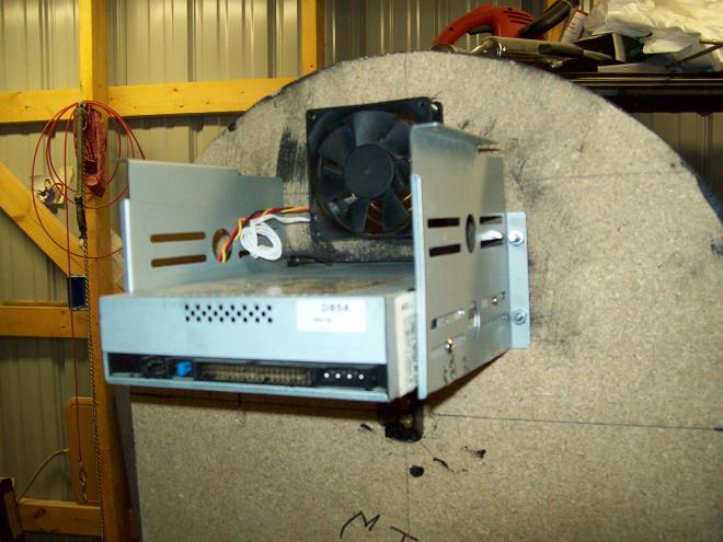

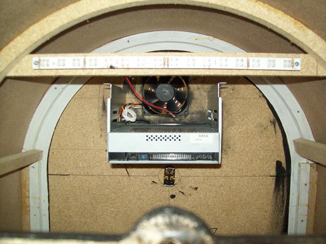

I mutilated an old PC case to get the mount for my Cd ROM. Here is a picture of it and the back case fan. The fan is a variable speed with a temp sensor.
Here is picture of the CDROM/fan as viewed through the marquee opening.
Here is the back, with a lot of dust on it:

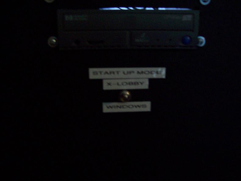

Here is a dark picture of the CDROm and the startup mode switch:
Here is a picture of the hard drive mounting bracket: (cut from the Cdrom bracket):

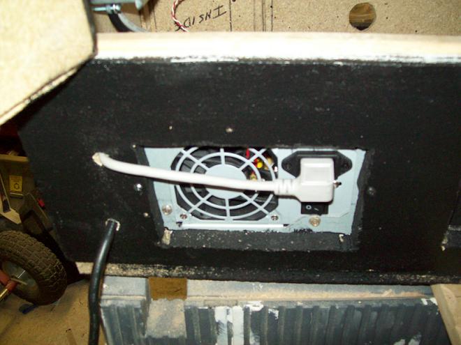

This is the back with the power supply fixed to exhaust air. I used a 90 degree power cord to connect it.
Notice the AC power cord coming out of the case. I touched up the paint a little on this part later.

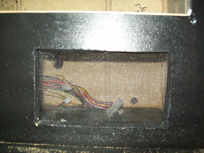

This is the air inlet opening. it is covered on the inside with black vinyl screen:

And here is the finished product.
This was before a good dusting and cleaning the plastic to remove my finger prints.
I put 3/4" chrome T-molding around the front and back edges, but I didnt get a picture of that. The chrome t-molding looks really good, and really improves the over all look.
I am using X-Lobby for the juke software with windows XP as the OS.
The switch in back allows one to choose whether to startup in X-lobby or Windows when the machine is turned on.
This is accomplished by switch grounding one pin of the printer port. I wrote a small app that starts X-lobby if the switch is in a certain position on start up.
This switch will allow Stevie to boot to Windows where he can rip his Cd's to the jukebox when he wants.

I missed a pic that I thought might be interesting..
This is the monitor mounted, view from the back.
You can also see the hard drive mounted..
