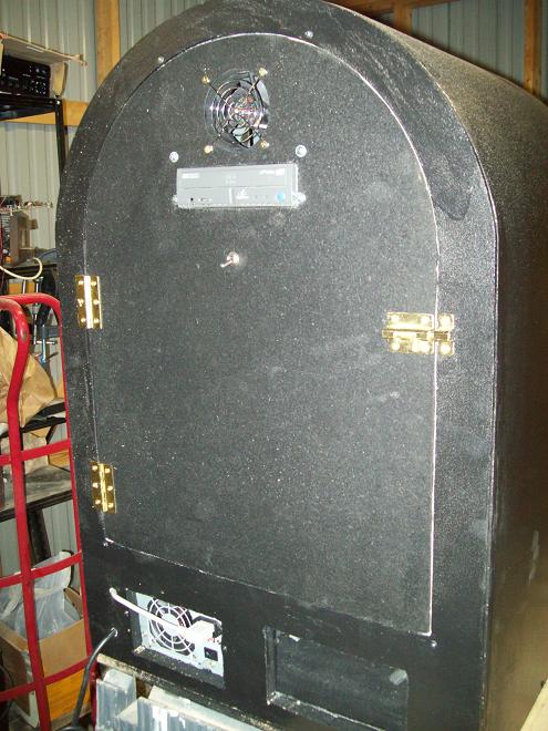

Here is the back, door is cut out and T molding slot is cut.

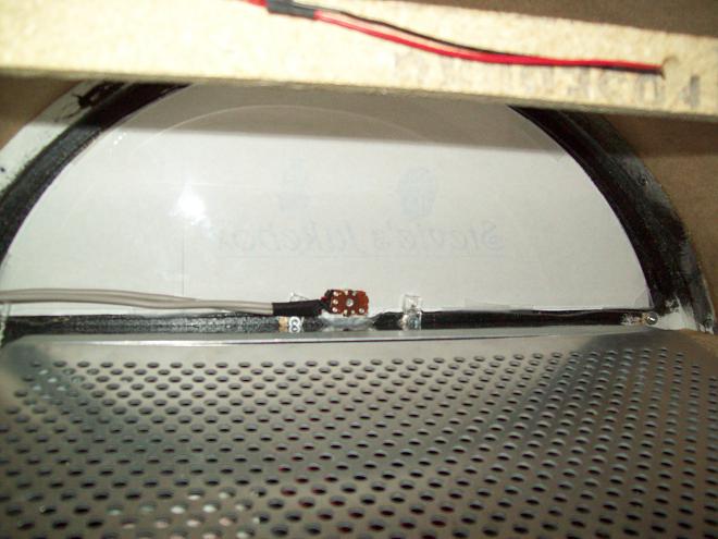

After drilling the starter holes, I started trimming the access plastic. Here is the laminate trim bit in action.
I drilled out the inside panels one at a time, just stuck the hole I drilled earlier and put it over the router bit. Then just went around the inside edge.
Here is a pic of the finished product:

Here is the pot I intend to use for volume control..
Edit, one more time..

Here is teh back of the marquee installed. Notice the mirror clamps I used to hold the marquee in.
The volume pot is attached to the marquee.
I mutilated an old PC case to get the mount for my Cd ROM. Here is a picture of it and the back case fan. The fan is a variable speed with a temp sensor.
Here is picture of the CDROM/fan as viewed through the marquee opening.
Here is the back, with a lot of dust on it:
Here is a dark picture of the CDROm and the startup mode switch:
Here is a picture of the hard drive mounting bracket: (cut from the Cdrom bracket):
This is the back with the power supply fixed to exhaust air. I used a 90 degree power cord to connect it.
Notice the AC power cord coming out of the case. I touched up the paint a little on this part later.
This is the air inlet opening. it is covered on the inside with black vinyl screen:
Here is the power switch setup. the relay turns on the duplex outlet. The monitor and speakers will plug into the outlet. The power supply cord is hardwired to the AC power cord inside the duplex "handy box".
