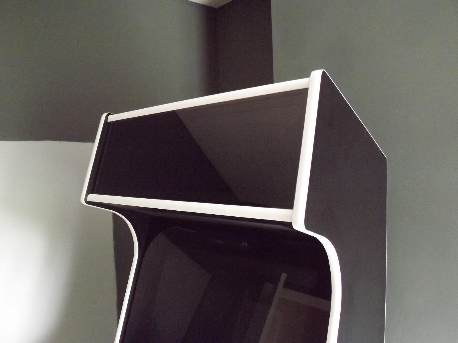

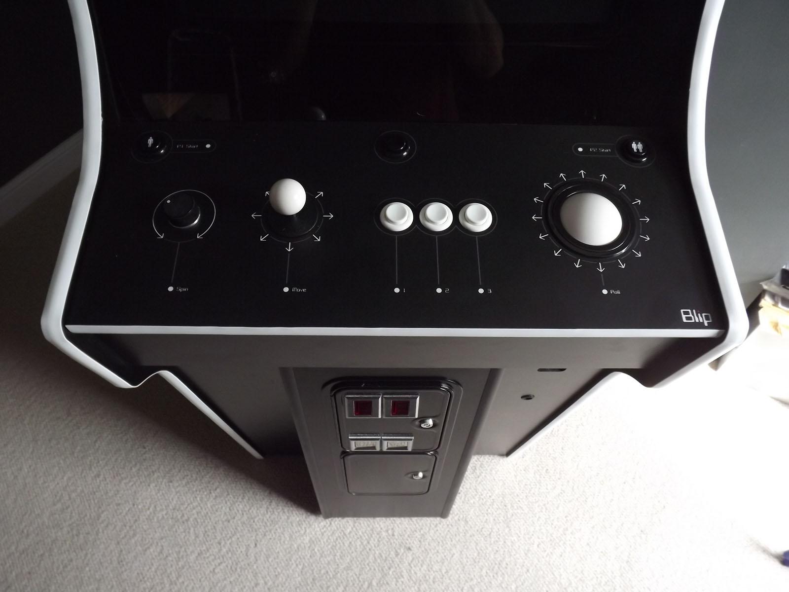

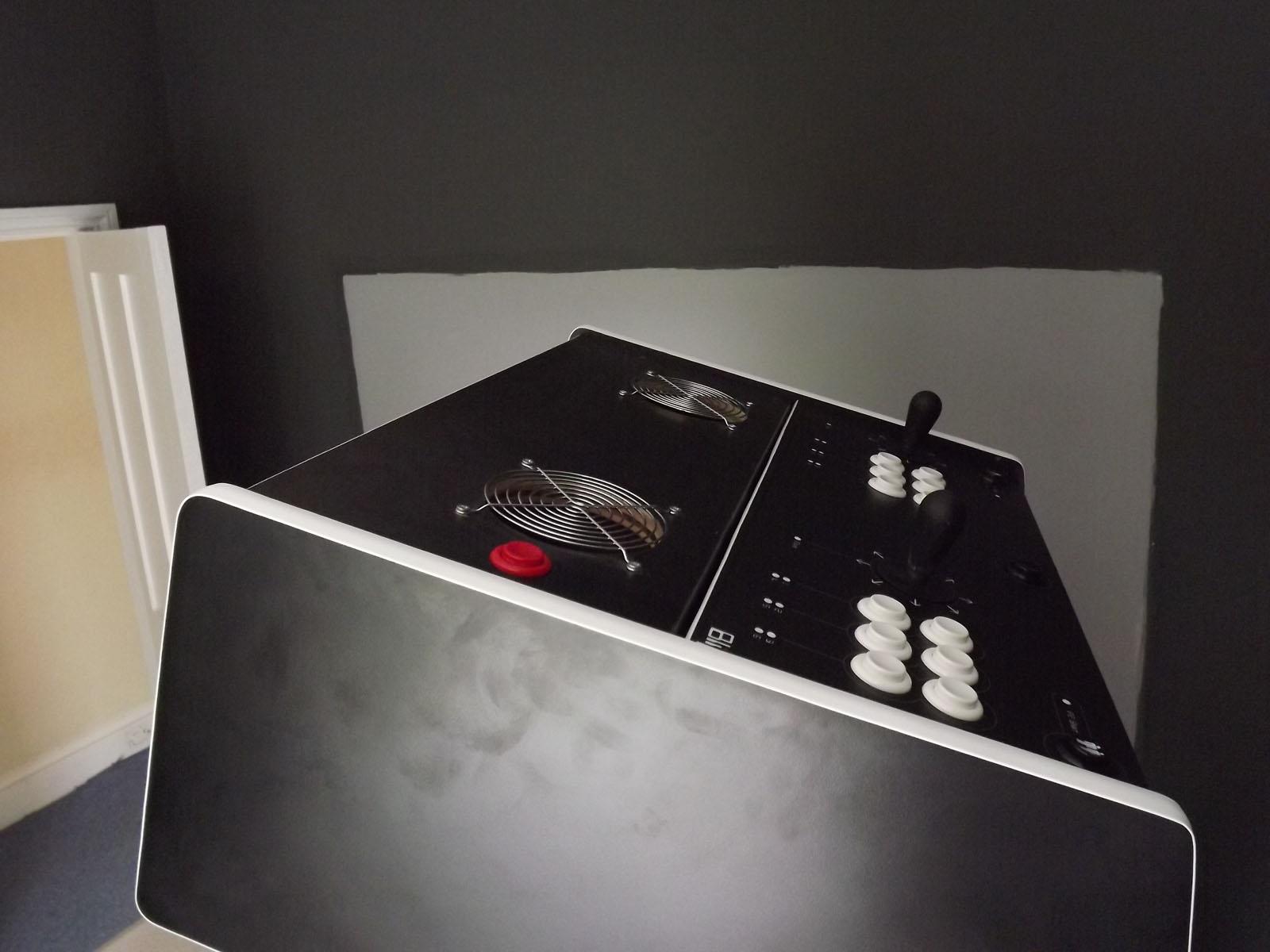

Hi guys,
Cabinet is now finished. Some final pics below.  There's loads of pics throughout the thread and some pictures of it switched on are here: http://forum.arcadecontrols.com/index.php/topic,137295.msg1452050.html#msg1452050.
In a nutshell, it's a Moon Patrol inspired retro styled cabinet with swappable control panels, funky LCD marquee and LED lighting. Was fun to make but now it's all about the playing :-)
Many thanks for all the comments and support throughout the build!

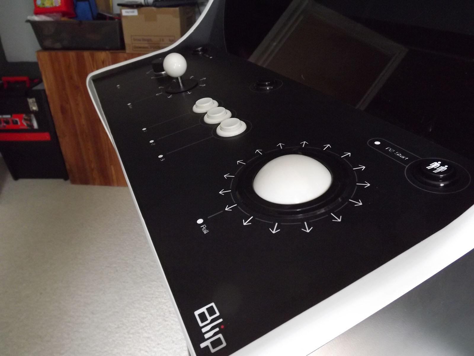

I do intend to do some funkiness to the control panel. The plan is to use the white lines from the original Blip console and have something very retro looking.
As I was designing the control panel in Photoshop I had a bit of a lightbulb moment (literally). Using this design I can use some funky lighting to indicate the controls used for each game without lighting up the whole button/stick/trackball whatever.
Anyway - I'm still quite a way away from the control panels as I intend to do them last but this should give you an idea of what I'm thinking of, first unlit, then as a 2 button stick game...

« Reply #6 on: January 21, 2014, 11:00:22 am »
Trackball that close to the side of the case leads to smashed fingers/hands imho.
markc74
  • Posts: 842
  • Last login:March 08, 2026, 11:25:45 am
  • Flipping out
Re: Blip
« Reply #7 on: January 21, 2014, 05:23:00 pm »
Very good point and thanks for bringing it up. While it feels good on paper I obviously haven't tried it in the flesh so don't know what problems may arise. I intend to mock the panel up before i do it for real so hopefully this will help refine the layout.
