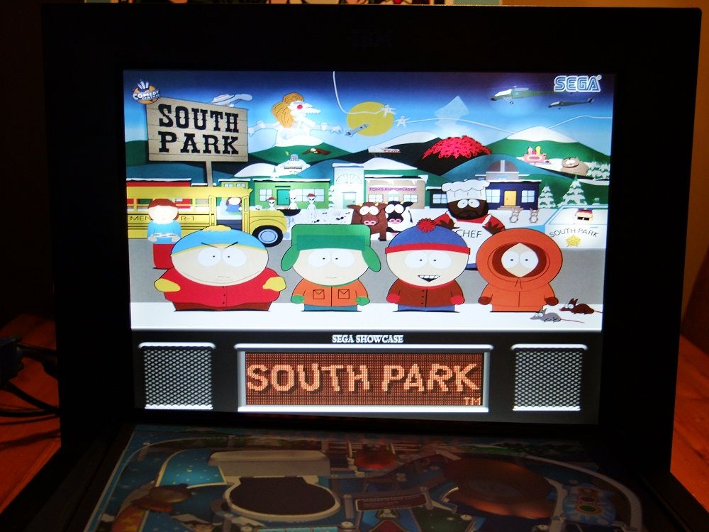

Hello guys,
I'm just in the middle of grabbing some parts together for my Mini Pinball slash Arcade Bartop machine.
Did some tryouts on my main pc and later on on my mini pc, and I'm hooked to the fine details of those virtual pinball tables .....   :banghead:
My journey with the Popeye bartop was a hell of a ride, and it was the best that I could do, and after 3 nice bartops, you come to a point, what can I do more ore better to challenge me again, except another color or artwork   :dunno
So it's a new challenge to build a mini pinball machine with a arcade machine in it.. two in one.
Here are the first pictures of this new adventure  creeper
Just in testing phase if everything is running fine.
I got a strong feeling that SouthPark is going the theme of this project....   :laugh2:
Things to do before I start with the woodworking progress:
Running Mame and vpinbal in the same frontend. Now I run Hyperpin, hope to start the mame also in that one... just to find out.
Some experiment with the controller   >:D

Lost a lot of time on shopping today, but I got everything to finish this one.
Only the backdoor of the top need to be done and cut the plexi and aluminium.
Did some testing if it's working  :creeper:
See you

  • What are the specs of the PC you use to run this?
  • The sides look like 18mm (or 3/4"), what material thickness are you using for the rest?
  • Were you so lucky that the visible width of the backglass monitor was exactly visible playfield monitor height plus 2 x material thickness?
  • How is the painted lockdown bar handling sweaty palms?
  • Do you have any internal pics?
Hi Sho,
Sorry for the very late answers  :angel: I was very busy with building a kitchen en painting doors and all kind of crap you came across when a son buys a home  :cheers:
What are the specs of the PC you use to run this? : AMD A8-6600K 3.90GHz FM2, Asus PCI-e Radeon HD6670 1GB, Crucial 1x8GB, DDR3, PC12800, CLI9, Ballistix Sport, Gigabyte GA-F2A88XM-HD3 AMD A88X, SAT600 RAID, Seagate Harddrive 3,5" 1TB, Sata600, 7200rpm
The sides look like 18mm (or 3/4"), what material thickness are you using for the rest? : All my build I use for the sides 18mm and the rest is 12mm MDF.  Works for me  :cheers:
Were you so lucky that the visible width of the backglass monitor was exactly visible playfield monitor height plus 2 x material thickness? : No, that was no luck, there was a lot of planning and lurking for the right monitor. Fist I had a 15"backglass monitor, but that was to small for a non bezel frame, so replace it for a 17 and the playfield 24". And after that I could made the slots for the side panels to create the none bezel look.
It feels better to have a non bezel look for this, otherwise the whole thing became a lot bigger and you got large aluminium L strip to cover the monitor frame, and that's what I don't like  :dizzy:
How is the painted lockdown bar handling sweaty palms? : For now it still holds  :cheers: There is a lot of primer, filler and paint on it, so it HAVE to stay good  :laugh2:
Do you have any internal pics? : Not for now ;) but if you want some special screens, I could make some if I find some time for it.
