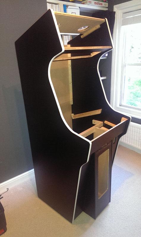

« Reply #47 on: March 30, 2014, 03:07:10 am »
It’s standing!
So I finished the remaining panels and laminated those. Added the furring strips and did a dry build to make sure everything fits as it should.
I’m pretty happy with the way it looks so I’ll take it apart and glue it together properly and then start mounting the electrics - then its onto the two control panels.
I still need to prep the control panel overlays for printing and finalise the design of the marquee but it definitely feels like the home stretch now.

So it’s been a while since I’ve done an update - mainly because there was nothing to post as I was kinda stuck working out how to redo the coin door panel. Anyway, after a few false starts I eventually found a nice way to rebuild the front which would be stable - so on with the update…
Coin door panel v2
I ended up having to rebuild the base of the cabinet to have an extra protrusion in the bottom so the new coin door could be secured to it as only using the sides wasn't going to be strong enough.
That done I recut the pillar which contained the coin door and admin panel and secured that centrally to the base and an equal distance to the sides.
Once that was done I then recut the angled sides (one with the gun hole) and secured those to the central pillar and sides as well.
Happy with how it was looking I then laminated all the pieces and did the final mounting the rest of the cabinet
Even though this was loads of work I’m much happier with the base now as it looks more like a real cab - as a side effect it’s also more stable too - although it was pretty stable before I don't know how well it would have handled a two year old wannabe mountaineer hanging off the control panel…!
