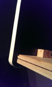

Well I was hoping to be able to show the laminated sides but I completely screwed it up. Used contact cement and a roller but the glue kinda fluffed up and when I put the laminate on it went on bumpy. It’s only slightly bumpy but I know it will annoy me every time I look at it so I’m going to redo it. I won't share the words I used at the time but just goes to show that you should always have a few practice goes first!
Since then I’ve chatted with a guy that used to laminate for a living and he’s given me some pointers which have definitely helped.
Anyway, in order to keep the momentum going I decided that I’d so some smaller pieces and laminate those to get my head around the process before continuing with the sides.
The Speaker panel
Whilst I showed the speaker box before I didn't have the panel that it was going to mount it in so made that. It’s a fairly simple rectangle with a hole in that holds the speaker box.
The speaker box itself will be covered with speaker cloth and then the panel will be laminated. If it sounds over-complicated, it is. When I designed it, it made sense but the pics should show you what I mean.
And the laminating worked quite well this time :-)

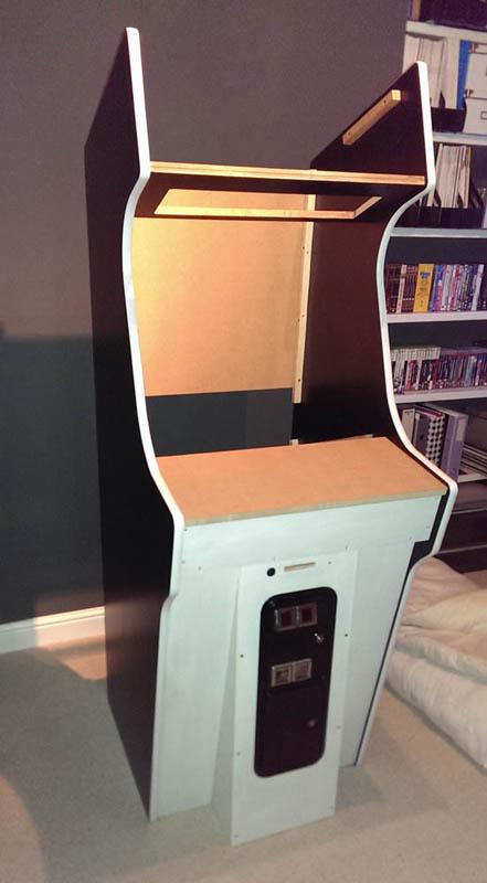

It’s standing!
So I finished the remaining panels and laminated those. Added the furring strips and did a dry build to make sure everything fits as it should.
I’m pretty happy with the way it looks so I’ll take it apart and glue it together properly and then start mounting the electrics - then its onto the two control panels.
I still need to prep the control panel overlays for printing and finalise the design of the marquee but it definitely feels like the home stretch now.

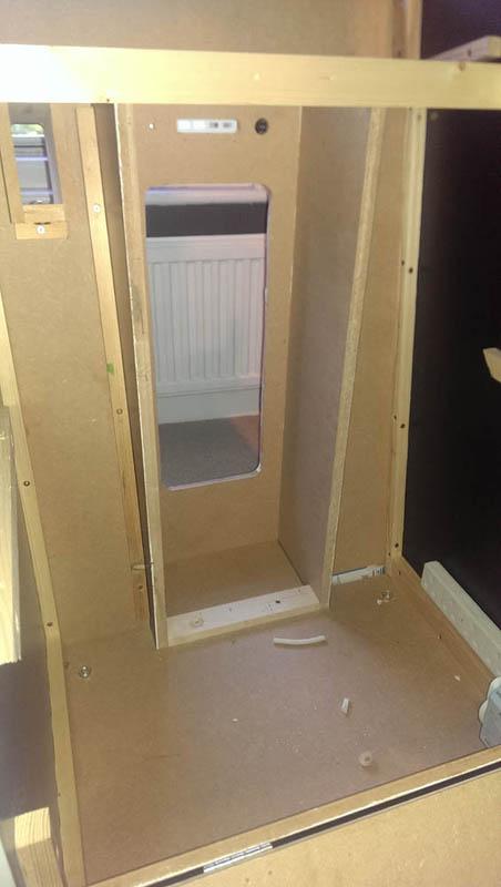

Major screwup with the coin door
I cant believe I missed this. When I had the cab standing (but not glued) I was test fitting everything to make it all went where it should and I put the coin door in to double check it wasn’t too low or anything like that.
So I put a couple of coins in and it immediately jammed. None of the coins were falling into the coin box and I realised it was because the coin door panel is at a 10 degree angle which means that coins can’t slide through the mechanism properly.
Bah. So went back to the drawing board and came up with this.
Ah well - better to find out now than when it is glued together. Still kicking myself though!

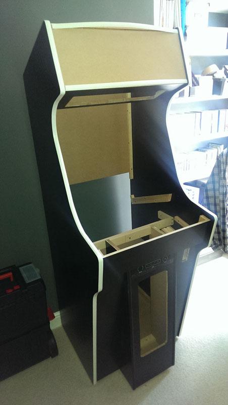

So it’s been a while since I’ve done an update - mainly because there was nothing to post as I was kinda stuck working out how to redo the coin door panel. Anyway, after a few false starts I eventually found a nice way to rebuild the front which would be stable - so on with the update…
Coin door panel v2
I ended up having to rebuild the base of the cabinet to have an extra protrusion in the bottom so the new coin door could be secured to it as only using the sides wasn't going to be strong enough.
That done I recut the pillar which contained the coin door and admin panel and secured that centrally to the base and an equal distance to the sides.
Once that was done I then recut the angled sides (one with the gun hole) and secured those to the central pillar and sides as well.
Happy with how it was looking I then laminated all the pieces and did the final mounting the rest of the cabinet
Even though this was loads of work I’m much happier with the base now as it looks more like a real cab - as a side effect it’s also more stable too - although it was pretty stable before I don't know how well it would have handled a two year old wannabe mountaineer hanging off the control panel…!

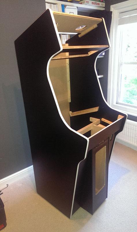

A fairly easy one this after all the shenanigans of the front panel. The back panel is in 3 parts, the bottom houses the intake fans and the power inlet, the middle panel is the door which is hinged from the bottom and the top panel simply fills the gap at the top. I don’t need to provide too much access to the top from the back as the monitor slides out the front.
Power
Another simple update - I wired up the IEC socket to go directly to a single plug socket - in this socket is an Intelliplug which basically turns on all the other sockets when it detects power going into the master socket.  The plug only comes with 2 extra sockets and I needed 3 (marquee light, TV and AimTrak recoil power supply) so I wired up a 4 way extension.
Marquee
Whilst on a roll I then did the marquee - I did this by cutting a notch in the speaker panel and top panel which will be used to hold the perspex. The perspex will be held in place with t-molding.
I’m currently using a spare MDF cut-off in place of perspex as I wanted to triple check the size before ordering the perspex for this marquee and bezel.
