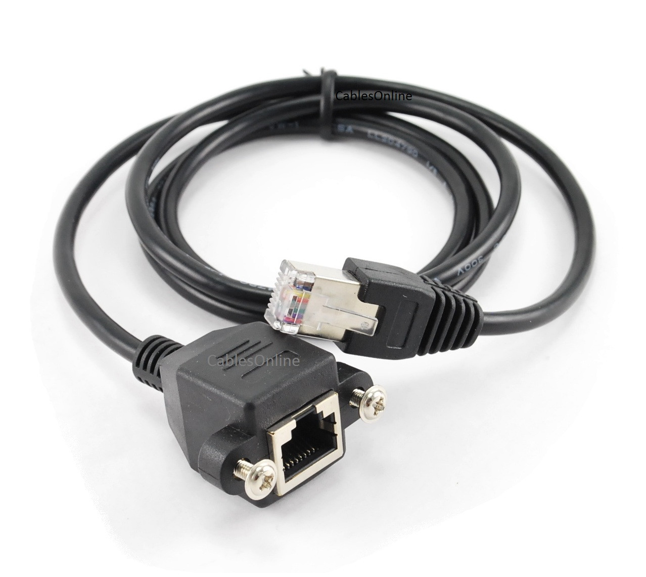

The buttons wiring harness for the back part of the CP can be disconnected.  These connectors were sold as RC car battery connectors.

I hadn't originally planned for this cab to be connected to the internet, but got into Steam and changed my mind.  To avoid having to mess with any extra wiring outside the cab, I installed a powerline adapter that transmits the signal through the electric cord.  It didn't work so well when plugged into the power strip, so I installed a splitter before the power strip.  Seemed to be working good at first, but then got flaky.  It turned out to be a software issue caused by me disabling services, but before I figured that out, I made this nifty Ethernet port (I don't like the looks of the neutrik ones):
Started with a panel mount extension:
Grinded the sides off of it:
Until it fit in a cut up power inlet from an old PC:
JB welded in place from the back, then topped off with liquid electrical tape in front.  This turned out to be a mistake.  I thought the liquid tape would pool and make a shiny black surface.  It kinda did, but not as smooth as I thought it would be.  It would have looked much better if I'd filled with bondo and spray painted.  Since it's on the back, I don't care enough to redo it. Still need to pick up some mounting screws.
