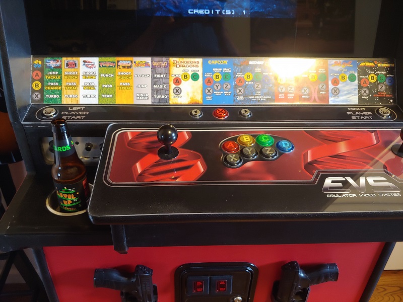

Joysticks: Sanwa JLF, SparkCE Optical Sensor, GT-C circular restrictor, Hand Candy balltops
4/8 way switching: custom built circuit to adjust voltage to IR emitters in SparkCE controlled by Pololu Mini Maestro servo controller
Buttons: Seimitsu PS14 KN 30mm Screw in Button for most buttons, PS14 D N K 24mm for navigation buttons
Interface: Hacked xbox360 fight pads for controls.   Key Wiz.  I went back to keyboard encoder for everything after updating to Windows 10 and having connection and order problems with the hacked xbox fight pads.

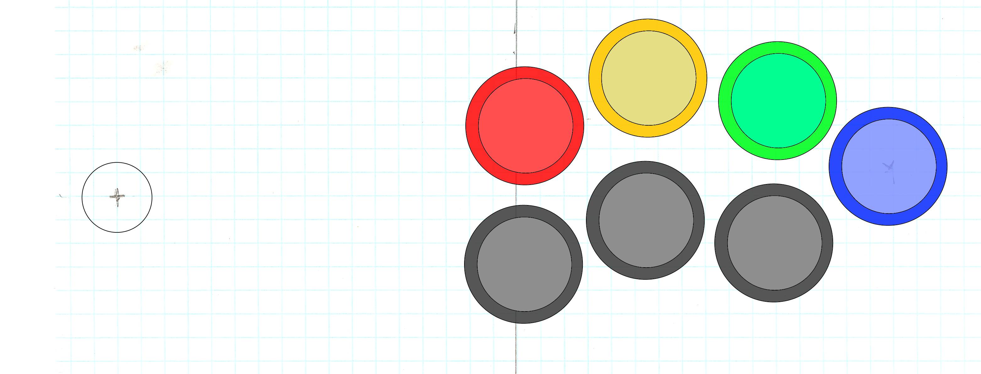

Button layout will be similar to a Neo 29:
EDIT: Tried it out and this button layout sucks as it is.  For Player 2, I rotated it counter-clockwise a bit and the top row feels awesome.
         Bottom row feels ok, but will probably be shifted left.  I'm amazed at how close you can squeeze these Japanese buttons together.

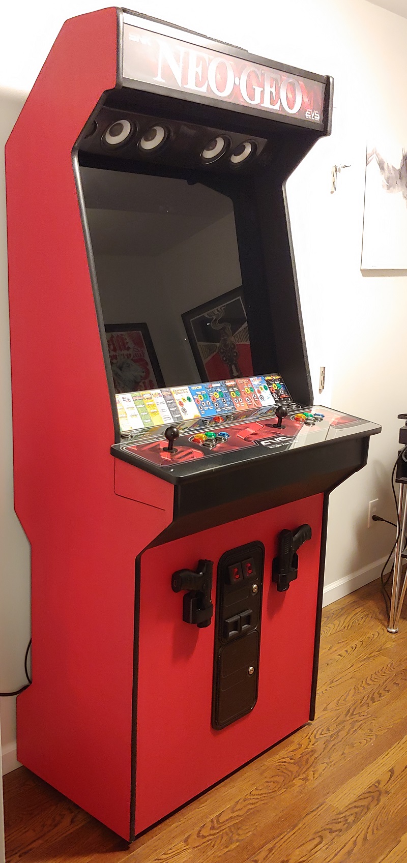

Cut the sides out today.  The original design forced the coin door to be mounted too low, so I modified it.
It doesn't look as balanced to me now, but I think it will look better once the CP is there.
I still don't understand what happened, but after everything else going smoothly, the router decided to climb toward the top of the panel instead of staying centered.  I have no idea what happened.  It didn't feel any different than it did going around the rest of the cab and the depth of the router didn't move, but somehow this happened (my camera decided to focus on the grass instead of the project):
It looks even worse after routing the correct path next to it.
Pretty horrible, but I had bondo glass on hand:
EDIT: Forgot to mention that after that, I was cutting down the center of a large piece of mdf on supported by plastic sawhorses and as soon as the cut was complete, everything fell in toward the center and made a big mess.  I had two sawhorses on each side, but I guess they weren't close enough to center.  When I went to make the next cut with the circular saw, I couldn't get the blade lined up, then realized that it was bent.  It must have hit the floor before the guard closed.  Good thing it was just a concrete basement floor.  No choice but to stop working and go get a new blade.  One of several points that I should have just stopped working at :timebomb:
Obligatory side panels against wall pic:
Got some of the non-angled panels cut too.  Here's an idea of the width:
This thing is becoming more of a beast than I'd planned.  Slim or not, 2 sheets of MDF is heavy.
It was originally going to be one player and just over 2ft wide.  It's now 32" wide to (barely) accomodate the rotation of the 27" monitor.
I measured a 32" lcd tv and it would also fit, but I wouldn't want to be that close to a 32" screen.
I'll post templates once I get this thing together and makes sure everything fits.

While waiting for that to set up, I fine-tuned the control panel layout:
The buttons in the top corners are Left Player Start and Right Player Start (will be printed on the artwork)
The red button in the center is Exit and the smaller 24mm buttons on each side of it will change the gamelist.
The top 2 inches of the CP will be inside the cab and will not move.
The rest of the CP will slide 8.5 inches to the right so that player 1's Left Player's controls are centered when playing vertical games.
(It won't be automated)
