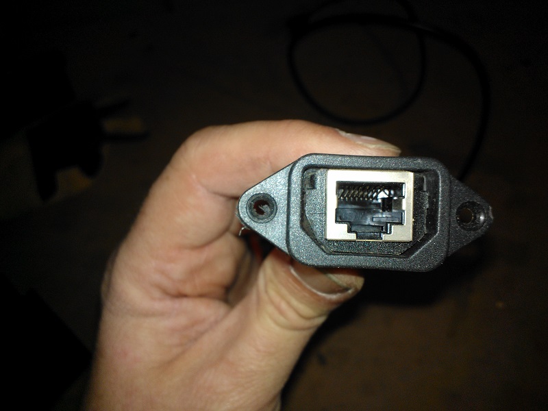

I hadn't originally planned for this cab to be connected to the internet, but got into Steam and changed my mind.  To avoid having to mess with any extra wiring outside the cab, I installed a powerline adapter that transmits the signal through the electric cord.  It didn't work so well when plugged into the power strip, so I installed a splitter before the power strip.  Seemed to be working good at first, but then got flaky.  It turned out to be a software issue caused by me disabling services, but before I figured that out, I made this nifty Ethernet port (I don't like the looks of the neutrik ones):
Started with a panel mount extension:
Grinded the sides off of it:
Until it fit in a cut up power inlet from an old PC:

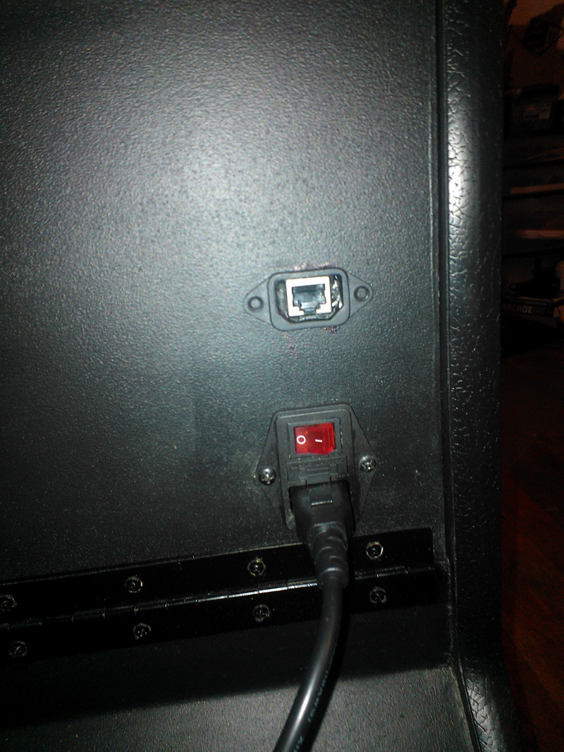

JB welded in place from the back, then topped off with liquid electrical tape in front.  This turned out to be a mistake.  I thought the liquid tape would pool and make a shiny black surface.  It kinda did, but not as smooth as I thought it would be.  It would have looked much better if I'd filled with bondo and spray painted.  Since it's on the back, I don't care enough to redo it. Still need to pick up some mounting screws.
(used a black sharpie to touch up the edges of the cut area.  Apparently I slipped.  I did not notice any of this before looking at the pic.  Guess I should run the paint roller over that area)

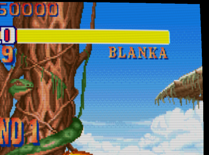

Been setting up HLSL separately for each resolution.  I'm finding that the theoretical best settings for the really low resolution games look like crap on a monitor this big.
Using pics of the real games on original hardware for reference, the results are pretty awesome:
My method is to find a section of the screen where the lines are easily counted and then make sure HLSL has the correct number of lines, then get the size and darkness of them to match.
I wish the curved edges of the pincushioned image were smoother and the corners were more rounded, so I might try to make a .lay overlay that has the look I want.

I like the usb in the old power entry idea. Will have to remember that one.
