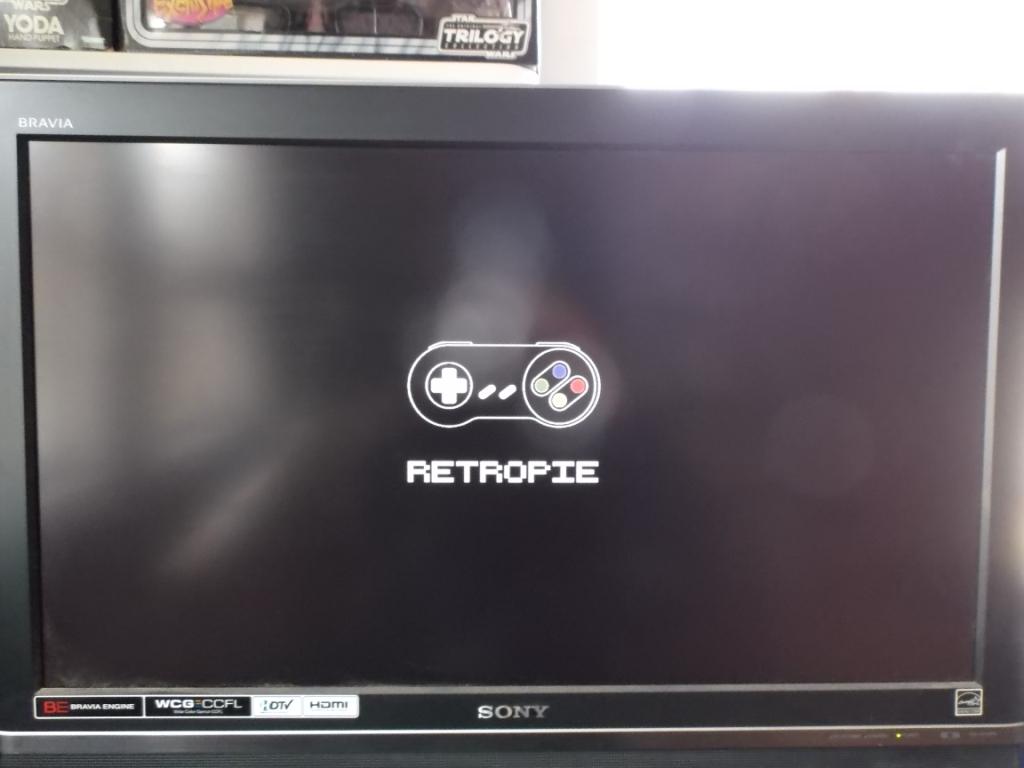

Here is a good video for setting up Retropie disregard the part about setting up the controllers, in Retropie 3.0 that is all taken care of in the initial set-up.

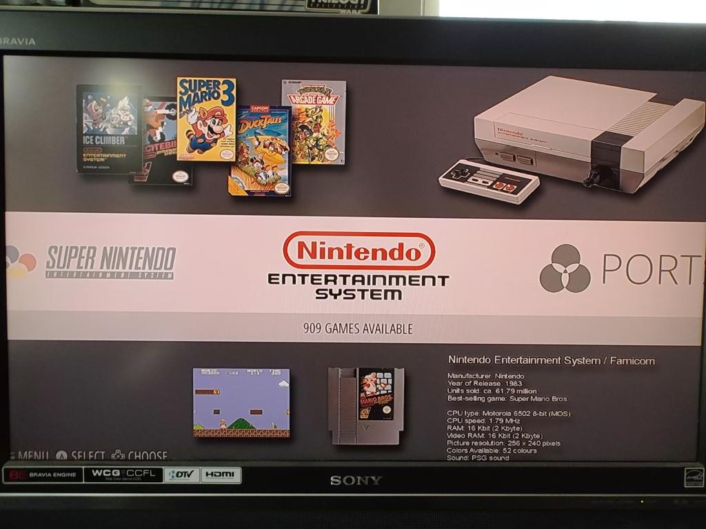

Once this is done you need to enter your ROMS. Since all my ROM files are located on my arcade machine, I used a USB-stick to enter them into Retropie. First you need to create a folder called retropie on the USB-stick and plug it into RPi. The first time you plug the USB stick into the the RPi, a ROM directory structure is generated on the USB stick, which only takes a few seconds. You can unplug the stick, put it into your PC and copy your ROMs into the corresponding directories on the USB stick. When you put the USB stick back into the RPi, the ROMs are automatically synchronized with the ROM folder on the RPi. When the flashing on your USB sticks ends (which indicates that no writing or reading activities are going on) you can unplug your USB stick
Once this is done you probably want to add a picture of each game and some information about it, to do this we need to do something called scraping. There is a scraping tool in Emulation Station but it is not very good, so don’t use it, instead follow this video
Now that that is done, you should be good to start playing some games.

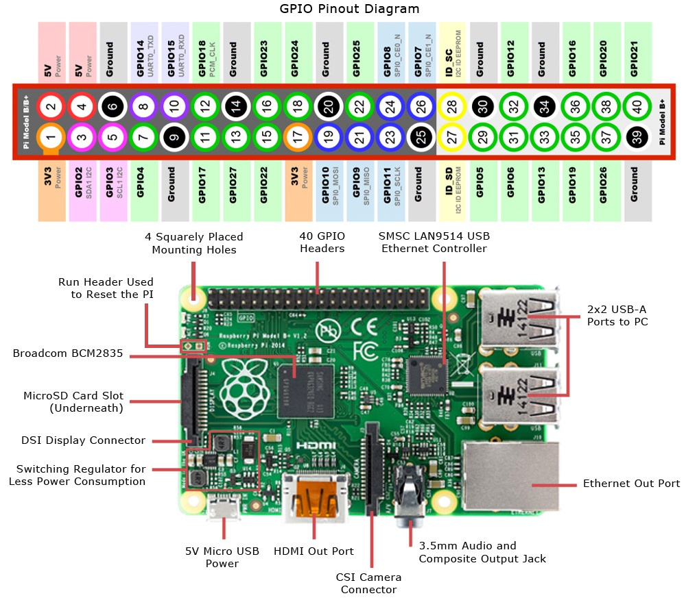

Next was adding the Mausberry circuit to the NES's original on/off button and the RPi.
You will not find any better explanation on how to that, than here http://forum.arcadecontrols.com/index.php/topic,147336.0.html
I thought it was a little confusing which pins to attach the Mausberry's IN OUT wires to because I didn't know which direction the RPI was pointing in, in relation to the Pinout diagram. The below diagram clears that up.

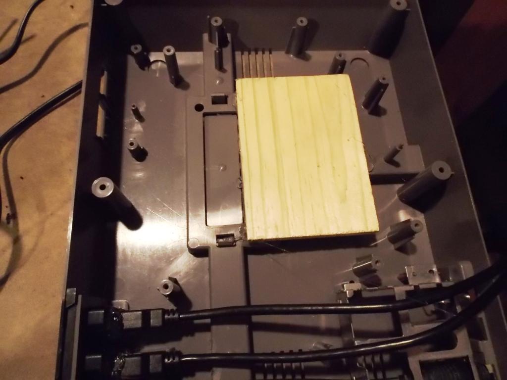

Like DaOld Man’s Pi-tendo I choose to use a broken NES Console as my Retropie gaming console.
Added a place to mount the RPi.

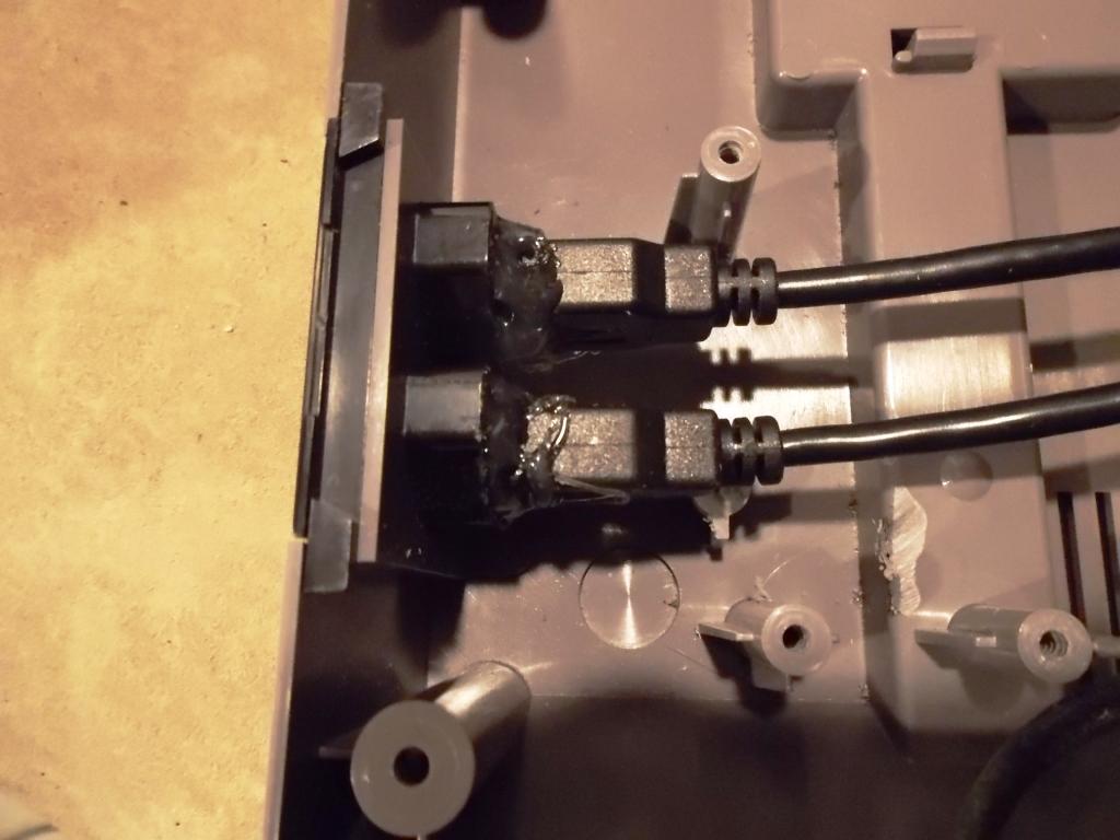

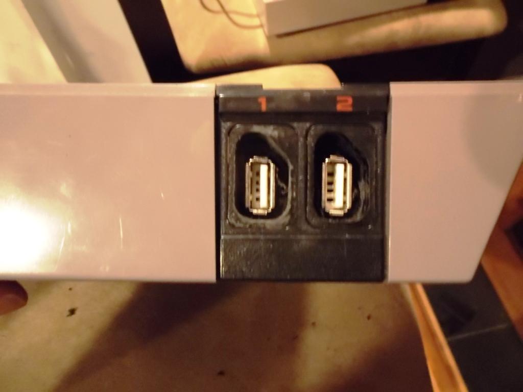

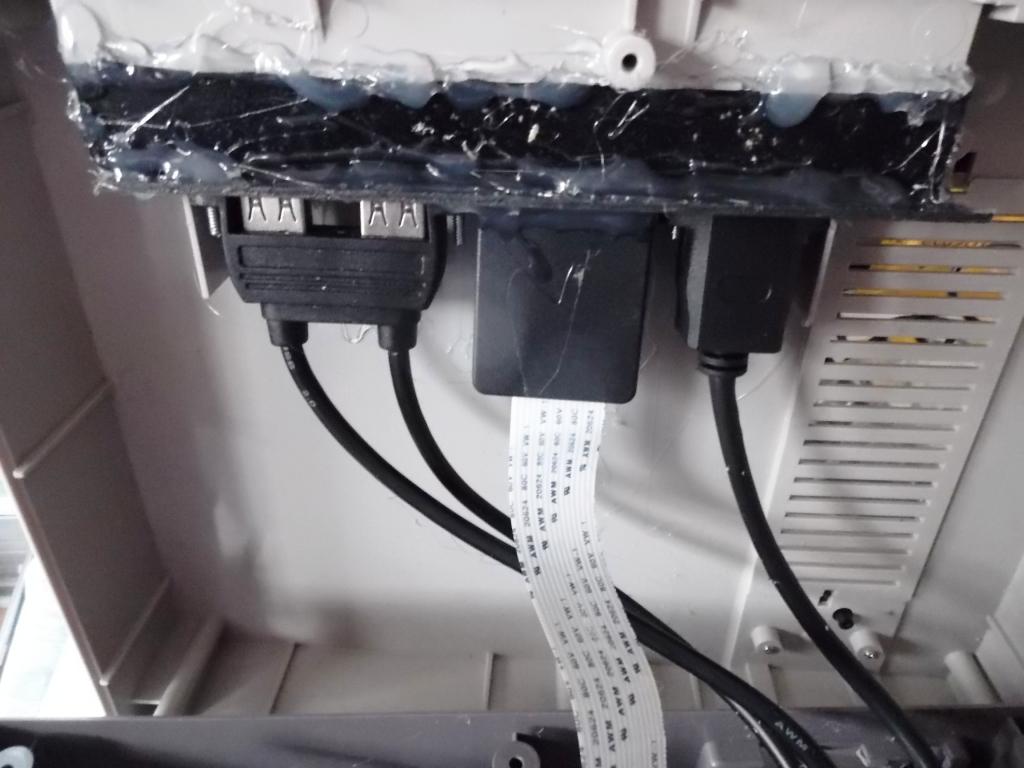

Since I was going to use USB Controllers I cut and grinded where the original controllers pluged in to fit a USB plug.

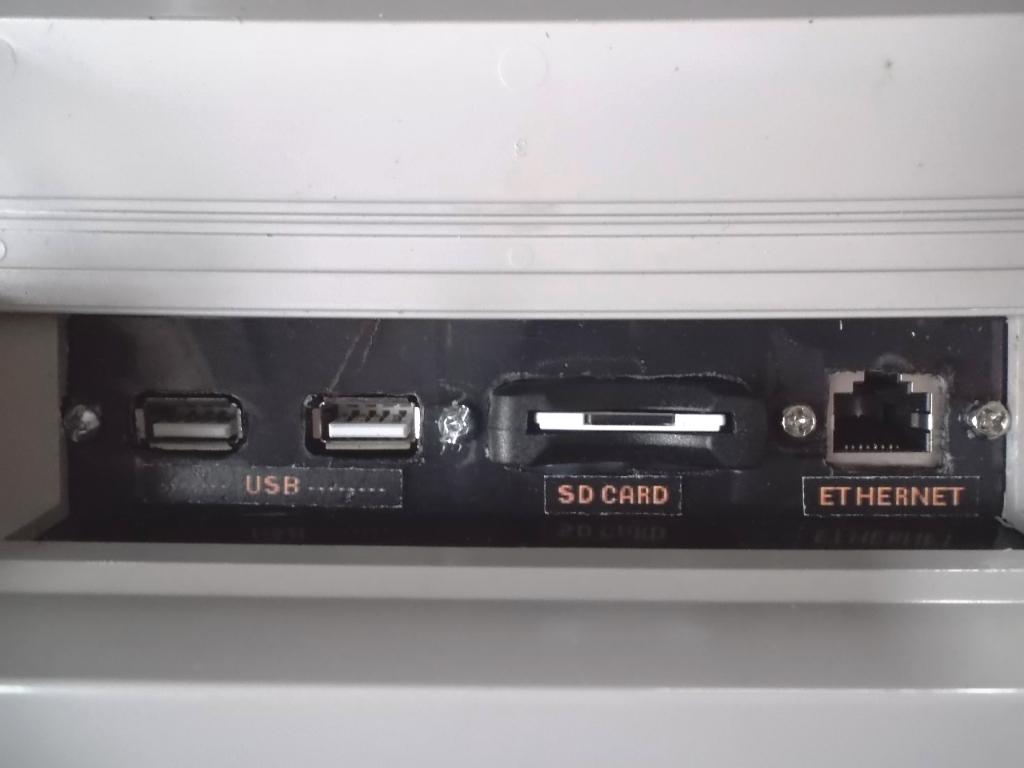

Next I created a panel for two extra USB connections an Ethernet connector and an SDCard connector that will be mounted behind the front flap.
It didn't come out as nice as I would like,(I used the wrong type of plastic) but since it would be very rarely seen, I decided I could live with it.

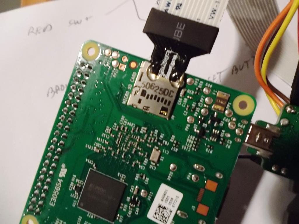

I didn't like having the SD Card buried within the console so I bought an SD Card extension and added it to that front panel. The one problem I had with it was, it didn't fit too securely in the RPi, so I just added a some hot glue to keep it in place.

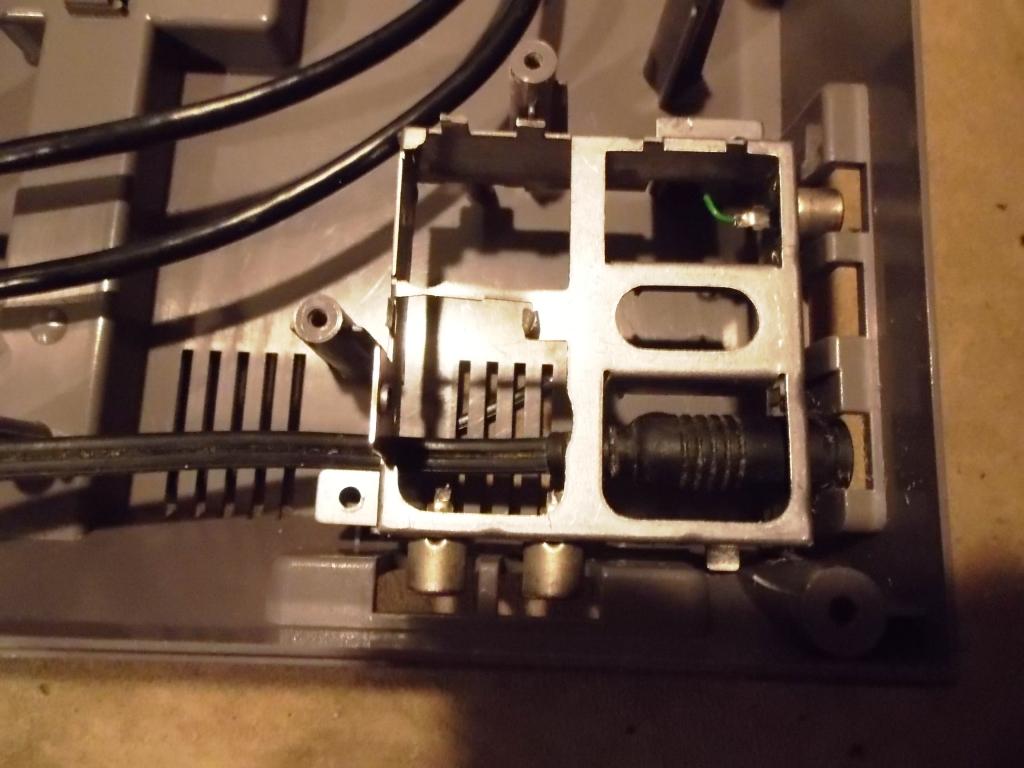

I wanted to use the NES's original DC connector, so I deconstructed board the held this connector, it also included the audio and video output. Here is what is left with the circuit board stripped away.
The original connector was a little short so I used one I had laying around.The barrel connector I had, fit perfectly in the original spot once I cut shallow slots on each side of the new connector and it helped hold it in place as well.

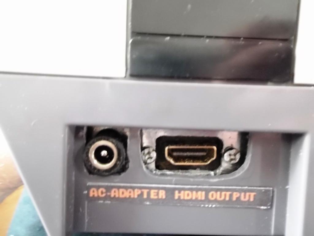

finally I added the HDMI connector next to the DC Connector. This required more cutting and grinding to get it to fit.

Are you using Emulation Station?
If so, where did you get those background pics? Pretty cool.

Yes, I'm using Emulation station, which background pics, the one of the controller or the Nintendo system? I like the sd card extension cable, it gives you easy access to the SD card and you can use a regular size card instead of the micro.

Yeah the background behind the menu, the last pic you posted.

That is just the theme I'm using, the default theme is carbon, follow these instructions to install new themes. https://github.com/RetroPie/RetroPie-Setup/wiki/themes I'm using zoid.

I had to install the binaries before I had the option to do that. (Thought I'd already done that, maybe it got lost in one of my screw-ups/start-all-overs)
I like the zoid one, think that is the one I will keep.
