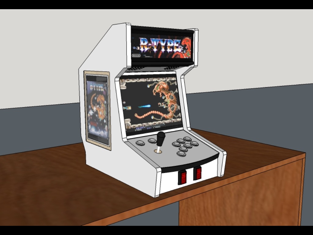

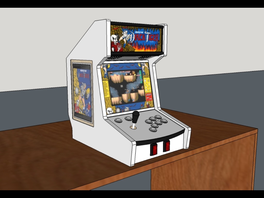

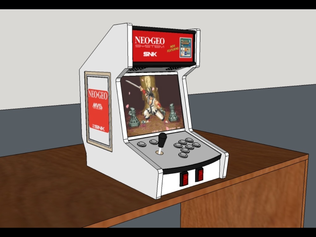

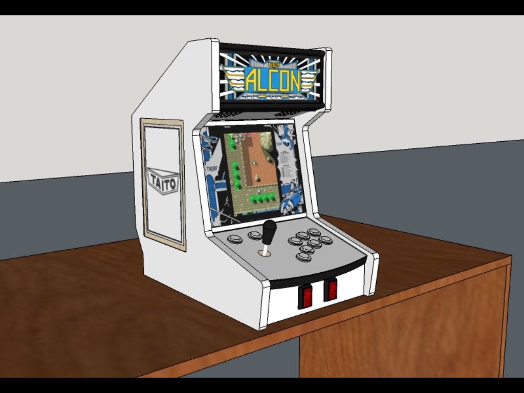

Introducing Dainamikade, a modular control panel, bartop arcade cab, that displays game specific bezel, marquee and sideart, dynamically, while playing and previewing your favourite arcade games (at least that is the plan).
Quick background...I built a CNC over the past year to build bartops for myself, family and friends http://forum.arcadecontrols.com/index.php/topic,131934.0.html. During the build, I became friends with Yvan256 (a member of the community and if you don't recognize his handle, here is his forum profile-http://forum.arcadecontrols.com/index.php?action=profile;u=19349) as he was commenting on the build, and had asked me to test his G-code program. So after a couple of months of back and forth messaging, testing, cutting, etc, I asked Yvan if he minded coding me a bartop. This benefited both of us as I could use his Sketchup expertise/g-code program and we could use my CNC to cut them out (for both of us) and test his g-code. If ever there was feature creep, this is it. What started out as a simple bartop turned into a 4 x LCD monster that not only displays marquee, bezel, and sideart depending on the game you play (hopefully), but will also have modular control panels, including 4/8 way joystick switching.
Unfortunately (cause I know you guys and gals love your pictures), I am starting this thread at the end of the prototype/build stage, however, because I like everyone on here so much, I am going to walk through every aspect of the final cab and its construction, from start to finish (with pictures), including all the software and programs we will need to run the 4 x LCD's. Here it is in its current state with the marquee and main LCD installed in mock sides for testing...
So first, the name: "Dainamikade", a combination of the Japanese word for dynamic, "Dainamikku" and of course "Kade" for arcade (and cause it will probably use Kades for the keyboard encoding). I think "Kade" can sometimes seem played out when attached to the back of a cab name, but in this instance, and in mine and Yvan's opinon anyway, I think it works well.
We started with the basic shape of the bartop I built for my god son a few years back http://forum.arcadecontrols.com/index.php/topic,121910.0.html, but quickly transitioned to an MVS styled cab do to the fact that the LCD we sourced for the marquee area was an almost exact match in size once we reduced the scale of a full size MVS into a bartop and also Yvan already had lots of Sketchup models of MVS cabs as he built (is building) his own MVS style bartop...MVS-99-6 http://forum.arcadecontrols.com/index.php?topic=94770.0.
We might as well work top to bottom and I can explain each item, why we chose it and provide links to those who might want to do something similar in the future.

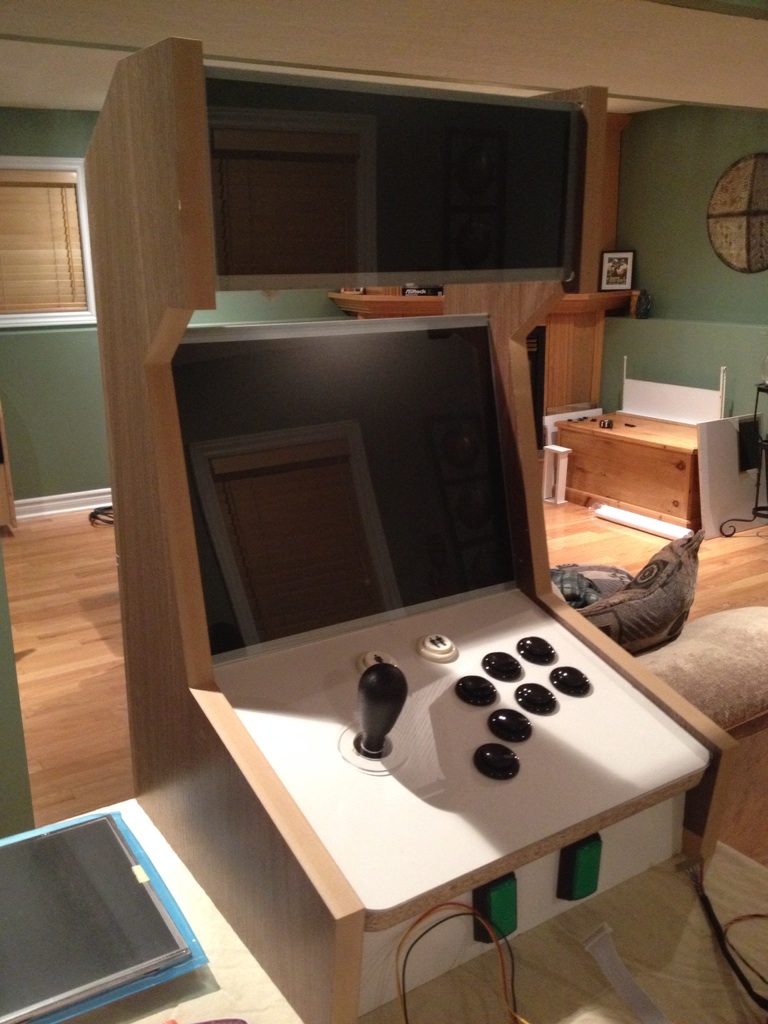

Here is a pic of a test pocket to hold sideart monitors. Monitor fits snuggly and plexi fits flush.
Next is full size cab side test and get all four monitors working (hopefully this weekend).

So, here is the fruits of a ---steaming pile of meadow muffin--- load of money and a whole slew of cables, adapters, LCDs and power supplies.
First time all four screens were fired up, the mouse cursor did a little dance around the screen and there was some noticeable lag, but after a restart, all seems fine now.
Initial impressions: Marquee LCD and side LCDs look fantastic...main LCD has horrible light bleed, but I can only notice it during start-up BIOs screen (all black) and looks good every other way (viewing angle, colour, etc...).
I will play around with it the rest of the weekend and see if I can get some images on side LCDs and a marquee or two.
