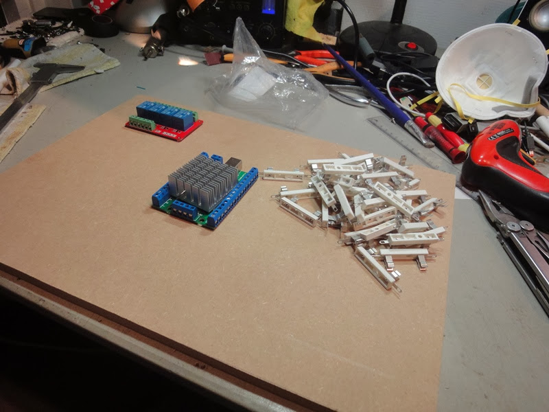

- 4-Channel 12V Relay Module
- Neutrik NC3FRX BAG XLR

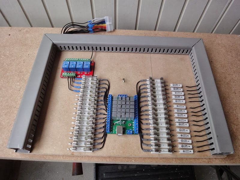

Assuming you are going to go down the Zeb's power board/LEDWiz route for contactors and LED drivers?
Because this is just "a"  32 inch sized cab, it wont have a dozens of  high power rgb leds or shakers or replay knockers.
No space and i am not such a enthusiast.
I was thinking along this guide and use 12 volt siemens contactors for some force feed back
Loving your work btw Maximus, very wel planned and executed.
I wont let you guys down in the way of, it will be the same old technique and resources  ;D

Typical VPin rigs use 8 contactors. One each for the the flippers, one for the bumpers on one side, etc etc. Also you can use a windshield washer motor to simulate the 'whirring' of rotating toys, a shaker motor and of course a knocker.
Contactors eh..........great, you just cost me $100.00 in more parts.   :o

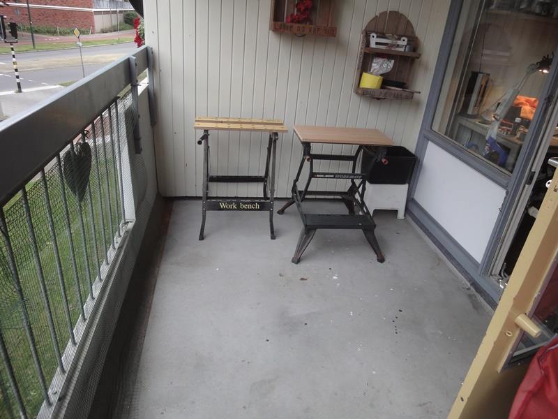

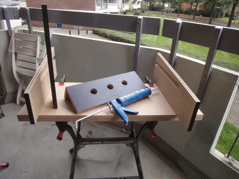

So after many hours of reading, understanding, designing and gathering parts i can finally start
Working space ready  :angel:
Woodworking !  :laugh:

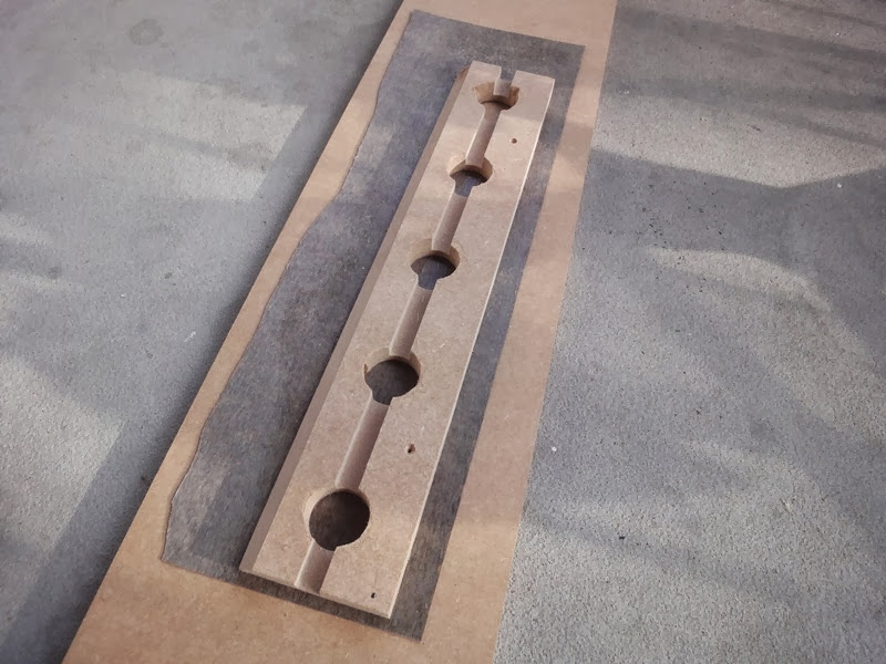

I started with the side

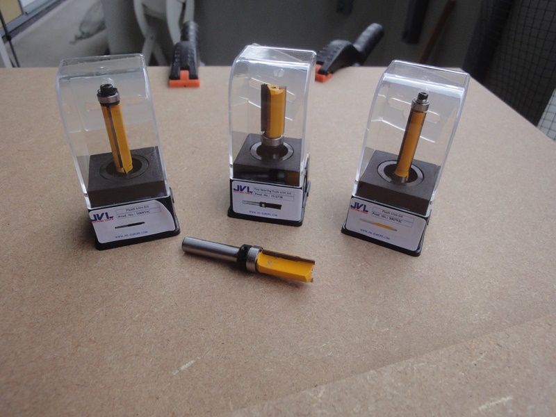

And some new sharp bits to help me out
When i finished one side and just placed it onto the second and copied it
And i cutted the lcd slot
Twins
Same for top lcd side panels
Thats it for today

Rick
  • Posts: 2801
    • Gameroom Designs Canada
Re: Pinball Cab - MultiBall Madness II [Upd 19 Sep. - Woodcutting]
« Reply #55 on: September 19, 2013, 11:13:26 am »
Did you happen to route into your workbench?
 :laugh:
Martijn
  • Posts: 822
  • Akira!
    • ModMyBox
« Reply #56 on: September 19, 2013, 12:09:44 pm »
Those are vintage, gives the bench character :P
I think those marks are from my jukebox build.

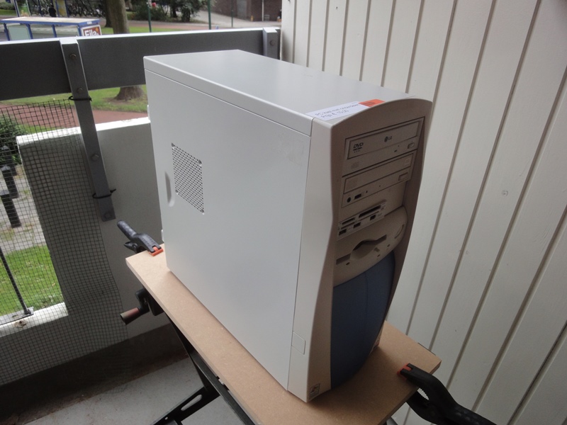

Today i did some electronics..
i picked up a free pc, seems to be a pentium 4.
i only kept what i could need
- dvd drive (for windows install
- floppy disc drive (could be handy if i go windows xp lite route)
- case (using this for the pc components
- on off switch wires (easy wiring to outside on off switch)
- cpu and motherboard cooling fan and blocks
Cutting up the case and painting it..

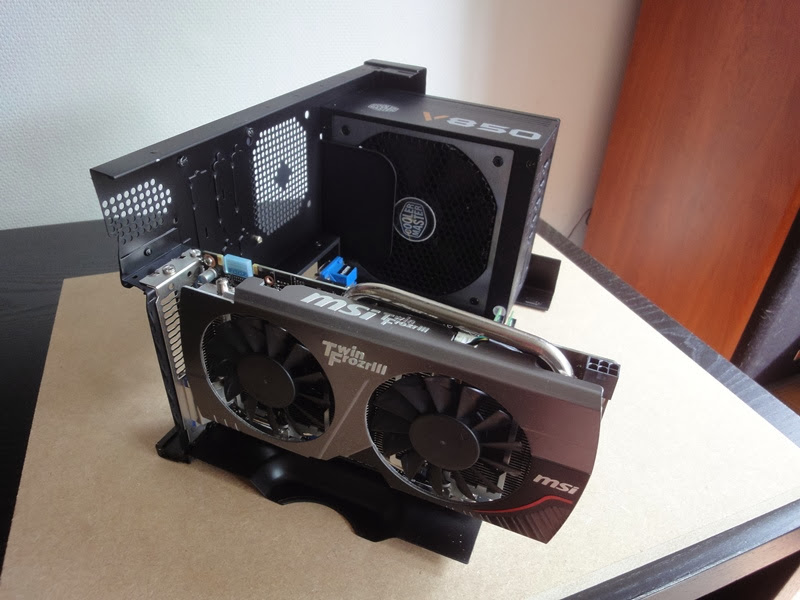

here is the pc part done mostly
Mounted the ssd on the case itself
That power supply rocks, its modulair build and has a 12v line of 70A!
Goldclass 96% efficiency. Should be enough to power everything.
Then i started on the ledwiz panel.

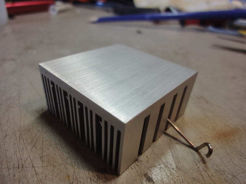

That cooling block from the mainboard looks nice to cool those chips on the ledwiz
Before
After
Then starting the primairy wiring..
Done for today
I used way to thick wire (AWG18), stripping/soldering/heatshrinking that was a time consuming

Art maybe , but i made a mistake, the fuses are bigger then the holder  :banghead:
When i insert them, they short each other out, i need to make space between them..
Or just solder the fuses on top of the holder, but then there is no point for the easy-clip-on-clip-off-fuse-holder

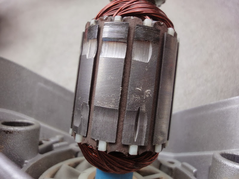

When i was using my router, it heard a rattle then the thing died on me.

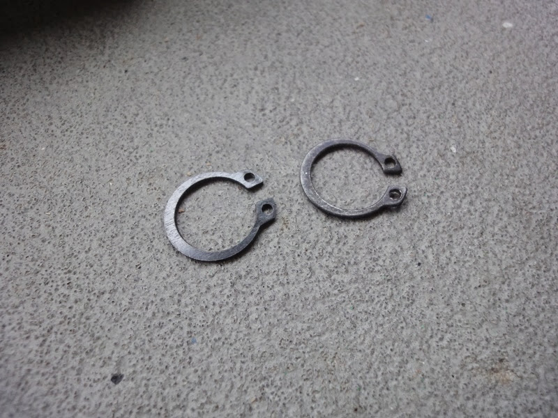

I took it apart and found 2 lose metal clips , which they have eaten away a bit of metal from the middle
Quite a big bite..
These 2 parts where the problem. i don't know where they are from..
I cleaned the whole router and put it back together without those 2 metal clips, and i seems to work just fine.
Any thoughts on this? Or should i get a new one..  :dunno
And i am happy that my circle cutting jig came in, its a Jasper 200J, not for sale in Europe
Gonna try this thing out when i made up my mind with this router
Buick455

Hey thanks, that helps allot  :cheers:, they seem to be holding the legs from going out of their sockets. Thankfully nothing important.
I was about to guess that!
Black & Decker doesn't seem to hold up anymore...
Nice build btw! Please document how you connect those subs!
It didn't let me down yet (Still happily married with it,  my first and only router  :angel:), i even think it was me slamming the springs back and forth a few projects back.

Just finished up my slot for the rgb ledstrip  :applaud:
Jealous at you cnc enabled people, but don't give up builders, with a steady hand we can accomplish similar result.
I was looking dread against this part, i only had one shot to get it right
I placed a panel on top to guide my router and went freehand to cut out the slot
Hooray  :applaud:
I am on the highway to hell  8)
Ill probably paint the inside black and then add the strip, it fits like a charm

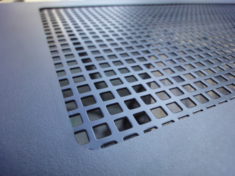

Made the grill out of a piece of aluminum and painted it
Ready for paint

Ok, here is a mistake i made, but i dealt with it.
Started working on the flasher panel, it will have 5 rgb high power leds. The ledwiz has a 500mA limit so they will be locked at a save 450mA with some resistors and fuses to protect the wiz.
Draw out the hole markers
Drilled 5 holes with t bit
But as you can see the last hole is ruined, because i didn't lock the bar hard enough, it warped and the bit went crazy. Also very dangerous..
I could remake the panel , but i thought to solve this differently.
I cut out a piece of laminate.
I placed the panel on top and cut out a correct hole
All smooth
Then glued the correct hole over the bad one
All good  :applaud:
goodbye bad hole  :angel:

I got my perforated aluminum from a local DIY shop (Praxis)

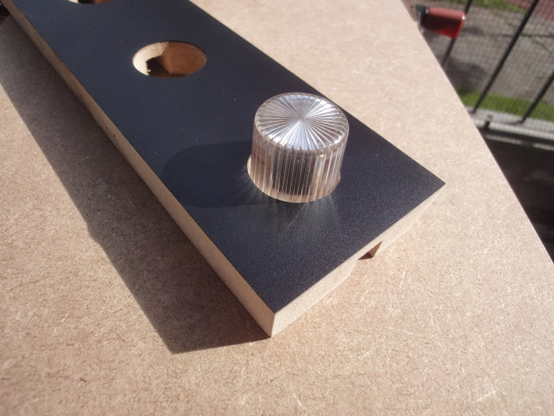

Little update, i finished laminating the front and sides, made flipper holes, finished the back latch and started on the backbox.
I removed the II from the titel, it was in the way on some parts of the artwork  :angel:
Added a extra bar for strength
Glued 2 pieces of mdf on the sides of the speaker grill, i forgot the hole wasn't big enough for the sub to fit in it, so i elevated it a little.
Placed the woofer on top, and screwed it fastened on the pieces of mdf below
Then added 2 extra metal brackets to add extra strength to the sub and the entire cab
Then started on the backbox
And thats how she is standing now..

Some more progress on the cabinet. I finished the bottom mostly, still waiting for the plunger kit. And almost done with the backbox. I have also installed hinges for the backbox, i was uncertain i would install them, the pinball cabinet is not that big and the top could be easily removed. But i went for it and cut the hinges up and mounted them , had some trouble with installing them, i forgot how wide the screw in part was, so i removed 1.5cm from the sides.
Cut them up and drilled new holes
Ready

I started working on the led flashers, i have 5 RGB leds in a row , they can get very hot and need a heatsink, so i cut up a cpu heatsink/
Cpu heatsink ready to get a new life
Cleaned it and drawn out the cut out plans
Chopping it up with my metal cutter, this material gets really hot !
Then drilling holes for screws to hold the leds
All done, backside of the leds have some thermal grease
Wired them up to a ATX connector
And mounted them
You need to have them connected to a connector because the cables need to be out of the way if you want to slide in the lcd panel
And i wired up the ledwiz some more, and added cable management sleeves

Thanks, i finished wiring everything inside and did a first ledwiz test to see if everything was done right.
Here are some shots of the wiring.
Those wire sleeves are really nice for managing
Here is a vid of my first ledwiz test.

Here a small log about the dmd creating part.
Dmd panel cut to size
I printed out a drilling template and glued it onto the final sized dmd mdf panel
Used the cirlce cutting jig to cut out a circle, not all the way through. because i wont want it to warp, i route out the rest with a copy bit.
Place holders onto the template
Route out the rest
Apply laminate
All done
Then apply the artwork, so you can route out the sticker inside, you can NEVER get such a smooth shave of the sticker with a knife
ultra smooth
Then route of the back for the lcd and speaker, leave 2-3mm of mdf dept left over
Paint the inside edge with a marker, clean up the artwork if it has some markings with some alcohol.
Pressing speaker grill and glued it in place
Done
