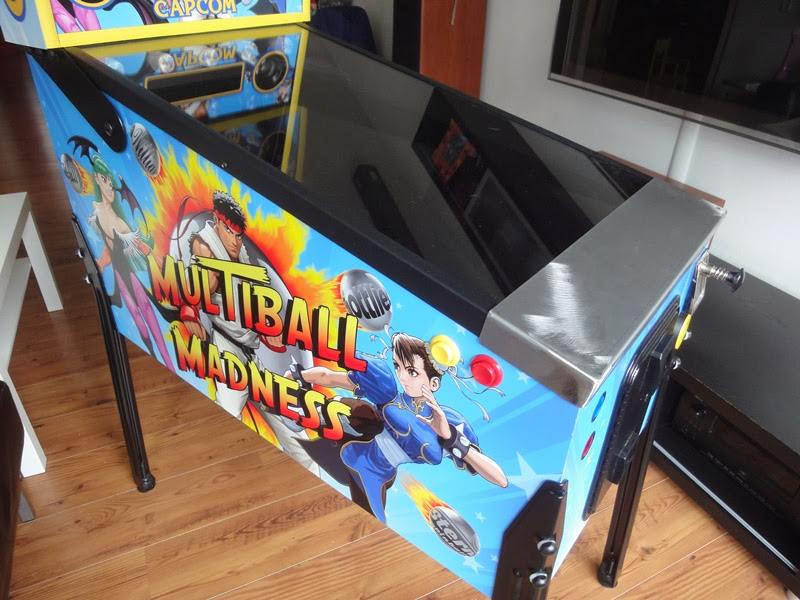

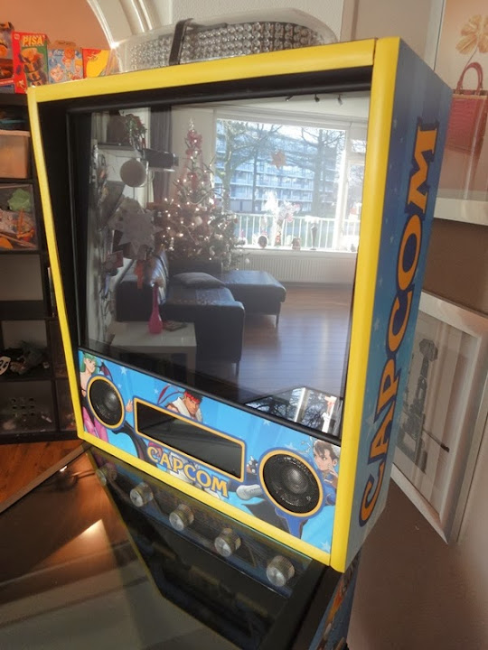

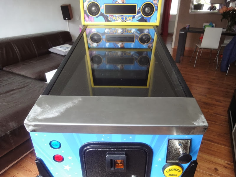

« Reply #127 on: December 25, 2013, 05:19:50 am »
Here's a xmas update from me, i finished all the woodworking, applied all the artwork and did most of the electronics.
Still need to do some wiring and cleaning things up inside.
I am still waiting for the custom lockdown bar, will get that next year.
Here is some eyecandy.

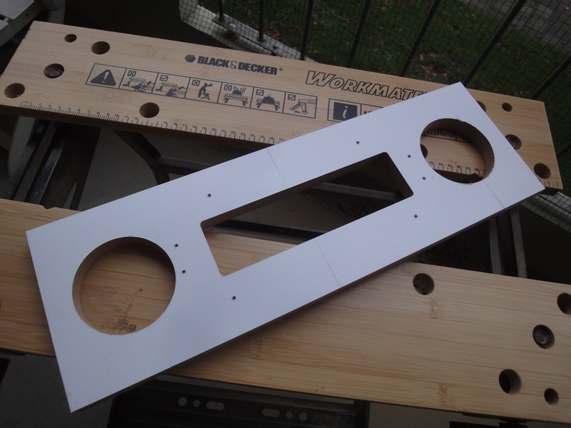

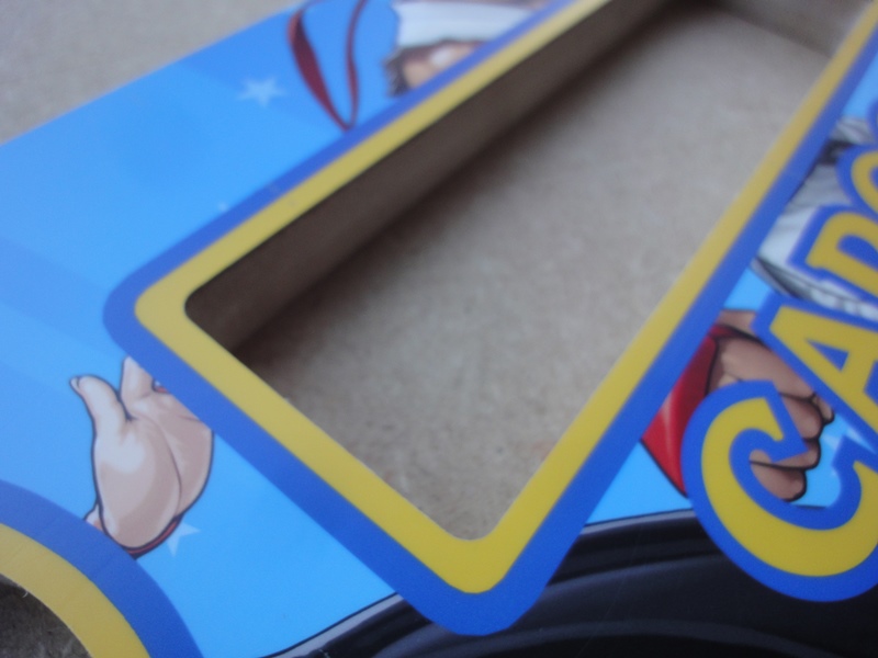

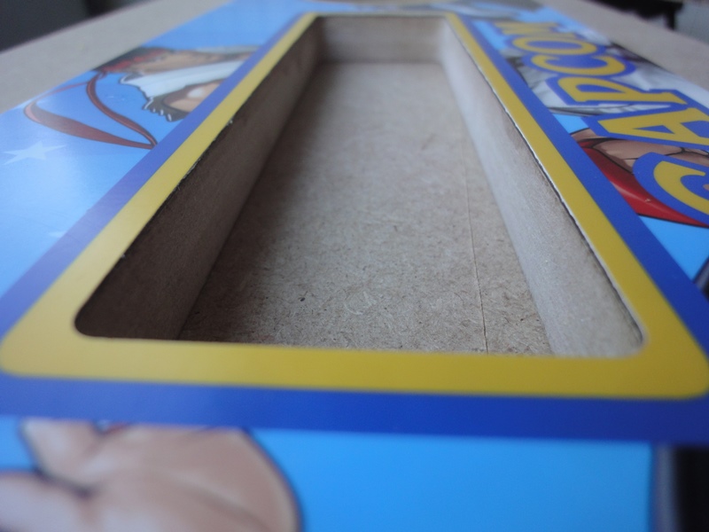

Here is a closeup picture of one side of the artwork. both sides are different, all the pinball balls have different logos on both sides.

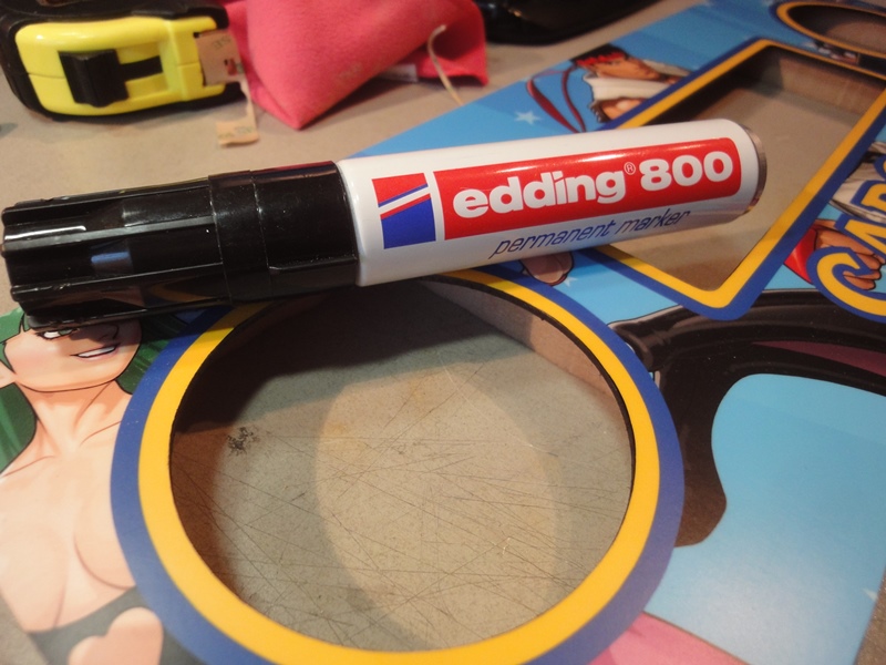

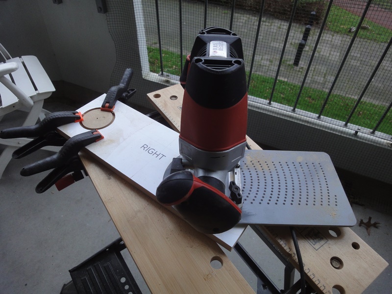

Here a small log about the dmd creating part.
Dmd panel cut to size
I printed out a drilling template and glued it onto the final sized dmd mdf panel
Used the cirlce cutting jig to cut out a circle, not all the way through. because i wont want it to warp, i route out the rest with a copy bit.
Place holders onto the template
Route out the rest
Apply laminate
All done
Then apply the artwork, so you can route out the sticker inside, you can NEVER get such a smooth shave of the sticker with a knife
ultra smooth
Then route of the back for the lcd and speaker, leave 2-3mm of mdf dept left over
Paint the inside edge with a marker, clean up the artwork if it has some markings with some alcohol.
Pressing speaker grill and glued it in place
Done

 :laugh: thanks, but this lockdownbar i didnt make. A dads friend works in a metal factory, he made the shape.
I sanded it down and then i went to a poadercoating shop of a acquaintance of mine.
Result  :applaud:  :applaud:
(work in progress pic of the bar)
Because of the structure, you will not see imperfections that easy, also i like how it feels when holding the machine. Plain black was to cold for me.
I mounted it with 3 screws, it fits so tight around the cabinet i almost dont need screws to hold it in place.
Well thats the end of this ride, the cabinet is 100% done hardware wise. Just more table configuring and fine tuning other software things.
Ill make a video soon  :cheers:
