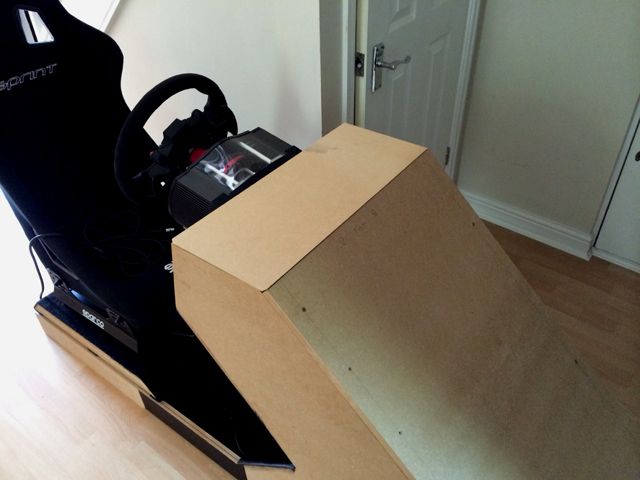

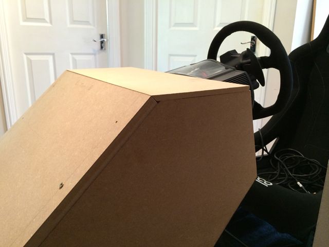

I will not be able to continue with the build for most of the weekend but I have free days today and Monday to make some progress.
A couple of panels have been mostly prepared this morning. This will not be screwed and glued into place fully just yet though.
As with the shifter pod, the angles will have sharp edges and will be wrapped in blackboard vinyl.

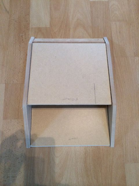

Almost done with the front panel basics now. One of the pieces is a couple of mm off (wehre the downward sloping panel meets the front-most panel) but that can easily be sanded back.

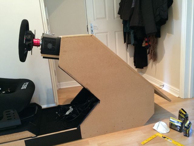

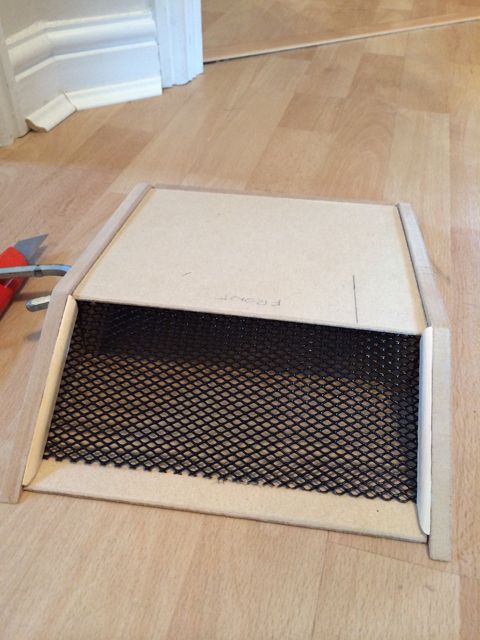

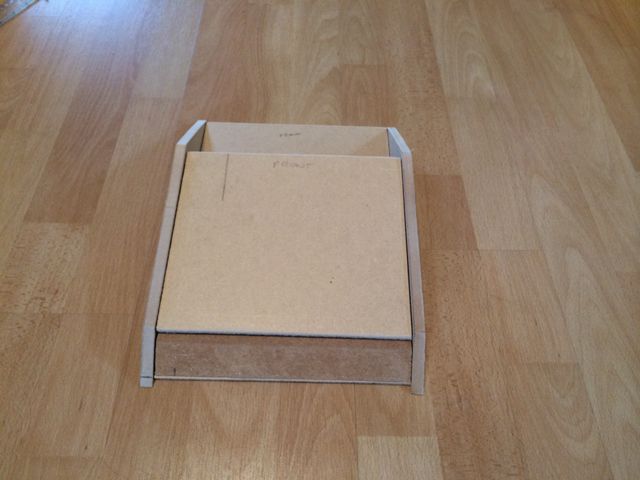

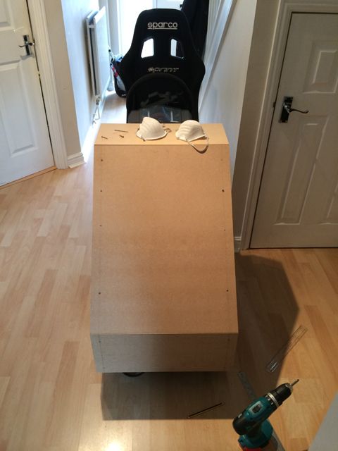

Air intake for the front of the pod. Loads of work left to do on it yet though and it's just balanced together atm.
Rear view:
Front view:
Side view:
Click a pic for a video tour
SpaceHedgehog
  • Posts: 937
  • Almost done ...
I decided to add some mesh to it. Lots of tidying up is required to make it look more integrated.

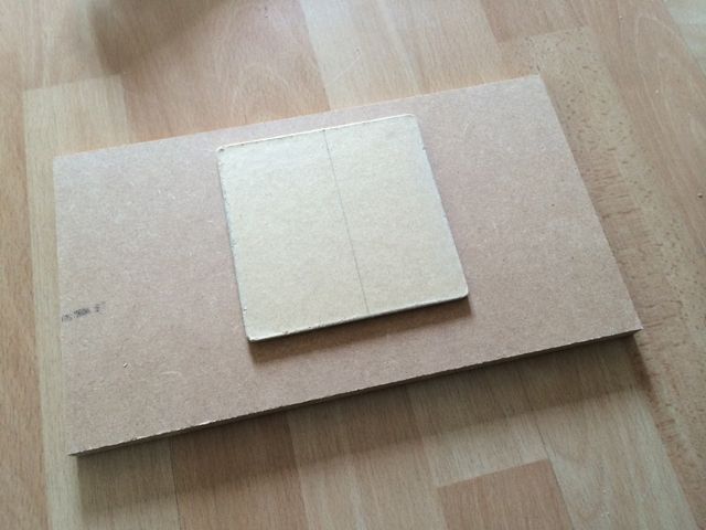

Just a little deviation from the main build whilst I consider the platform that this will sit on. I've located a material that looks like asphalt that I will be ordering shortly. This rubber is not cheap but is designed to be very durable (not that I'll need it to be particularly):
This will it on a shaped base:
This will sit on MDF with a thin wooden frame underneath that. White LEDs will be wrapped around the frame which will be set back from the edge to avoid the 'dot effect'. I will place the Magiglides under the frame to allow it to be moved around easily. I will also fit a switch on the dash to activate the LEDs. T-Molding will be used as an edging. I'm considering mounting a black handle on the diagonal to assist with moving it around.

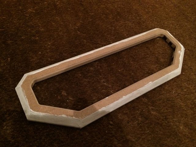

Grill shape cut and flush trimmed.
With tow hook:
I'll cut out the middle next ....

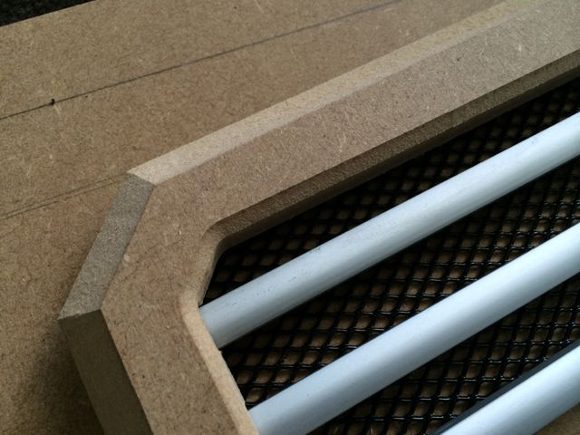

Finished up for the evening but worked a little later to make up for lost time over the last few days. The shaping for the grill piece is now complete. I will be inserting some aluminium bars into this provided I can source them tomorrow.
Guides attached to the back of the grill:
Trimmed and beveled on the inside edges:
Beveled on the outer edge:
Close-up:

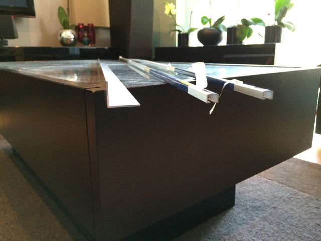

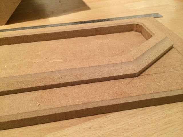

The hardware store had the items I needed - Aluminium strips for the grill and also some angled section for the 'door' kick plate:
I went for anodised rather than chrome as I didn't want something too 'bling'. Now to route out the recesses for the grill and cut the metal ...
SpaceHedgehog
  • Posts: 937
  • Almost done ...
The grill section is complete aside from filling in a few gaps, painting and cutting the black mesh to sit behind it.
Routed back with inlay for mesh and recesses for the aluminium:
Close-up of the recesses (over cut to give a bit of wiggle room to allow the bars to be lined up correctly:
Front:
With a temporary piece of mesh behind it:
It will look much better once it's painted black and the mesh is backed by grey vinyl.

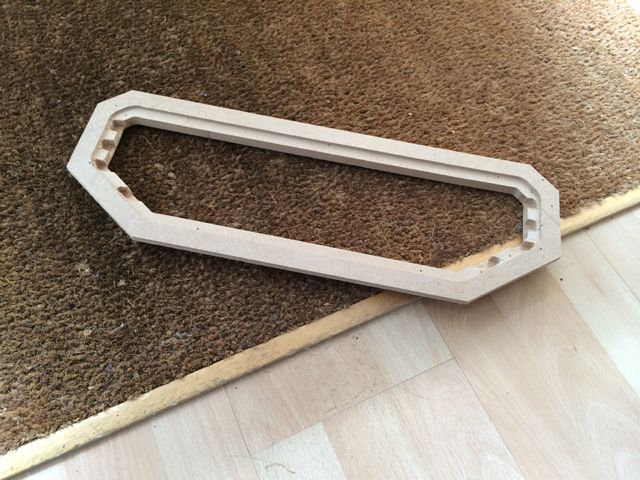

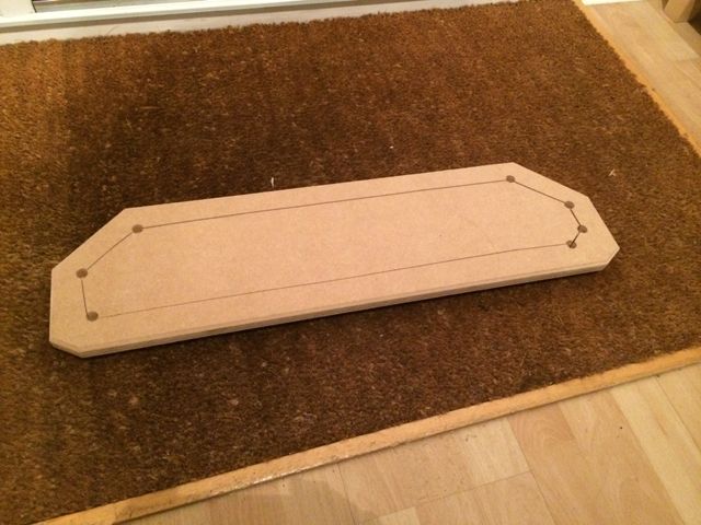

Side cut for the right seat base panel:
I will need to cut another piece out in 12mm MDF and then start cutting the windows out ....

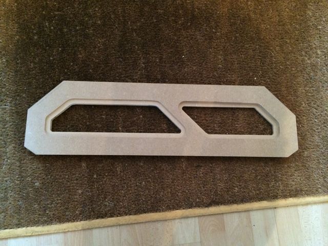

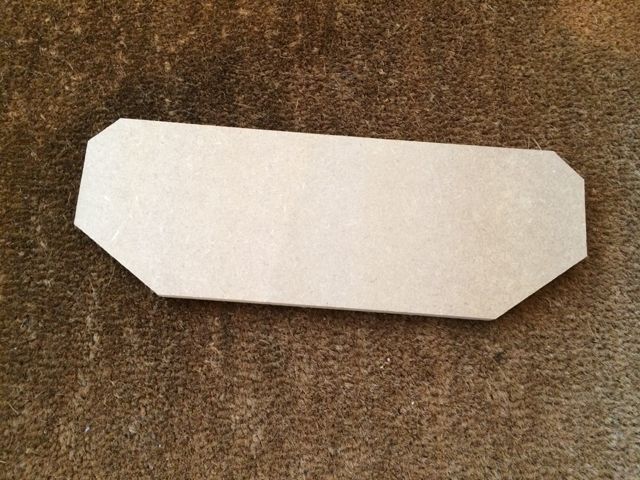

The second side piece has been cut and flush trimmed. Rough cut holes have been made for the windows. A more discrete logo for this panel with grill to be applied to the front-most window:
I like my projects to look solid as well as feel solid, hence the chunky cut approach with double panels (sounds almost edible ...):
Next I will nail the guides to the back and get routing.

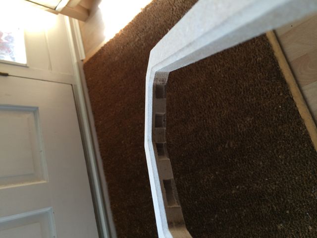

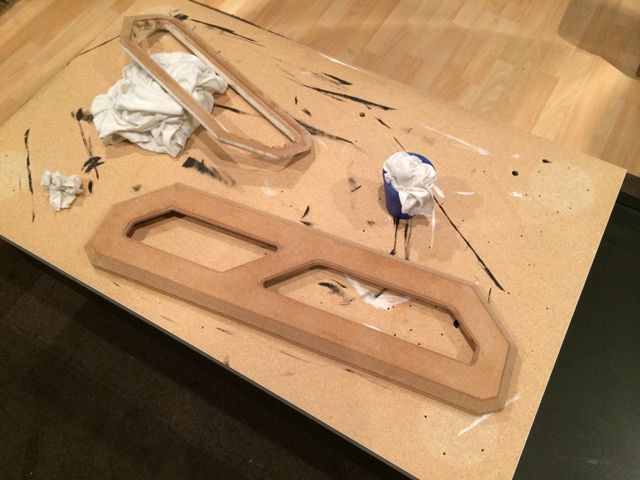

The seat side panel is nearly done.
Routed recesses for artwork and mesh:
Top panel beveled:
Side view:
Leaning on the seat base:

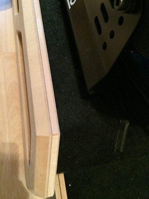

I made some simple kick plates out of angled aluminium:
I will add a strip underneath this to raise it a little so it better integrates with the T-Molding and also hides the MDF underneath the seat base.

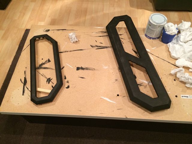

I was running low on Blackboard vinyl so ordered some more of that. Hopefully I'll be in a position to skin the front of the cab with it soon.

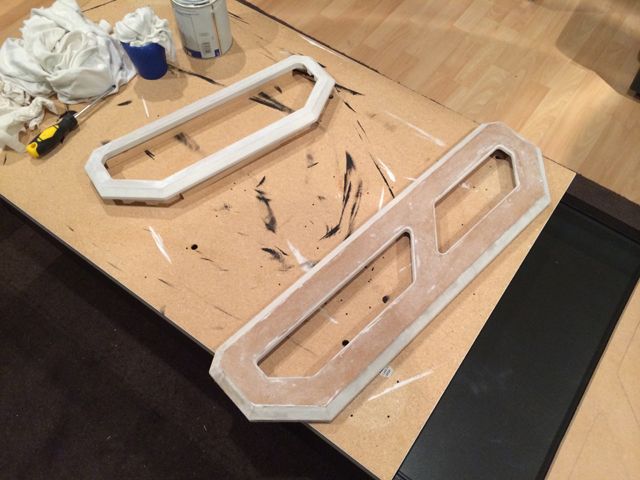

Just finished up filling the seat base panel and applying the first coat of primer to the grill section. A couple of productive weekday hours and I'm hoping to get the flat black paint applied on Friday after some more prep work tomorrow.
I need to consider whether I'm going to go for an engine bay under the air intake or not ...

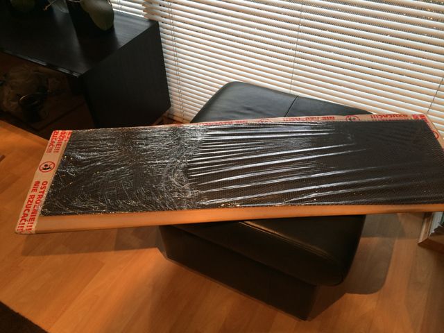

2 sheets of mesh grill have arrived (yum):
The grill section looks much better now it's painted:
