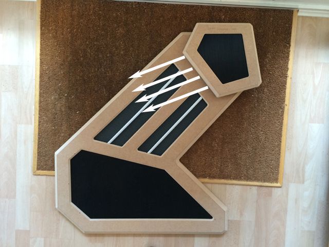

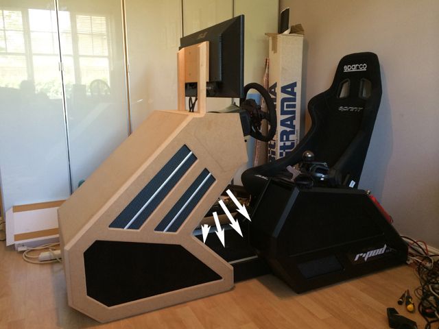

Like dis:
That does look nice Namco. I was very close to doing something like that (albeit smaller) as another section at the bottom but decided to go for a simpler styling.
I had this in mind when I was considering  the aluminium rod (not Lamborghini styling though):
I will be using carbon fiber though for the fascia on the dashboard.
I'm leaning towards one and one at the moment.

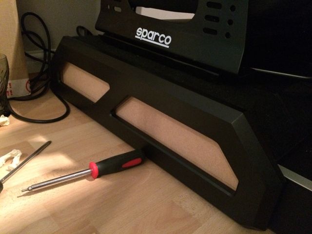

Firstly, I painted the visible areas with flat black paint:
Then I made some blanking plates which would:
-Raise the kick plate to integrate better with the T-Molding on the front.
-Add more protection to the side of the foot well and ensure that any foot scuffs wouldn't cause the vinyl in that area to peel.
-Tidy up an area visible between the kick plate and the seat base.
Blanking plates:
I covered these in vinyl for a good finish:
Close-up of the vinyl - I can't recommend this stuff enough, it has a lovely texture:
The section is now a lot tidier:
I will need to use epoxy to glue all these pieces in-place.

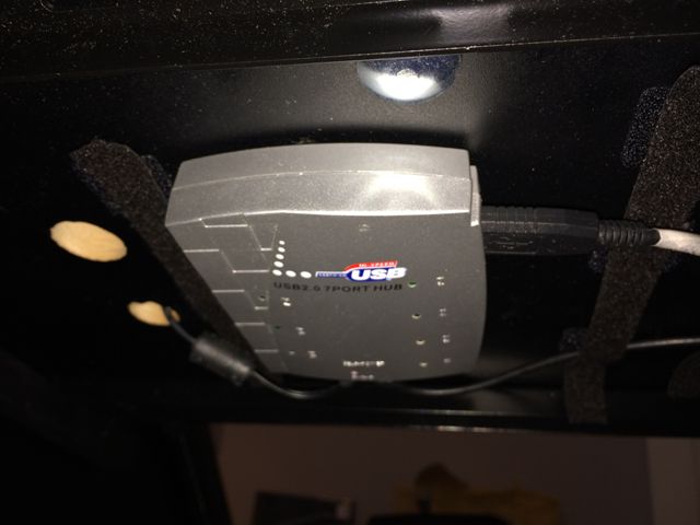

Make hinged drop down panel for 'glove box' - this is to hide the USB Hub under the wheel shelf

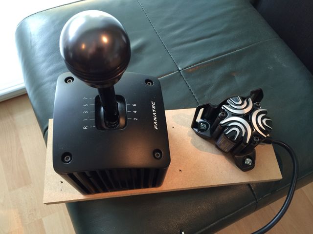

Cut new internal shifter / Buttkicker mount - needs to be a single piece for better Buttkicker effects
Wire up pedal and shifter Buttkickers - Only the seat buttkickers are operational at present

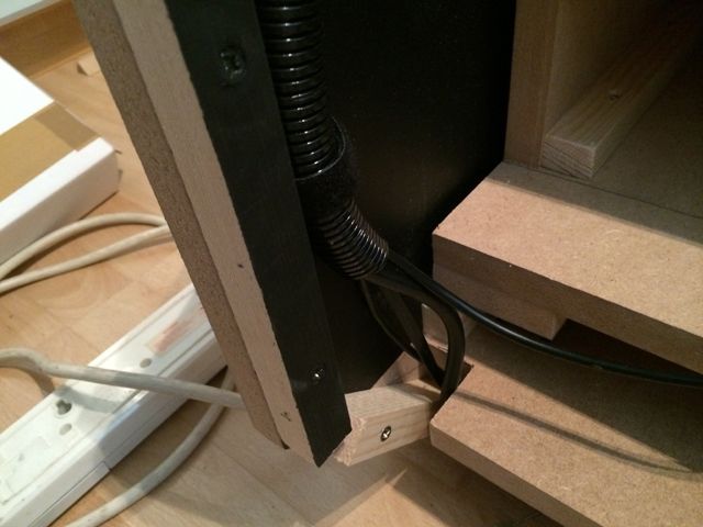

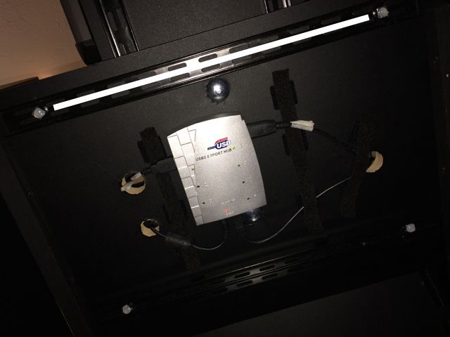

The ducting has been completed.
Pieces cut:

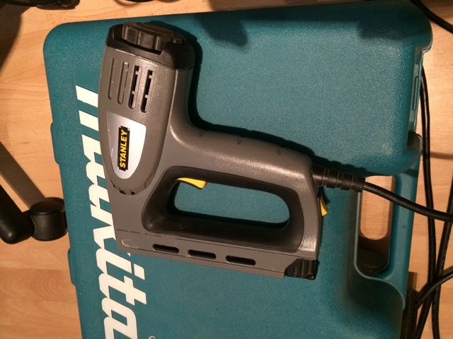

My friendly tool, the staple gun:
Velcro stapled to the inside and sheathing fitted:
Click a pic for a video tour
SpaceHedgehog
  • Posts: 937
  • Almost done ...
More progress. Velcro squares are being used to attach various things to the inside of the dash:
Power strip attached:
Main inside panel covered with vinyl:
And trimmed:
This will need to be cut further to allow me to glue and screw to the main frame.
The monitor mount has also been addressed (the cable hole isn't the tidiest but it's functional and will be covered):

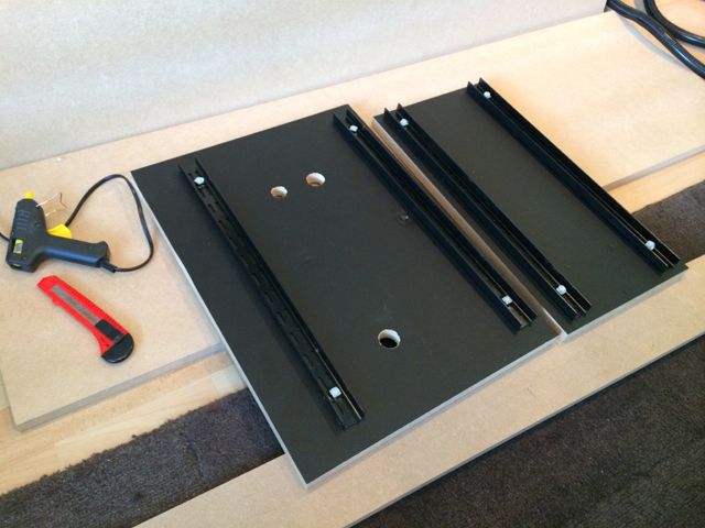

Wheel shelf and stem (inconsistencies are due to holes):
Bolts are hot-glued in place to prevent movement.
Some cable management:
Underside of wheel shelf:
Velcro strips to keep cables in place:
This will all be covered with a thin panel.

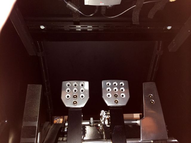

Internal shot - it's difficult to get a good picture:

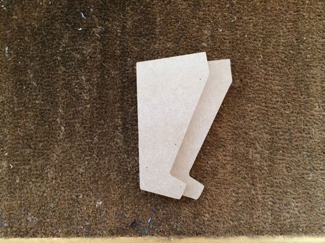

I spent a lot of today fitting and refitting, doing and undoing cutting and re-cutting. I'm beginning to feel that I'm on the final straight with this now as most of the pieces have had their final fit.
I cut a new shifter and Buttkicker panel ... incorrectly ... then made another one. It's easy to get frustrated when an hours work goes down the tubes but I was determined to at least get that done today.
These are the pictures from the first attempt. Unfortunately the top panel wouldn't fit back on so I had to move the kicker closer to the shifter.

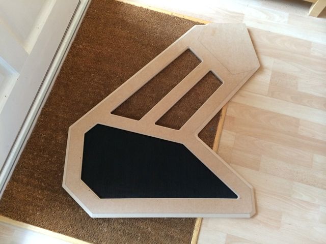

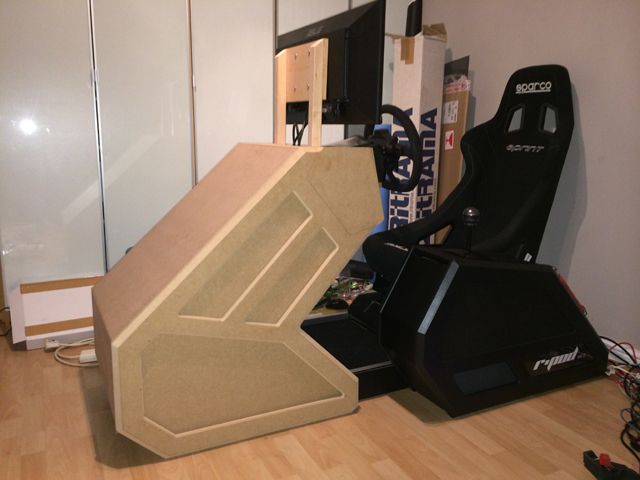

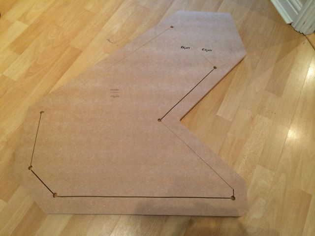

Cutouts to allow for the inlays have been completed on both front panels. I'll glue / screw the outer piece to the main section:
SpaceHedgehog

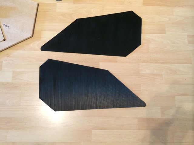

Backing board has been cut for the rubber inlays with it now glued in-place:
Test fit:
Edit:
Temporarily leaning against the side:
« Last Edit: May 11, 2014, 07:34:24 am by SpaceHedgehog »

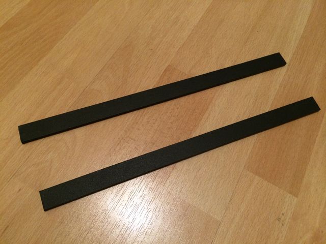

I've routed the channels and cut the aluminium bars:
One and one it is.
« Last Edit: May 11, 2014, 09:02:25 am by SpaceHedgehog »

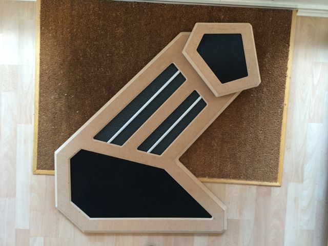

SpaceHedgehog
  • Posts: 937
  • Almost done ...

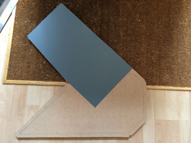

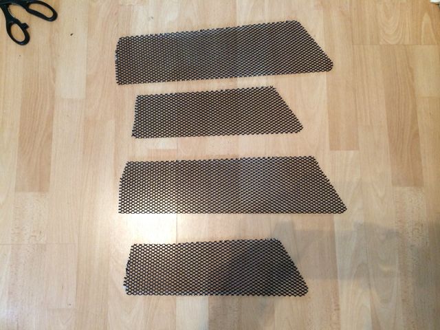

Vinyl backing to accentuate the mesh:
Mesh sections for the front panels:
Loose fit:
Close-up:
Loose fit on the side of the pod:
« Last Edit: May 11, 2014, 12:11:51 pm by SpaceHedgehog »

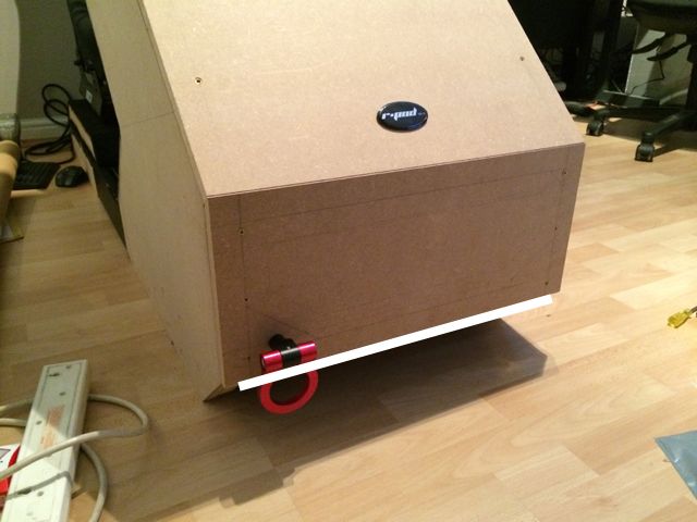

Fitted the tow hook:
ChanceKJ
  • Posts: 3229
I was like: "whys the shifter on the wrong side?"   Then I remembered your power bar and was like "oh yeah... Duh."   :D

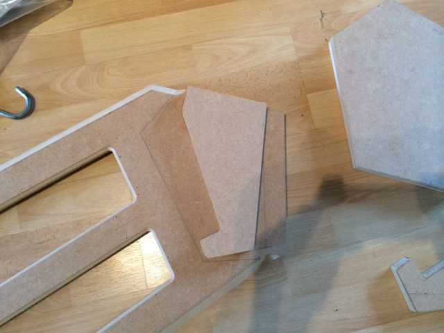

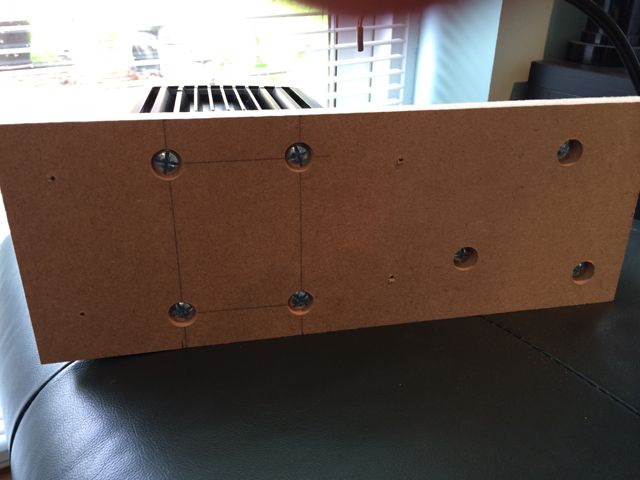

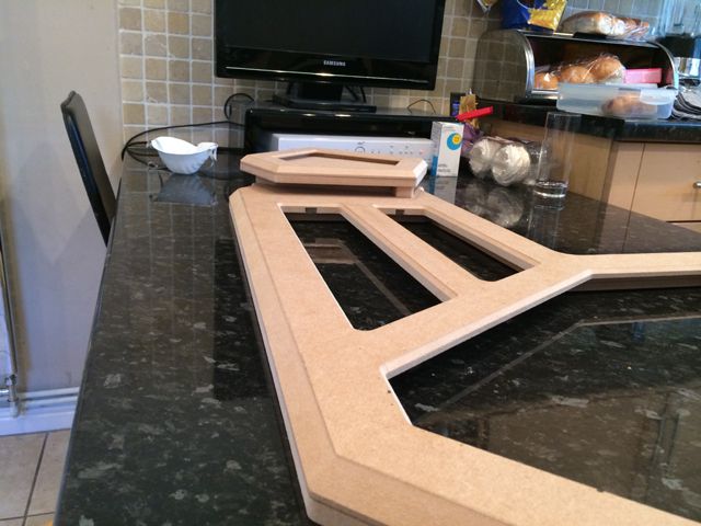

I have a day off today to sort a few things out but I'm also determined to spend some time on this.
Just started on sorting out the dashboard section. Ive created some spacers to give it a more interesting profile:
These attach to the front sides:
The reason they don't extent all the way is that I will need to trim the sides a little to allow clearance for the buttons on the dash. I will attend to that once the dashboard fascia is in place and I can see what's what.
Profile:
Top view:
I'll sort the paneling on these side pieces out next.

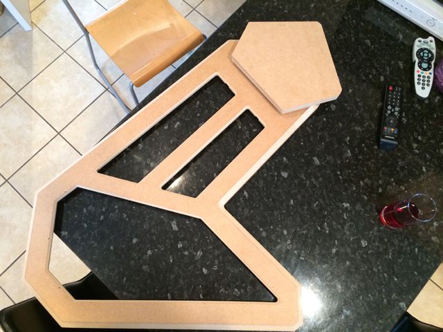

SpaceHedgehog
  • Posts: 937
  • Almost done ...
The cutouts for the dashboard sides have been done. Just the beveling and inlay work to do now:
Rough cut:
Router guides:
Flush trimmed:
Cloned:

Just about finished the dashboard sides. There's still a little bit to do on the inside pieces.
Beveling:
Inlay (I had to be very careful with the depth of the router bit as these pieces are 6mm thiner than the others I've been shaping):
Profile:
Top view:
I need to get the ribbed rubber inlay sorted next.

I've made the inlays for the dash.
Backing board:
Rubber Sheet (I made sure the orientation of the ribbing was correct - pretty much run out of the material now):
In-place:
I'll go and set one of the panels up to get a view on how it looks all together ....

Thanks mattgold. The other bits I use are a large chamfer, straight cutter, rebater and slot cutter. That seems to cover about 99% of what I need.
Here are all of the side pieces dry assembled:
I may have a rest now, I've been at this for pretty much 3 days straight ...

  • Posts: 2019
  • Last login:Yesterday at 10:37:15 am
Re: R-Pod MkII Racing Simulator, Vewlix style : Phase 5 - The dashboard
« Reply #233 on: May 12, 2014, 11:47:57 am »
That's a... quite penile shape.  :laugh2: Sorry. Carry on. :cheers:

Well I've been thinking about lighting and as I'm too tired to do any real work on the rig tonight, I decided where I wanted to place the lighting. This is just an initial view and subject to change.
I'd ordered some LEDs a while ago but also some connectors. The idea will be to run connected strips in certain parts of the rig:
The first location will be here:
Which should provide lighting dispersed like this:
I will then attach some to each of the spacers on either side:
This should drive light down the side of the rig:
The third location will be under the monitor hood / shroud (but set back to provide more dispersed light):
And the forth will be underneath the grill section on the front:
I'll fit a single toggle switch on the dash to activate it all. I don't want to make this overly complex or elaborate.
