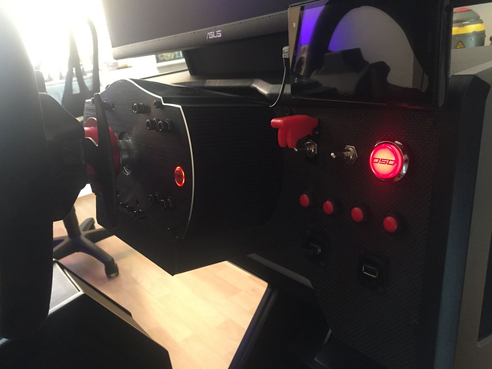

Current state of the build:
Main build log starts ...
After my existing arcade and console cabinet builds, my previous racing setup was looking a little unprofessional, so I've decided to build a new one, something more in keeping with the design of everything else in my room. I’ve been working on this for approximately 4 weeks now and I reckon it will take around 12 to complete.

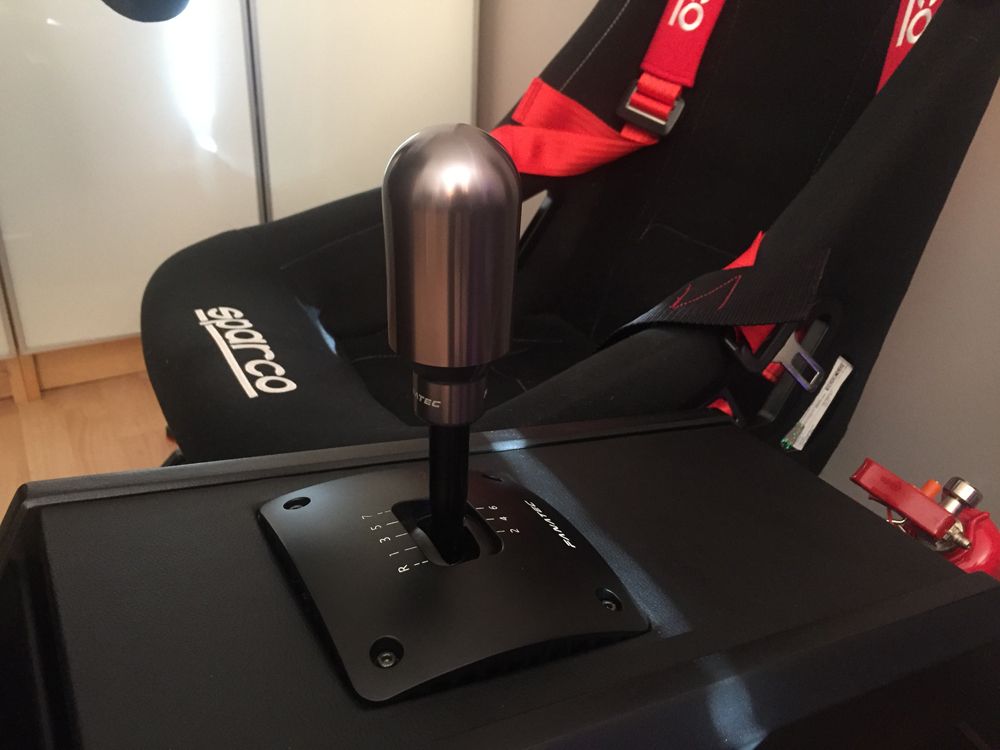

This is what my current racing setup looks like:
First job was to acquire some new equipment. I’ve gone for the Fanatec ClubSport series kit. This includes the pedal set, wheel base with detachable rims and an H-pattern/Sequential shifter.

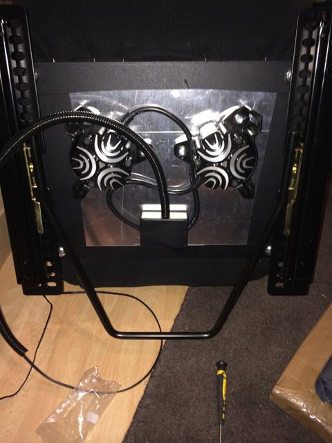

The first challenge was to figure out how to mount the transducers to my new seat (there will be more attached to the pedals and underneath the shifter):
I used some 4mm aluminium plate and drilled some holes and bolted it directly underneath the seat. This transmits the vibrations very efficiently throughout the steel frame:
I tidied things up a bit by using some split convoluted cable sheathing to hide the bolts:

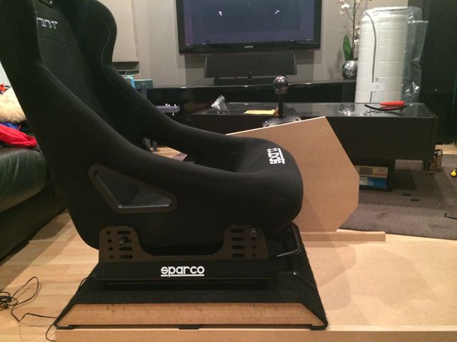

Next stop was the seat base. A simple construction with risers to allow room for the transducers:
This was then covered in automotive carpet with some T-Molding applied around some of the edges:
The speaker cable from the transducers is wired into a small project box:
The remaining speaker cable is fed through some smaller convoluted sheathing through the seat base:

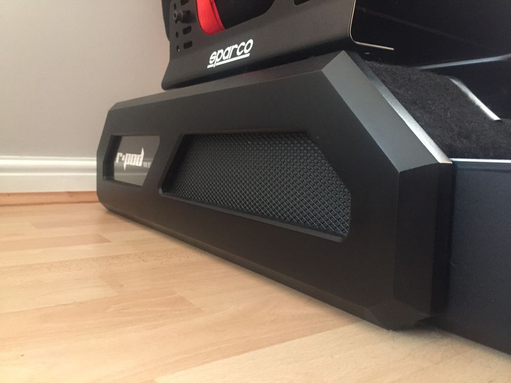

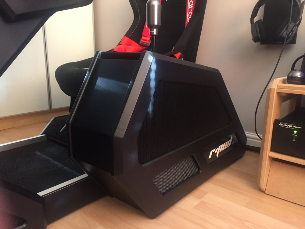

Once complete, I set about designing a console to accommodate the shifter and spent some time figuring out where to position it:
The outside of the console was designed to look like this with recesses for various inlays:
Logo (this will sit behind 3mm acrylic sheet):
Logo test:
Mesh test:

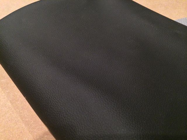

The top shifter panel has also been covered in leather vinyl material:
Close-up:

How do you like that fanatic shifter?
When it first came out and I saw the diagram of the internals, I thought to myself "that's how I would do it if I had the means".
I wasn't a fan of fanatec's previous shifter.

@BadMouth    I came from a G25 and the difference is huge. You probably know the finer technical details but the feel of the shifter is fantastic. It's very easy to switch between the H-pattern and sequential settings also. I would thoroughly recommend it.

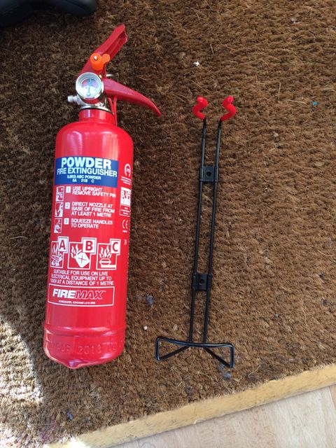

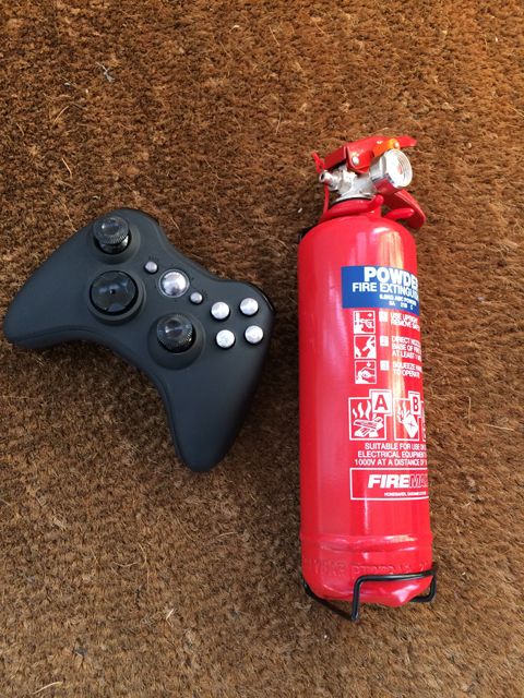

Just for a bit of fun, I've bought a small fire extinguisher to mount on the back face of the shifter pod:
Size compared to a 360 controller:
Mounting bracket:

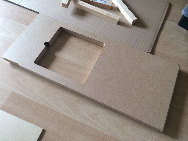

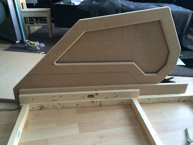

All the main cutting for the shifter pod is now complete. The outside face of this comprises an 18mm (decorative) and 12mm (inward facing) section. In order to insert the inlays, a window has to be cut in the 12mm section:
This in now ready for gluing and screwing to the outer 18mm section. For the width of this piece, I had to make sure there was sufficient clearance from the window sections whilst still enabling me to screw it in place without the screws coming through the outer beveled edges whilst also providing sufficient room to screw the inner 'window' piece back in-place. Difficult to describe!
The finished piece will effectively look like this again:
I will then be able to screw a wooden shelf to the inner window' piece for mounting the shifter. Stability/solidity and a seamless external finish were key consideration in doing all of this.

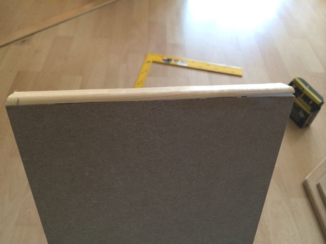

The bracing glued in place yesterday has dried and is now screwed in place.

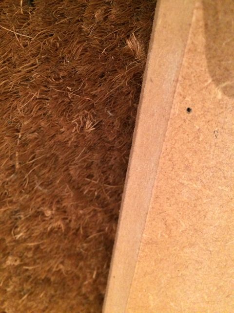

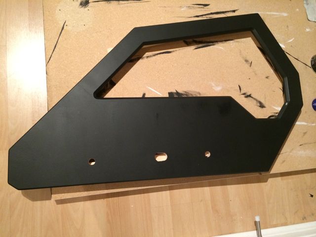

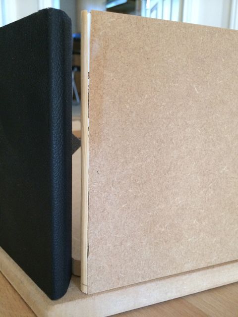

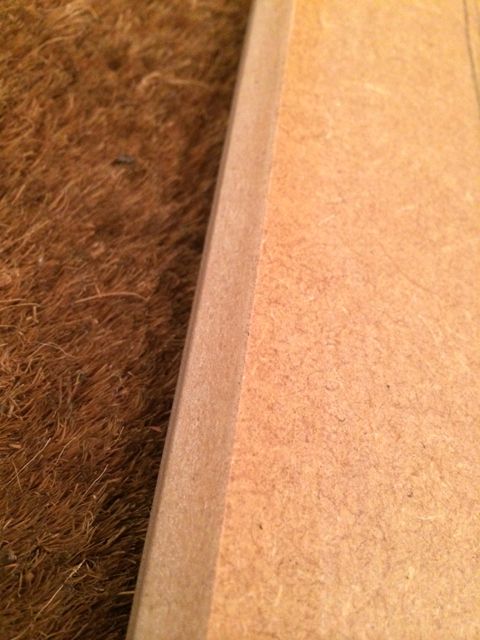

The cut from the circular saw on the top piece wasn't too straight and I needed to round it off so another piece of rounded soft wood has been glued to the top:
This is the gap where this section meets the top panel (the leather material looks like it needs trimming slightly). Finger access so the top panel can be removed easily:
You can see how wonky the cut was.

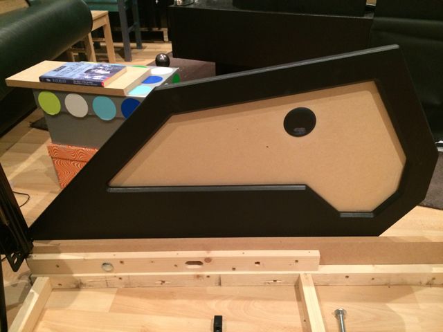

The side pieces for the shifter pod are complete now with everything ready to prep for painting (hurrah). I want this unit to be detachable from the main base so I'm using some m10 bolts. The base and the inside panel have been drilled with a test fit to make sure it all fits:

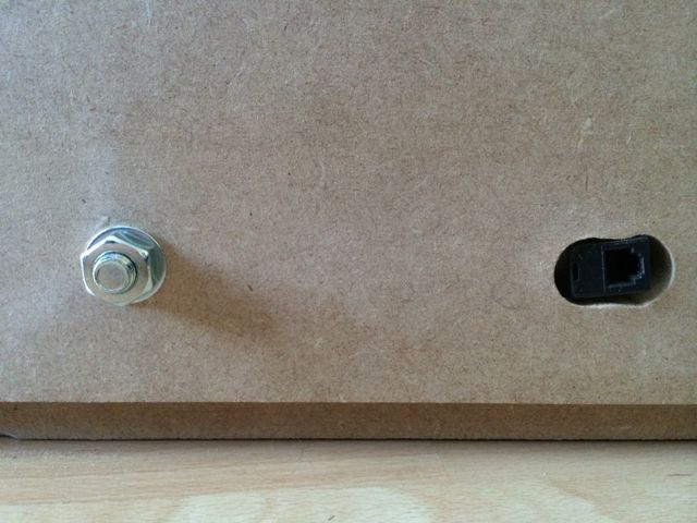

The middle hole will house an extension cable for the shifter. I will also be feeding some audio cable through for when I buy a Buttkicker. I'm not too fussed by the quality of this hole as it won't be seen anyway:

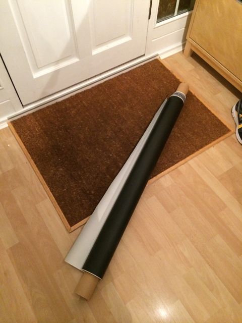

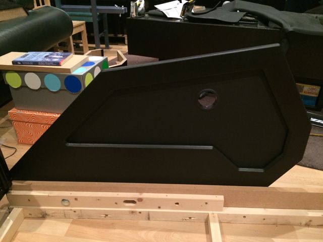

Just a quick update before I close down for the weekend. The side panels are filled sanded and covered with vinyl. There are many ways to do this I'm sure but just a quick tutorial on my DIY laminate (not as durable as the real stuff obviously).

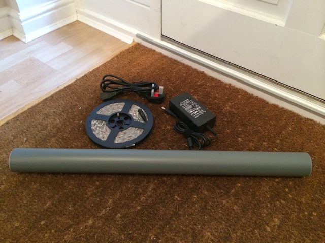

Roll of blackboard vinyl (1m wide):
Cut a sensibly size piece for the panel which requires covering and start to peel the backing back whist smoothing if from the inside outwards:
When an edge is reached, use your thumbs to push it firmly around it. Again, start in the middle and go fairly slowly. It's imprtant to give it a bit of a push to ensure there are no air bubbles:
Once the panel is covered, trim with a sharp blade, working in sections:
Completed rear panel:
Completed front panel:

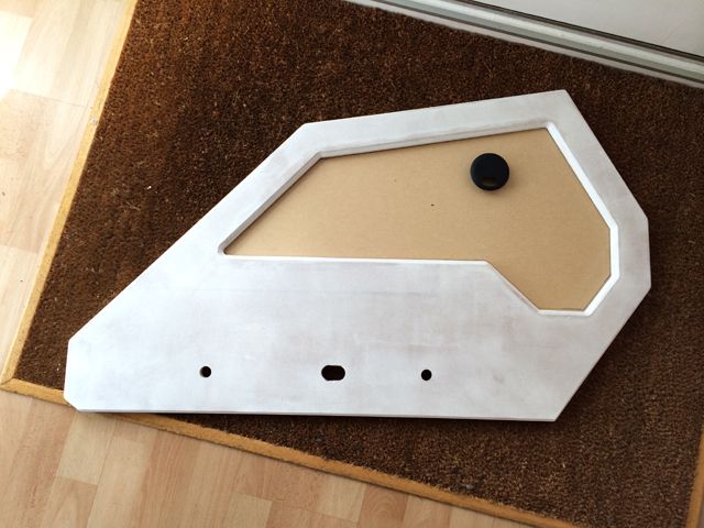

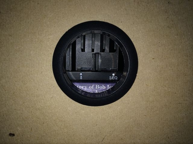

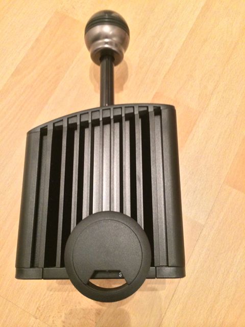

My desk cable grommet finally arrived. This will be the access hole for changing the shifter setting:
Shifter:
The grommet will fit into a hole cut into the side of the shifter pod, seat-side. I'll need to make sure this is lined up correctly as there's not a lot of room for error:
The cover pops of quite easily and snaps back into place. It also has a handy finger hole to help with removing it:

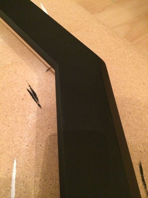

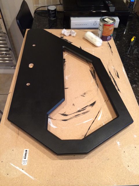

A coat of primer has been applied and lightly sanded back:
First coat of flat black paint applied. I will give this the usual 2 coats. It's still drying, hence the slight inconsistency in the finish:
There are a few areas which are showing as needing the extra coat but the finish looks good:

Second coat of flat black has been applied to the outside frame. This is now ready to have polyurethane varnish applied. I use the same water based products on all my builds and get consistently acceptable results.
Second coat of flat black:

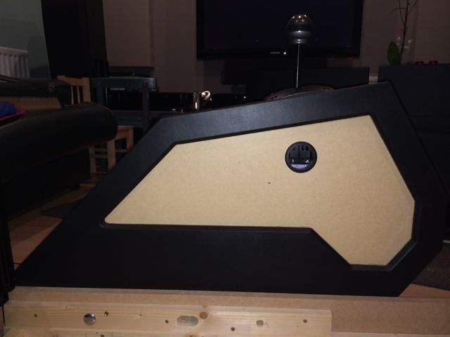

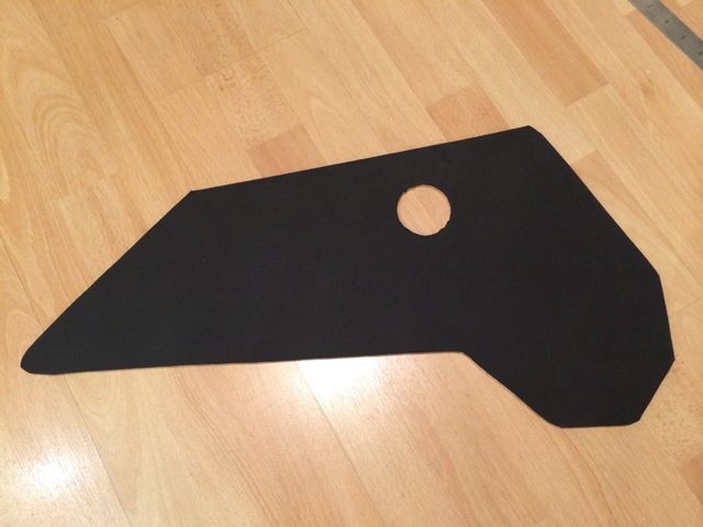

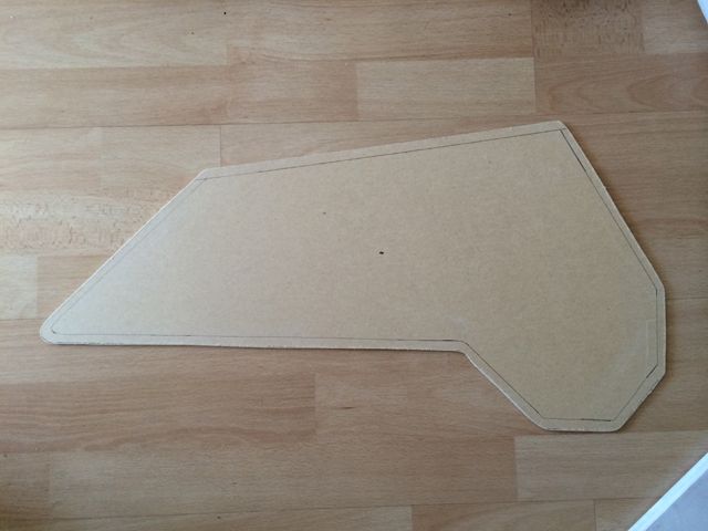

Template cut for the inside face of the pod. This will have a hole drilled for the grommet and be covered with leather vinyl:
Primed / sanded back and showing the likely position of the grommett. I will need to assemble the whole unit first before drilling the hole to ensure it all lines up:

I ended up filling in a few blemished on the side pieces which resulted in me having to sand and repaint. Nevermind, I've completed it now and both pieces are ready for varnishing.
Inside piece with flat black + filler (this has since been given another 2 coats):
I may just have enough time to put 1 coat of varnish on this evening but we'll see.

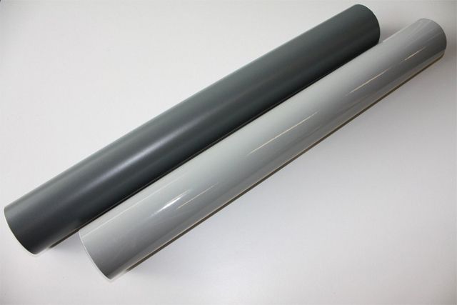

I did order some dark grey matte vinyl last week and this will sit behind the grill. I'll be using some of this on the nose of the pod as well:

The Logo looks less black due to the reflection from the acrylic:
I'm pleased with the result.
Edit. Polyurethane varnish has been applied to the above piece. I will do the other piece next.

Finally feel like this is all coming together now. It's turned out as well as I could have reasonably expected it to. I'm just waiting on the grey vinyl before putting it all together. I still need to spend a little bit of time getting the shelf that the shifter will sit on in the right place.
First coat of polyurethane on the inside piece:
The shifter pod will sit on 4 of these:
I spent some time hot-gluing the panels and mesh into the frame. I am really pleased with how this came out. It was just as I had imagined it.
A few shots of the outside face of the shifter pod:
Reviewing the outcome, it was worth the effort. It's easy to compromise when things start getting challenging or taking too much time but I didn't want to look back and wish I'd done it differently.

I've just ordered some 'cool white' LED lighting to fit underneath the rig. I prefer a dispersed rather than concentrated dot look (if you know what I mean) so I need to figure out the correct distance from the edges I needed to fit it to avoid the 'dot effect'. I'll may need to embed the strip - figuring this out at the moment.
The inside piece now has 3 coats of polyurethane applied so, provided my vinyl turns up tomorrow, I should be in a position to start assembling it. Hope to complete it by Wed / Thurs.

I managed to motivate myself to sort out the shifter access hole. This took about an hour of measuring, marking, drilling, and lining up panels to confirm where I needed to drill the hole.
Inside panel of shifter pod with grommett fitted:
Shifter in position (it will sit a couple of mm higher once the internal shelf has been attached:
Close-up of access hole:
I will need to tidy up the inside shelf to ensure it's all blacked out when I assemble it.

Why waste an hour? I decided to finish of the leather vinyl insert.
Leather vinyl attached to template:
Fitted to the inside frame:
Close-up:
I found out my grey vinyl had been left at the depot. I'll be picking that up sometime tomorrow.

LEDs and vinyl arrived:
I've put the vinyl on the backing of this panel and put some bracing on the back of the other panels to ensure that there's no give and everything is solid. The reason for the vinyl in the first place is to bring out the texture of the mesh. With a dark background, it's less noticable.
Vinyl applied:
A close-up which shows the contrast better:
Click a pic for a video tour
