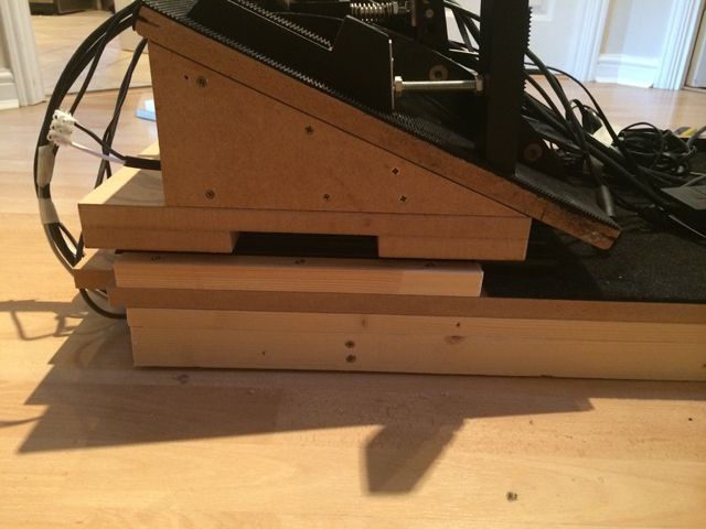

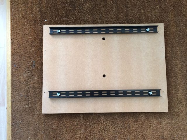

The foot rest pieces are now complete with the rubber cut. I will need to tidy the base up a little to ensure that no bare MDF shows through the matting (i.e. paint it black).
The bolt at the back really stabilises the whole construction and presents a solid structure. No flexing even with a hefty whack with my foot.

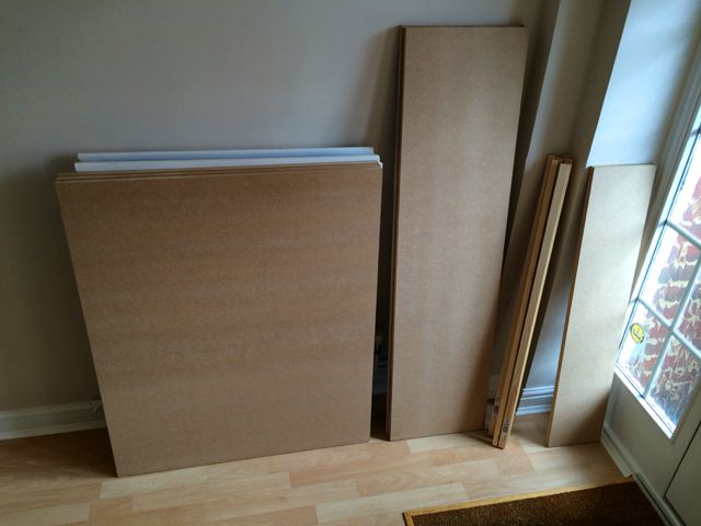

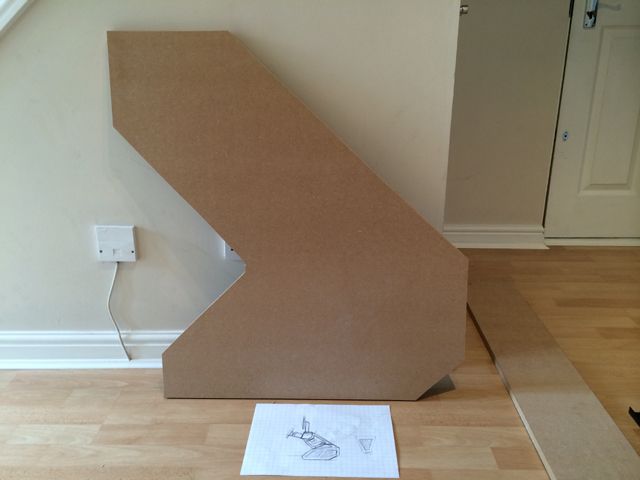

18mm MDF has been cut into the basic panels I need to start shaping the nose section:
Click a pic for a video tour
SpaceHedgehog
  • Posts: 937
  • Almost done ...
This is the most important part of the build so I've spent some time checking and re-checking the measurements - there's always something to overlook but hopefully I've taken everything into account. MDF will be applied to the outside face of the sloping angle and front nose piece so it will be a little fatter than the profile shown. This is to allow me glue / screw everything in solidly and then apply blackboard vinyl over the top in one continuous piece. I will again be making side panels for this with cutouts and inlays - a lot of work but I'm please with how the shifter pod turned out so it should be worth it.
Rough cut profile:

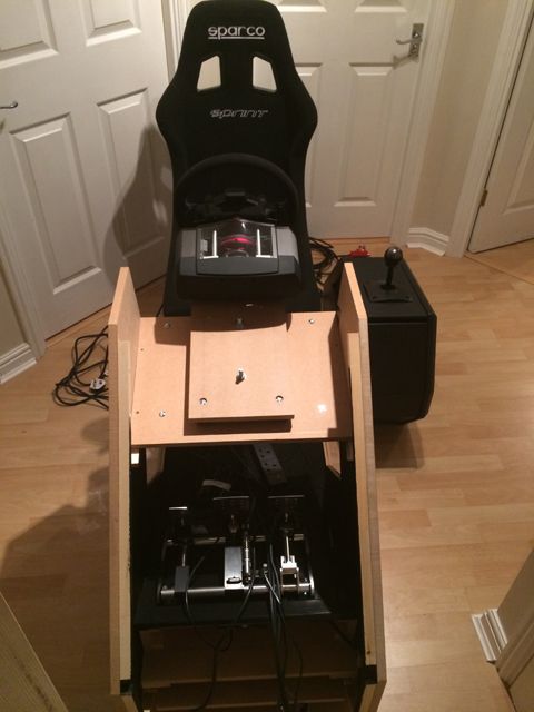

Just hauled everything into the hallway for a test fit. There's still some work to do on the base (trim the part that's jutting out at the bottom) and also the top part of the nose side pieces (these will need to be angled to align with the wheel, once that's in place).
It's starting to look like a rig now and not just a random assembly of parts.

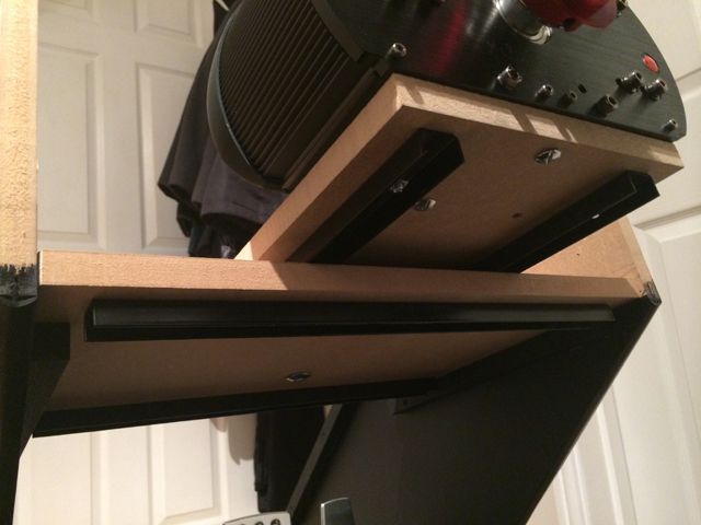

Made some more progress with the wheel shelf - this will extend from the main nose section to allow clearance for the cooling vents on the wheel. It needs to be rigid so have used some shelving brackets as mentioned in a previous post:

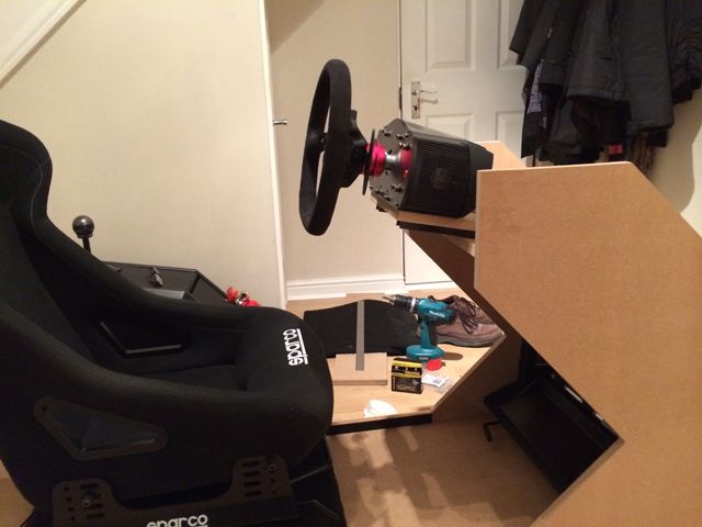

It's time to mount the wheel. There's a bit of adjustment to do, I need to lower it a little and set it at more of an angle. As the seat moves forwards and I can raise the height and also mode the pedals back and forth, the wheel will be fixed.
« Last Edit: April 12, 2014, 05:47:09 pm by SpaceHedgehog »

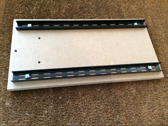

I thought I'd write a list of things to do before I can even start on the next panels for the front section. Just realised there's a lot to do:
Frame: trim front pieces
Base: Cut slots for furring strips
Carpet: re-cut - current piece too small - include holes for seat runner raisers
Front sides: angle top sections for dashboard integration
Top shelf - cut back and use excess to stabilise base further. Add shelf supports to remove vertical play.

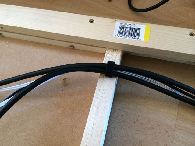

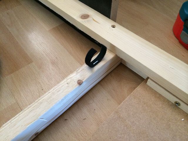

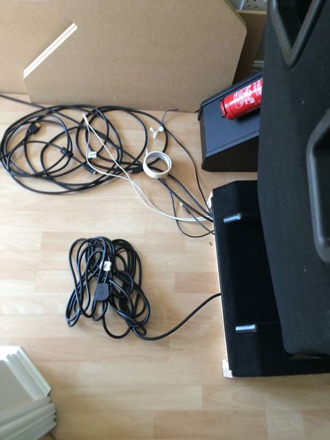

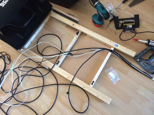

Looking at the cabling at the moment (Power will be kept separate from everything else):
Velcro used to keep things tidy:
SpaceHedgehog
  • Posts: 937
  • Almost done ...
Cables, cables, cables. I need to be absolutely sure I've fitted everything in:
DVI - check
Displayport - check
Speaker cable - check
Speaker cable spare - check
USB - check
USB extension cable/spare - check
Shifter cable - check
Rear Buttkicker cable - check
Power cable - check
I hope that's everything ...

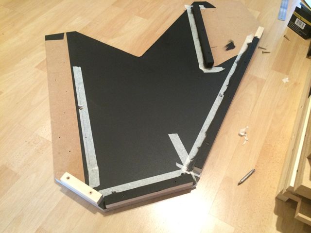

Bracing applied to the top panel where the wheel stem attaches to:
Slots cut on the side pieces - T-Molding will be applied for a better finish. Ive painted it as well to avoid the potential to see any wood poking through - Ive had to offset the slot slightly to ensure that the T-Molding doesn't interfere with the shaped side panels when I make those:
I've also beveled the bottom edge of the side pieces to align with the rest of the base. Next will be to cover the inside of the side pieces with blackboard vinyl.

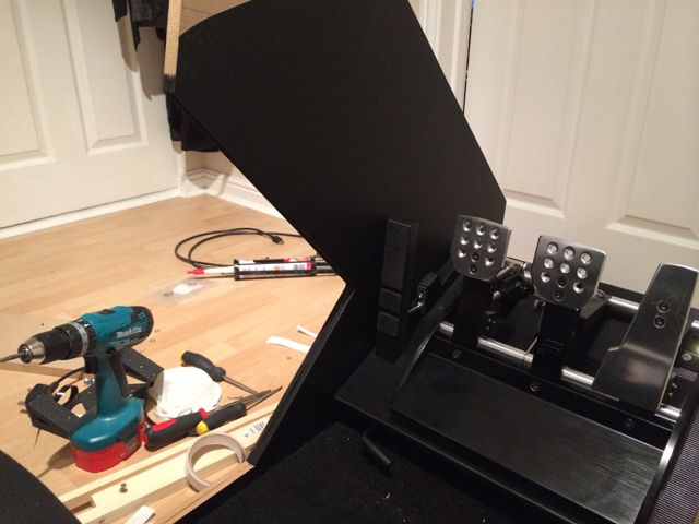

I've spent the last couple of hours doing the final fixing of the pedal assembly, dead pedal, carpet and rubber matting. I've also started to prepare the inside of the side pieces. Blackboard vinyl has been applied to one of them:
I want to get the two sides finished and glued/ screwed in place before the evening is over.

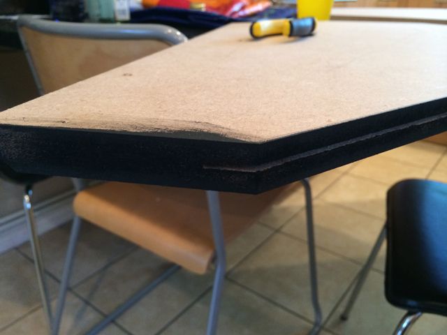

A bit more progress. T-Molding applied:
Wood strips applied:
That's it for the weekend. Thanks for watching.

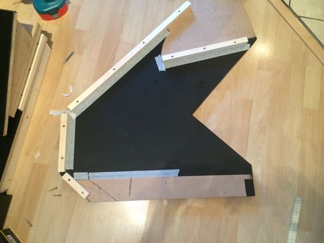

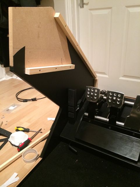

Before I attach the sides permanently, I need to be sure I've covered all the bases. To provide some additional base support, I've attached an extra baton underneath the peal assembly - I'll be able to screw and glue higher up which will only add to the stability:
I've also decided to paint the internal batons as well just in case any wood is visible. Masked out:
Flat black paint applied:
Not looking pretty at this point but once everything is assembled, all the visible parts should look good.

The sides have been glued and screwed on. Everything still lines up - always best to check as you're going along:
The dashboard will taper upwards and extend forwards slightly when fitted to give the profile a thinner look - I also want to make sure I have enough room for buttons and dials / screen devices etc.
Shot of the bracing for the wheel stem and shelf - there's still a bit to do here. The stability is much improved with the cross braces:

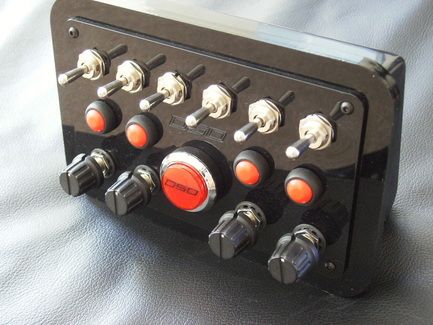

Now that I see this coming along I am amending my previous suggestion.  THIS should be your power button:
Perhaps even incorporate the entire panel with audio controls:
From a 2000-2009 Honda S2000.
SpaceHedgehog
  • Posts: 937
  • Almost done ...
That does look very nice mattgold! I'm  starting to think about the configuration of the buttons on the dash. Given the cost of assembling all the parts and controller board separately, I'll likely go with a Derek Speare designs unit and de-case it. I think it's probably as / more cost effective to do it this way:
A nicer engine start button would look better though.
The plan would likely be to buy real carbon fiber sheet as the backing to this.
