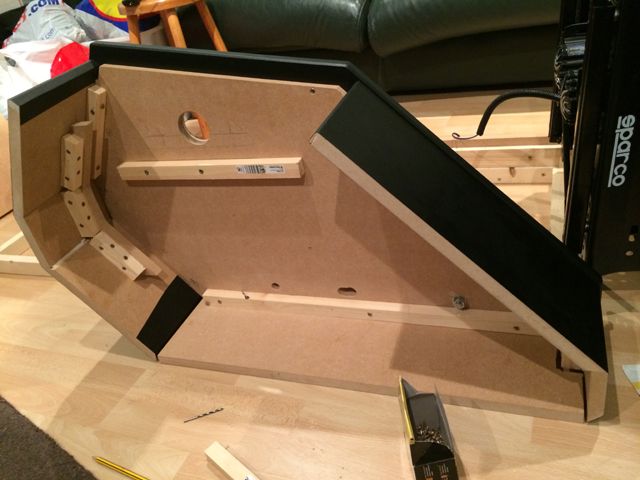

A few pictures of the rather awkward and challenging assembly process. It's still a long way off yet. I want to dry assemble to make sure it all lines up first. I'll then glue most of the panels together.
My house has a tendency to turn into a right tip at this point in the project process. Everything gets left where it falls. This makes taking decent pictures a bit difficult as well. I'll give the place a good clean at the weekend once this phase is complete.
This is with the outside panel just leaning on the rest of the structure:
The batons in the middle will be where the shifter shelf will be attached. This should add further to he stability too.

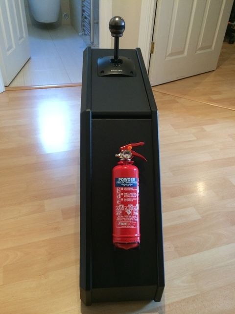

As mentioned previously ,I wanted to make some blanking plates to hide any view of the inside of the shifter pod. Just the tips of these show and have been hot glued in-place.
The thing is finally finished aside from a few minor tweaks which need to be done once the whole R-Pod is built. I reckon it's taken about 50 or so hours to get this done so excuse me while I get a little self indulgent and post a whole load of pictures!
A fire extinguisher has been attached to the back face of the pod for a bit of fun.
The last picture shows that the top panel is not quite true. I will sort that out.
I will also need to raise the shifter itself by a few mm. I wanted to set it this low initially to give myself some options later.

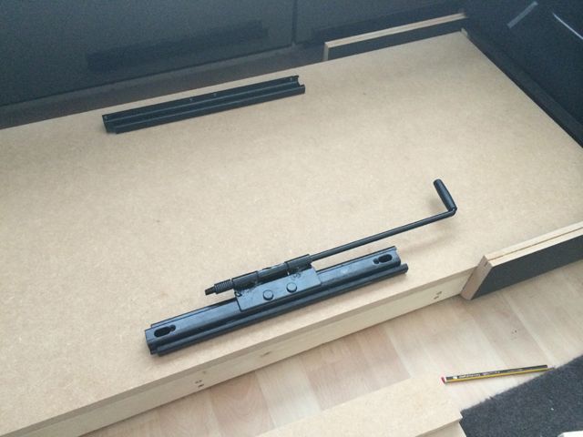

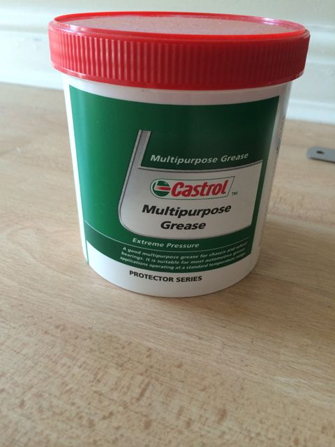

I've started the adjustable pedal system this weekend. This is managed by seat runners:
These were very stiff when they arrived so time for some lubrication:
The pedal base plate is 1 cm narrower than the base of the pod to allow a bit of give. The adjustment mechanism on the runners meant that I had to cut 2 pieces to fit on that side:
Threaded inserts were used to attach the runner to the pedal base. The same approach will be used to mount this to the pod base:

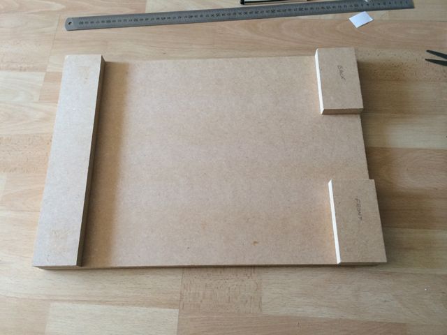

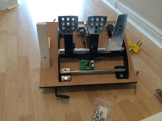

Some more progress with the pedal system:
Sides complete:
Top section cut:

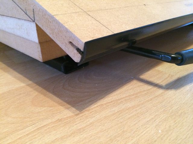

T-Molding applied to the top and bottom of the top section with a slight overlap to integrate with the rubber sheet:
I will need to cut out areas of the rubber sheet to fit the pedals:
Pedals attached:
Click a pic for a video tour

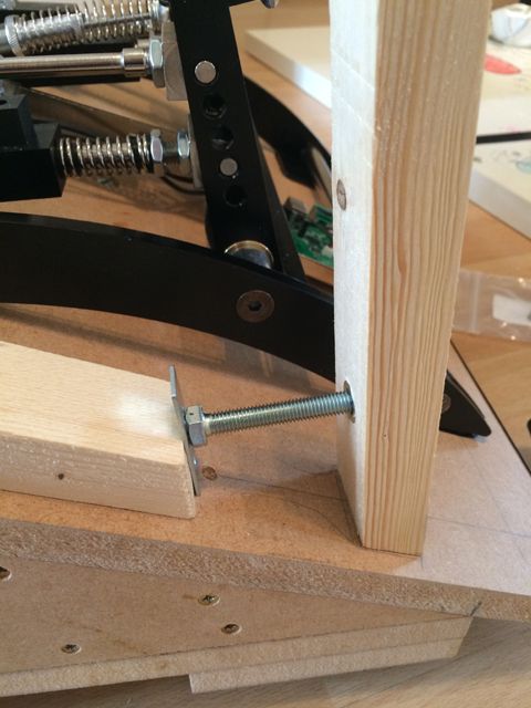

The runners have now been hard mounted to the base and use risers. This will give the appropriate clearance to ensure the runners don't interfere with/catch the carpet when that is fitted:
Everything looks to be lining up correctly (i.e. the base won't interfere with the sides once those are on) and the pedal base is surprisingly easy to move. Must be that special Castrol grease I used!
Unfortunately the pictures are a bit poor due to the lighting in the room.

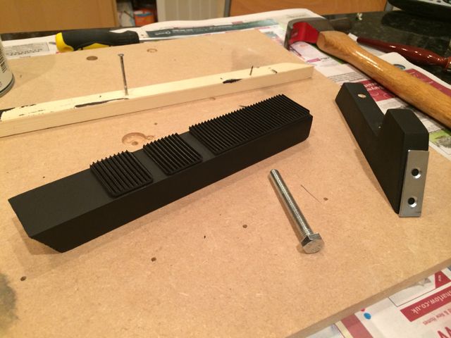

I've always found myself wanting a foot rest so I figured that this time I would make one:
This needs to be secure as it's likely to take a bit of a kicking. A couple of 50mm screws are holding it in place but I wanted to make sure it didn't flex. I constructed an adjustable bolt mechanism to ensure that it fits tightly. I'm still working on the piece behind the main foot rest. This will need to be finished cleanly:
I'll need to cut a hole in the rubber matting to get a good finish.

So I spent a little time figuring out how I wanted the foot rest to look. It needs to blend in with the rest of the build, be functional and not look like an afterthought. I coated the whole thing in car body filler and sanded it back to harden it and get rid of the grain. This will be painted black. Small strips of rounded rubber have been cut and will be glued to the front face:
I chose to have 3 sections for a bit of variety.

Completed the retaining piece for the footrest, finished filling and sanding and then applied a coat of flat black so it's ready for some polyurethane varnish tomorrow:

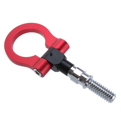

Been eyeing up one of these tow hooks for the front of the pod. Couldn't resist any longer. Buy it now. Click.

Tow hook arrived. I've created a tow graphic to go with it (will likely print out on vinyl):
