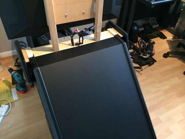

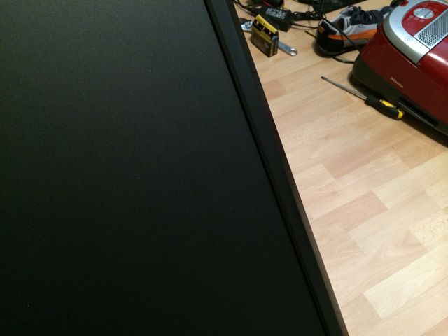

With the remaining filler sanded down ad a few extra spots re-done, it was time to apply the vinyl. Two hands are better than one for larger, more complex  surfaces. Before starting, it goes without saying that the area should be inspected very carefully for debris. Typically, I will is a duster and then brush with my hands.
Line the vinyl up and push it firmly around the first edge. It's a very important step to ensure there are no bubbles. All the places where I've applied previously haven't developed any. Note: 90 decree angles are very difficult and typicaly I will try and avoid that or use a light chamfer to help it along.
Step 1: line the vinyl up and negotiate the first edge:
Step 2: carefully draw back the backing paper and smooth the vinyl on:
Step 3: continue to cover the piece, ensuring to press firmly around any remaining edges:
Step 4: rough trim excess to allow the final trim to be easier:
Step 5: get the tools ready, a decent flat length of wood strip and a sharp knife:
Step 6: work in sections to make the process easier:
Step 7: complete all the sides:
On close inspection, it looks to have gone on very well with no bumps or air bubbles.

Vinyl can be a bit difficult to work with sometimes, especially the thin stuff. This is thicker which seems to help.
I've painted the outside face of the front to ensure that no MDF is visible should there be any gap:

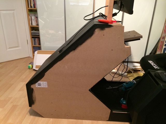

The left side piece is now in place with the wiring for the LEDs fed through the dash section. Close-up of the fit:
Profile:
It's looking decidedly meaner imho.
Click a pic for a video tour

Second side has been attached:
The dashboard will fit over the top section. I've made it nice and wide so I can fit lots of switches and extra bits:
Still deciding whether to attach the grille. I quite like plain ...

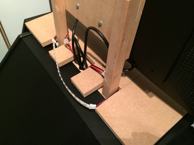

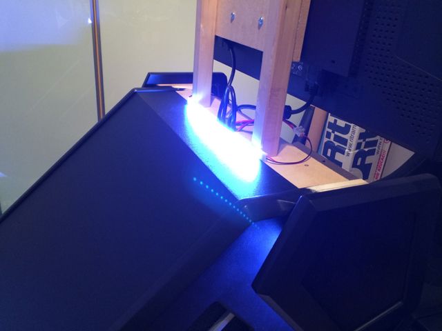

I bought one of these to control the lighting:
Completed the lighting for the wiring (hot glue gun will be used to make all the wiring secure):
Side:
Top (this will be masked considerably by the monitor hood so only a thin slice of light comes through - can you slice light?):

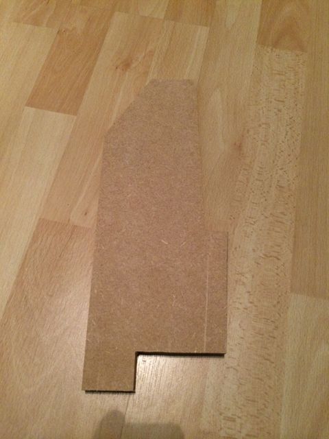

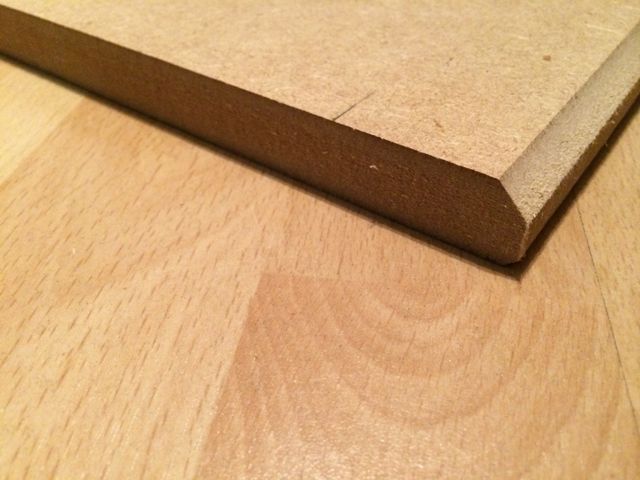

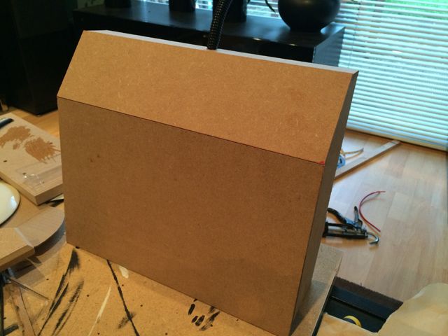

Started on the dashboard top panel. This is what I call a 4 hour piece of wood.
Cutouts to allow the piece to slot in:
Beveling on the front face:
Extra depth to avoid the CSW wheel base interfering with the panel:
Curved around the CSW base to ensure it's visible:
The whole piece will be covered in leather material. The back will be hidden by the monitor hood.

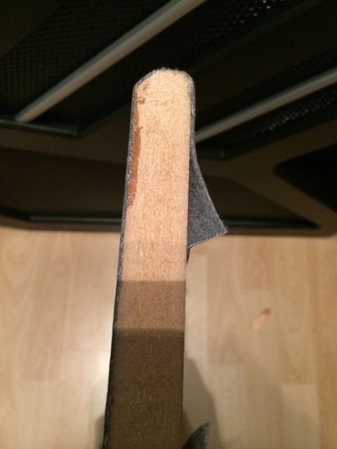

Without a doubt, the most difficult part of the whole build, upholstering the dash ... It took about 2 hours to get this on. I almost gave up, twice. The staples will be hidden by the monitor cover.
Fully covered:
I'll need to epoxy the material to the edges.
In place:

Cheers  :cheers:  The underside is staple city, just the edges glued with epoxy. I used the same stuff on the top of the shifter pod panel and it's holding really solidly. The carpet spray glue didn't hold it so I had to redo with epoxy.

Most of this morning was spent finishing off the dash top plate and designing the dash panel. I also rough cut one of the sides for the monitor hood. It still needs quite a bit of work yet:
I made a template for the dash panel which took much longer than expected and then cut both of them out:
The lower part will have a vinyl R-Pod logo:
And will be covered in real carbon fibre:

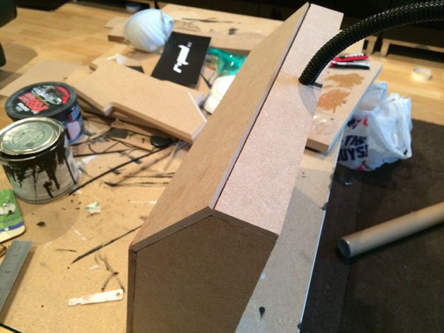

I've finished the side pieces for the monitor hood, there's only a limited amount you can do with a cover:
They need a little bit more work before filling, sanding and painting ...

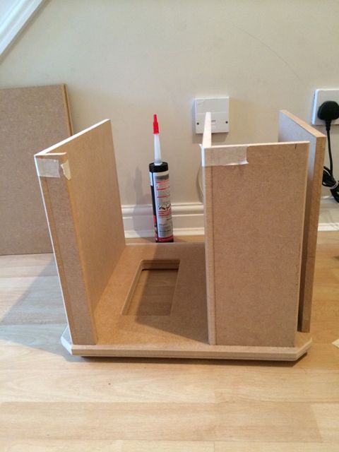

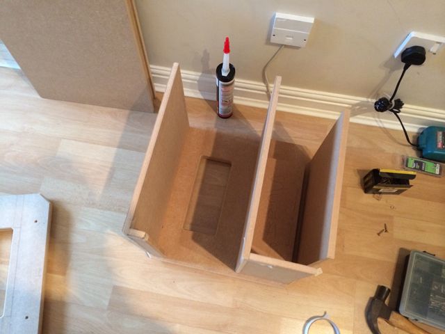

I've cut the internal rests for the monitor hood panels. I'll use 6mm MDF for the remaining parts:
I'll also need to cut some braces for the insides as the material is thin and I want to add some strength to the structure.
« Last Edit: May 29, 2014, 06:33:14 am by SpaceHedgehog »

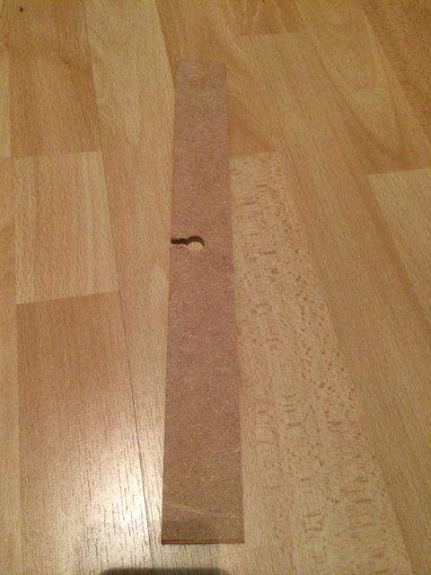

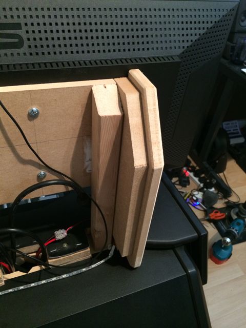

Made the first panel for the top. This has an access hole for TrackIR cabling (can't stand seeing cables - let's make a feature out of it):
I'll be making an enclosure for the top where the transmitter will sit.
Split convoluted sheathing to connect the two:

Personally, I think that kind of cable management is (if not uglier than) as ugly as the actual cables. I think it'd look very slick if you used some kind of low profile wall type cable management and run it tight against the back of your screen. :cheers:
SpaceHedgehog
  • Posts: 937
  • Almost done ...
Re: R-Pod MkII Racing Simulator, Vewlix style : Front section complete
« Reply #305 on: May 29, 2014, 10:18:00 am »
It'd be difficult to get it all snug to the monitor as it would have to go around a square bit! I'm quite taken with the sheathing tbh - it'll look better once the top box is in-place. Too late now anyway, all the pieces are cut :)

Glue time. Epoxy and wood glue down the sides for good measure:
Welcome to my table of mess btw.

With all the focus on the front and the dash, I'd completely forgotten about the right side panel for the seat base:
I'd redone it all a couple of weeks ago and forgotten about it (there have been bits lying around all over the place). I got around to cutting the mesh, acrylic artwork and backing board:
Just loose assembled at the moment. I'll get the hot glue gun out and then glue and screw it together:
Edit: Odd, final picture wasn't showing ...

Well, my deadline to finish this cab was today - looks like I've missed it but still have 3 days to go before work beckons. I know I won't get to finish the dashboard layout as I've only just ordered the DSD button box. Hopefully I can set everything up so I just have that to do and stop boring you all with all these updates :)
Finished attaching the outer 2 pieces of the monitor hood:
Looks like I was a little off with the top piece. Nothing that a bit of filler can't resolve:
« Last Edit: May 29, 2014, 03:24:10 pm by SpaceHedgehog »

Test fit (it's just hanging off the posts at the moment so isn't lined up perfectly):
I've left room to fit an aluminium bar at the bottom but I cant' help thinking it needs something to perk it up a little - I've bought another sheet of acrylic for a small r-pod logo cutout panel (new Batman pictures in the background :) ):

Measured, cut and flush trimmed 8 side panels for the amp and keyboard/mouse racks:

The first side piece for the amp unit has been cut. I don't want to go too fancy with this, the rig needs to be the centrepiece really. A hole has been cut in the side for some interest and also to allow air to circulate.
Rough cut:
Flush trimmed:

Panels attached together (double width like everything else) and beveled:
Close-up:

Finished cutting all the pieces and have screwed the frame together. The blanking panes are just stuck on with tape for now:
