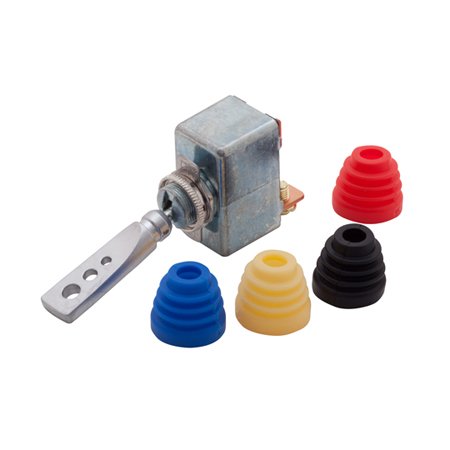

Plug "switch boot" into Amazon FTW.
Well, that's awesome.  I've been looking for these for a long time for the Battletech pod.  Thanks man!

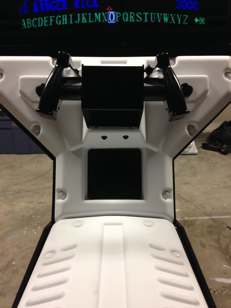

Been able to get after a few things in the last bit - I have two other projects actively going and one on the burner right now so I've been multitasking like a mofo:
Got the yoke prepped and laid out to tackle assembly
If you need to replace your bumpers these are a great fit and a set of four will run you $6 at Lowes.  They are a little big but you can trim them if necessary.
Thumb button installed
Interior view
Analog and trigger wired up together for the right hand grip.  Went to go hook it up to the kade+ for testing and realized that I don't have any 10k ohm resistors left in the house so I'll have to run to the Shack.  Kinda took the wind out of my sails as I was on a roll.  The cut away on the trigger mount is for analog clearance - it'll be a tight fit
These are the boots I went with for the analog stick, it's kind of of pricey for such a little piece but you get three to practice on.  I had to cut off the top ring to get the fit I wanted.  Pic is link fyi.

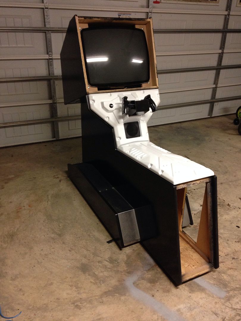

Once I got the kadestick sorted I wired everything up for a test fit - had my axis reversed and on one pot I had the 5v and G reversed but that's why we test  ;D
Here's where I began to build up the support.  I thought about using putty but hot glue a little at a time gave me a lot of control over how the support structure got built.  I wanted to ensure that the pots and pushbutton on the unit didn't get gummed up.  It was tedious but once I had a good base I was able to start using wood stints to help build up the area faster.  Of course if I ever have to change the unit out I'll probably just buy a new handle rather than fight that mess lol.
That T-molding needs to hurry up and arrive so I can mount the monitor and get this show on the road!
Now we're getting somewhere.  The boot around the analog stick needs to be glued down as there is a little bit of lift at the corners but I'll wait until I do the final test to do that.

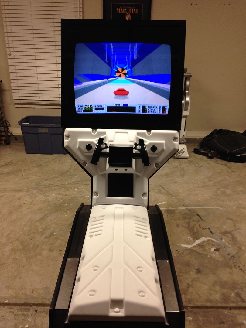

T-molding came in today!  Couldn't help but get it installed tonight and snapping a few pics.  Yoke is just show mounted for now, monitor if mounted but the boards are just sitting in the back.  I have a black out template for the speaker grill but liked how it looked with the white showing through.  That may get a stencil job before the end too - we'll see.  Next up is the bezel and coin door.  Then I'll fiddle with the kickplate panel and start wiring it all together - I really should start working on the art for this  :laugh:
To be clear I haven't fired it up yet but I'm pretty sure SW is going to be straight up sick on this thing  ;D

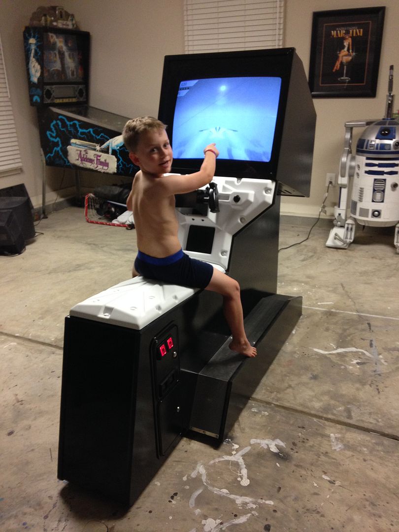

Been making some progress ::)
Done so far:
Wiring, body work, all controls, coin door, a lot of clean up
Still to do:
FE work, game installation and setup, repaint the CP and seat.
I had it gloss white and changed it to flat white because I thought I'd like it better.  While it looks great the gloss gave such a more resilient durable finish so I'll take the plastics off and redo them.  It's not that much work and I'll be much happier with it once finished.
I would like to eventually like to switch the TV in the unit out for a better monitor but finding el-cheapo 25" monitors can be tricky.
Now I need to start on the art.  By the way, I'm totally up for recommendations on the art.  I have a very blank slate right now so I can go any which way.  Starfighter is the general theme but it doesn't have to be "Last Starfighter" gunstar, it can be anything really.  I'll play with some ideas and get some options posted later.
