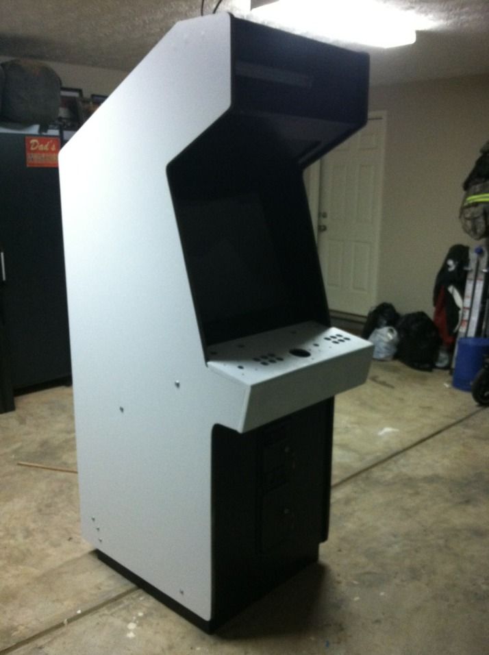

Scored the TV off craigs for $20.  It worked fine at the seller's house, got it home and it started showing classic signs of needing a cap job on the vertical.  I'll crack it open and see if one is bulged, if not I'll probably just replace the lot.  I toyed with decasing but its a slim case on as far as width goes so I'm not really gaining any space by doing it.  Makes it easier to replace for the user later on down the road like this anyway.
I wasted an afternoon building a super sturdy awesome 5" base only to determine it was a bit too narrow to feel stable and about two inches too tall to be comfortable.  Was able to make use of 80% of the wood from the effort but was kicking myself for not stacking some wood up just to test height first.  Live and learn.
The build can be dismantled as I'm using threaded inserts throughout.  It ran about $50 in hardware to do it that way but I like it better than screws, it's rock solid, and it can always be flat packed and put in a conex to take to afghanistan or something  ;D

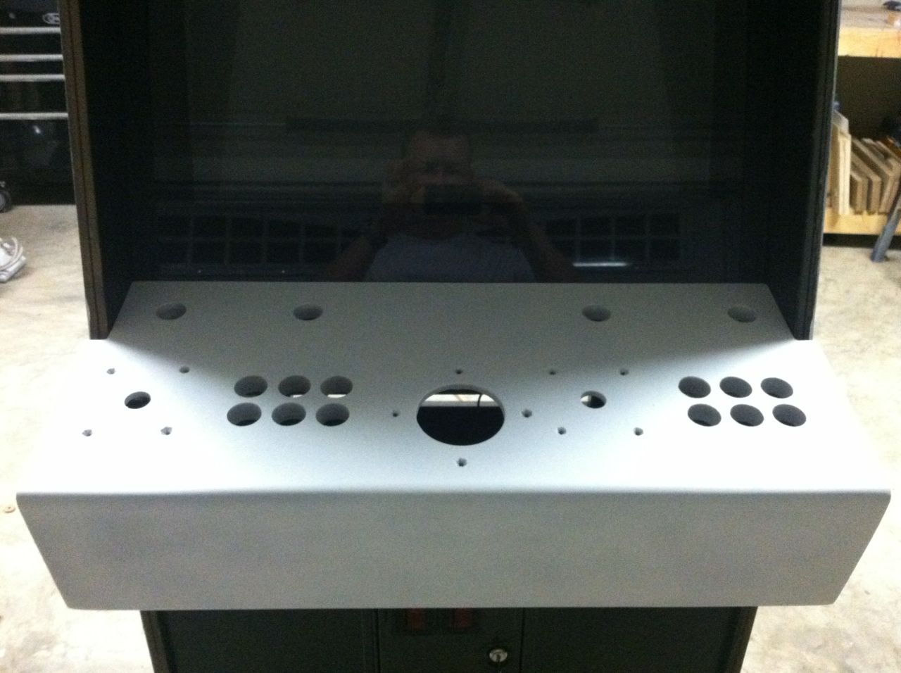

Got a fair amount done after work today.  Fixed the base, did some more on the monitor mount, cut the top of the CP, wired and mounted the marquee light, cut and formed the marquee retainers, routed for T-molding, fell asleep at the wheel and totally borked an 8 inch section on the front while routing, did all the sanding and patch work, filled the borked area with wood filler so I can retrain on routing.
Top down detail of the CP.  I'm trying something a bit out of left field with this one but think it will blend well and have nice curves.  I need to cut the front and bottom pieces but can't put it all together until I get in my parts to route and test fit all the components.  I've got my dimensions sorted in my head tho so I can start on the art finally.

rablack97
  • Posts: 2215
Re: The Fieldhouse - Commission Job
« Reply #30 on: April 01, 2013, 11:52:33 pm »
do you want constructive criticism or kiss ass comments?
It may be the camera, but the top of that thing doesnt' look proportional.  It's like you modified it to fit those humongous speakears.
Dunno man, I'm sure you'll make it look pretty in the end, otherwise good start....

Rough draft CPO.  I'm not 100% happy with this I think.  It's headed in the right direction but it's not quite there yet, or maybe I've been working on it for too long at one stretch.  My design eye is shot for the evening.
edit:  Just for reference the bend will be about at the lions' necks-ish.
« Last Edit: April 03, 2013, 12:50:52 am by Le Chuck »

Have you tried outlining the lions like you do with the little ones?
« Reply #39 on: April 03, 2013, 01:24:16 pm »
Yeah, I'll play around with it some more tho.  It's hard finding the balance between the text overlays and the outline to keep it from becoming visually muddled.  The client is pleased, I'll try a few more things tho.  I did the lions as stained glass but it felt cliparty and I didn't like it.  I think this is pretty close unless somebody has a wizbang idea.
« Reply #40 on: April 03, 2013, 01:28:52 pm »
I'd maybe try tossing in a splash of red somehow to make it pop a bit more, the barmaid ribbons and lips on the sideart seem to really stand out in a good way.
Otherwise, it still looks good as-is.
« Reply #51 on: April 04, 2013, 06:56:16 pm »
MC, and whoever else cares, here are the measurements for the side panels to get things started.  I numbered all the corners of the cab with the rear bottom corner being 0, the front bottom corner 1, the corner at the bottom of the CP arm 2, and so on in an anticlockwise fashion.  They are presented in a X, Y style so you can lay them out on a sheet of lumber.  All radii are based on a 2.25" disc.  All units are in inches and all decimals are common carpentry fractions.
0 - 0,0
1 - 29.75, 0
2 - 30.75, 29.25
3 - 35.4375, 29.25
4 - 36.5, 34.875
5 - 29.875, 36
6 - 23.90625, 60
7 - 33.9375, 66.1875
8 - 33.9375, 75.84375
9 - 21.09375, 75.84375
10 - 0, 62.09375
The monitor platform's leading edge is at the same height as number 5 but set back about 4 inches and the shelf is on a 30o slope down towards the back.  This slope can be adjusted based on desired viewing angle tho.  A 27" tv and is still cased fits with the back panel closed in this cab (but it's super close).  The cab width is 26" and the panel offset is .5" except for the CP which extends into the cab 4".
I'm priming today so pics won't really help, I'll get some once I'm ready to start doing final assy.

I've been really hustling on this build trying to get it done in time.  Getting close tho!
[cliffhanger] I am anxiously awaiting my order from Randy (shipped yesterday) and am über (hehe) excited to be premiering some new prototype hardware from Groovy Game Gear in this build.  Randy, as you may know, is super helpful and very responsive to suggestions from the community.  I've been lucky enough to get in at the early stages and showcase some of his handiwork.  I think you'll like it.  More to follow. [/cliffhanger]
TV is fix'd, mounted, and generally ready for action.  The computer has MAME up and running like a champ and I need to put the final touches on the MALA layout.  It took me waaaay to long to get that computer working with that tv but I learned a lot, like certain dells don't ship with all the ports turned on or even with drivers installed  :banghead: but it's all fixed.  Once I get the components I'll be able to start wiring everything up.  I just need to fabricate a mount for the LED bar but that's a 15 minute side project.  Still lots of little details to get done but the only major muscle movements left are mounting the controls and hanging the art.
Okay, there were some questions about making the cabinet flat packable.  You can see here the 2x2 is mounted permanently to the side panel but has a 1/4" bolt fixing the top cross panel.  The threaded insert doesn't protrude out the facing side.  All the panel are like this except for the two back panels so the whole thing can be assembled.
CP needs one more coat of paint then will be ready for art application.
And there we are thus far.
But are you design the artwork in Photoshop (300dpi) or in Illustrator ?
Thanks
I worked in photoshop for this build, 300dpi, and mostly in paths pushing the limits of PS's vector ability.  The only raster is in the background for the stained glass (a shot of Prague that I swirled) and the lions.  The gradients are raster masks as well but they're at such a high resolution that it's no issue.

dammit, chuck, next lesson is how to flush mount a t-ball....
Ok, now the good part....
Kick ass build man, you knocked this out quick, super impressed..... :applaud: :applaud: :applaud: :applaud:
Re: The Fieldhouse - Complete and ready for delivery
« Reply #79 on: April 18, 2013, 03:05:40 pm »
I like how you assume it a mistake.  ;D
I didn't use a mounting plate and modified the housing. Cost me 1/8th of an inch. Two reasons. 1) to see how it would work 2) didn't want to order a mounting plate.
Thanks for the kudos and pic of your CP.
