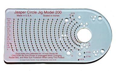

    I also need to get a 3" hole saw, or a Jasper Jig so I can clear out a hole for the trackball, route away the top for the trackball mounting plate, and any underside clearances needed. I've got a mounting plate on order from Suzo Happ, and I want to get that in-hand before I start cutting anymore from the CP.

    Progress Since Last
    I have cut all of the exterior MDF components and begun laminating parts in black or white Wilsonart countertop laminate. I done goofed by laminating the upper, exterior surfaces before assembly... meaning now counter-sunk screw heads will be visible. Let the lesson to the reader be: if you assemble before the exterior surface is laminated, you can hide those fasteners.
    I have used a Jasper Jig to route speaker holes as well as counter-boring to recess the speakers up into the cabinet by ~0.5".
    After I finish laminating, I plan to chamfer the compound angle joints into the pieces with a table saw... and then it's time for assembly!
    If other threads are any indication, either things move very quickly at that point... or posting updates becomes a hassle.
