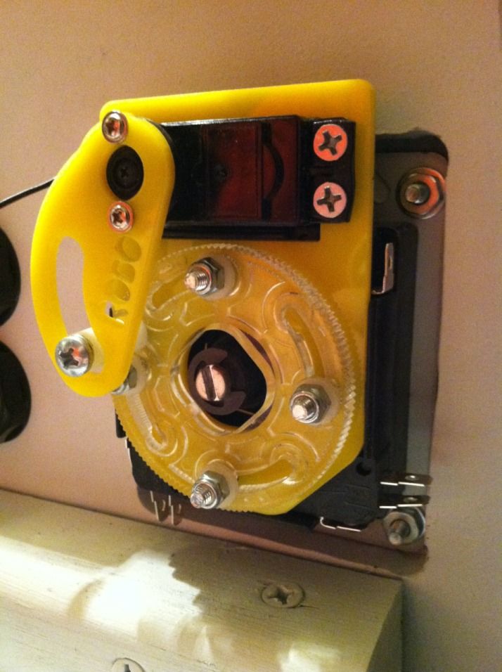

Also, I am excited to show off some new prototype hardware from Groovy Game Gear.  I would like to present the Omni2 ROBO!
The Omni2 ROBO is a great solution for those looking to automate their OMNI2 but were put off by or too busy for the servo mounting and actuating arm fabrication.  The two ROBOs came with servos and a Micro Maestro servo controller.  From there I just added a 6v power supply and used a super simple script in conjunction with DaOld Man's joychoose to automate the switch.  Ideally I'd say these would be mounted on a metal CP but you can see how I did on wood.  Hopefully long handles will be available so one could just do a super simple bottom mount with threaded inserts and call it good.  There is a slight overhang where the servo isn't covered by the mounting plate but this is a minor issue to a really fantastic solution. I have no clue if Randy is going to market these as a stand alone project or make them available as kits but he's got a really good product here and what's great is that the micro controller can run up to 6 of them at once.
Here's a video with me narrating like a moron but you can check out the motion:
http://s479.photobucket.com/user/vonjett/media/Fieldhouse/316E3A99-E513-4DF3-95C9-C848B9005CF9-5083-00000E21566A6AD7_zps6b6169f4.mp4.html
Sorry it's not embedded.

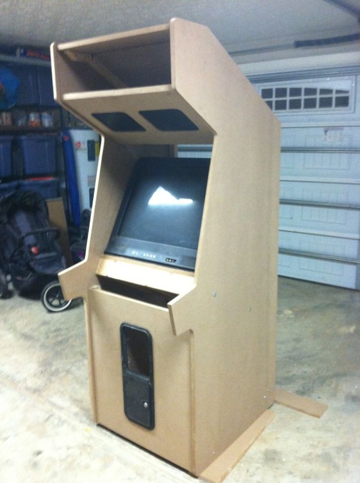

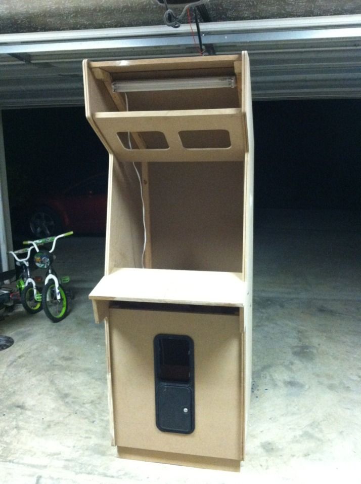

Scored the TV off craigs for $20.  It worked fine at the seller's house, got it home and it started showing classic signs of needing a cap job on the vertical.  I'll crack it open and see if one is bulged, if not I'll probably just replace the lot.  I toyed with decasing but its a slim case on as far as width goes so I'm not really gaining any space by doing it.  Makes it easier to replace for the user later on down the road like this anyway.
I wasted an afternoon building a super sturdy awesome 5" base only to determine it was a bit too narrow to feel stable and about two inches too tall to be comfortable.  Was able to make use of 80% of the wood from the effort but was kicking myself for not stacking some wood up just to test height first.  Live and learn.
The build can be dismantled as I'm using threaded inserts throughout.  It ran about $50 in hardware to do it that way but I like it better than screws, it's rock solid, and it can always be flat packed and put in a conex to take to afghanistan or something  ;D
Still to do:
remake the base - shorter and fatter
mount marquee light
fab marquee retainers
fab CP box
route for t-moulding
glue in guides for bezel glass
complete art
disassemble
paint
reassemble
do all that other arcadey stuff that always happens

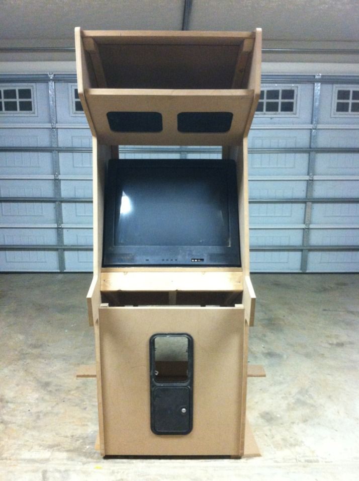

Got a fair amount done after work today.  Fixed the base, did some more on the monitor mount, cut the top of the CP, wired and mounted the marquee light, cut and formed the marquee retainers, routed for T-molding, fell asleep at the wheel and totally borked an 8 inch section on the front while routing, did all the sanding and patch work, filled the borked area with wood filler so I can retrain on routing.

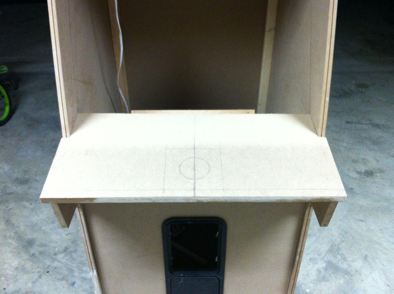

Top down detail of the CP.  I'm trying something a bit out of left field with this one but think it will blend well and have nice curves.  I need to cut the front and bottom pieces but can't put it all together until I get in my parts to route and test fit all the components.  I've got my dimensions sorted in my head tho so I can start on the art finally.
Still to do:
complete CP construction
get glass cut
complete art
disassemble
paint
reassemble
cap the tv
Anyway, let me know what you think!

do you want constructive criticism or kiss ass comments?
It may be the camera, but the top of that thing doesnt' look proportional.  It's like you modified it to fit those humongous speakears.
Dunno man, I'm sure you'll make it look pretty in the end, otherwise good start....

Can you closeup the TV mount?  I'm sitting on several TVs and I'd like to convert The Blue Pill when it's moved.  I just have no experience with TVs.
You da man.  Looks good so far.  Love the fact that it can be brought on deployment.
Depends, was that the kiss ass comment?  :scared
Seriously tho, that's good feedback.  I used the Centipede cab design as a heavy influence and I have a pechant for large marquees but I may have missed the mark.  We'll have to get it all put together and see how it fits.  I think the bezel will help balance everything out but it might have to be addressed.  I don't see an imbalance myself but I'll be looking for it now.
AJ
Thanks.  I will post up some more, I have one more support peice to make and then I'll post pics of the mount with TV and w/out.  What you're looking at is a heavy duty shelf on carriage bolts at a 30o angle.  The client is tall so I wanted to give him the best viewing angle I could based on his other goals for the cab.
