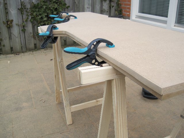

I bought some MDF (I will use 15mm and 12mm)...

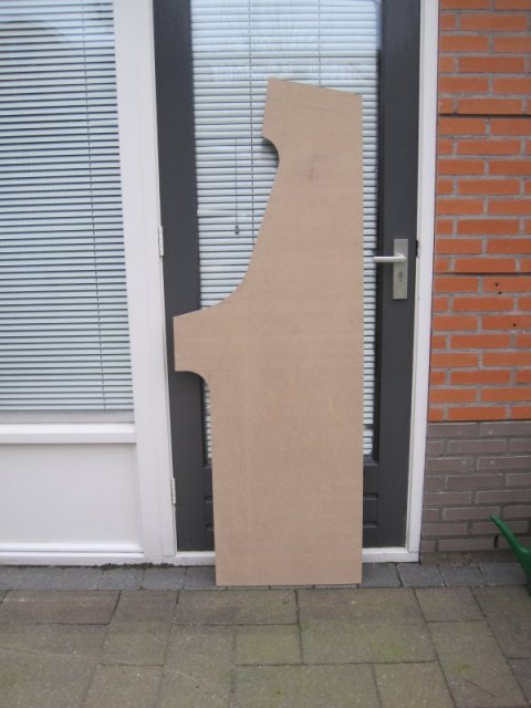

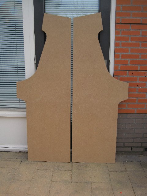

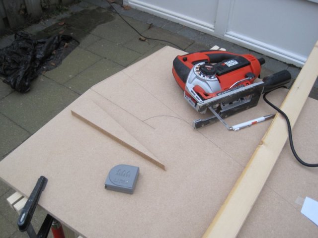

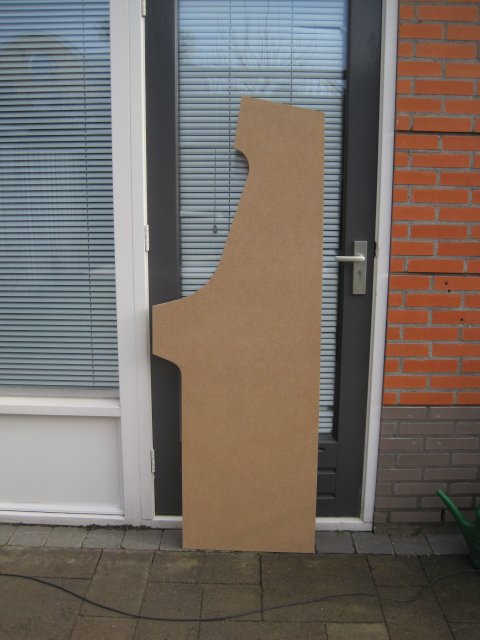

Drew the first side panel...

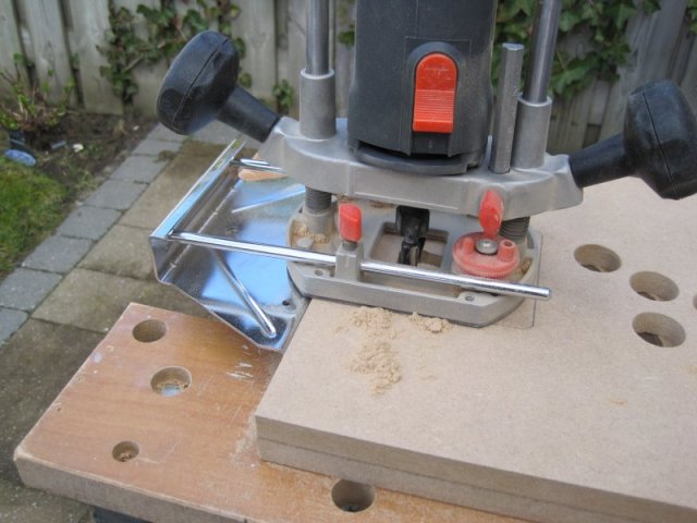

My first attempt was not a success as I tried to fully cut it out using the jigsaw. I messed up the smooth curves. I put too much pressure on the saw messing up the angle of the cut.  :angry:
After some more reading I figured I would use a router. I never touched a router before so this was an adventure on it's own. I'm no wood worker at all being a software engineer all my life...
I first roughly cut out the full shape using the jigsaw and afterwards used the router to trim it to its final shape. Routing was really easy and fun. I will use that baby a lot from now...
And there it is. The first part is done.

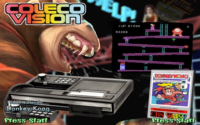

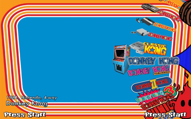

Time to do some more reading, planning and testdriving my Hyperspin setup. I Compiled my own version of MAME with highscores and no warning screens and fired up good old Donkey Kong. It must have been about 30 years ago I played that machine after my soccer practice. Still great fun. Even my kids enjoy it as much as their Wii and iPad.

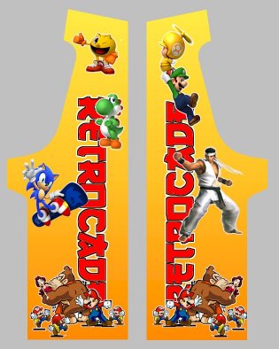

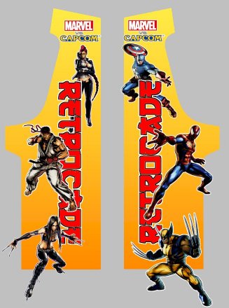

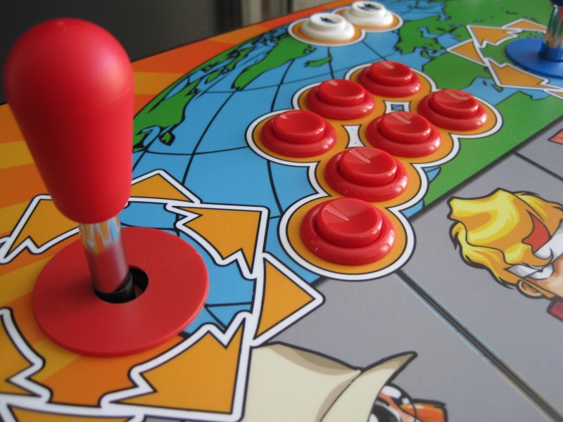

I played around with Microsoft Image Composer to create some basic prototypes of the sideart. I know, it's a bit early after only cutting out the first side panel but I wanted to visualize some thoughts.
I fell in love with griffindodd's Marvel v Capcom: Revolution artwork and tried to reproduce it using the RetroCade title:
Then I tried some other background coloring and other characters:
Did a quick marquee too:
My son of 6 liked the first one (Red Marvel vs Capcom), my daughter of 4 the last (Yellow-Orange Nintendo). I'm not sure myself. The last is a bit more unique although that's not a big deal for me. Luckily I still have lots of time to decide...

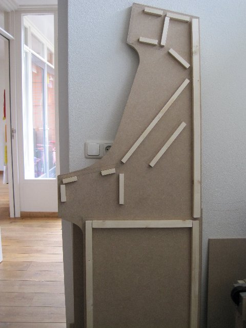

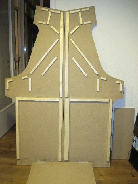

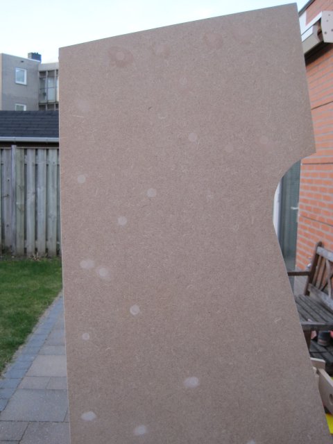

Today I re-did the side panel. I did not like the curve below the control panel. Very small change but so much better. I'm glad I did it.
I then drew the dimensions of the first panel to the piece of MDF for the second and roughly cut it out with the jigsaw.
Now I need a copy-flush bit for my router to flush-copy the first one. I don't have one large enough. Let's hope my father-in-law has one...

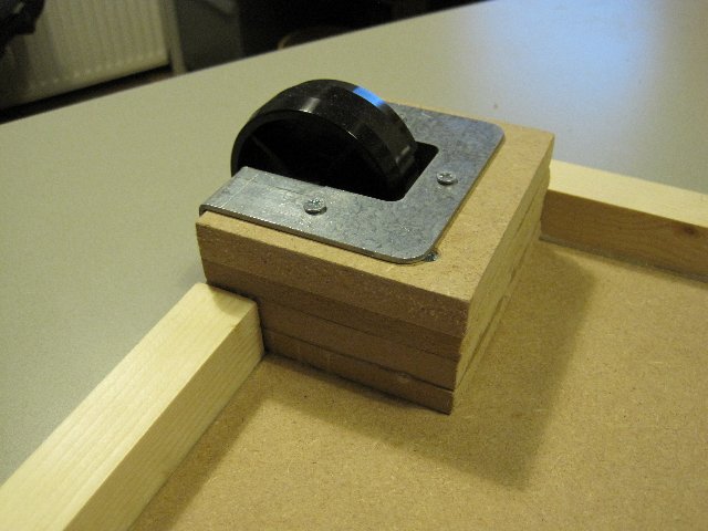

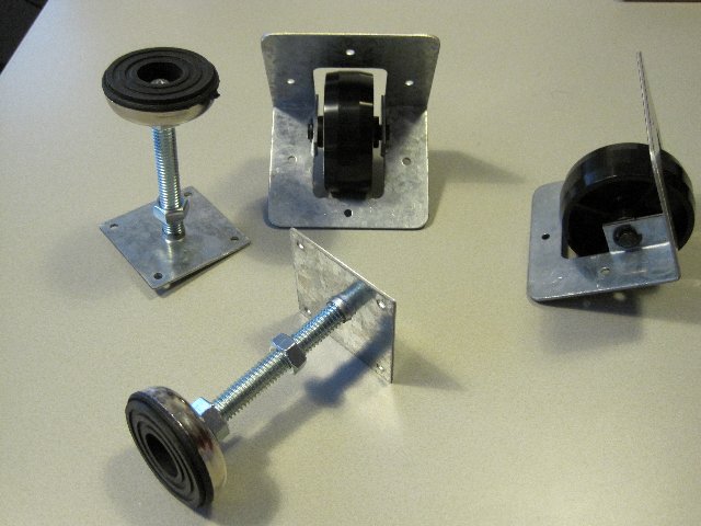

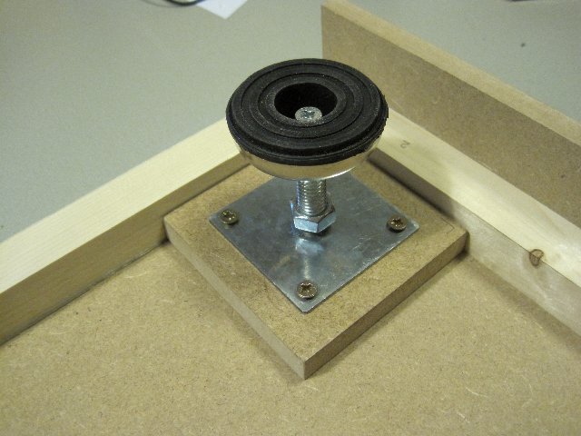

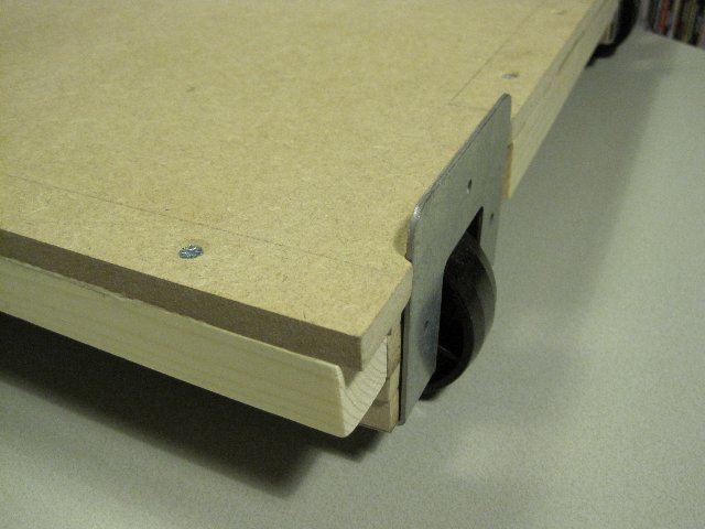

I received the wheels and leg levelers. I have to figure out how mount them properly.

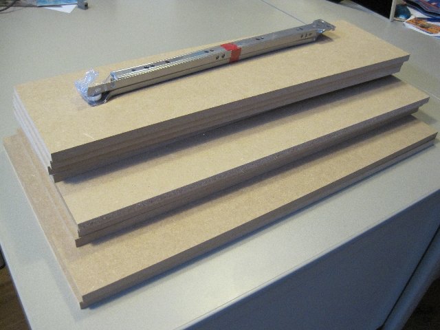

Picked up the remaining pieces of MDF. I had them cut to the correct sizes in the store where I bought them. Also got the rails for the keyboard drawer.

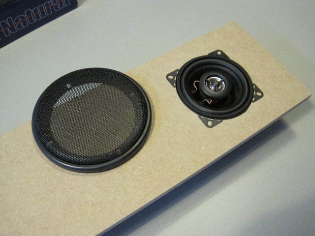

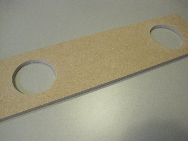

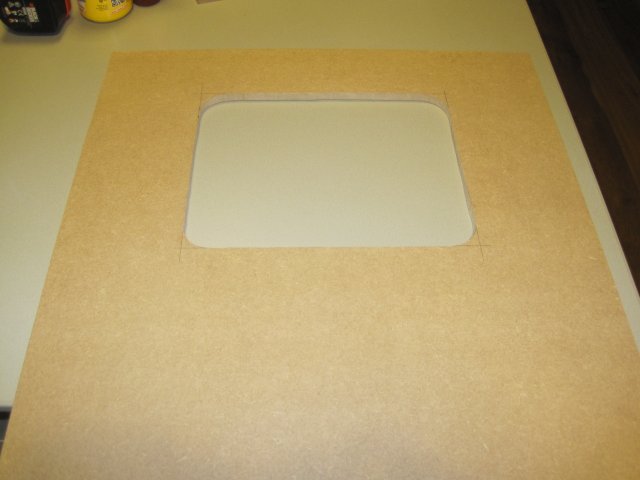

I received the speakers and Amplifier. 2-way 80 watt Car speakers and a 12V 2 x 50 watt amplifier should be sufficient:
So I routed the holes in the speaker panel:
Perfect fit...

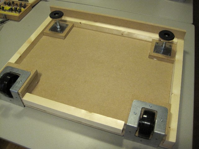

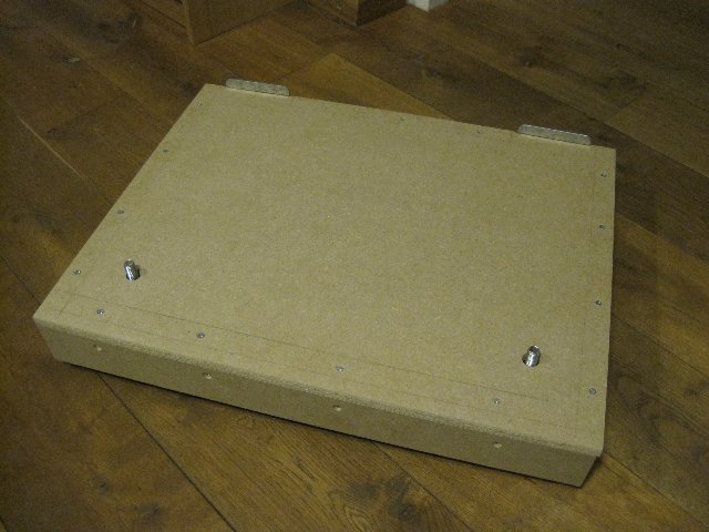

Today I finished the bottom plate:
The wheels stick out the back a bit to let you tilt the cabinet to the back to easily move it (there will be a handle at the top of the back panel to pull it backwards to tilt). The levelers let you level the cabinet while standing and prevent it from moving.

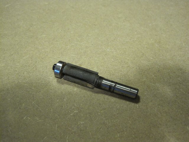

Luckily my father-in-law had a flush-trim-copy bit so the next step will be to copy the second side panel...

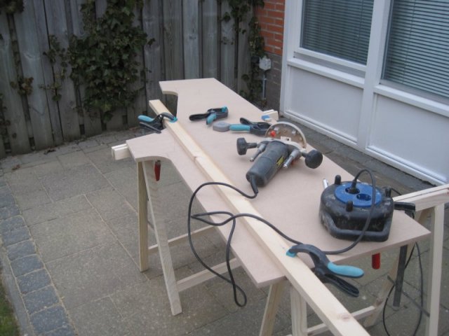

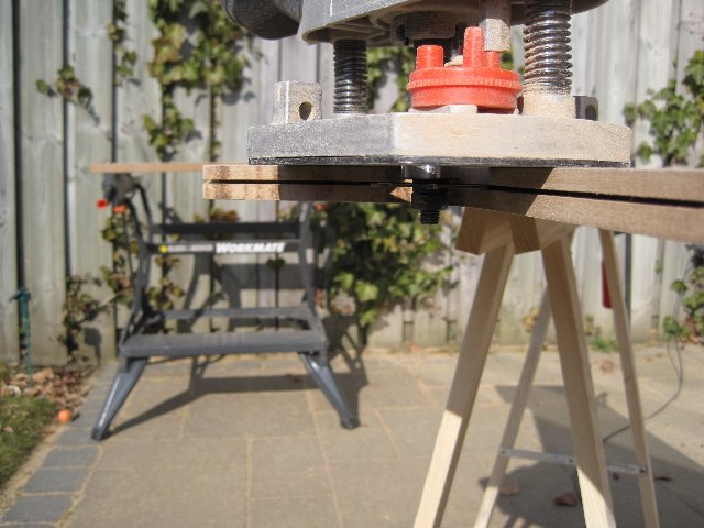

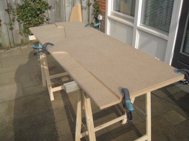

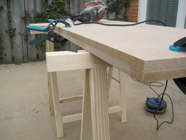

Copy time. I Put the two sides on top of each other and use the flush copy bit to exactly match the second side with the first.
Fast and easy with very nice result.
Twins  :D

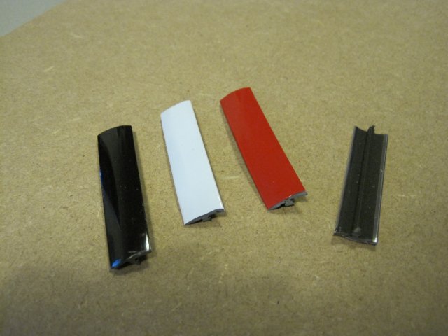

I ordered some samples of 15mm T-molding (which seems kinda rare) at ArcadeWorldUk to see what slot cutter I need to route the T-moulding...

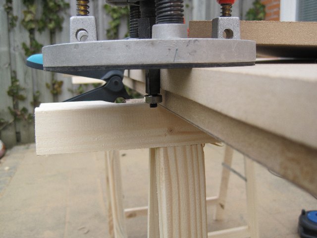

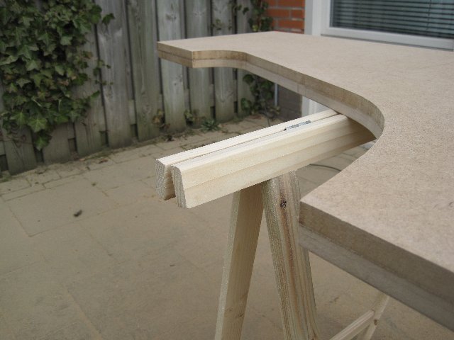

I received the 15mm T-moulding samples and made a 2mm slot test cut with a slot cutter I could borrow. I could apply the T-moulding with very little pressure. It will definitely not stick.  :angry: So I decided to order a 1/16" slot cutter bit online. The shipping was way more expensive than the bit itself  :angry:

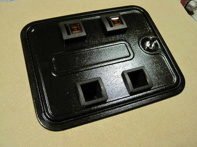

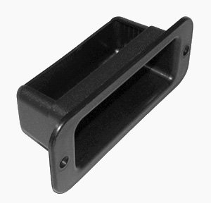

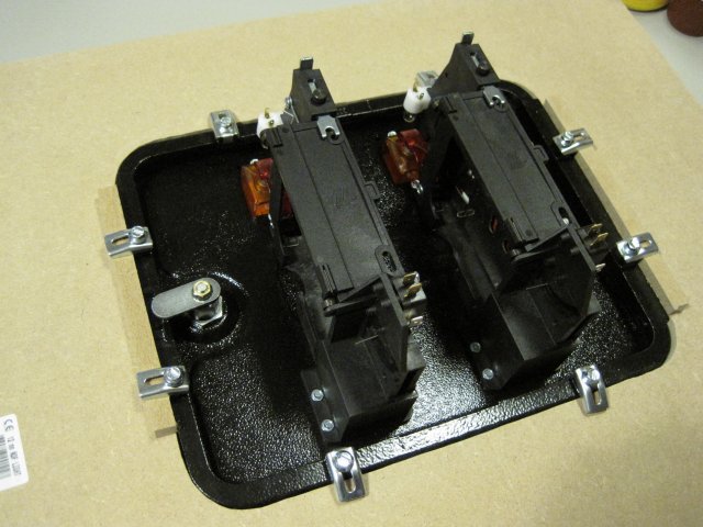

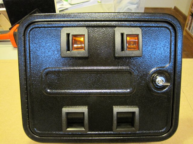

Started on the front panel holding the coin door. I bought a double coin door with only one mech. The coin mech works fine with 50 eurocent coins. I drew the dimensions using a beer glass for the corners.
Now waiting for better weather to be able to work in my outdoor workshop again.

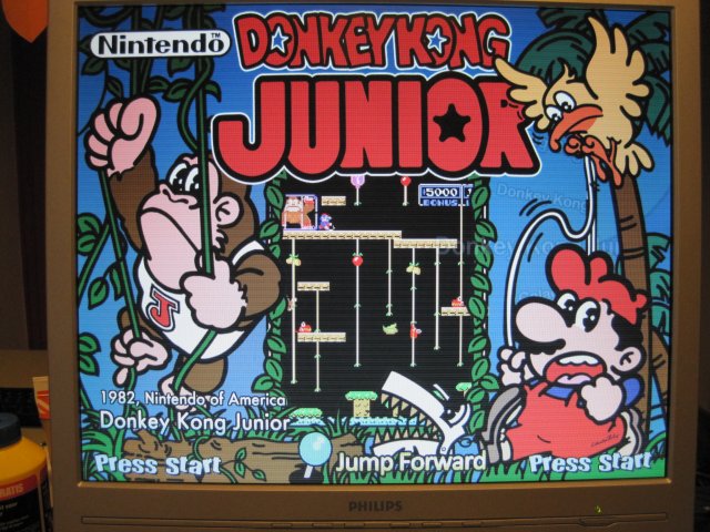

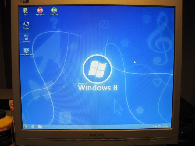

I copied Hyperspin (with the configuration I already did on my PC) and gave it a try. Hyperspin launched but did not go into the MAME sub menu. I could not figure out what was going wrong as exactly the same config worked smooth on my PC. Was it Windows 8? Google finally helped me (as always): Hyperspin won't work without speakers connected  :angry: When I first read the solution I thought I was being played but I found the same solution on several other sites so I decided to give it a try. Hyperspin and MAME worked like a charm...

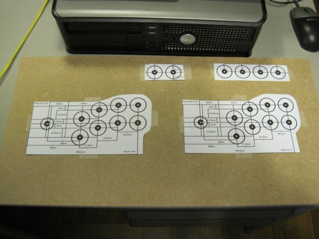

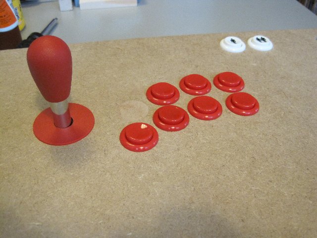

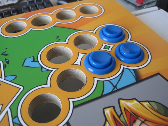

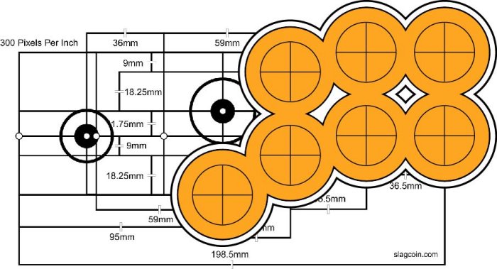

Then I started thinking about my Control Panel layout. I want 2 players, 7 buttons each, 1 and 2 players buttons and 4 admin buttons. Coin buttons I do not need as I have my coin door with mech. I probably add some secret shifted coin button bypass if I run out of 50 eurocent coins myself ;D. Maybe I'll add some pinball buttons to the sides too.
« Last Edit: November 03, 2017, 01:31:11 pm by EMDB »

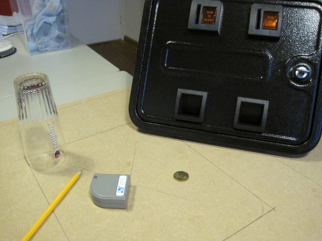

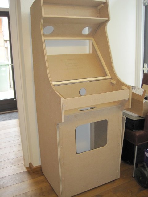

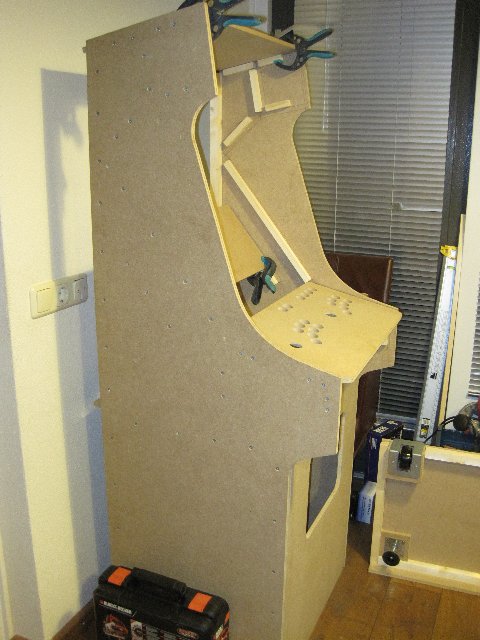

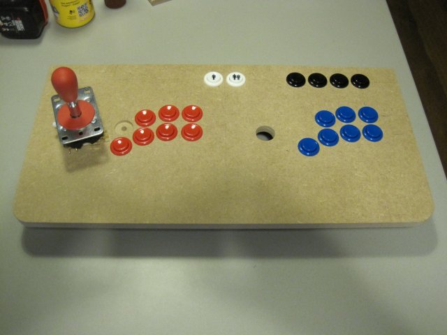

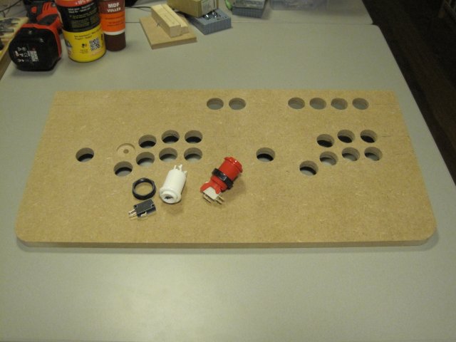

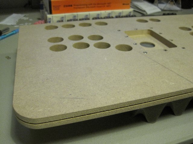

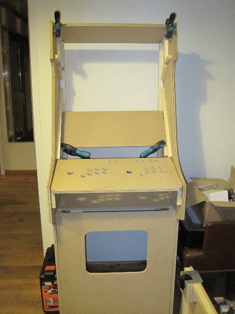

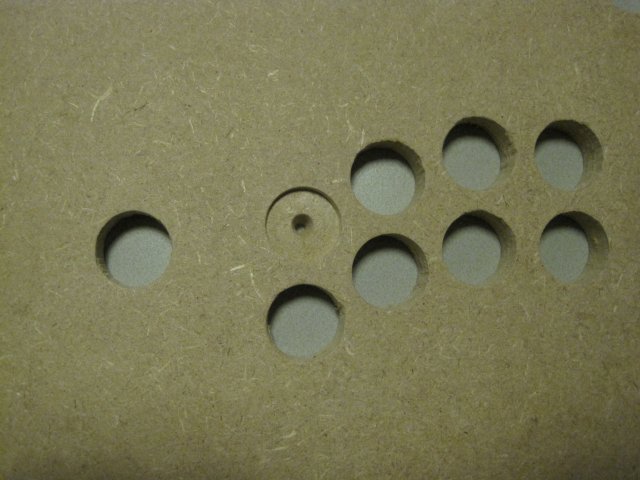

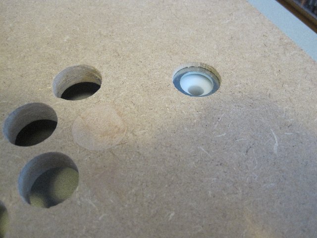

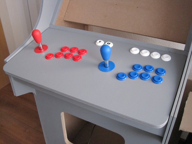

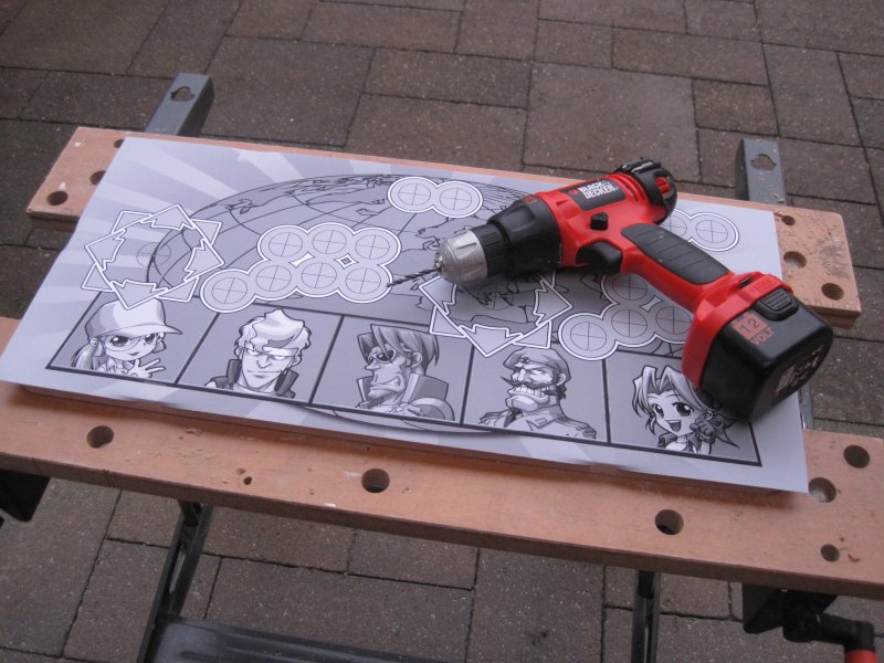

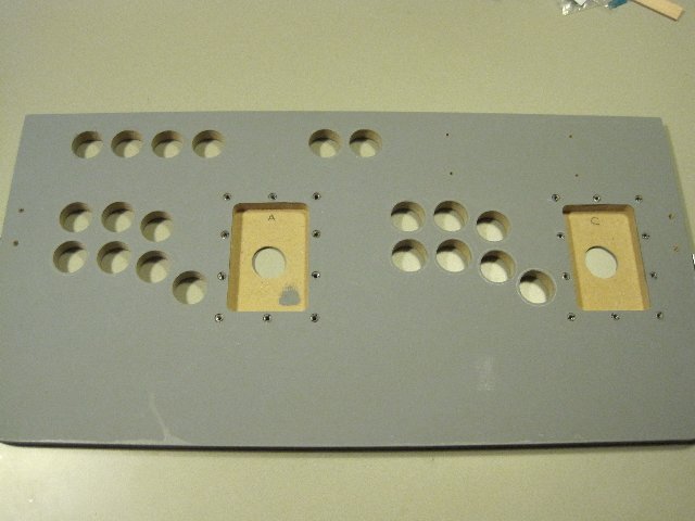

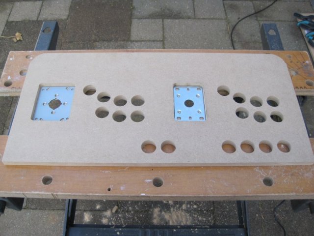

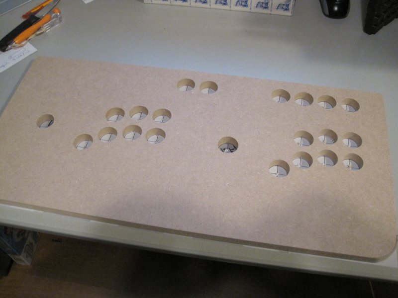

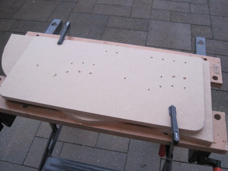

Today I drilled the holes in the CP and cut out the hole in the front plate for the coin door.
I knew I should not have used the 8 button layout template although I was certain I would not drill the 8th hole. I drilled from two sides to make the cuts smooth but had the panel upside down when I did the first part and skipped the wrong button position. Well some MDF putty will hide my mistake  ;D
The coin door fits perfectly.
I like the layout of my CP. The black buttons will be admin buttons. 4 will be plenty but you never know...

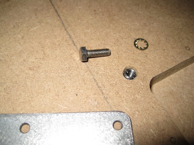

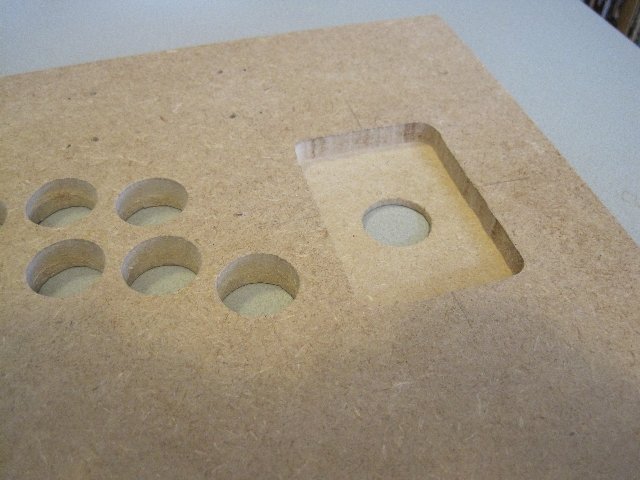

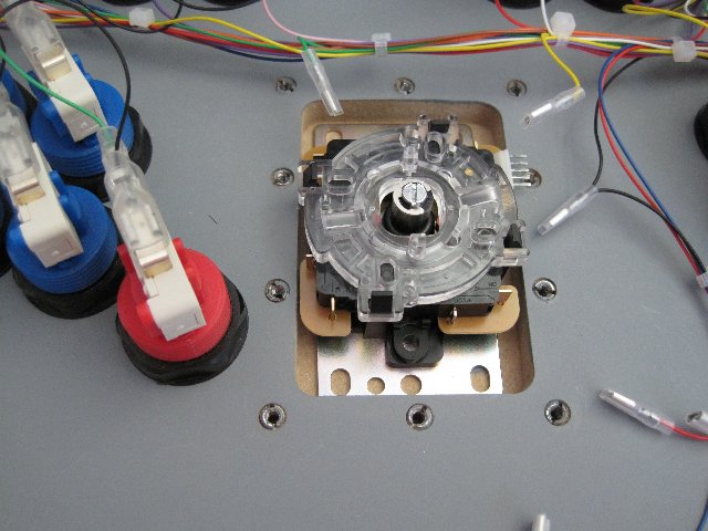

Now I have the think how to mount the sticks. I don't want to mount them sunken on the top as I don't wan't to cover them with putty so I can not re-use them if I want to change the CP.
I'm thinking about routering a sunken part of about 10mm from the bottom and fixate the sticks with a bracket so no bolts or whatever will be visible from the top. Any thoughts, examples or other options?
« Last Edit: March 05, 2018, 01:45:34 am by EMDB »

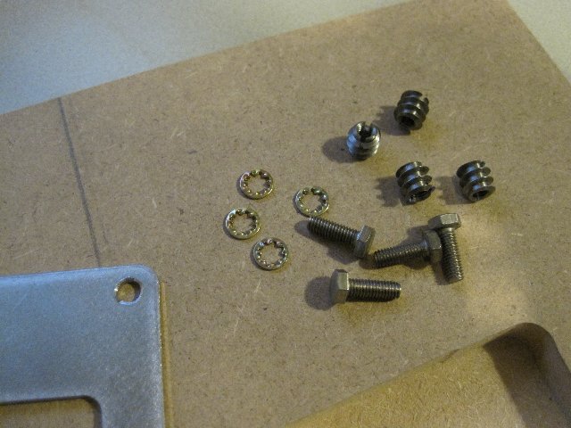

Your choice of top-mounted + countersunk T-nuts (a.k.a. tee nuts) or threaded inserts from below.
One word of warning, the GGG insert screws stick out the back of the inserts a little when used with a metal mounting-plate joystick like yours or the Zippyy.
If the routed area is already shallow enough for that to make a difference, you'll probably want to use the tee nuts.
EMDB
  • Posts: 865
  • Project RetroCade
Re: Scratch Build: Project RetroCade (in progress).
« Reply #16 on: March 13, 2013, 06:54:51 pm »
Thanks. Do you have images of mounted plates as I can not understand how these work exactly.
  • Posts: 9752
  • Last login:Today at 12:25:22 am
« Reply #17 on: March 14, 2013, 02:30:35 pm »
GGG inserts look like this when installed -- bottom view.
Tee-nuts installed from the top look like this -- top view.
If you don't use plexiglass over your CP, you will want to use bondo (or similar) to make a smooth surface over the tee-nuts for your overlay.

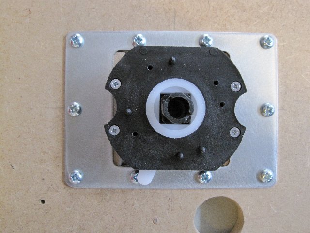

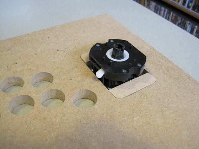

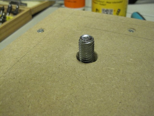

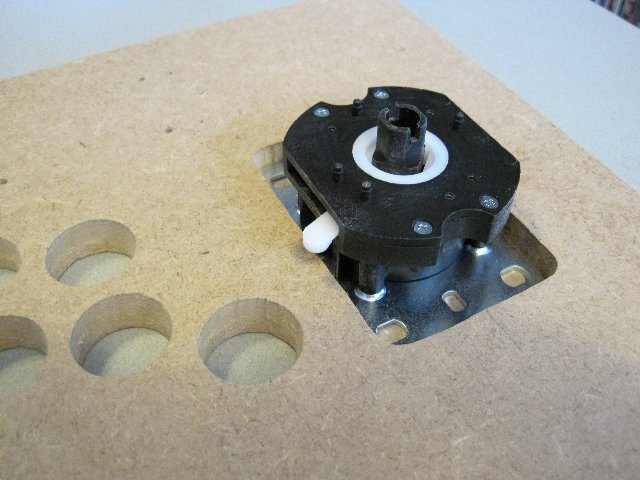

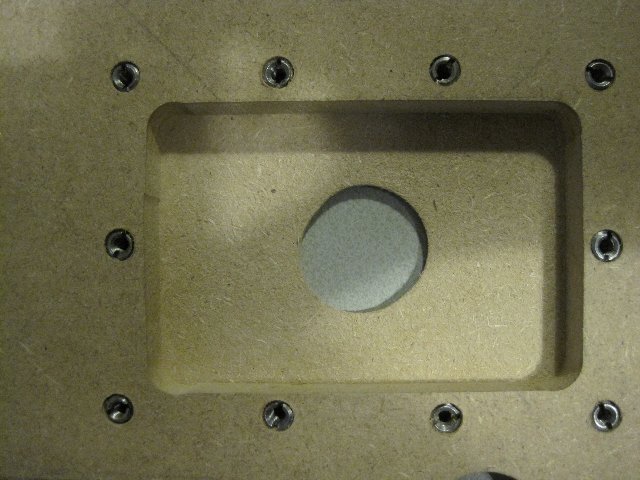

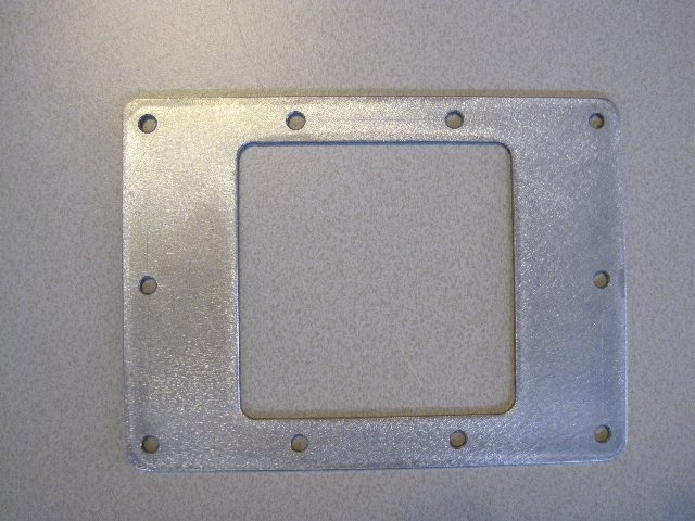

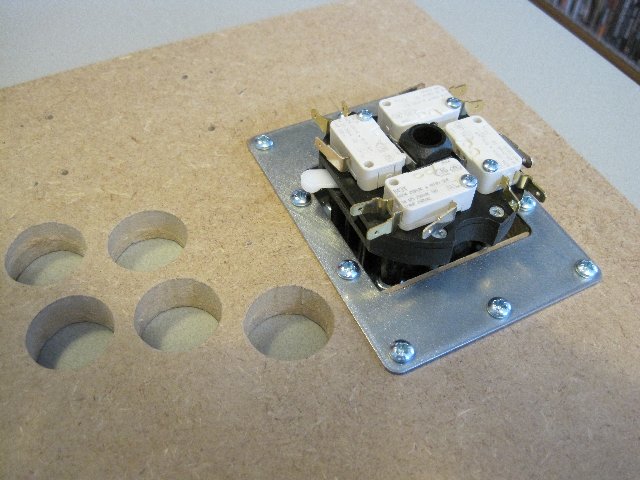

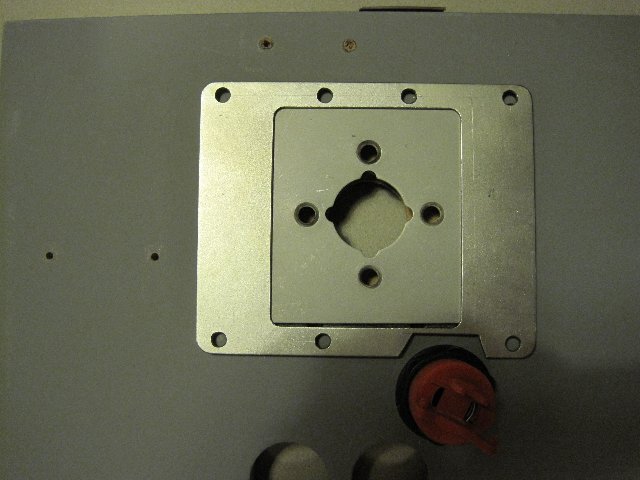

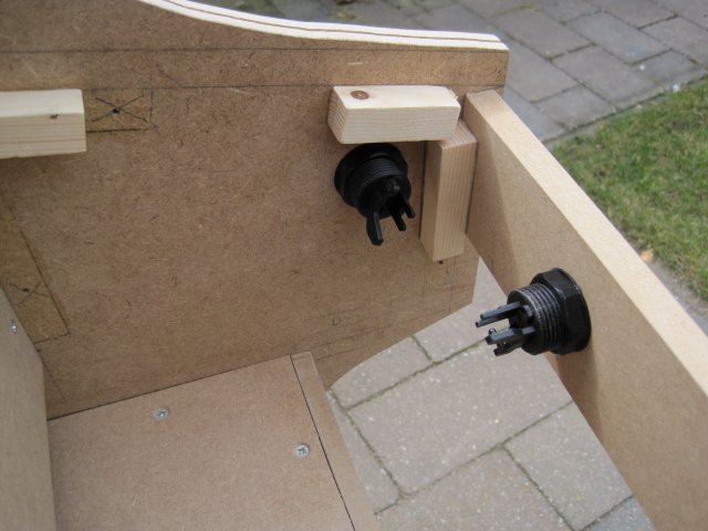

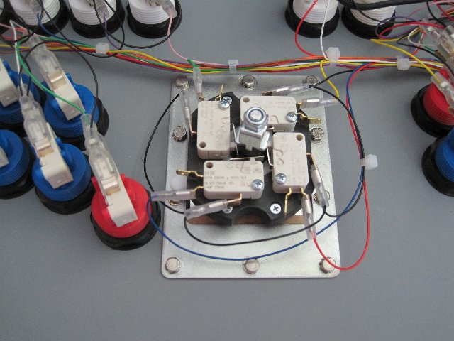

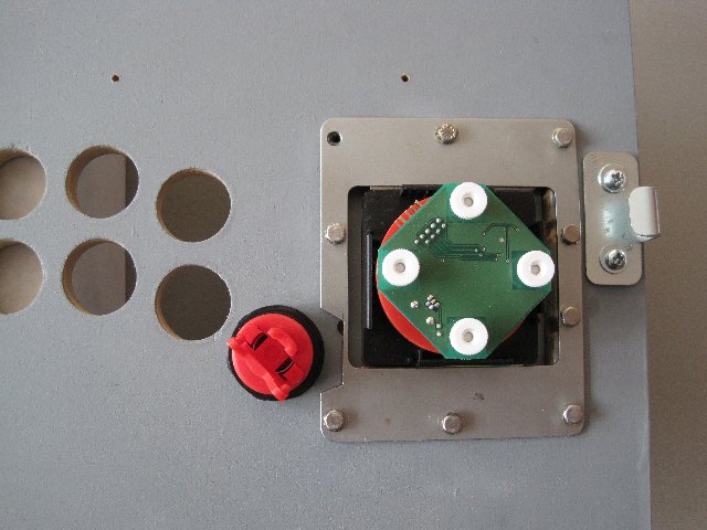

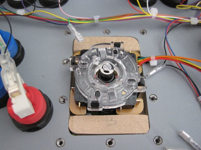

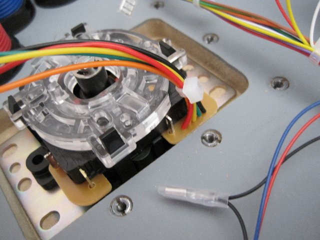

I finally found some time to work on the mounting of the joysticks.
First I routed a 12 mm recess at the bottom side of the CP. The CP is 15 mm thick. Perfect fitt for the joystick.
Filled up with small blocks of MDF just a tiny bit above level with the CP.

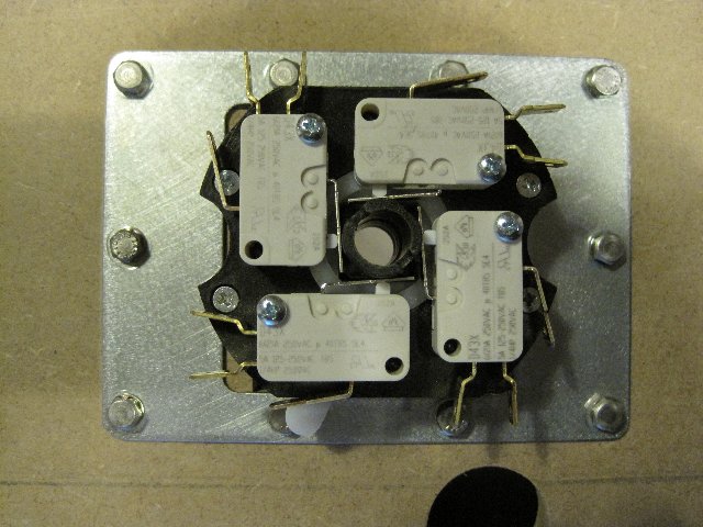

I had my brother made two metal plates to shut in the joysticks.
Mounted without any bolts or other visible stuff on the top of the CP and easily removable without any damage, putty or whatsoever...  8)
Next up: routing for T-moulding.
Nice plate.  :applaud:
Please tell me you aren't using wood screws to hold the plate to the MDF.   :dizzy:
Wood screws into MDF *might* seem to work the first time, but they *will* shred it to fibers and strip out easily when you remove/reinstall or re-tighten them.
If you used the threaded inserts and machine screws mentioned earlier around the perimeter of the plate, it will work fine for many dis-assembly / re-assembly cycles.
EMDB
  • Posts: 865
  • Project RetroCade
« Reply #27 on: March 24, 2013, 05:43:05 pm »
They aren't regular wood screws *and* I will fixate them with glue after final mounting. The will not be disassembled afterwards but if I decide to redo the CP after some test driving I can easily do so. And with this way of mounting the stick is only 3 mm (less than 1/8") below the CP surface.
  • Posts: 9752
Re: Scratch Build: Project RetroCade - (slowly) In progress...
« Reply #28 on: March 24, 2013, 06:34:43 pm »
Regardless of what kind of thread geometry a screw has, with MDF you can only tighten it reliably ONCE.   :banghead:
When you loosen and retighten any thread geometry in MDF it pulps and strips it.
Also keep in mind that anything mechanical like a joystick will eventually break down or require alignment.
Which scenario sounds better to you?
1. Being able to remove and reinstall a handful of machine screws from threaded inserts to swap a joystick without damaging the MDF because the inserts stay properly tightened into the MDF.
2. Having to remake/refinish/re-CPO the entire CP because the joystick mount screws stripped out.
You might not have to face #2 for a while, but using screws directly in MDF makes it a guaranteed eventual outcome.
I will reconsider mounting the plate with machine screws and inserts. Thanks for your persistence  ::)

Drnick
  • Posts: 1642
  • Plodding Through Life
« Reply #30 on: March 25, 2013, 05:27:14 pm »
That is brilliant. I mounted mine from underneath as well but could only route about 5mm rather then the 12 or so that you have been able to route. I would definitely second the inserts, I am so glad that I used them for my joystick.

I finally found inserts in a local hardware store. I tried 5 mm ones but the 8 mm I had to drill to fit them in and the holes of the previous screws screwed up the MDF around the routed area of the joystick  :angry:
So I created another CP, drilled all 22 holes and routed the two joystick areas. I'm getting pretty handy with this  ;D This time I used 4 mm inserts and tried them on a spare piece of MDF first. All went well so I dared to put them in my just finished CP. It was quite easy and now I have joysticks which are easy and safe to remove multiple times. Thanks again PL1 for pointing this out!
I received my Slot cutter but the 1/4" (6.3 mm) shank does not fit in my router which can only take 6 or 8 mm shanks  :o  I asked my brother to let the shank be reduced to exactly 6 mm. So still no T-molding routing...

Sorry it took so much extra effort to get the inserts working, but the latest revision looks really good.   :cheers:

Today I did the routing for the t-moulding on the side panels and the CP. It was quite easy, once using the right tools.

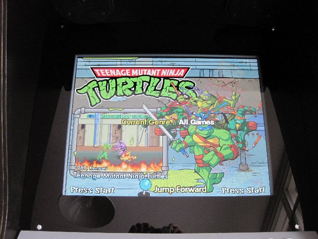

My kids did some Hyperspin testdriving. I think the setup will work just fine on the actual machine...

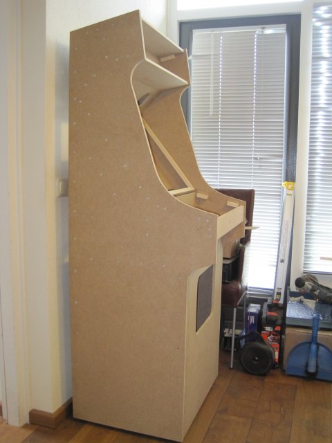

Today I "framed" the first side panel. It was quite a puzzle to measure and fit everything. I had to deviate from the original design to not let the marquee retainers stick out, better position the plate to cover the monitor and leave the bottom of the CP off to be able to reach the CP clamp I want to use...
« Last Edit: November 03, 2017, 01:42:13 pm by EMDB »

I framed the second side panel. I'd better drilled the holes for the bars through both panels at once. Now I had to re-measure (and mirror) everything again. After some corrections they now match perfectly.
I couldn't resist quickly assembly the main parts to get a first glance on how my cab will actually look. I really like the shape and the actual size  :applaud:

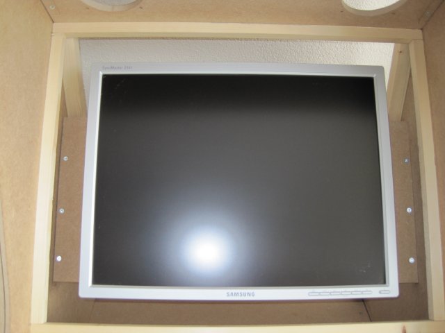

From this first impression I noticed the plate the monitor is going to be mounted on has to be a bit higher than the original design. Both Rasmus and Remco used a 19" 4:3 one, I scored a 21.4" 4:3 Samsung SyncMaster 214T. Those large size 4:3 monitors are becoming quite rare here in the Netherlands.
I'm not sure whether to first mount the drawer and CP clamps or just assemble everything and mount them afterwards...
« Last Edit: November 03, 2017, 01:42:56 pm by EMDB »

1) The art, I like the last one the best...with Pac-Man, Yoshi, Donkey Kong, etc.

3) Why did you go out of your way to install windows 8 for the build? Seems like windows 8 will be more of a hassle, when if comes it hiding windows when everything is done. Are you going to try and hide windows?

1) I'm not sure about the artwork. I was just playing a bit. Maybe it will be completely something else.
3) I had a Windows 8 USB installer laying around. And Windows 8 boots very fast. I did not look into hiding windows yet. I want to start HyperSpin as Windows Shell in stead of the desktop as I did with XBMC on my media center PC.

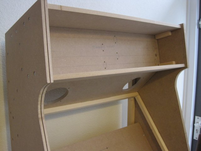

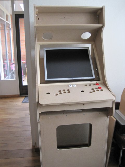

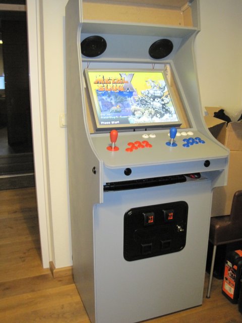

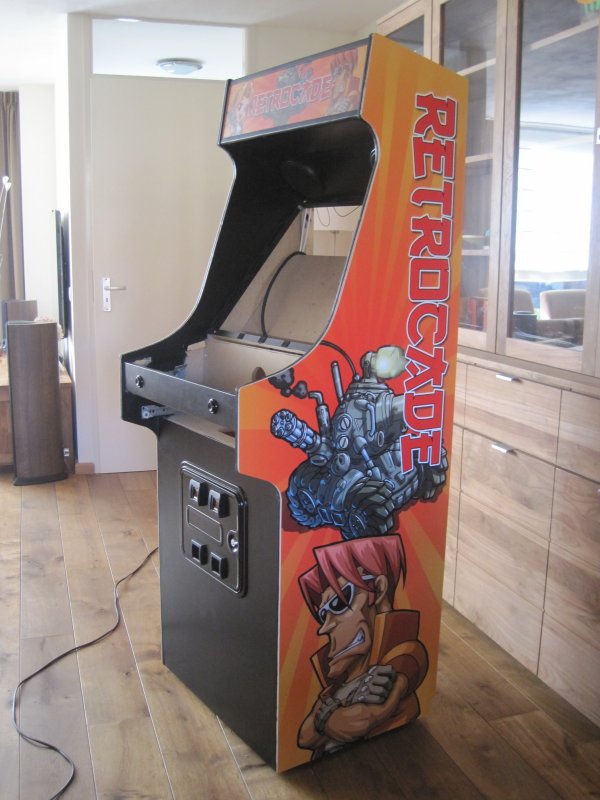

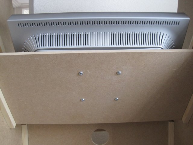

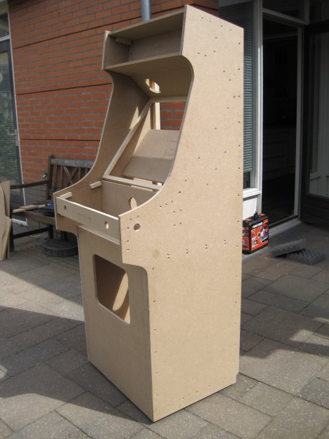

After all preparation work I could finally start assembling. Almost everything fitted as designed and with a little bit of adapting i'm quite happy with the result...
Mounted to monitor to get an even better impression. It could have been even bigger but I think 21.4" is the biggest size 4:3 around?
After some small additions (pinball buttons on the side panels and two extra Admin buttons on the panel below the CP) I can get started puttying, grinding and adding some layers of primer. That seems to be the least fun part of the project...
« Last Edit: November 03, 2017, 01:44:08 pm by EMDB »

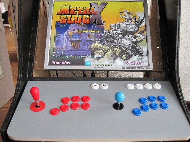

Did some short test driving. The wheels and levelers are awesome. It moves around easily once tilted to the back but when standing it is rock solid.
The total height and control panel height (although still played with a keyboard) is ok but when playing the monitor is too low. The angle seems fine. I can very easily move it up a bit though, it's just mounted by 4 machine screws in the monitor back plate as the monitor has standard VESA 100 x 100 mounting...

Today I did some small modifications to the cabinet. First of all I had to correct a design flaw: The cabinet could not be tilted enough to move it around. The back of the bottom construction is not the absolute back as the bottom back plate (actually a door) will be mounted behind it. Therefore the wheels did not stick out enough. I fixed it by removing a small part of the bottom side panel at the back. Now I can tilt it almost horizontal...
While I was busy I added some holes for the pinball buttons and some extra admin buttons and added an extra cable guidance hole in the plate in the middle of the cabinet.
Then I checked the speakers and marquee light mounting. Perfect fit.

It is possible to navigate 90degree corners with T-molding, and have it look nice.  Ensure the molding is warm and pliable prior to installing, this will make it conform easier.  Take a look at my build, I have exterior 90degree corners (not rounded at all) that worked out perfectly.  Interior corners would be trick, but still doable.  Good luck!
http://forum.arcadecontrols.com/index.php?topic=129725.0
« Last Edit: April 13, 2013, 04:49:16 pm by a1pharm »

Look at the snips I used with my T-molding.  I showed close-ups of how I snipped some of the ribbing off the molding.  You will almost always need to take off more ribbing than you think.  The 3mm section of molding that navigates the corner should be completely devoid of ribbing (you may even want to "dig" the ribbing out in that area - carefully) to prevent improper laying of the molding around the corner.

Some more beta testing. It seems the cabinet has just the perfect height for my kids... With some help from a chair  ;)

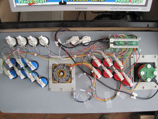

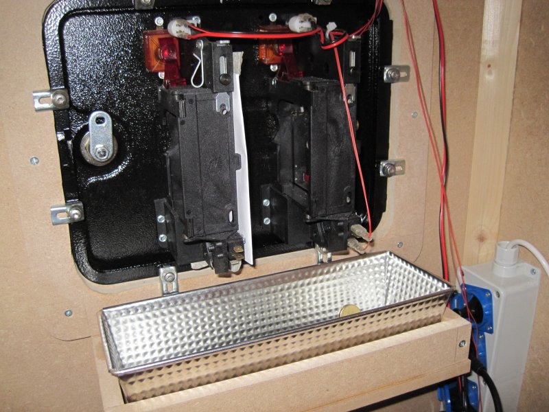

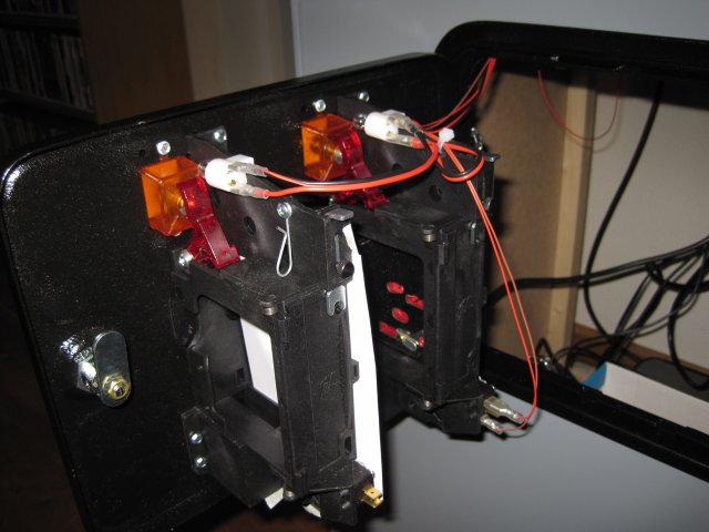

I added a frame to the front panel to be able to mount the coin door. 12 mm was too thin to hold the clamps.

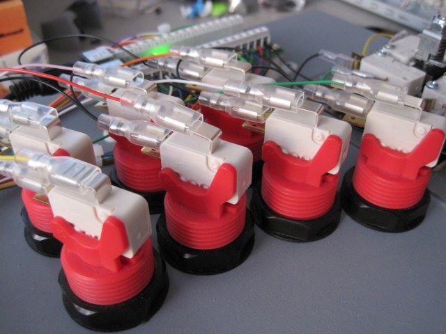

Then I wired the CP. Every micro switch connection is soldered and has an isolation sleeve.
I played a bit connected to my desktop computer. First impression is great. The Mag sticks are nice, button layout is great. I'm considering using the original red-yellow-green-blue coloring for the bottom row of buttons although I like the clean red and blue sections too. I never controlled MAME using joysticks/buttons, I have to get used to using my left hand for the stick and the right hand for the buttons, on a keyboard it is just the other way around.

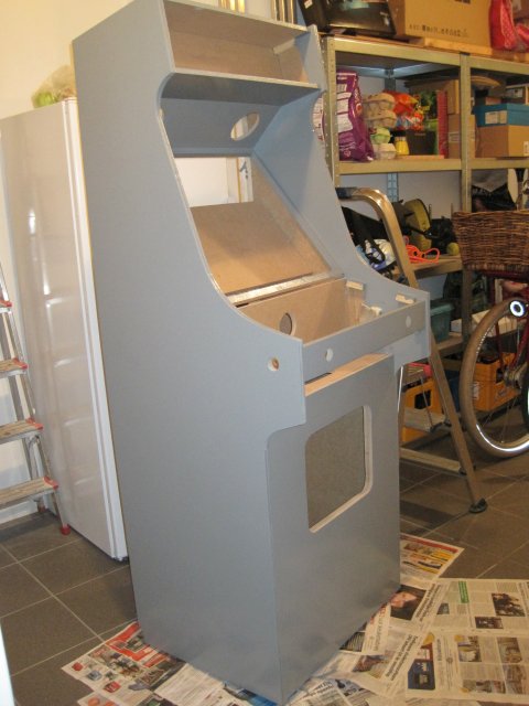

Sanded and fully cleaned with ammonia...  :dizzy:
Then applied the first layer of primer.

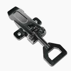

CP mounting:
When mounted it can be reached (and photographed ;D ) via the drawer opening on the front below the CP.
« Last Edit: November 03, 2017, 01:56:07 pm by EMDB »

« Reply #55 on: April 23, 2013, 03:58:36 pm »
My next CP will definitely be hooked like this. My actual design will require screw on top, wich suck....  :embarassed:
Your cab looks great by the way!

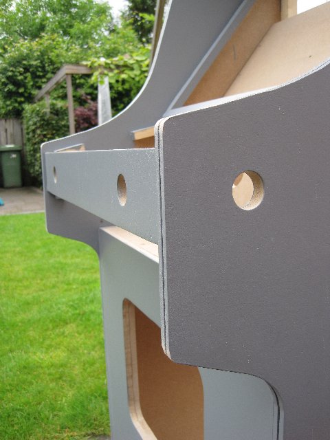

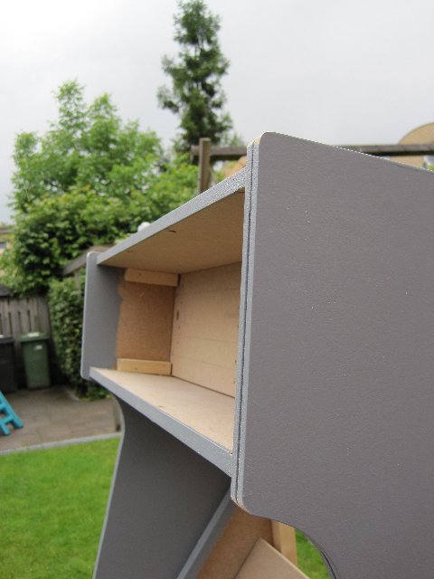

Sanded with very fine sandpaper, applied some more putty on last irregularities, sanded again, cleaned with ammonia :dizzy:
The surface is really smooth now. Then applied the 2nd layer of primer. This was much faster and more easy than the first one. The result looks very good. I think if this was the final layer of paint I would have been very happy.

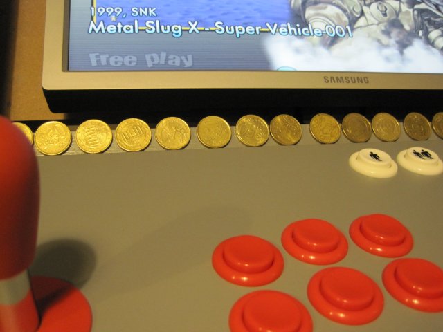

I beat my deadline by 2 days. Retrocade is far from finished but playable. After the 2nd layer of primer I mounted the speakers, monitor, CP, PC and coin door. Wired the coin door lighting to the power supply and connected the switch to the iPAC.
When configuring the iPAC for the coin switch I noticed the shift function did not work nor did some other buttons. After some checking I noticed I had the ground and connections swapped on the micro switches.  :banghead: After I corrected this everything worked just fine.
Then it was time... The moment I was working towards for weeks. I launched my favorite game series all times (Metal Slug), took a 50 euro cent coin, dropped it in the slot and...  OMG, What a great feeling!  ;D
Now I'm ready for my daughter's birthday party coming Sunday  :cheers:

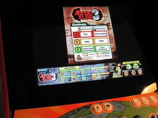

When I returned from a short holiday (at Tenerife) I found a package delivered at my neighbors. It was the mini-SLG scan lines generator (http://forum.arcadecontrols.com/index.php/topic,128970.0.html) I ordered a while ago to improve the genuine look and relief the PC a bit. I connected it, disabled scanlines in MAME and fired up some of my favorite games. They look awesome. The cascaded connectors (PC - DVI->VGA converter  - miniSLG - VGA cable) are a bit long...
The appearance is a bit hard to capture with the camera but it gives an impression:

coming along nicely. And how much do I like those sexy scan lines... :P :notworthy: ::)

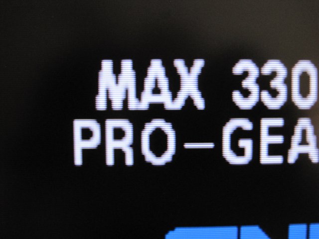

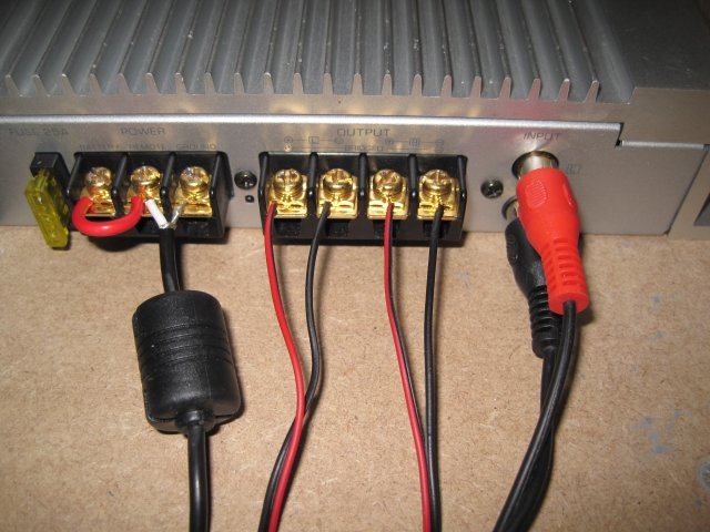

Today I picked up a new audio amplifier on marktplaats (Dutch national ebay). The one I bought originally had some zero level noise and was not very powerful. It sounded a bit poor. The new one is a Clarion APA2101 car amplifier and is very powerful and punchy  ;D  Even the connections are way better. I'm very happy with this upgrade, especially since I might use the cab as a jukebox once it is finished.
Size does matter...
« Last Edit: November 03, 2017, 03:11:29 pm by EMDB »

I played around adding support for Future Pinball. It's not that bad of an experience. I did not wire the pinball buttons on the side panel yet so I mapped them on the P1/P2 buttons 1 for now. I'm in doubt about adding extra buttons to support Nudge. I don't think I will play pinball that much and don't want my cab to turn into a pimped carnival attraction. I want the tables I am going to add to my launched from my Hyperspin frontend. Although there is no out of the box support I got it to work (not perfect yet, the table does not always get keyboard focus after being launched). Furthermore I can't find any decent Main Menu and System HyperSpin themes for Future Pinball. If anybody has some sources for these please let me know...

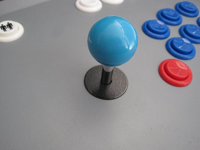

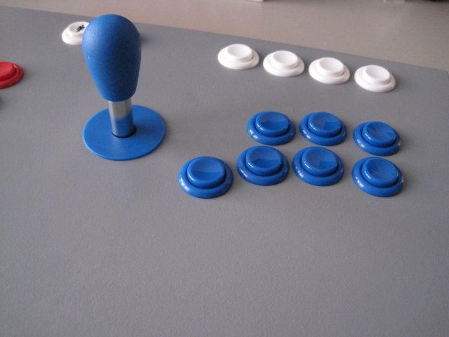

After playing some weeks I wondered how other joysticks would feel. The Mag Sticks are really not bad and although it is easy enough to switch from 4 to 8-way and back from the top I started to think it should be automated. My kids and guests don't understand the difference between 4 and 8-way. In fact they don't care. But they DO notice a game is unplayable if the stick is set wrong.
So I ordered an Ultra Stick 360 and a Sanwa JLF to get a feeling of the Japanese sticks. As I also wanted to see how a Neo Geo colored set of buttons looked on my CP I ordered some yellow and green buttons too.
I was curious how modular my joystick mount was. I already knew I did not take into account larger mounting plates unfortunately but at least the Sanwa has the same plate dimensions as the Mag Stick.
Original Mag Stick mount:
The Sanwa fits just fine but the connector is in the way of the mounting plate. So I removed it and soldered the wires directly on the PCB:
Placed the filler blocks again and remounted my custom plate:
Tada...

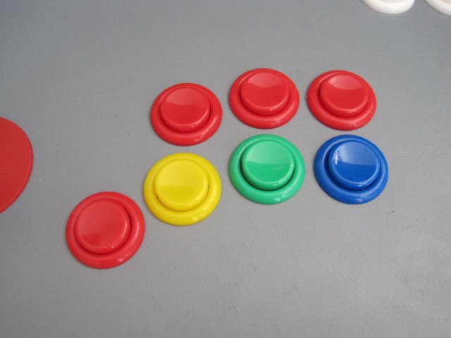

I swapped the buttons. My first impression was not that bad but I think it will look bad once the CP artwork is in place. We will see:
I programmed the iPac so the Sanwa stick and right buttons also control Player 1. I asked my test team to play some games:
Both my son and I were not very impressed by the Sanwa. The travel feels longer than the Mag Stick. It reacts fast but is is less restricted. We also both prefer the bat top over the ball top. I ordered an addition bat top for the Sanwa but still the Mag stick won. Now I'm even more curious about the Ultra Stick but I have to make another CP with larger undermount to also fit the Ultra stick (and maybe even a Servo Stick in the future). I want to get a CP setup which can hold pretty much every stick. I was close but not there yet ;-)
« Last Edit: November 03, 2017, 03:13:10 pm by EMDB »

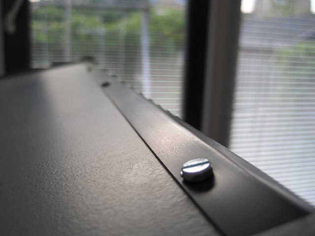

Finally did the marquee retainer. As I didn't want to spent $40 on shipping only for the original retainers which can't be found anywhere in Europe I was looking for an alternative. I found a strip intended to hang posters on a wall in a local hardware store. I carefully tried to fold them out and that seemed to work just fine so I bought 1 length of 2.5 meter (about 100") for just 3 euro (about $2).
At home I unfolded it until it had the right angle (just below 45 degrees) and drilled some holes.
I used inserts on the top and bottom of the marquee area and mounted the retainers holding the two sheets of 3mm clear plexi. I just need to get some black flat head machine screws for a perfect finish. I am very happy with the final result  :)
« Last Edit: November 03, 2017, 03:14:46 pm by EMDB »

I replaced the screws for the retainer with flat black ones. Now it really looks good  :applaud:
« Last Edit: November 03, 2017, 03:16:21 pm by EMDB »

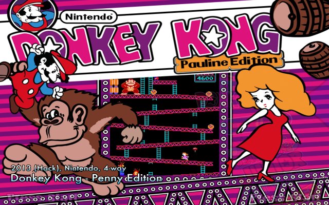

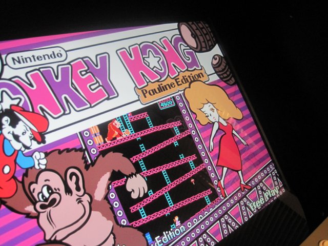

I'm considering doing a DK tribute as that was my favorite game ages ago. And I still like it. Original marquee, custom sideart (I don't like the original one, just a first try) and a adapted CP (text on top right buttons should be BACK - PAUSE - MENU - SHIFT). And use White t-molding. Maybe even the DK bezel.
What do you guys think?
« Last Edit: November 03, 2017, 03:16:53 pm by EMDB »
  • Posts: 9752
Re: Scratch Build: Project RetroCade - In progress...
« Reply #74 on: June 15, 2013, 05:43:46 pm »
Sideart questions:
Why is Jumpman above/behind DK?
Shouldn't DK be throwing the barrels at him instead of away from him?
How would it look with Jumpman flipped horizontally and moved to the bottom left of the grouping?

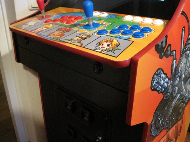

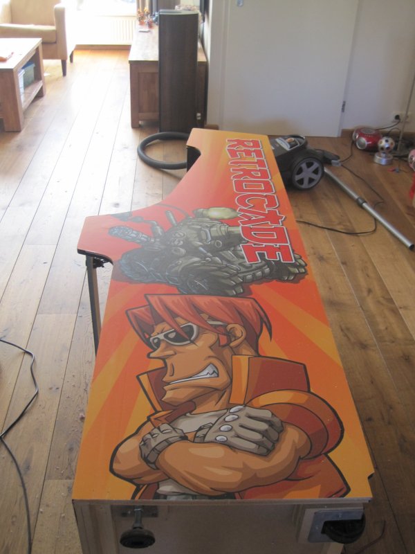

I stopped my DK tribute artwork and went back to my SF-kinda look. I got an initial CP design from my designer. The arrows looked too small and the button surroundings okay on screen but I decided to print and cut them and tried them on my actual CP just to be sure. And I was completely wrong... Arrows were fine but the button surroundings way too big. I even tried to print a slightly bigger arrow set but it was already too big. Back to the drawing table...
« Last Edit: November 03, 2017, 03:17:35 pm by EMDB »

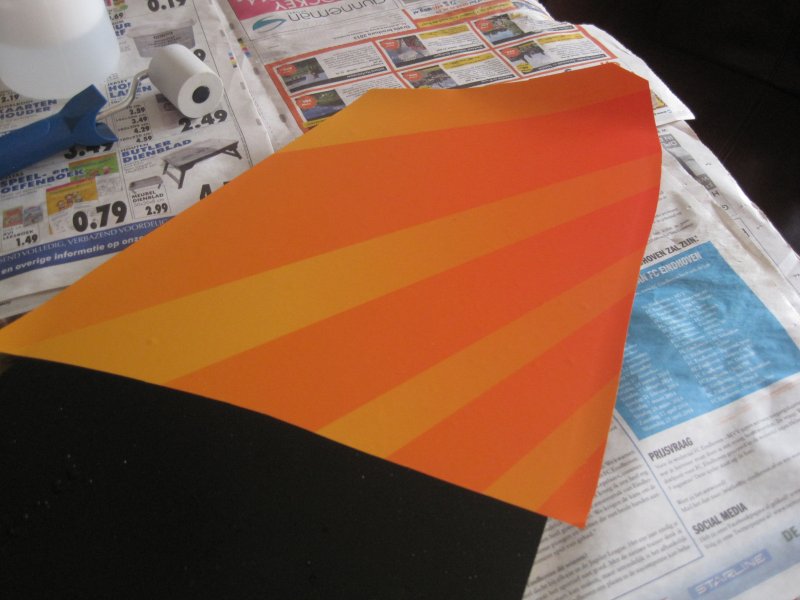

I finally got some time to pick up the project. I first had to disassemble the working cabinet completely. Then I rounded the sharp edges a bit just to be sure the t-molding can be applied easily.
I then again sanded, cleaned with amonia  :dizzy: and applied the first layer of black paint.
Wow... It looks completely different now  :applaud:
I also finally decided on the theme after going back and forth between all kind of ideas. It's going to be a Metal slug meets StreetFighter style. I think both cartoonish styles match quite nice although the games are quite different. Here's a very rough first version of the marquee (don't mind the characters behind the primary ones ;) ):
« Last Edit: November 03, 2017, 03:18:54 pm by EMDB »

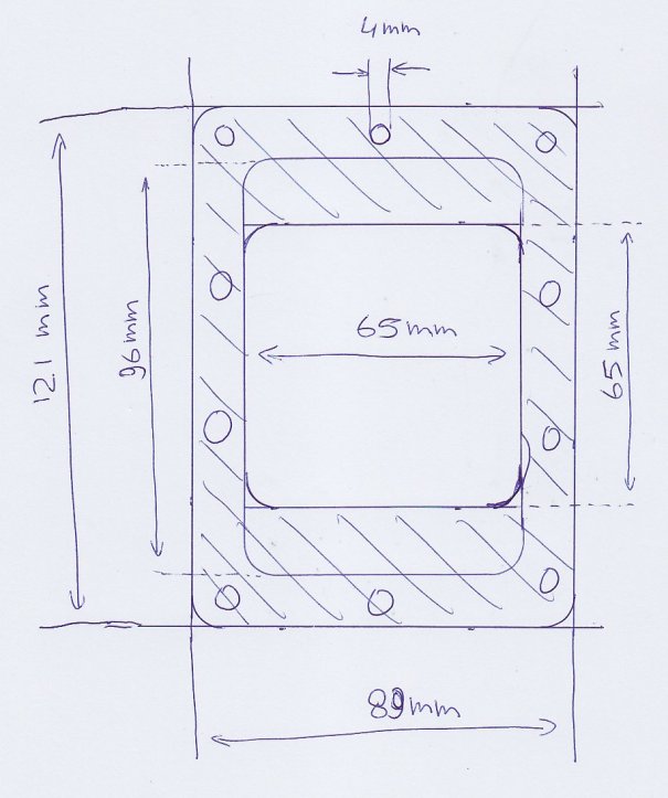

I received my new mounting plate for the wider U360 stick. I had a small section of the edge cut out to fit the closest button.
I removed the wire harness witch iPAC and sticks from my test CP to enlarge the routed area to fit the wider U360 stick.
Tonight I will route out the slightly larger area to fit the U360 and make the CP an inch or so less deep.
« Last Edit: November 03, 2017, 03:20:19 pm by EMDB »

After routing out a bit bigger area to fit the U360 stick:
I had to drill new holes for the inserts and re-used some from the previous plate. The top left was an existing but did not fully fit. So I left the bolt out but hey, I got 9 left ;D This is still a prototype CP, I will create the final one after finishing the CP Artwork using the experiences of this one...
I then re-wired all switches, the iPAC2, the Sanwa stick and the U360:
I'm also happy with the look of the shortened CP. There's (just) enough space left to rest my hands while playing...
Everything works just fine. I installed my UltraMap4Mame to map the U360 correctly for every selected game launched from HyperSpin.

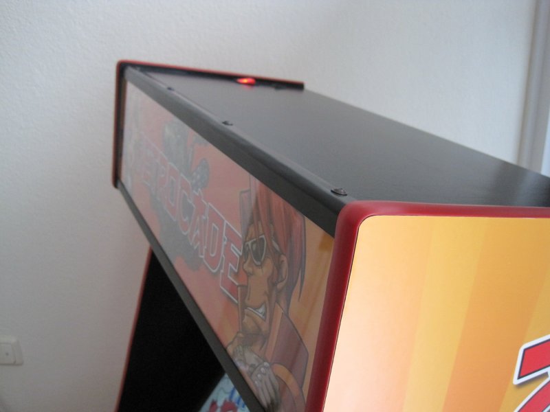

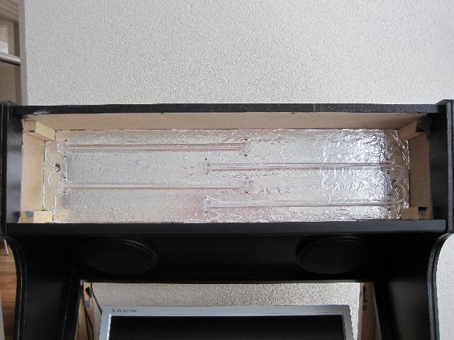

I also did the marquee lighting. I put some aluminum foil on the back of the marquee area for optimal reflection to the marquee. I used 4 PC case modding cold cathode tubes of 30 cm. They operate on 12V.
I guess its bright enough (the protective foil is still on the plexiglass).
You can switch it on and off with a switch on the top of the cabinet. I only planned a power switch there so I have to drill an extra hole.
« Last Edit: November 03, 2017, 03:22:26 pm by EMDB »

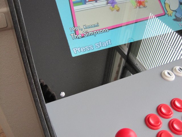

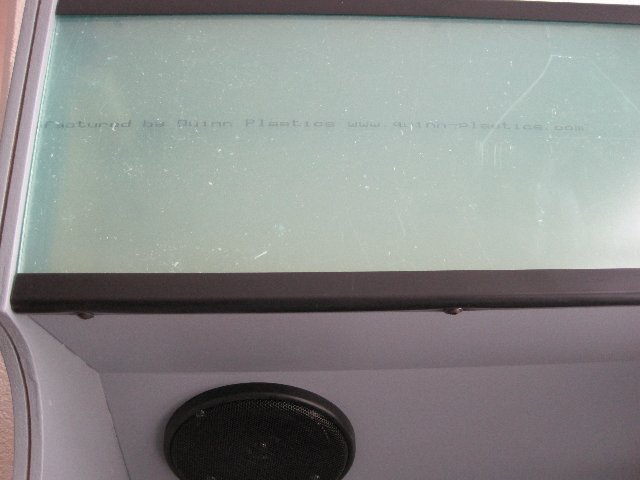

« Reply #89 on: September 18, 2013, 04:28:31 am »

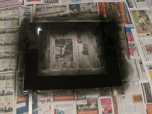

I received the plexi-glass to cover the monitor. It's 3mm grey 49% transmission high gloss plexi-glass (http://www.plexiglas-shop.com/NL/en/gs-allround-4aql41br8z4/plexiglas-gs-allround-grey-7c14-gt-dic33ry3pgp~p.html).
I taped the inside to spray paint the bezel. It turned out pretty nice. The screen now shows amazingly crisp and sharp. If you look from the side you can slightly see the silver monitor bezel so I guess I will spray paint that black too. I'm not sure what kind of bolts to use to mount it. Should they be hidden as much as possible (countersunked flat black ones) or stand out (chromed rounded) like they I did for now?
« Last Edit: November 03, 2017, 04:24:23 pm by EMDB »

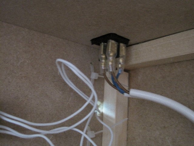

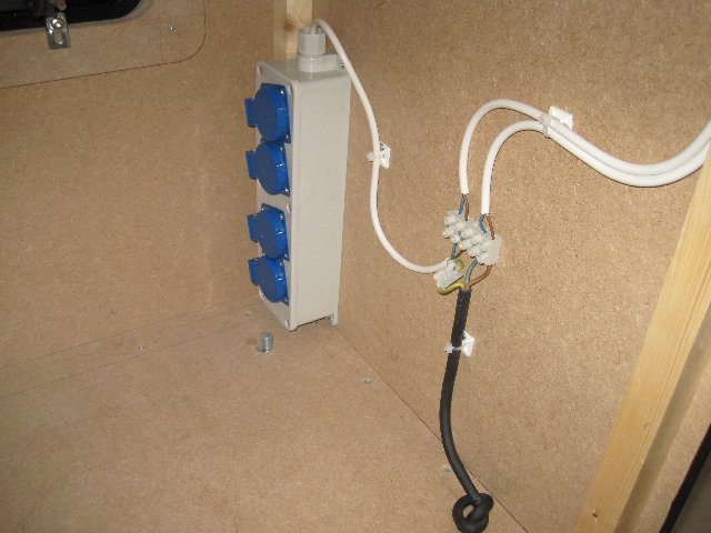

Today I mounted the power switch and finalized the power management. The power switch switches all devices (PC, monitor, adapters) on at once. The PC is set up to boot on power up in its BIOS.
The mains lead goes out via the bottom. I didn't wanted the power switch or a mains lead connector on the back to be able to put the cabinet with its back flat to the wall.
« Last Edit: November 03, 2017, 04:25:12 pm by EMDB »

Hi nice cab youre building, also nice choice on the beer brand (what a jupiler glass can do, men know why!)
Could i get the technical drawing with dimensions off your stick retainer plate shown in picture.
EMDB
  • Posts: 865
  • Project RetroCade
Re: Scratch Build: Project RetroCade - Power Management...
« Reply #96 on: October 05, 2013, 06:38:16 am »
The Jupliler glass was rarely used as I drink Jupiler out of the bottle as it is supposed to  :cheers:
The drawing of the plate is not very professional but the guy who made it found it good enough. Be aware that I designed it for Magstick Plus. It fitted the Sanwa JLF too but for my recent UltraStik 360 the inner opening was too small and I had the guy create a new one.
« Last Edit: November 03, 2017, 04:26:58 pm by EMDB »

Thx a lot for the drawing are you familiar with the t-stick from arcadeshop.de i think they are the same as your first sticks.
And right on jupiler drinks from the bottle unless you have keg!
EMDB
  • Posts: 865
  • Project RetroCade
« Reply #101 on: October 08, 2013, 06:46:20 am »
The T-Stick looks exactly the same as a Mag-Stik. I started with the Mag-Stik Plus which you can switch 4/8-way from the top. I ended up with a auto-switching UltraStik 360 which I am very happy with.

Finally found some time do some work. Although the black bezel on the back of the plexi glass fits perfectly you could still see the inner edge of the gray monitor. So I decided to spray paint it black.
I also mounted the amplifier on the back of the panel which holds the monitor and started on the keyboard drawer.

Cross posting. I created an Artwork discussion thread after starting the artwork:
http://forum.arcadecontrols.com/index.php/topic,136038.0.html
It's based on Martijn's Streetfighter Artwork with a Metal slug touch. Recreating the arrows and button surroundings in Adobe Illustrator (never used it before) was a bit tough. WIP:
I still have to add the characters to the CP but I only have 5 of them...
« Last Edit: November 03, 2017, 04:29:14 pm by EMDB »
SkyKapture
  • Posts: 31
  • Last login:March 07, 2022, 02:55:38 am
    • ..:: SkyKapture ::..
Re: Scratch Build: Project RetroCade - started on the artwork...
« Reply #106 on: December 10, 2013, 07:39:50 am »
Great colours! And five characters might be enough. Maybe something like this.
EMDB
  • Posts: 865
  • Project RetroCade
« Reply #107 on: December 10, 2013, 09:13:15 am »
That would be too easy. The original design from Waveryder is based on the Streetfigter selection screen:
I want to replace the streetfighter characters with the metal slug ones but have a lot of tiles to fill with only 5 unique characters...
« Last Edit: November 03, 2017, 04:29:55 pm by EMDB »
  • Posts: 4520
« Reply #108 on: December 10, 2013, 10:10:11 am »
Use less, but slightly larger tiles.
3 on top, 2 on bottom.
EMDB
  • Posts: 865
  • Project RetroCade
« Reply #109 on: December 10, 2013, 10:20:35 am »
I will try some possible options like 3 at the bottom and 2 on top as the top ones are too covered with the buttons / arrows. Or put the MS characters on the fully visible spots and populate the rest with SF characters. I will show the results in the Artwork topic...
EMDB
  • Posts: 865
  • Project RetroCade
« Reply #110 on: December 17, 2013, 01:43:37 am »
I finished the whole set of artwork (marquee, CP and both sides). I'm very happy with the result. Especially since I had zero experience with Adobe Illustrator when I started...
I will prepare for printing now (adding some bleed, flatten all layers, final check on dimensions) and send it to GameOnGrafics  :)
« Last Edit: November 03, 2017, 04:30:53 pm by EMDB »
I would put the general in the middle to even things out.
How did you get your corners with the tape so straight?
EMDB
  • Posts: 865
  • Project RetroCade
Re: Scratch Build: Project RetroCade - Plexi
« Reply #117 on: December 20, 2013, 02:52:06 am »
I first applied address labels like these in the corners to get rounded corners:
In between I used painters tape.

Where did you get your speakers and amp from?

I bought the speakers from a Dutch webshop (http://www.conrad.nl/ce/nl/product/373007/Baseline-2-weg-coaxiale-inbouwluidspreker-80-W) but any decent car speaker will do I guess. The amp I bought on marktplaats.nl, our Dutch version of craigslist.

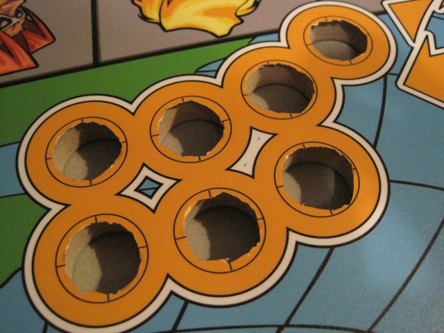

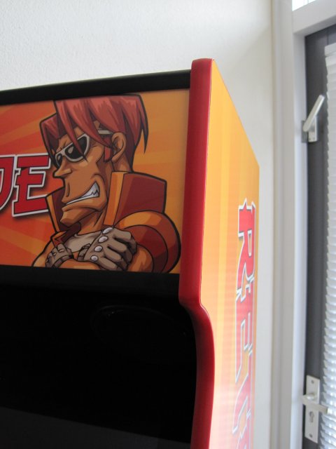

10 days ago finally I got this in the mail from GameOnGrafix:
Unfortunately I was all packed to go skying in France...
As you can see quite diverse weather conditions but had a great time.
This morning I returned after a 12 hour bus trip.  :dizzy:
I could not resist unpacking after a couple of hours of family time. Quality was even better than I had hoped and expected.
I decided to mount the marquee as that was all prepared:
I was a bit worried about the amount of light from the PC case modding cold cathode lights and seeing the thickness of the printed marquee and its fully white back did not help. But after mounting I could not be happier  :cheers:
The details are amazing:
It only shows a little bit of light bleeding on the left and right sides. It's not even very notable but I will try to minimize it somehow.
The side art vinyl and polycarbonate covered CP also came out great. Thanks again Scott!!! I used part of my DVD collection to flatten the large vinyl stickers.
I will redo the CP using the paper printed template and have to figure out how to best apply the vinyl on the side and trim the edges.
