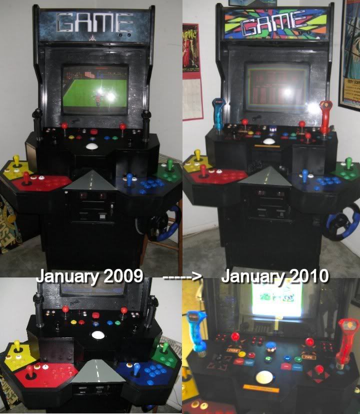

(above pic shows progression since this first post, updated as of 1-16-10.)

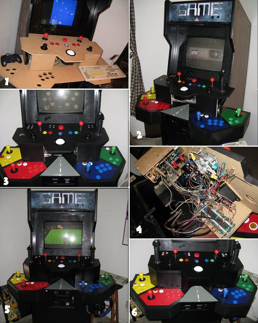

Here she is in her first fully playable version, with her original header (I have a new header, pictured below, although that one's about to get replaced too).
Before I even get going here, I need to throw out a wave of thanks to all you guys who have given me advice here, Andy at Ultimarc (who went above and beyond), the folks at Mike's Arcade, and those poor suffering souls at Electronic Parts Outlet (if you're working on a project anywhere near SW Houston, definitely check out EPO). Also, credit must go to Jeff Allen and his Supercade for inspiring me with his two-tier design.
She started out life as a Phoenix (at least that's what the nameplate on the back says). When I got her at an auction in Mesquite back in '96, she was a JAMMA cab with Escape From the Planet of the Robot Monsters complete with two Hall Effect joysticks. Worked great and an absolute steal for $85. I got a few envious looks and comments as I wheeled her out. The burn-in on the monitor (not too bad, but it's there) shows that it once ran as a Rampage as well.
I sold the Hall Effects and the metal control panel on Ebay for $130, and the Robot Monsters boards for $100. I now had my wife-proof funds to begin amassing controls.
The PC dropped into my lap; a 1.8 gHz AMD Athlon, and I put in a gig of RAM, Windows 2000, MAME32 v112, Daphne, Visual Pinball, ZSNES and other console emulators. It runs everything great up until polygons start getting involved in the 1990's. At some point I plan to replace this rig, but for now it does everything I want it to do just fine (Space invaders to Street Fighter). I already had an ArcadeVGA I had bought a couple of years ago when I meant to get started on this, but I didn't actually begin real work on the project until August of '08, and finished (apart from a few little to-do's) just before Christmas '08.
The top tier is the "Classics" tier. Everything is wired through an I-Pac 4 except the trackball, spinner and analog sticks:
2 8-way leaf switch joysticks (Mike's Arcade) for Robotron, etc.  ...mainly Robotron. Constantly Robotron.
2 4-way microswitch joysticks (also Mike's), the left one is set diagonally for Q-bert, the right one normal for Pac-Man, Donkey Kong, etc.
2 analog trigger joysticks (Saitek Cyborgs, Ebayed for 8 bucks each).  I plan on replacing the grips with Randy's awesome Tron and Satan's Hollow grips (actually, I was just waiting for the Satan's Hollow ones to happen, and when I checked the forum today I was surprised to see I had missed their debut).
1 U-Trak trackball (Ultimarc, wired to their Opti-Pac)
1 homebrew spinner (detailed below)
5 arcade buttons (Asteroids array, color coded for Mouse Trap!)
12 homebrew "Atari Volcano" buttons (buttons from EPO, "Volcanoes" crafted out of Super Sculpey). ESC, Enter, MAME settings, etc.
2 pinball flipper buttons (on sides of top tier, visible in pics toward the bottom).
The bottom tier is set up for MK/Street Fighter and 4 player games. 60 bucks bought all the lower panel controls (and the top tier buttons) in a single purchase on Ebay.
Player 1 - 1 red Happ competition joystick, 6 convex buttons, 1 concave button, 1 start button, 1 coin button.
Player 2 - 1 blue Happ competition joystick, 6 convex buttons, 1 concave button, 1 start button, 1 coin button.
Player 3 - 1 green Happ competition joystick, 3 concave buttons, 1 start button, 1 coin button.
Player 4 - 1 yellow Happ competition joystick, 3 concave buttons, 1 start button, 1 coin button.
Each joystick input on the I-Pac 4 is actually wired to two joysticks; one on the top tier, one on the bottom.  You're either on one tier or the other, and it's a great way to add other types of joysticks without needing extra inputs (or I-Pac's). For example, the left red ball stick on the top tier is wired to the same inputs as the red player 1 stick on the bottom tier.
The Logitech Steering Wheel (made for Playstation 2 Gran Turismo 3) clamps into the center bay for play, and down below when not in use. The pedals can be stashed inside the coin door bay.

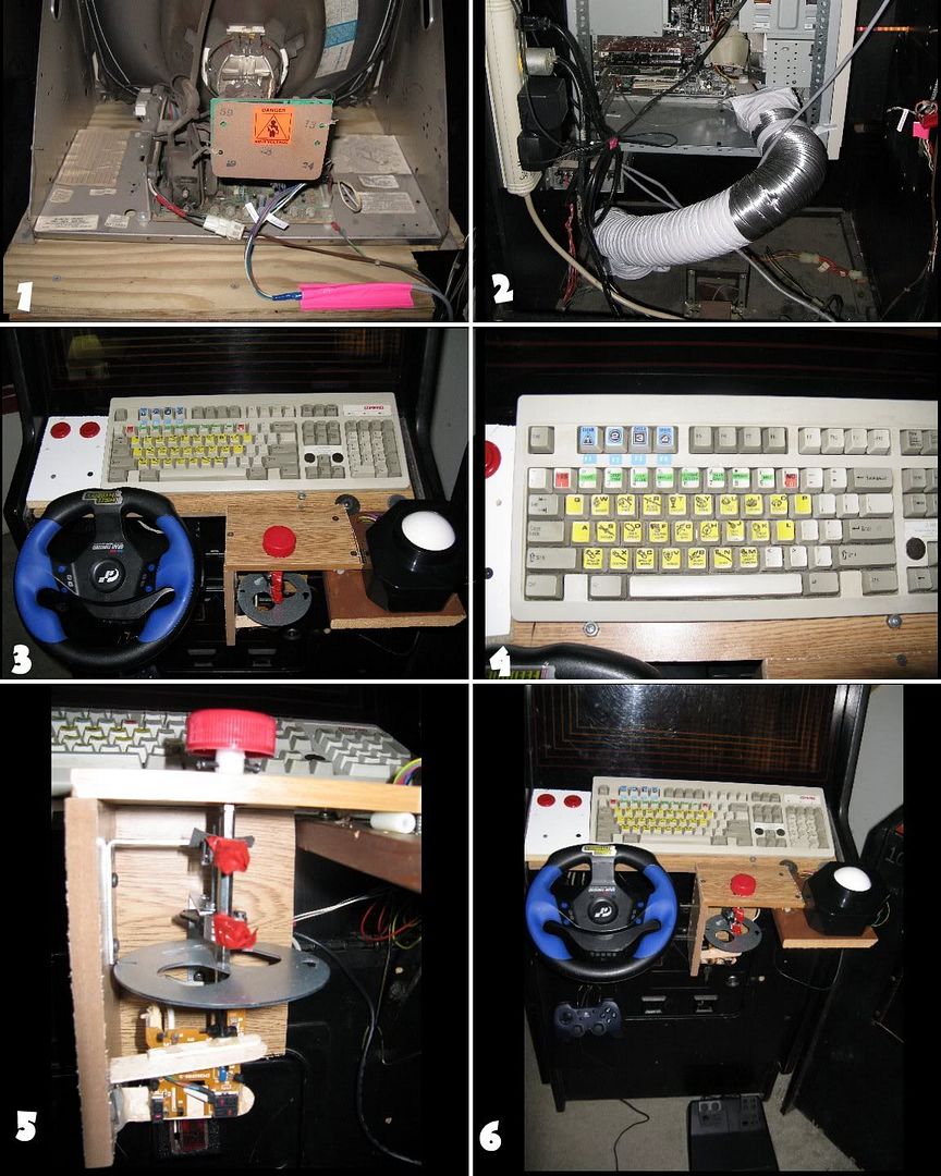

A better picture of the keyboard is below.  It's been repainted, and labeled for Thayer's Quest..!
...No one but me has yet to be excited by that.
1. Wells-Gardner 19K7906 monitor, wired to ArcadeVGA. I can find almost nothing about this monitor.  I'd kill for a manual. But I've managed to get it to do everything *except* adjust the horizontal size-- that coil doohicky feels stuck tight. Fortunately the H size was already set pretty well, I just wanted to tweak it a tiny bit.
2. Powerstrip feeding PC, monitor, speakers and steering wheel. I secured a clothes dryer duct hose to one of the vents on the cabinet floor, then a PC fan to the other end.  The hard drive was running pretty hot until I started feeding it cool air from the floor, and I haven't had a problem since.
3. A true Frankenpanel. The U-Trak has arrived! The two red buttons in the UL are the mouse buttons. In the center is homebrew spinner v2. Serious lack of joysticks at this point.
4. Thayer's Quest stickers on keyboard.
5. Homebrew spinner v2; v1 had the same knob, but was way too flimsy. It was a Western Digital hard drive jobber that obviously wasn't going to last under any wear and tear (the shaft, mainly).  But when I went to rebuild it, I had ruined what Western Digital platter hubs I had-- and what I ended up using were 2 of the actuator arms from the butchered hard drives. They each have a small (1 1/2 cm diameter) spinning piece-- the actuator shaft-- with a screw on one side and a threaded hole on the other. They worked great, AND I found shafts at EPO that would screw into them! Another plus with the actuator arms-- they don't need to be Western Digital (to get the pre-centered hole). Of the four HD's I dismantled for this project, only 2 were WD, but all the actuator arms had a screw on one side, and a threaded hole on the other.
The knob is a cap from a gallon jug of Lactaid milk-- perfect size, and nice ridges on the side. I filled the cap with hot glue and put a plastic cylindrical spacer in the center (you can see one of the spacers on its side, in the upper right of the pic, leveling out the top wood piece of the spinner). Two screws secure the knob to a hexagonal metal shaft from EPO. That shaft screws into the hard drive actuator arm, and another shaft links it to the second arm.
The actuator arms are the two pieces with red electrical tape on their ends-- because those ends are SHARP AS HELL and I had a million tiny cuts on my fingers before I even knew it.
The two actuator arms are clamped to two L-brackets, which are in turn screwed into the wood housing. Below the actuator arms are two more short hexagonal shafts, with the spinner weight screwed tight between them. The spinner weight is a metal facing from a circular electrical socket (another Home Depot "Ah-HA!" moment).
The shaft piece underneath the weight is a male end where it's secured to the weight, and female on the other. The mouse spoke wheel is screwed into that end.
The circuit board is from a cheap Gateway mouse, whose wheel was never detected by any computer other than the original Gateway, so I decided it had to die. But what made a crappy mouse made an awesome spinner.  On the first spoke wheel I tried, following some guide I was reading (probably here), I cut out every other spoke to accomodate high speed spins; but that wheel wasn't detected well at all. On a whim, I tried the second, unmodified, wheel and it worked perfectly.
I have spun the daylights out of this thing, and I have never managed to spin it fast enough to get that jerky effect I have experienced all too-frequently on PC mice and trackballs. I have NO idea why the Gateway mouse parts worked so perfectly, but I get insanely fast motion onscreen and yet, still perfect precision. After adjustments for tension, leveling, etc., I now get 13 seconds of spin on this thing from a single good twirl. I'm working on a design for another version that will more solidly brace the actuator arms, and also reduce the depth-- it's pretty tall, about 8 inches, but the room was available in the final control panel, so the height was never really a problem.
6. Oh, yeah, the car pedals and the do-fer Logitech joystick down below.

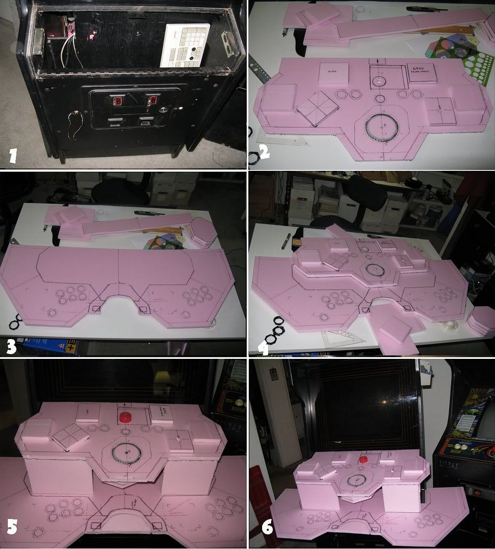

1. The empty control panel bay.  Also, the coin mechanism has been removed to make the coin door into a storage bay for the pedals, and easy access to the 2 USB hubs (for Opti-Pac, analog sticks, steering wheel, and disco ball power. ...More on the disco ball later. ;) )
2. Beginning the design model. I bought an 8x4 sheet of 1/2" foam core insulation for $10 at Home Depot. The idea here was to build a full size, easy modifiable model so I would be sure that the controls as I had drawn them out would not be too crowded, or poorly positioned in general. MERE WORDS CANNOT DESCRIBE the imagined nightmare scenarios I avoided by building this model-- in fact, this pic shows that I incorrectly positioned the center line; it's an inch off. If I had realized that after cutting wood, I'd'a cried like a baby.
The foam core is light as a feather. You can cut it with an exacto knife instead of a saw. You can attach it to the cabinet with scotch tape instead of screws. And if you screw up a cut, it's a simple matter to repair-- slice the right size/shape piece to fix it, and tape it on. And once you have the model completed, its pieces serve as crude stencils on the wood, making sure your measurements are always in the ballpark before you make an absent-minded cut.
The square pieces on the top are measured to represent the joystick footprints, so that I can move them around and make sure that the arrangement I want for my hands will fit together underneath the panel. The spinner, trackball and button footprints are drawn on, as they would not likely be moving from their centered positions.
3. The lower tier model. Center area stenciled from top tier model to indicate correct overhang. Note the curved divot in the center, inside the steering wheel footprint.
4. Looking at the two tiers stacked.
5. Adding the front 'legs' for the top tier. Once these pieces were finished, it would be time to start cutting wood. The remaining pieces would all be angled facing pieces, and would require much more precise measurements made off of the actual construct. Modeling those pieces at this point would be a waste of time. Also notice that the center divot from #3 & 4 has been replaced (yaaaaay exacto knife and scotch tape). It weakened the structure, and was unnecessary-- the top tier controls turned out to be easy and comfortable to reach.
6. "OMG this is actually going to happen.  ...OMG I better make this thing easy to take apart, 'cause it won't fit through the door like that." (All-original Super Cobra cab makes Hitchcockian cameo just before acquiring White Elephant status.)

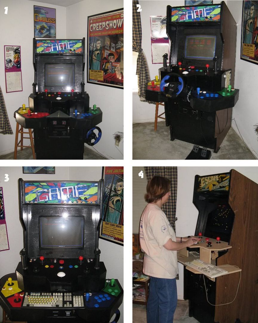

1. The new header is in, and the 80's corner is coming together (The Creepshow poster was given to me long ago by a good friend whose grandmother was in the movie-- she was the maid in Father's Day).
By now I've long since flipped the cheap cardboard bezel, painted it black, and given it a light sprinkle of silver glitter for a 'starfield' effect.
The header as seen here is pretty close to what will be the finished version (until I tire of looking at this design, anyway). There's a top layer of 'cosmic swirl' in this one that ended up looking like crap when backlit. The one I'm fixing to put in gets rid of that, and the colors look much bolder.
2. Steering wheel and pedals in place. Keyboard is hanging on pegs on the side of the cab. Look closely to the UL of the keyboard, and you can see the right flipper button (for Visual Pinball).
3. Keyboard in place for file maintenance-- or THAYER'S QUEST!!! I added some rubber feet to the underside of the keyboard in strategic positions so it can sit in that spot, well supported at all four corners, while also not pressing any buttons on the lower tier.
4. My wonderful, beautiful, understanding wife getting her Centipede on in early days.  When I snapped this pic I started worrying less about getting killed in my sleep.
On the header you can see the Tone and Volume knobs. I used a 3" hole saw on the underside of the header and put in a couple of stripped Dell speakers (there's a center hole from the original mono speaker that I covered). The header is lit by a 100 watt flourescent bulb (one of those twisty ones that fit in a regular lamp socket). I made a whitebox inside the header to spread out the light.
...Then I made my DISCO BALL!
I went to Fry's and bought a little plastic dog that plugs into a USB slot, then it humps your laptop.  I then eviscerated that randy animal, and extracted from him his tiny 5v motor with USB plug. The motor is about the size of a pencil eraser, and it spins a small screw-gear VERY fast. Then I got a packet of lightweight plastic gears at EPO, chained them small-to-large, small-to-large until I had the final rotation slowed down to about 10 RPM (by the time I had this doohicky working, it was 4am and I felt like a mad watchmaker). Hot-glued to that last gear is a 1/2 sphere of styrofoam, and I scavenged a few mirror bits (from an old disco ball that came as a package deal with my wife) and glued them to the styrofoam. BAM! USB powered micro disco ball.
The light is 3 LEDs on a bendy metal arm with a USB plug. I cut a white Bic pen into 3 small tubes and put them on the lights-- because as a wise man once told me, "the tube MAKES the disco ball". ...Well, he may not have been wise, but he could dance.
It doesn't read very well in these pics, but the colored squares on the header are coming out of a black hole-type thing. Inside the header, the light is blocked in the middle and reflected out to the sides. In the middle, the disco ball projects its whirling pattern of lights from the dark center of the black hole.

Ive seen worse, but theres just too many controls there.
Too many for what, exactly? 'Cause I can tell you that the only one that doesn't see regular use is the 4-way diagonal. Even Players 3 & 4 get used regularly for 2-player 2-joystick games.
And for me, it has too FEW controls on there-- I racked my brain trying to figure out a good way to work in a pair of Ikari Warriors rotary sticks, and just couldn't do it-- I thought about making Player 3 & 4 rotaries, for example, but didn't like the look. But I'll tell ya, since I finished, I haven't had a single instance of  "I wish I had"; the closest I've come is "I wish I could have"-- Wish I could have had 2 spinners. 2 trackballs.  ...A giant arm to wrestle.  >:D
The CP is ---smurfin---' awesome.   I don't care what anyone says.  That is not a frankenpanel.  It's a work of art.  I'm completely serious.  That is the sort of the you wanted to see in an arcade twenty years ago.
Thanks, man.  :cheers:  I only realized when I first made this post that the whole thing was 8 years from design to completion.  Once I set down to do it, the actual accumulation of parts and the construction itself only took about three months; but by the time I was ready to start, I was completely certain about what I wanted to do.
Not what i wanted to see in the arcade 20 years ago, and it isn't what i have seen in an arcade ever. It would have been better without the higher tier on it.
See, the tiered design was what set me off in the first place (seeing Jeff Allen's Supercade).  Before that, I had been trying to come up with a way to have all that stuff on one panel, but there was just too much obstruction.  The tier completely eliminated that.
I find it a bit funny that I've been playing the hell out of this thing for five months without an iota of regret about any decision I made-- that's a rare animal--  and all this time I didn't know it was borked.

Personally, I think the height of the second tier is a tad too much, but other than that, I love this concept (Hell, supercade is what I based my CP on too, as in
I went with the two trackball design, but I wish I could have gotten 4 spinners on there (mainly for warlords). It was just too tough to justify that expense for basically only one game. However, the cheap spinner based on an optical mouse thread has me thinking I might revisit that idea.
I'm also thinking I can use the p3 and 4 sticks as the second sticks for dual stick games, just haven't gotten to the point of having a PC and monitor in the cab yet to actually try it out.
I can't remember playing any rotary stick games, so I have no idea what I might be missing there, but I do recall playing dual stick topfire games, so that's another stick conversion I may attempt in the future.

It did end up higher than I originally planned, but that ended up being dictated by 2 things: The proper slope on the top tier, and the steering wheel bay. What ended up happening was I split the difference from the position of the original control panel.  The top tier is 6 inches above the bottom tier (at the front), so the top tier is 3 inches above the original panel position, and the bottom tier 3 inches below.
I love the Armoirecade!  ;)
Yeah, that was the decision-maker all over the place on mine.  The biggest conceit, I think, was the 4-way diagonal.
It feels a little weird at first, not having the sticks exactly side by side, but that evaporates quickly. I've had good success on SmashTV and Karate Champ.
Time Soldiers was the rotary stick game I played the most,  but they're most widely known from Ikari Warriors. They have a LOT of wiring coming out of them to accommodate the eight positions of rotation.

Hey angryred, great job dude!
I can really tell you've put a tonne of effort into your cab and it shows mate, I love how you've integrated a 4 player setup into a 2 player cab, whilst keeping the 2 player vibe of the top tier.  Really like the Yellow/Red/Blue/Green under the player controls and the little road strip in the middle is a nice touch!
Bet you can't wait to have 4 buddies around that to play Gauntlet or TMNT Arcade! :applaud:
EDIT: You're cab might have sparked an idea, on regular 2 player cabs how sweet would it be to have the two (bottom left / right) as detachable panels with little connectors, so you could just plug in the bottom 2 and slide them into place with rails or something?

Nice Creepshow poster!   :burgerking:

I cant resist!
did you steal a big giant simon game for the bottom panel??  :laugh2:
All kidding aside,
It's too busy for me. But you built it and if you like it, hey, the BYOAC community doesnt matter!

« Reply #16 on: June 24, 2009, 04:42:14 pm »
I cant resist!
Just for that, I'm gonna make this @#$%er emulate Simon.  >:D
...Now with TRON and Satan's Hollow stick goodness!
I got the handles from GroovyGameGear, and mounted them to the Saitek Cyborg bases with a couple of pieces of 5/8" PVC piping (and a little help from a couple of plastic martini olive skewers). I made the faceplates (shown below) from images found on the net, tidied up and printed out on thick photo paper at 600 dpi.  The clear plastic fronts were cut from the "un-CD" that you find at the bottom of a stack of blank CD's/DVD's-- and it has the same "circular rainbow" effect that you see on an actual CD/DVD. I didn't notice that until I had the plates mounted, and walked by so the light hit them just right. An unexpected coolness.
...And last night was the application of the classic tier art.
...Still to do: the circular arrows from a Tempest cocktail for the spinner... and something for the TRON stick base.
It's good to have friends. Thanks Rick!

« Reply #17 on: August 05, 2009, 04:17:43 pm »
So, now that the TRON and Satan's Hollow sticks are in, they cannot be allowed to linger in improper lighting.  So it's off to Electronic Parts Outlet once again, where I end up with one of these:
Mine is a bit different from the above pics in that the white wires go to each end of the neon tube, as opposed to both on one end.
It's a cold cathode neon blacklight, and it's easily wired into the PC's 12v power (something I'm sure somebody else has done around here, but please forgive my conceit at speaking of it as an amazing discovery-- it was to me!).  I just snipped a plug from an extra PC power harness I had lying around, wired it to the red & black wires coming from the little blue box (a ballast, basically), and plugged it into the PC power.
A drawback is that the white wires coming from the ballast to the bulb cannot be lengthened, and the white wires are only about 8" long.  The wires from the ballast to the power source can be as long as you need, but you still have to consider your placement carefully if you want to conceal the blue box.
I ended up getting a 1" clear plastic tube (for aquariums) from PetSmart to mount and mask the neon tube. I painted it black while masking off an area just large enough to get a good lightspread-- the black eliminates line-of-sight to the bulb itself, while allowing the light to illuminate the control panel.
The tube is just wedged into place with a couple of thick foam rubber pieces on each end holding it in place. The assembly is so light, and I didn't want to make anything too permanent until I was sure I had it where I wanted it. The foam rubber does make it very easy to adjust the light throw, though.
I wish I was more experienced with this doggone camera.  The pics below do not really convey the brightness of the glow coming from the sticks. I could get an even stronger glow if I could figure out a good way to get the neon closer to the sticks without them getting in the way.
It really looks great in the dark now, and the neon illuminates the panel quite well while playing in a dark room.
And my father, the electrical engineer, is coming over this weekend to help me with my cap kit! Dark bars have recently cropped up on one side of the monitor, so we're gonna cap that mother.  Apart from some minor burn-in, this thing is going to look so fresh...

« Reply #20 on: September 01, 2009, 01:46:33 pm »
... It really is a tough struggle I know, to balance how many games you can play with number of controls...
Especially when I'm more of a Golden Age guy.  Games before '85 seem to have a much wider variety of odd controls, dual trackball setups, etc.  But believe me, if I had run into any major obstruction issues, I would have started crying about it by now. Every now and then I wish I had dual trackballs/dual spinners, but there was just no way to fit them in...
Dad helped me cap my monitor a couple of weeks ago, and now (apart from the Rampage burn-in) it looks SWEET!
There are lots who have done this...me included...my first cab has both a blacklight and blue cathode above bezel. :)  It is a nice way to add some additional lighting.

This is... intense.  I've got about half the controls you have, and it is a chore setting it up so guests know what controls to use for which game.  I can't imagine coming up with an understandable plan on that cab.  I'd love to try it out though.
...Yeah, bothered me too... so I made an instruction booklet, with a layout for each emulator, and keep it tucked inside the coin door.  Here's a few pages...

So what all games do you have on this monster? The keyboard pic up above for Thayers Quest and your layout for Star Control II has given me a cool idea on one of my upcoming projects. Do you have alot of "non-arcade" type games installed on this? I wouldn't mind seeing all those layouts either. I think they are cool.
Also, have you made any progress on v3 of the spinner? I'd like to see a closeup on how you used those actuator arm bearings.

Ok, so here's the panel as of this week; Mike at Mike's Arcade was kind enough to switch out the shiny black ball stick for a textured red ball, now the top tier v/h 4-way looks properly Pac-Manny. I'm not sold on the yellow disc on the 4-way diagonal. I'm looking at it. Do I hate it?
The new spinner knob. This was a base for a bizarre pen I got at a trade show-- it looks like Uncle Sam, and it has one of those plastic fiber dusters coming out of his top hat. You stuck it in this little drum base on your desk. The pen is goofy, but the little drum made a perfect fit as a spinner knob.
Top to bottom: Knob, housing (MDF scrap), actuator arm, hex shaft, actuator arm, housing, counterweight (electric socket panel), mouse guts.
I cut the housing from leftover MDF, making sure to cut two panels the exact same size, with a matching hole in each.  There's a thin screw hole on the metal portion of the actuator arm, and a larger hole on the plastic portion (though I had to use some washers as spacers under the plastic portion to make sure the arm was leveled on its base).
That's 2 points to screw down the actuator arm to its base, then I hot glued all around it (being careful not to glue the rotating part!). Repeated the process with the second actuator arm, except as a mirror image.
The hexagonal shaft connecting the two actuator arms is a double female end. The wheel of the actuator arm has a male side and a female side-- but they don't take the same size thread. To connect the two, you have to link either the two male or two female ends with a single matching shaft.
Bring the actuator arms with you when you dig through the part bins, and make sure you get enough of both sizes-- the shafts for the knob and mouse assembly will be the same size, and the linking shaft will be another size. Wish I knew the sizes to tell you, but I figured it out by trying out the pieces by hand, and never bothered to check what the sizes were.  But if you have the arms with you, it doesn't take long to figure out which ones to buy (and BREAK OFF the sharp metal ends of the actuator arms before you go running around with them, or you'll have a million tiny razor cuts on your fingers before you know what's happened).
Once I got the 2 actuator arm bases finished, I made the walls of the housing: 2 more pieces of scrap MDF cut square, then glued and screwed into and L-shape, making 2 walls. Then  I clamped in the actuator arm bases and pre-drilled the screw holes, then glued and screwed those in.
EPO didn't have many hex shaft pieces of the size I used for the linking shaft.  If they did, I would have put the counterweight between the actuator arms, and made the whole thing more shallow.
A couple of l-brackets jerry-rigged together hold the mouse board in position. The popsicle stick braces the peg on the underside of the optical wheel.  I found it easier to use hot glue when assembling this thing, as I could make fine adjustments as the glue cooled, and get it just right.
Even so, I added a little screw to make finer adjustments to the distance between the wheel and optical sensors (I broke my last mouse board when I started this rebuild, and the replacement mouse was a lot more finicky). The best way to go about this, though, would depend on the mouse board.
The last time I checked, I got 17 seconds of spin on this thing with my most Olympic-level twist.  And with making sure to really eliminate any unwanted flexibility along the way-- permanently mounting the actuator arms directly to the solid housing is what finally did it this time-- this thing is now solid.
