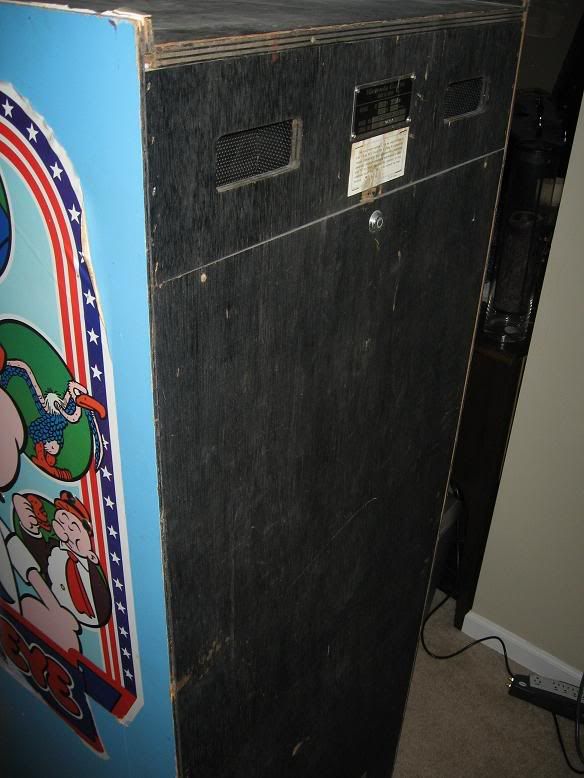

Problem #1:  I don't have the keys for the cabinet, and although the coin door is locked open, the back cover is locked shut.  Since I don't have the time to tear into this thing for a while, I'm going to try and procure actual K6510 keys before I drill out the locks.  I'd like keep this restore as authentic as possible, right down to the locks and keys.

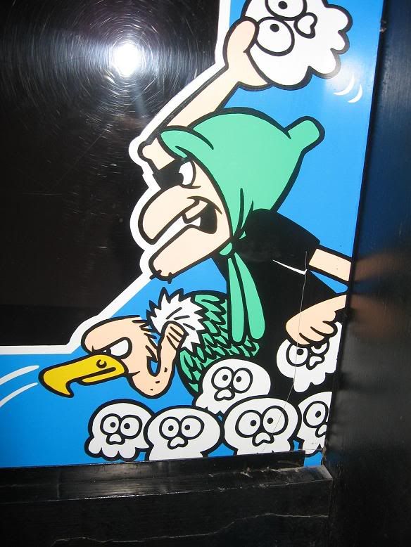

#4:  Side art is going to have to go and the sides are going to need to be sanded, patched with bondo, and repainted or revinyled.  I was thinking I would repaint it as I had great results spraying my scratch build, but it has been suggested that I revinyl it which would be more authentic.  I'll be looking into this as an option.   Its my understanding that whether I paint or use vinyl, I need to sand, patch and prime the surface the same way.  There's  no real way to remove the existing vinyl right?  I've just got to sand it down and put primer over it?

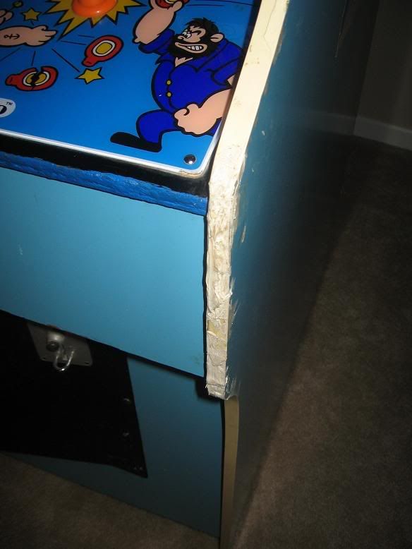

The bottoms and the corners look the worst.  This will be my first time using bondo.

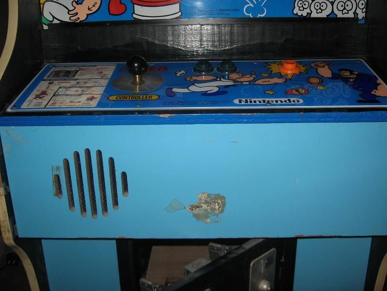

#5:  Tmolding will need to be replaced and I'll have to do something to fix this sloppy caulk job that was used to fill in missing tmolding.  I'm thinking a blow dryer or heat gun might melt it enough for me to peel it off.

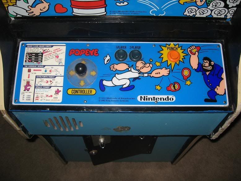

#6:  Need to evaluate replacing the cp overlay.  It looks like it is in pretty good condition.  Its a bit faded though.  We'll see, I'd really like to reuse as much of the original parts as possible.  Marquee looks pretty good and I don't think I'll have to replace it.
#7:  Even if I don't replace the overlay, gonna have some work to do on the control panel.  Probably needs to be stripped and repainted.  The controls feel suprisingly good, but replacements are readily available so I might just replace them.
#8:  Don't think I can get away with this bezel.  For the most part, its pretty good, but there's a lot of knicks in the art and then there is this crack.  MikesArcade.com has replacement bezels for a lot of Nintendo cabs, but not Popeye.  Wonder where I can get one.
#9:  Coin door needs a complete restore and I need to replace all these decals.  Also, only coin slot #1 is working, but after inspecting it, I can see that #2 is wired up differently than the first, so that should be easy to fix.  There's a coin counter on this thing that still works and is past 26000.  A few games have been played on this machine.

If you're interested in preserving the original lock core, you could always knock out the vent grilles above it and that will allow you to get your hands in there with a snub nosed screwdriver and take off the lock tab. Once you get the door off, you can remove the the core and getting a replacement key made will be easy for a locksmith once they can hold the core in their hands.
My buddy and I once got a Ms Pac cab that was locked in the same fashion. Luckily for us, the vent holes were also handles, and could be unscrewed and removed. We used this method to get the back door off, and then we were able to reach forward to unscrew the retaining tab from the coin door lock too. :D

You want to keep everything as original as possible yet want to replace the controls ? Why ? Nintendo joysticks usually just need some good cleaning and new grease. I did replace the microswitches with leafs, but that's just my hate agains microswitches. Whenever possible I try to get rid of them, original or not. The buttons you should definitely keep because these are the original colors and they look very nice still.
I think Mamemarquees has the bezel if you don't mind inkjet.

Hmm.  Not sure about knocking out the speaker grills.  It is like you're describing but they seem pretty solid in there.
No keys in the cab that I can find.

There were none in the cabinet, but I got a spare key for the back panel from John at vintagevideogames.com.  Guess I didn't make that clear in my earlier post.  Damn words.

With the sides and front clean, it was time to take a look at the bottom.  I turned it up and was happy to see there wasn't any water damage, just some rather thick, haunted house style cobwebs.
Took to it with soap and water and got it clean.  Big question here though.  the base is pretty chewed up.  Should I even bother attempting to repair it?  Will bondo work here?
Right side of the cab is pretty solid...
But the left is all nasty.
The T-molding was glued in here and the wood is splitting apart.  Before I quit for the day, I cleaned out the groove, pulled the wood apart, squirted some glue in there, clamped it down for the night, and cleared the excess glue out of the groove.  Hopefully it'll feel more solid in the morning
