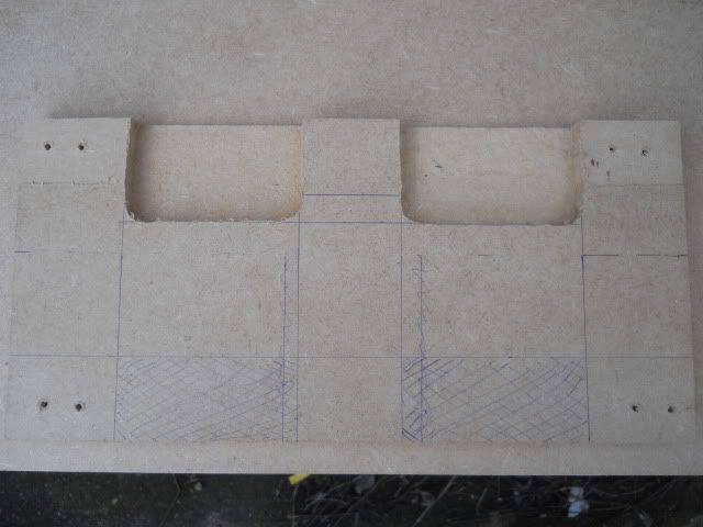

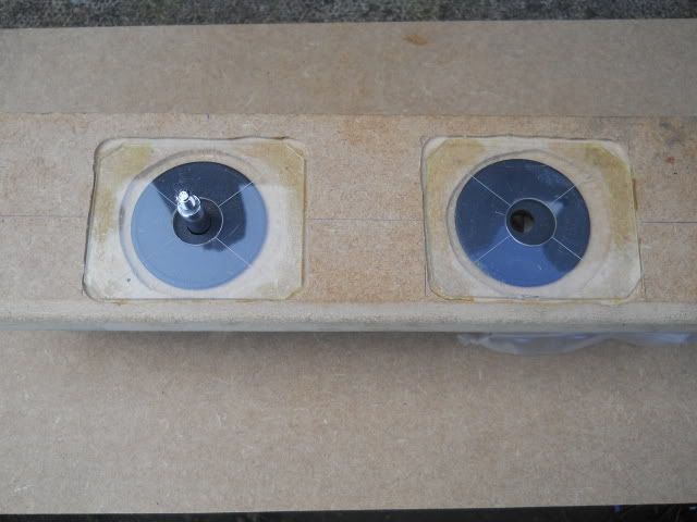

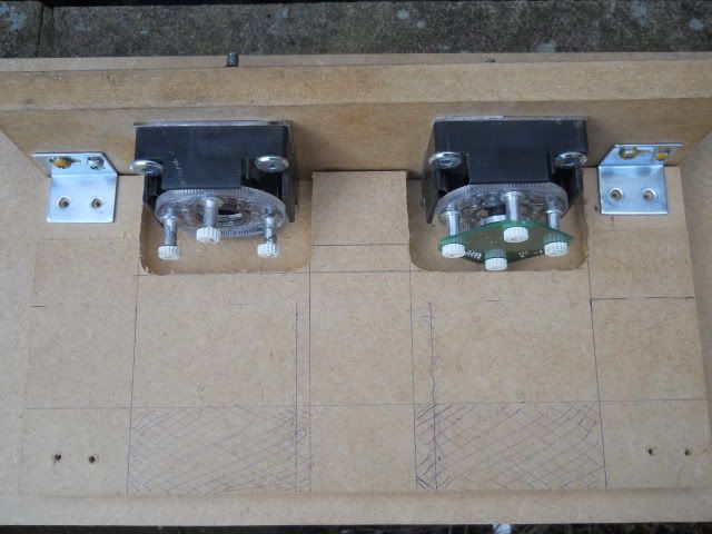

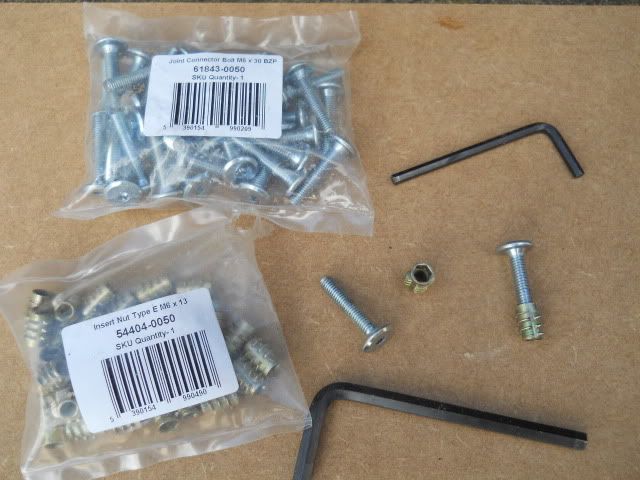

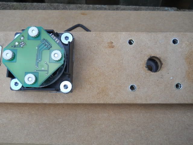

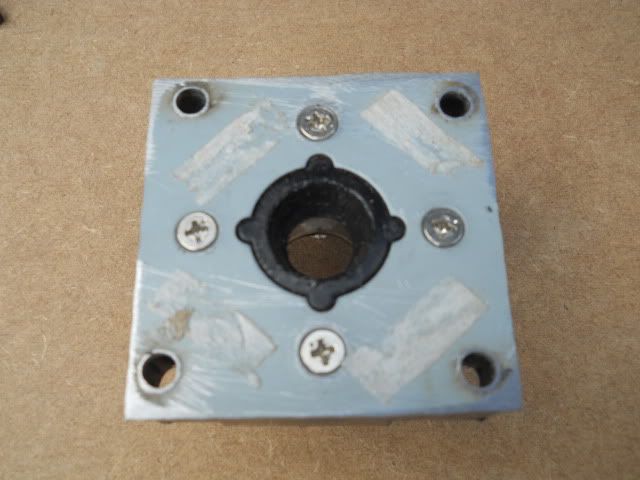

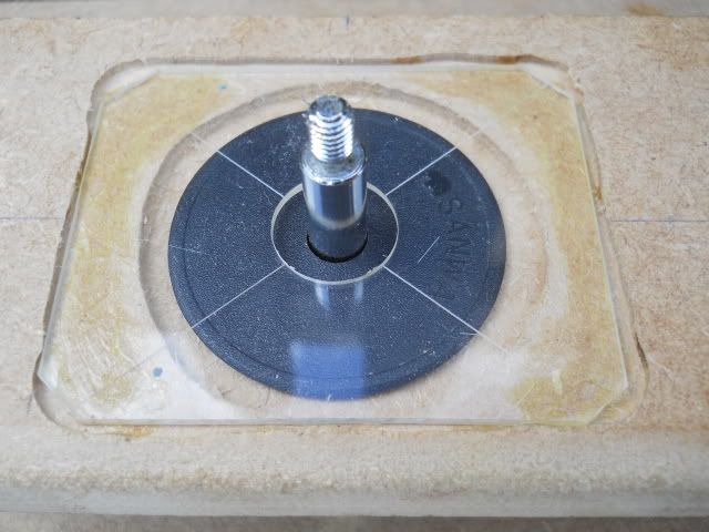

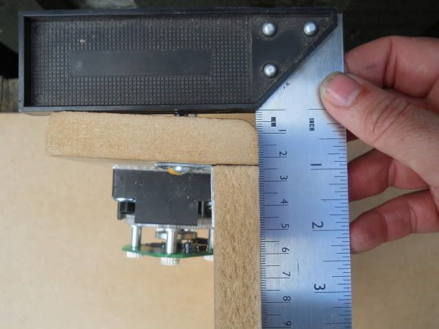

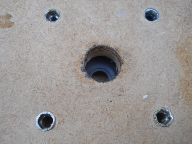

As promised here are some pics of where I am up to with the control panel. Firstly we have the artwork from Scott at Gameongraffix. Awesome quality as per usual! Thank you Scott.  :applaud:
When it came to planning the panel I realised that the stock U360 and mounting plate simply would not fit correctly. I'm using 18mm MDF and where the joystick shafts come through the panel there would not be enough room behind the front panel for the joystick body to sit. So I had to make some alterations to the way the U360s mount. I basically trimmed the mounting plate so it was square with the plastic housing and then drilled through the housing in each corner and down through the mounting plate itself. Looks a bit rough and ready but it works a treat.
I also had to route out behind the front panel to that the joystick shafts could come through the holes correctly. The bottom of this panel still needs trimming to the correct height.

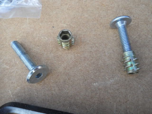

When it came to mounting the sticks I wanted something strong and sturdy because by moving the mounting holes closer together you can lose some strength. I'd seen these "nut inserts" before (that's what Screwfix Direct call them anyway) but I'd never used them. I wasn't sure how they would work but they are excellent. You just drill into the panel without going right through and then wind in the insert with a hex key. Getting them straight is easy as you just pull them straight after the first turn or so. Then they wind in perfectly.
I'm using 30mm furniture bolts to fix the U360s in. They have nice large heads and are the perfect length for the U360 body + nut insert. Again, these just wind in with a hex key.
The only thing to watch for is that you must get the insert to perfectly match up with your holes. I simply stuck the U360 with some strong double sided strip to the underside of the panel with the shaft perfectly centred in the hole. Then I drilled down gently through the mounting holes I'd made to make four small pilot holes. Then I removed the joystick and drilled with the correct 8.5mm bit to wind the nut inserts into. Doing it this way ensures the nut inserts will line up properly with the bolts.
Here's a close up of the inserts when they are in place.
I wanted to get the top of the panel looking like a regular Robotron panel. Which means getting the dust washers to be just below the artwork. On an original Robotron panel the washers sit in a recess in the top of the Wico joysticks. When the stick is bolted up to the underside the washer then appears directly below the artwork. So to replicate this I routed out two levels into the upper side of the panel. The washer sits in the lower part and then I placed a small piece of 2mm plexi on to the upper part which traps the washer in between. The washer does move smoothly though, it doesn't rub against the plexi. At the moment the plexi is just glued into place flush with the top of the panel. The little gaps around the plexi will be filled with wood putty and sanded smooth.
Here's a pic of the panel with both U360s installed. The left stick in the pic is actually the right stick which was snagging slightly. This pic was taken just after I'd disassembled it and lubricated with some grease. It feels much better now. It's still not silky smooth like the other stick but the slight snagging has gone. I can move the stick in all directions even slightly and it feels good and returns to centre. Before when moving it slightly there would sometimes be a slight jerk or roughness to it's movement. All sorted now though.
This is a side on pic of the panel showing that there is a built in slope to the top of the panel. Having looked at many pics of a Robotron cabinet I was never really sure if there was a slope or not. Some look like the top panel is flat but others don't. So anyway, I've gone with this slope which I'm sure is correct.

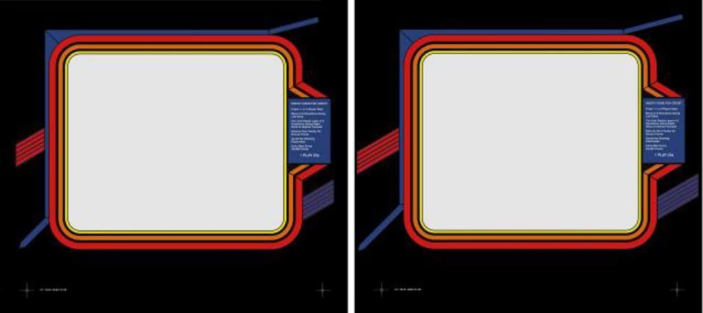

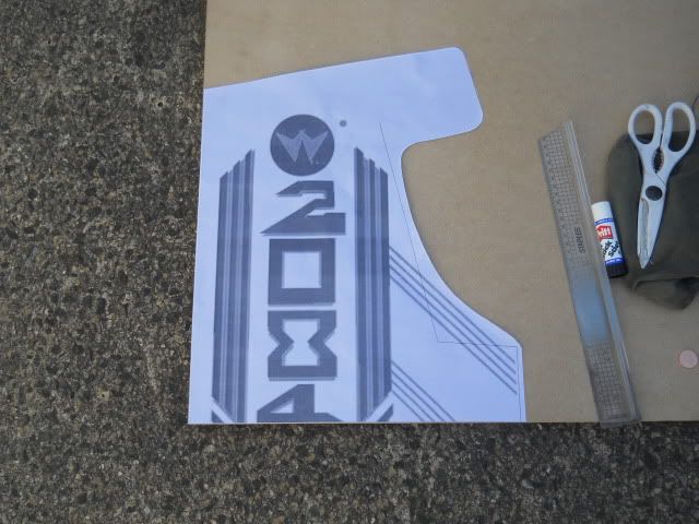

I've also been working on the bezel which I'm gonna get printed myself. I took the original bezel image and resized it to 50%. However I found I needed to resize to 43% in order to get the aperture to fit my monitor screen even close. And then I had to make further tweaks as the original bezel isn't exactly 4:3 ratio to the screen. You can see here the comparison. On the left is original bezel image. On the right it's been tweaked slightly. Again, not totally original but I dunno if anyone would even notice the slight adjustments.
EDIT:  Sorry for the poor quality of this pic. Looks crappy. But the original is at 300 dpi and looks lovely on screen. Just hope it prints out as nice.  ;)

Nice work on getting those bases mounted! Those sticks don't look like they're going anywhere, but I'll throw the question out there anyway. If strength is a concern, are the inserts better off on the top of the panel, or do the outside ridges themselves provide sufficient support?
I'm thinking along the lines of a T nut. If that doesn't work with inserts (because they'd unscrew themselves or something like that) feel free to set me straight.
Either way, keep up the progress. Minis with CRTs make my iCade hide in shame.  :)
Well to be honest with you it's the first time I've used these. And I've never used T-nuts either. I'm not sure how you mean mounting in the top of the panel though. The whole point is that the top of the panel is flush with no signs of any mounting at all. The nuts are 13mm long going into 18mm MDF. As you say, they aren't going anywhere! It really is a solid setup. The outside ridges work really well into an 8.5mm hole. Obviously had I made the hole much larger then yeah, the ridges would eventually have no wood to bite into. I did practice on a some scrap wood first to see what size hole was best fit to screw them into.
Thanks for the clarification. I saw the pictures all at once, so inserts from the top made sense to me, as they'd be under your plexi squares. But with the routing and plexi having been added to solve the dust washer clearance, 'top' wouldn't have seemed like an option originally.
The way it would have worked is to drill all the way through with a bit sized to the bolt, then 13+plexi mm down from the top with the bit for the insert. (Something to try next time you have to suspend a closet rod instead of a joystick I guess)
Anyway, stop reading and go make more progress for us to be jealous of.

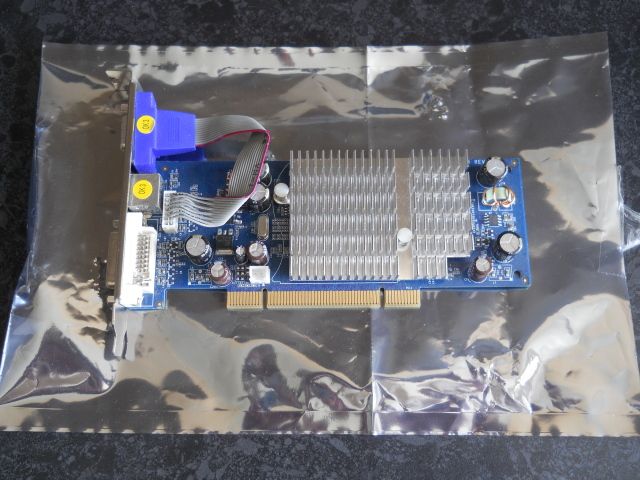

I've also had to make a change of direction as regards the monitor. I cannot use the CRT I intended to use as it simply won't fit in the project well enough. The depth is just way too large. It would mean extending the depth of the cabinet by around 70-80mm which would just make the side profile look odd. I could get away with 10-20mm but having drawn out the side profile necessary it instantly looked silly. So I'm gonna go with an LCD, but this does have some advantages. It means more room to get the other bits in, a lighter end product and I can also use the original bezel art albeit at 50% size.

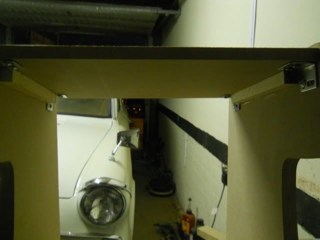

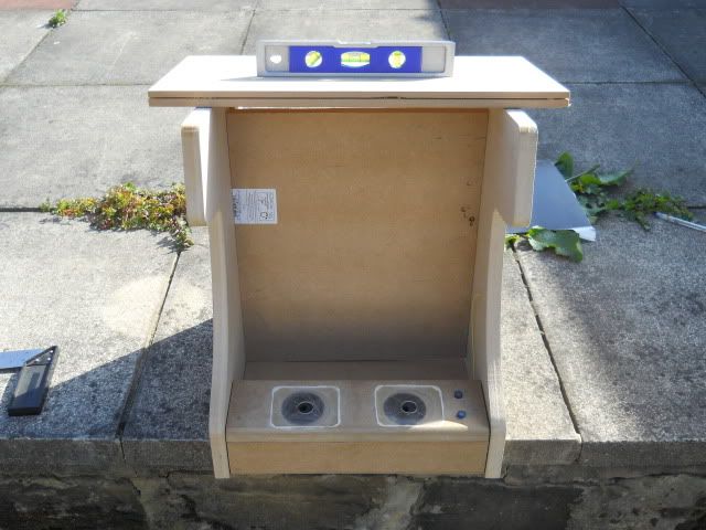

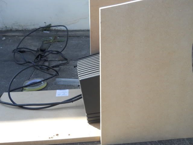

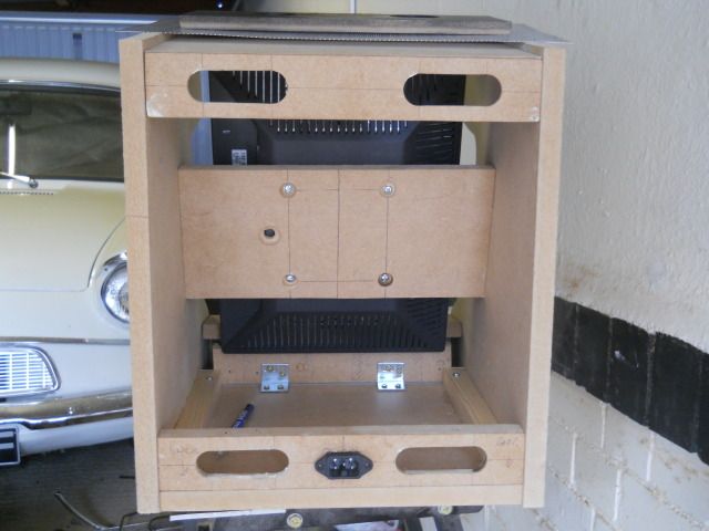

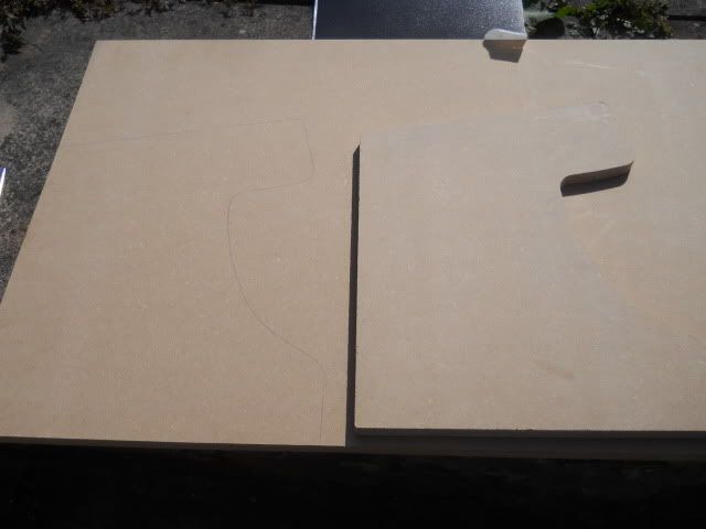

Here's an update on what's been done on this last weekend. I started to make the side panels:
Now I searched high and low for plans or dimensions of an upright Robotron cabinet. Couldn't find anything anywhere except for a few tidbits of information. I know what the width of my bartop will be because I'm sticking to the artwork Scott printed. I asked for 50% size of original so I must be confident that his full size art is spot on. I'm sure it is.
I also found out the depth of the full size cabinet on two different forums and both measurements were the same, so I'll take that as accurate. Then I found this template of a side on profile. No measurements came with it but I just adjusted the image so that the depth was half the size of original. Those curves look accurate to me so I went with this template.
Here's one side cut out. I just roughly cut the second side out a couple mm larger. Then I put the two sides together squaring up the back and bottom edges and used the flush trim router bit to get two identical sides.
Here's the sides installed with a temporary piece in between. Yes... it's spring and we need to do some weeding.  :lol

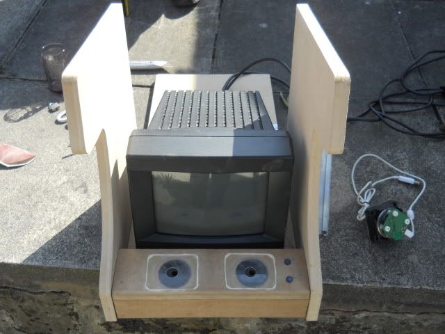

Here's the monitor I intended to use. I have three of these! Shame I couldn't use it.....
..... and here's why. It just sticks out too far. I could extend the side panels but the finished cab would look silly. The monitor would even stick out further than in this pic because the monitor needs tilting for the screen to match the slope of the bezel. In this pic it's just sitting flat. I've got a nice Dell 15" monitor I got cheap on eBay that will be fine. May need to turn it to portrait mode though.

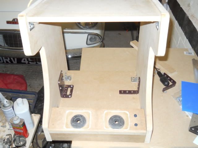

Here's the top panel temporarily installed. I switched to 12mm MDF for this panel and the speaker panel for reason that will become apparent later. I want this top panel to be removable so that I can easily get to the marquee lights and speaker etc. I just put it in like this to make sure that everything is square before I put the wood bits in I will eventually screw it to. The back of this panel has been chamfered off at 45 degrees so that it will meet the top rear panel (also chamfered) perfectly. Well.... maybe not perfectly. I do have a degree of tolerance with my build techniques.  :P
I also had to put those two heavy duty angle brackets in there to help keep the side panels square. The smaller brackets alone weren't up to the job.
And here are the bits of wood glued in place after checking everything is square. The brackets will be removed once this has dried and is screwed in place properly.

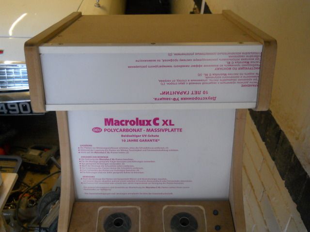

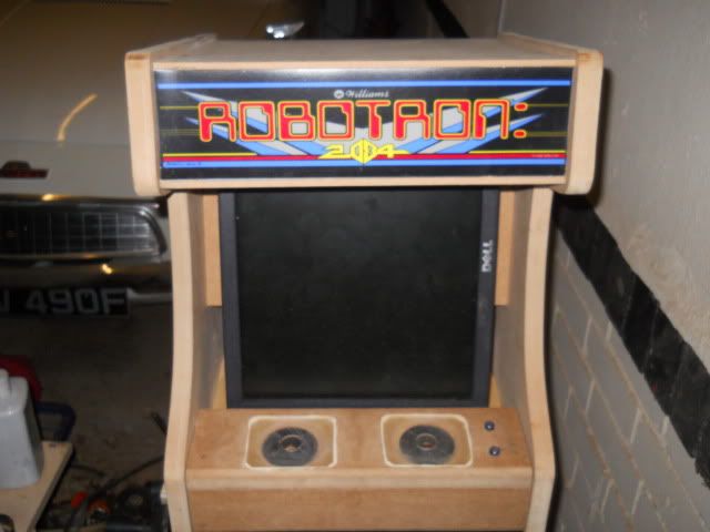

Did a bit more this afternoon. I basically wasn't happy with the way the inside of the cabinet looked with all those different brackets. I wanted it to look cleaner so set about it. I know I'm not doing anything ground breaking with this project, but I want to push the envelope a little further as far as my own work is concerned. I want things to look neater inside as well as out.
Much cleaner now but still not professional by any means. I will probably place a piece of hardbaord over those wooden bits to put the motherboard on later.
This is the marquee section I cut out. It's stepped in by 6mm each way. I did this because on previous projects it was so easy to just place the marquee up against the MDF and have marquee holders top and bottom. But of course by doing this the top and bottom of the marquee don't get any light as they are pressed up against the MDF. Depending on what thickness panels you have it can make the marquee look poor when lit. I definitely didn't want this with Robotron as there is a blue line that runs across the top and bottom. So long as all this is lit up then I'll happy with it. Marquee will be sandwiched between two pieces of 3mm clear plexi and then sit in the recess. 10mm corner trim from B&Q will act as marquee retainers overlapping the edge of the art by around 3mm... easily enough to hold it in place.
Couldn't resist a test fit of the marquee just to make sure it sits in there nice and square in all the corners. Marquee did need trimming a couple of mm or so at each end to fit the recess. Marquee art was slightly wider than the control panel but I don't mind trimming a bit here or there. Better than being too small.  :P

What if you de-case the TV?  Is there enough space to get it in there without the plastic?
LeedsFan
  • Posts: 1043
Re: Robotron bartop
« Reply #22 on: April 10, 2012, 03:02:37 pm »
I actually had to take the casing off to remove the touch screen overlay that was fitted. These monitors came from a bowling alley I was told. Once the case is off though there isn't any way to save more room. So it's the LCD now utilising HLSL effects in Mame.

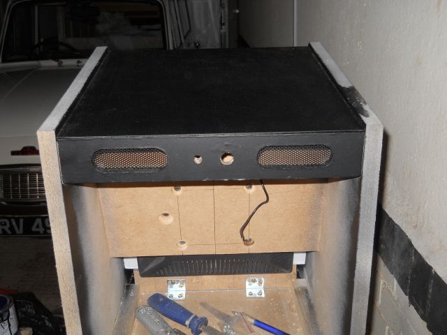

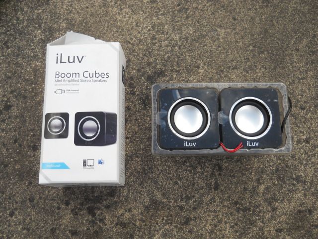

More updates of what's been done.....

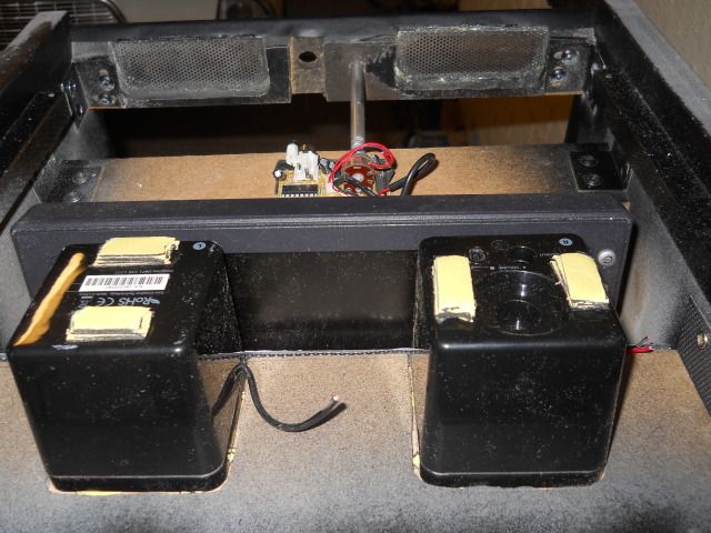

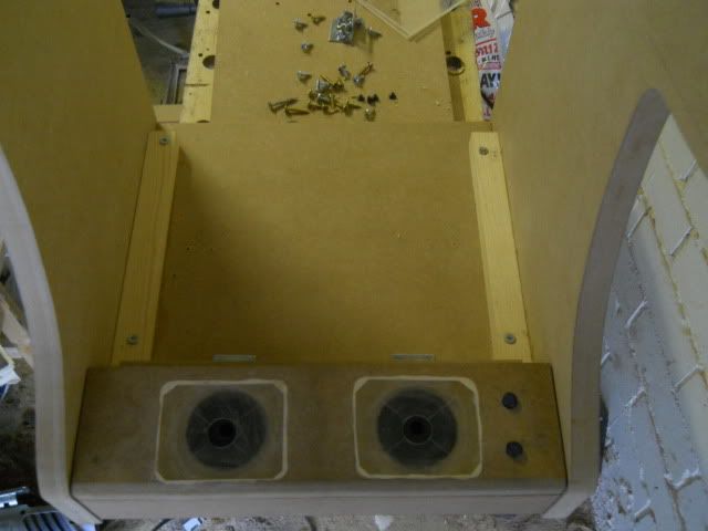

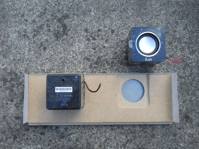

These are the speakers I've decided to go with. iLuv Boom Boxes... yeah right!  :P  But I'm sure they will be ample good enough for this little bartop. They were only £13 from my local Argos and the very square design helps with installation. I've cut the wires and removed the little pcb inside so I can have volume adjustment on the back of the cab. Just need to solder stuff up later when the PC goes in.

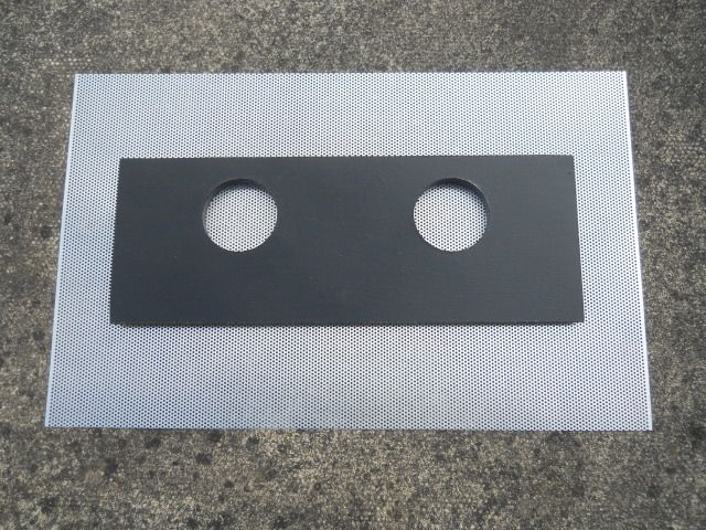

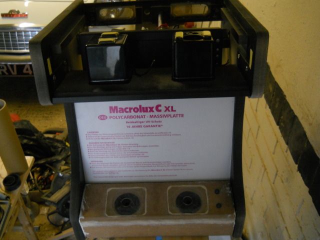

Here's the speaker panel cut out together with a sheet of perforated aluminium which will form the cover for the entire panel. The original was like this too, except of course that had a single mono speaker in the centre.
Here's the inner side of the same panel. The aluminium has been trim fitted. I routed out about 5mm for the speakers to sit into. When the panel is in place there is about 3mm or so between the top of the speakers and the top panel. But this will be taken up with some double sided sticky pads on both the front and back face of the speakers. This should help reduce any vibration or resonance that you can sometimes get with speakers mounted directly to the wood in cabinets.
The front side of the speaker boxes will also have a piece of perspex running the width of the marquee to which the cold cathode tubes will be attached. Yes... these little cube speakers do help with other stuff in their design.  8)
Here's the perspex cut to size and sitting in place together with marquee retainers.  I've not decided whether to use tinted perspex or not for the "inside" piece. (Bezel artowrk will be sandwiched in between). I got three pieces cut anyway (one tinted) so I can go either way with this decision later. I've got to paint these retainers because I wanted "L" shaped trim at  20mm x 10mm so I had room to install the screws - remember I took out 6mm  step for the marqee plexi so 10mm up top would have been too tight. And B&Q only stock this trim in white.  :dunno
Here's the cabinet upside down with the speaker panel now in place. Screws heads will be covered with those little screw caps. Once I was happy with the installation I then removed the speaker panel and retainers and got them primed ready for spraying satin black tomorrow.

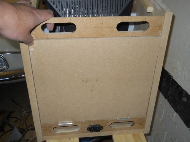

Here's the short rear panels between the door. I've tried to copy how a real Robotron looks at the back too. Not exact of course. Those holes will be covered on the inside with the same perforated aluminium as the speaker panel. I've still got to fit the power switch and volume control and they will sit between the cut outs on the upper panel. On a full size Robotron this space had a handle fitted to help when moving the cabinet around. But I have to put the power and volume somewhere and that panel section is only narrow so I don't want to give the impression that someone could pick the cabinet up with any handle I may have put there.
Last thing I did today was to get the door fitted up. Still need to drill and fit arcade lock with will go up centre top.

looking very good!, real shame about the screen but HLSL is still going to look good.

quick question where did you get the perforated sheet from and how much,if you don't mind me asking ??

You can use modder's mesh... http://www.frozencpu.com/cat/l3/g43/c12/s450/list/p1/Case_Parts-OEM-Misc_Case_Parts-Modders_Mesh_Panels-Page1.html

Here in the uk B+Q have a selection of mesh sheet its over by the bondage section, sorry the chain section.

B&Q don't have the mesh in small enough hole sizes.
This is where I got the mesh from.......
http://www.greatart.co.uk/PERFORATEDALUMINIUMSHEET-modelling.htm
Bear in mind that this website states "UK's largest range of art materials" but in actual fact my mesh came from Germany, delivered by DPD courier. This added £8.00 for the postage which at first I thought was for guaranteed next day delivery. Not until I checked the tracking did it dawn on me where it was from. DPD being a German courier I probably should have known.  ::)
But this mesh is with very nice and is easily cut with scissors. I bought the second one down in the list (80013) which has 1.5mm holes. I received two sheets as well, not just the one you see in the pic.
That B&Q sheet you linked to is steel which will be a little harder to work with. Won't cut with scissors anyway.  ;D

Front view of cab with speaker panel now installed after painting. Speakers are not yet fixed in because I need to solder up the wires etc. The front face of the speaker enclosures (as you see in the pic) will support a piece of plexi or hardboard to which the cold cathode tubes will be attached. I also ran some wood putty over the slight edge of the front of the control panel. This will need sanding and cleaning up before the artwork gets put in place.
Close up of the top. Speakers are padded out with some rubber strip so that when the top panel gets screwed down they are gently pressed in slightly. As you can see MDF dust is everywhere! Gonna need a good clean up soon.
The volume control is sitting on that brace across the cab which will be tie-wrapped down securely. It needs to be set back like that because I need to plug in a phono lead for the other speaker and that would otherwise have fouled the power switch. I had to make an extension of sorts with some aluminium tube for the volume control.
Here's the only bit of PC internal hardware I had to buy - Geforce 6200 PCI graphics card. The donor PC was given to me by a mate for services on his Mame project. It's only a Dell Dimensopn 2400 which is plenty good enough for the Robotron. However the onboard graphics chip doesn't support Pixel Shader 3.0 which is required for HLSL support in Mame. So I had top get this second hand card from eBay.

First off, This project is awesome. I'm glad someone else has thought of doing a Robotron bartop and if I ever get around to making one I'll be following your lead!
Secondly, I was struggling with how to do the dust washers to mimic the original Robotron set up for my Retrotron project. And this is an excellent idea! I think I'll need to borrow this from you.  :cheers:
