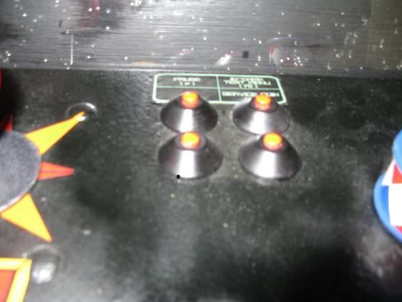

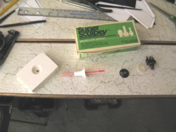

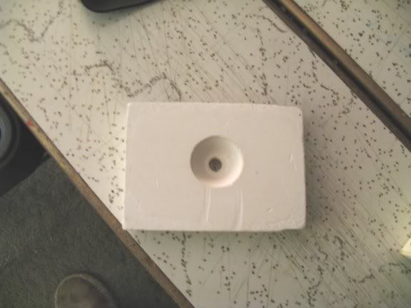

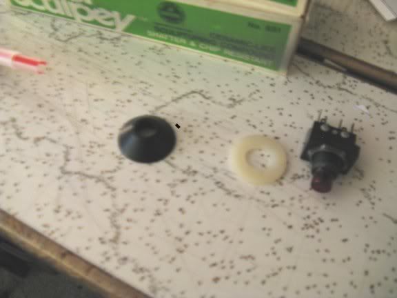

When I made my first set of homebrew Atari volcano buttons, I knew I was going to want to re-do them someday. Sculpey proved far easier to sand than I expected, and that accidentally resulted in a variety of sizes among the cones. I had also tried a mix of "metal" and black cones, and it just didn't work for me. So I ordered a couple of volcano cherry switches off of Ebay for five bucks, then set about casting a set of 12 from one of those cones.
Left - the plaster cast; Middle Top - wonderful Sculpey; Middle Bottom - a funnel tip and thick plastic straw that was my original mold; Right - cherry switch, washer and cone.
I only used the cone from the cherry switch assembly.  I already had an array of 12 switches installed, and it would have been a royal pain (and expensive) to replace them all with cherry switches. I actually got a pair off Ebay; one was perfect, the other was scarred with the familiar cigarette burn and so useless to me...
I filled the cone's center with Sculpey before casting-- otherwise it would have gotten stuck in the mold (it's threaded inside). Then I poked the straw through that center filling. The straw is the same size as the buttons in my panel, so having the straw in the center during casting made a proper sized hole in the top of the mold. I applied a light smear coating of Vaseline on the cone to keep it from bonding to the plaster, then poured the mold.
(underside of the mold)
After the mold hardened, then I pressed 12 wads of Sculpey into it, one at a time (making sure to smear the mold with a small dab of vaseline before each). Then I stuck the straw in from the top to punch out the hole, and also to help push the cone from the mold without distorting the shape.  Then I dropped the cones in a glass dish and baked them (about 25 minutes for something this size). After they cooled, I lightly sanded any rough edges, then applied a few coats of black rustoleum.
Voilŕ! 12 cones, uniform shape and color. I had all this stuff lying around, so it only cost me ten bucks total and that was just for ordering the original cone off Ebay.
I was content with non-illuminated buttons, again considering the cost of accumulating 12 cherry switches and the prospect of some awkward router work. Then a light went on in my head: I had already installed a blacklight to kick on the glow in my Tron and Satan's Hollow sticks. So I got some red flourescent paint, painted all the red buttons, and once that dried I applied a generous amount of clear gloss coat; several layers, in fact, to last through many, many presses. I also got a sheet of flourescent yellow paper, and printed out the radioactive symbol as an insert for the center button on the top tier.

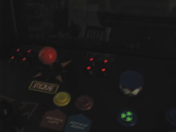

...Machine off...
...Machine ON!
I'm much happier with the cone array now. The uniform shapes look so much better, but either way I should have gone with a single color for the entire array from the very start.

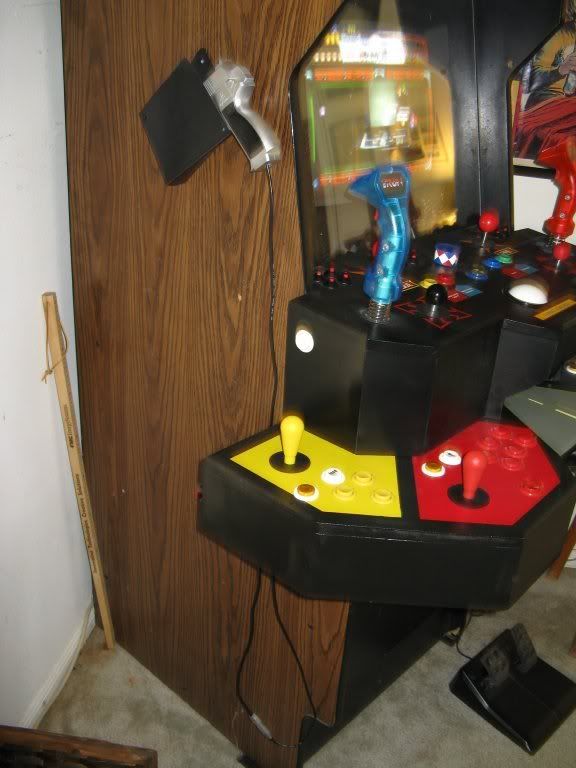

Moving on to the new Aimtrak! Below is the Aimtrak gun in its holster. I made the holster out of the black plastic cover from one of those narrow 3-ring binders-- the plastic is a single textured sheet, thin but sturdy.
The gun is an old PS1 Guncon, gutted and repainted.

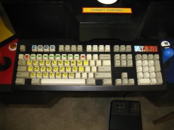

Some gussying-up of the Thayer’s Quest-labeled keyboard.  I layered several coats of clear gloss onto the keys, basically turning the paper stickers into plastic. I shaved the edges of the stickers with an exacto knife to make them nice and smooth and flush with the keys, and now you can rake your fingers across the keys without noticing the stickers at all. I had a few of these metallic Atari stickers that I have no idea from whence they came, and one of them fit quite nicely into an indentation in the upper right.

Could you show me a close up of your Thayers Quest keyboard? I went thru your posts again and didn't see how you made the stickers. How did you do that?

Hey angryred,
Well, I started with this image...
...from the TQ DaphneWiki here:
https://www.daphne-emu.com/mediawiki/index.php?title=Input&printable=yes
...It was the best quality image I could find at the time; I still don't see any better in GIS, but who knows what's lurking out there.
I upped the resolution, and did my best to clean up the image, but going that route there's only so much I could do to it before I made the lettering illegible.  It really was more of a quick and dirty thing; if I had been more dedicated to this portion of the project, I would have either 1) searched out someone to take a nice, well-framed, high-res pic of an original TQ panel, or 2) just used the above image as a template for colors and positioning, and re-done all the lettering with vector text in PS, retaining only the item images.
Feel free to use the below image (click for full size, print out at 8"x10"):
...The panel is duplicated 3 times because I printed it on a sheet of Avery address labels; I was trying to get as many keys as possible on one sheet unbroken by the address label seams, so that each key was a single sticker. Even so, after I cut out as much of a whole set as I could, I still had to cook up the following image, as the keys below were all broken by label seams in the first image (click for full size, print out at 8"x10"):
...Again, quick & dirty.  I did it this way 'cause I had the labels lying around and didn't have to go out and buy anything, but if you were to print out the single image on a full sheet of unscored sticker paper, you wouldn't have to worry about the label seams at all. But for me, this was another one of those "wild hair" projects I took off on that I was determined to finish in a single afternoon or evening (not counting later tweaks).
I cut all the keys into small squares with an exacto knife, then stuck'em on.
Once they were all on there, I gave them several coats of this:
That stuff soaks right into the paper (but doesn't blur the images at all), and by the time they're dry, the labels have all but turned to plastic.  The only hink was that since I had cut the labels as little squares, the corners of the stickers stuck out past the rounded corners of the keys and needed to be trimmed down. I just ran an exacto knife alone the edges of all the keys; stiffened by the gloss coat, they were very easy to shave right off and return the keyboard to a very smooth feel.
Geez, dirty keyboard I see, now that I zoom in. Shoulda run it through the dishwasher before I started all this. That keyboard's been around the house since I had:
...I have a salvaged Sony Vaio keyboard-- small & flat-- that I envisioned for a someday redo of this project; that would probably come with the emergence of a nice high-res image.
Zooming in, I see I need to take the exacto to that "H" again...
If your arcade machine has to have a keyboard, what's more appropriate than a Thayer's Quest keyboard?

Thanks Red, Just what I needed. I don't know if I will be playing TQ any but it does give me ideas for the games I want to do. I guess the toughest part will be finding good images. Or just making my own.
I was wondering how I was going to find the right sized stickers too. Never thought of just printing them on blank sticker stock and cutting them out.   ::)

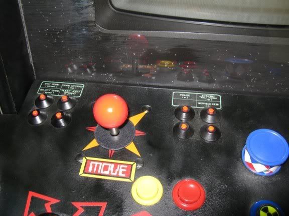

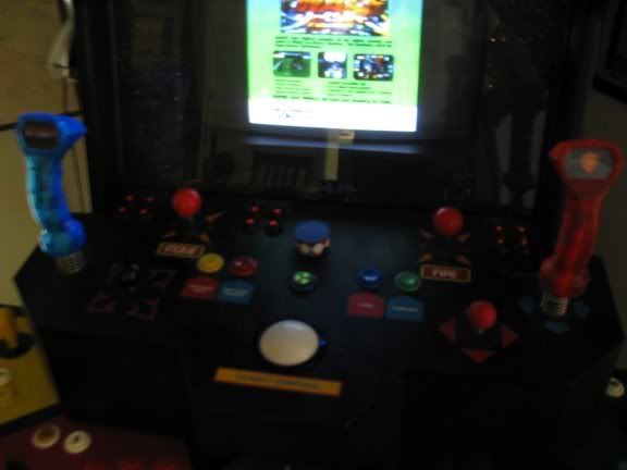

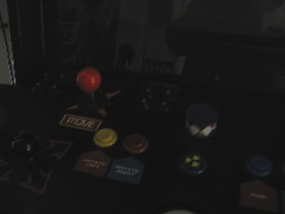

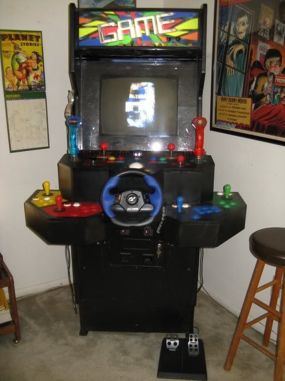

So, after a couple of years I decided that yeah, those two 4-way sticks DID get in the way more often than not, particularly when my hand slipped off the 8-ways while playing. So I set upon a rebuild of the upper tier of my control panel. The big difference this time: we're living in our own house now, and it's a LOT easier doing a project like this in your garage instead of on an upstairs apartment balcony.
I made another foam core model of the upper tier, and incorporated 2 angled panels to house the 4-ways. Space was pretty tight, but I managed to get everything in there, and also get rid of the "cliffs of doom" appearance that the height of the second tier used to have. And this time I cut SQUARE holes for the 4-ways-- finally, 4-way restrictors!
I also got to redo my volcano admin buttons (top row) so they're all nice, solid, and perfectly aligned; they were too much of an afterthought the first time, and came out looking a little sloppy. Of course, the spinner got rebuilt AGAIN...  ::) ...smaller footprint, and I finally built a solid adjusting arm for the mouse sensor board. I can adjust it quite precisely now, and tighten it into position. It was a little too "bendy" before.
Once again, the graphics are all adhesive vinyl labels, but that turned out to be a lot trickier this time. When I decided to get started on the rebuild, again I called up my buddy Rick at the sign shop and asked him if he still had the files we used the first time; he did, and would print more out soon.  Then he got fired two weeks later, before he got the stickers cut.
Fortunately Rick was smart the first time, as I remembered that we had cut multiples of many of the labels, and I also remembered where I had tucked them away. Almost all of the lettering existed, and most of the shapes.  With some extra thin colored adhesive vinyl I got at an art supply, I was able to cut replicas of the missing pieces (mostly simple angled geometric shapes).  I lost the Gorf "FLIGHT CONTROL" and its blue arrows, and I almost lost the Missile Command "TARGET CONTROL"; I gave up after one sign shop could only cut horribly mangled letters at that size, and still wanted to charge me for it. But despite the twisted condition of the original, dismantled, top tier, I was able to rescue the Missile Command label, crop and clean it up, and transfer it to the new panel successfully (that was a huge 'if' when I started).  Good Guy Rick was also kind enough to come over and do a professional application of the labels. They were his idea in the first place, and I couldn't bear to lose them in the rebuild. They really jump out at you.
And oh, yeah. Chrome headers, baby.

Is it hard using the 4ways at that angle?
Unstupid
  • Posts: 997
Re: My sweet baby... GAME (top tier rebuild)
« Reply #50 on: September 06, 2012, 12:41:33 am »
Wow!  How did I not see this cab before? :o
angryred
  • Posts: 78
  • Last login:October 20, 2023, 12:46:57 am
« Reply #51 on: September 06, 2012, 03:23:38 am »
Nope. :)
