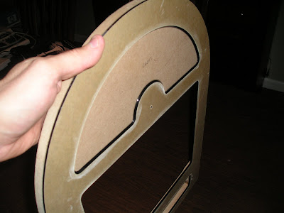

Back in July I started working on a new project and I wanted to make a little progress before announcing it.  Before I start documenting everything I've done so far I want to give a HUGE thanks to mountain for (1) building his awesome Jukebox which I am shamelessly ripping off and (2) his patience in answering a ton of questions that I keep asking him about parts, designs and other issues.   :cheers:
Since mountain's build is way out of my league I had to modify his design a bit to suit my skills.  I am not incorporating the rotating base and instead the marquee, monitor and speakers will all be contained in one box.  The entire front will basically look like this with three openings:
The goal for the first night was simple - all I wanted to do was create a template for cutting out the front and back panels of the jukebox.  The dimensions of the template are as shown in the picture and it is made out of 3/4" thick MDF.  The only real tricky part about making the template was cutting out the curve with my router and circle cutting jig and having it transition perfectly into the straight sides.
Next up is cutting out two identical panels to be used to help form the overall shape of the jukebox.

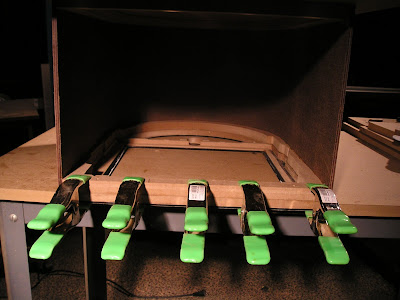

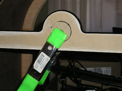

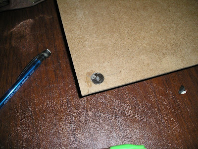

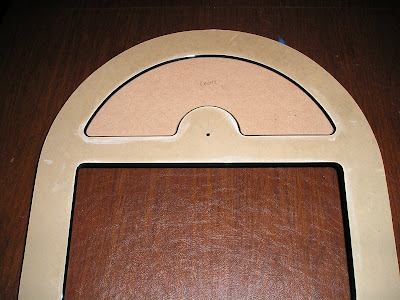

Now that I had a pretty good template, the next step was to use it to make two identical panels. First, I traced the template with a pencil onto 3/4" MDF and cut the panels out with my jigsaw staying about 1/8" outside the line.
Then, I clamped the template to the top of each of the panels I just cut out and used my router and a pattern bit to make two exact copies of the template. These panels will eventually be the frame for the front and back of the jukebox.
Finally, I cut out eleven (!) 2" holes close to the edge of the front and back panels (what a pain) for clamping.
Next step is making this thing 3D!   :cheers:

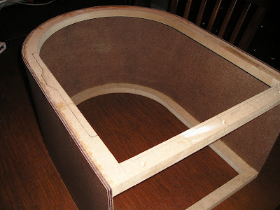

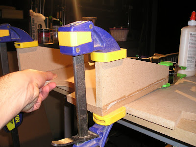

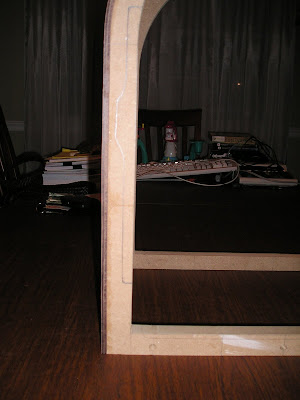

Next, I cut out the base and the interior spacers - I made each panel 9-1/2"x15-1/2" (the exact size of the base).  Then I screwed everything together to get the general shape of the jukebox. I'm using screws here because once the glue dries from attaching the curved panel I'll be removing the bottom and the interior spacers.  The only thing to note is that the front and back panels have to be EXACTLY opposite each other.
Next is gluing up the curved panel to the shell.   :cheers:

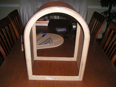

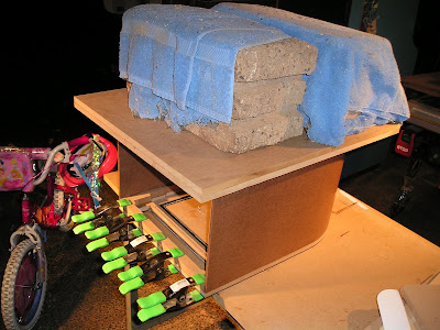

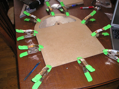

Next I glued a 1/8" hardboard panel to the shell and I was praying that it would bend along the curve without breaking (or putting a serious amount of tension on it). It worked even though the hardboard really wasn't made for bending.
This forms the sides and top of the jukebox - now we are getting somewhere! I'm actually using two 1/8" sheets so the final thickness of the top and side panels will be 1/4" to give it a little more strength. In order to hold everything in place while the glue dries I used those holes I cut out in the front and back panels.
Next up once the glue dried is to use my router and flush bit to even everything out and then glue the second layer of 1/8" material giving me a 1/4" thickness on the curved panel.    :cheers:

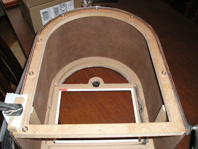

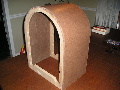

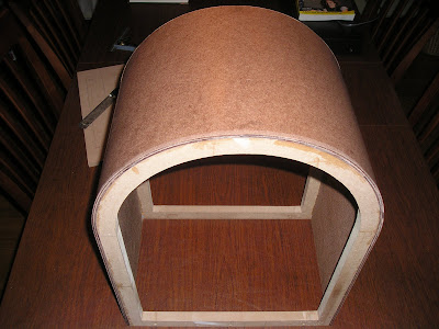

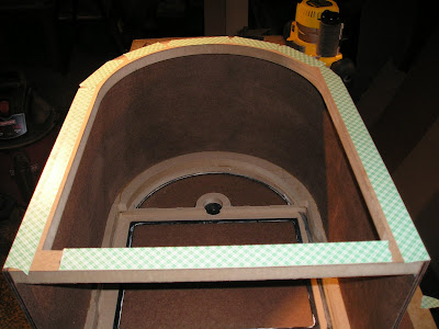

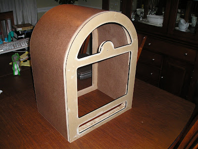

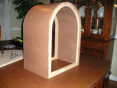

After letting the glue set overnight next came the moment of truth... would the curved panel spring back or would the bond from the wood glue be enough to hold it in place? The clamps are off and so far so good!
Now comes the tricky part - removing the excess material that overhangs the edges. Normally this is an easy task with a flush trim bit and a router, however, going over the curve is going to be difficult. I had to clamp the jukebox in place and then go around the curve ever so slightly. The router base was not laying flat and it was a bit scary.
Success! Check it out - it is really starting to take shape:

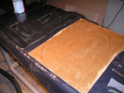

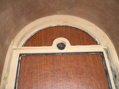

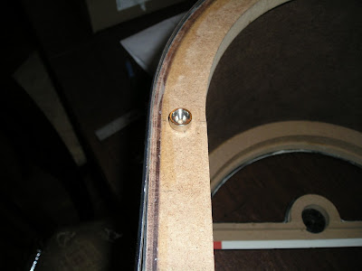

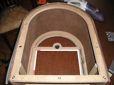

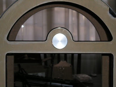

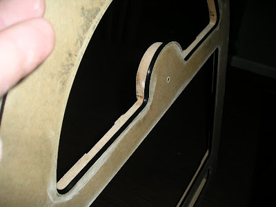

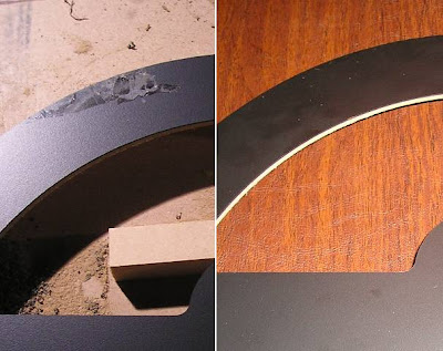

Some more of the build:
After flush cutting the curved panel it was time to add another 1/8" layer to the curve to get to the final 1/4" thickness. This process is identical to what I did for the first 1/8" panel only this time I have a lot more surface to glue to. I was also able to use my two band clamps to help keep everything nice and flat.  You can kind of see the two layers in this blurry picture:
Before starting, I roughed up the surface of the hardboard with some 100 grit sandpaper so the glue had something to grab on to. I'm hoping the glue holds over time but so far so good...
Twisted Tea for scale.   ;)

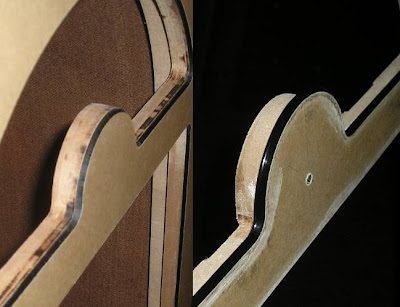

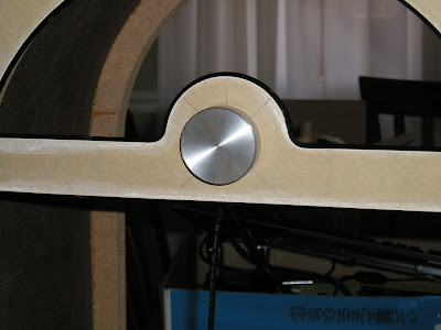

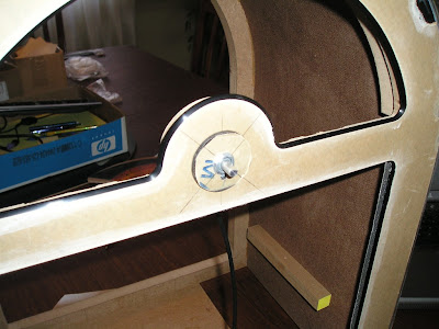

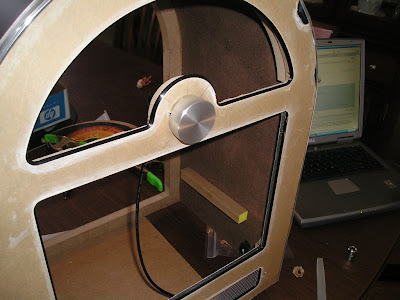

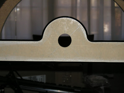

The next step was to begin making the front panel.  After thinking about it for a bit I realized this part is going to take quite a bit of time. I did manage to cut out the general shape of the front in less than an hour though.
First, I traced the shape of the front of the jukebox onto some 1/2" MDF and rough cut it out with my jigsaw staying about 1/8" wide of the line.
Next, I screwed the panel down to prepare to route the panel to size. I am not worried about leaving holes in the jukebox because the material will eventually be removed.
After the piece was secured in place I used my router and flush cutting bit to make the 1/2" MDF panel exactly the right size.
Finally, I removed the newly cut panel.
Next up is laying out the hole openings for the marquee, monitor and speakers.

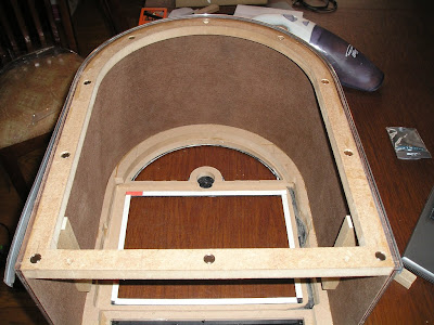

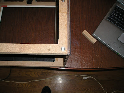

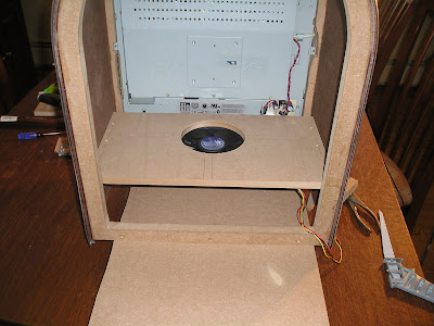

OK - this is kind of what I've got going on right now.  It is an EXTREMELY tight fit to get everything in behind the panel.  The semi-circle in the middle of the marquee area that is not getting cut out is where the volume knob will go - just like mountain's.  I don't have exact dimensions written down anywhere - I'm just sort of eyeballing it - but this gives you an idea of the general layout.
The usable touchscreen area of the monitor is 11-15/16" wide by 8-15/16" tall. The 11-15/16" dimension will define the width of the side borders which will be 2-1/32" wide each (the width of the panel is 16"). After laying out the side borders I had to decide how thick I want the borders to be on top of the curve, between the marquee and monitor, between the monitor and speakers and between the speakers and the bottom edge to make the overall layout pleasing to the eye.  I also wanted to make sure that the ends of the marquee were in line with the sides of the monitor and speakers.

Now we are getting somewhere!

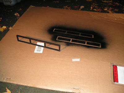

The next thing I decided to do while thinking about the final layout of the front panel was to remove most of the material in the jukebox leaving only the shell. I used my circle cutting jig to cut out the arcs on the top of both the front and back panels. I also unscrewed the bottom panel and the interior spacers. It probably weighs less than a quarter of what it did before (it's light!). These pictures just show the rough cuts with the jigsaw - I will post "clean" pics when I get a chance.
Here are a ton of pictures for no good reason:
I did have a concern about whether the shape would hold once all of the material was removed but it does not seem to be an issue.   :cheers:

Nothing major to report - Here are some shots of the cleaned up shell.  I used my router, a straight edge and a pattern bit to make the edges straight. I used a Japanese hand saw to square up the corners. The whole process took less than an hour.
Now the shell is complete the next step was cutting that front panel out - which is a HUGE PAIN - and squeezing everything inside.  I'm about 75% done with it right now and it has taken at least 20 hours for just the one panel.  I work slow though.
I still haven't ordered the computer parts yet mainly because I don't know what will be adequate.  I want to have between a 300GB and 500GB hard drive in there but other than that I have no idea what to get.  Since it will only play music and a few casual games it doesn't have to be powerful and I'd like to keep it on the cheap side.  I need a motherboard, some RAM, a power supply, a HDD and probably an internet card.  Any suggestions would be very helpful.   :cheers:

My goal this week was to have the front panel completely finished and glued to the shell but I still have a lot to do.
- remove material behind monitor opening to mount monitor flush
- remove material behind volume knob
- remove material around top of volume knob
- cut speaker grill and install
- cut speaker fabric/material and install behind grill.  I still have to buy the speaker fabric/material - anyone know of a place?  I only need a tiny bit.
- cut marquee pattern out of 1/4" MDF
I'm a bit nervous to use my foerstner bit to remove the material behind volume knob so the guts of the powermate has a place to sit.  I don't want to go through the Plexiglas on the front side!  I also have no idea how to drill a hole through the Plexiglas for the volume knob.  Every time I've tried drilling through the Plexiglas it chips - the only router bit I have for the job is a 1/4" bit which isn't quite big enough... I'm sure I'll think of something...   :cheers:

For drilling out the plexi I have used forstner bits and spade bits with hardly any problems.  On the spade bits make sure you get the ones with teeth on the ends.  Use a piece of scrap wood behind the plexi, don't use any pressure on the drill and let the bit sorta melt it's way through.  You can then clean up the edge with a small round file cutting at about 45*.
  • Posts: 8001
  • Last login:October 18, 2026, 02:44:30 pm
Re: Someone call the cops! I stole a Jukebox!!
« Reply #36 on: September 09, 2008, 11:21:31 am »
Hmm... maybe I'm just applying too much pressure.  There was definitely no melting involved the last time I tried!   Tonight I'm going to try and knock off the first three things on the list above even if it kills me... or rather even if my neighbors want to kill me for using the power tools past 10PM.  :cheers:
Applying too much pressure will crack the plexi every time.  Practice on some scrap plexi before you commit to the actual piece.
mountain
  • Posts: 1205
    • Mountain Jukeboxes
« Reply #39 on: September 09, 2008, 12:30:32 pm »
When I need a hole in plexi that is under 1/2" I always use my unibit. It is single fluted so it basically shaves the material from the inside of the existing hole. I have never had plexi crack using this method.
Here is a picture
  • Posts: 8001
« Reply #40 on: September 09, 2008, 12:53:08 pm »
Wow - cool.  I've never seen one of those things before.  I assume it's a drill bit and not a router bit, right?  I'm going to see if I can pick one of those things up...   :cheers:

Yes, it's a drill bit

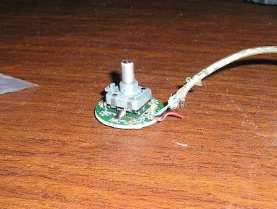

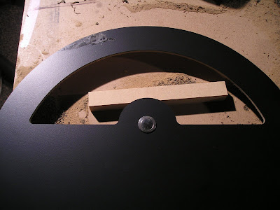

Here's where it starts to get fun (sort of - more on that in a bit).  Once the Griffin Powermate arrived I was able to take the measurement of the diameter of the knob [1-11/16"] and make sure the openings for the marquee, monitor and speakers were laid out properly.

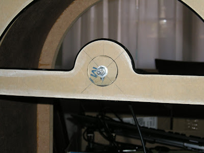

This part of the project is very very complicated. Not only do I have to cut out the openings but after I use the template to cut the 1/8" black plexiglass (which will be the front face of the jukebox), I have to remove additional material behind the openings in order for the monitor, marquee and speakers to fit. This is going to be especially tricky for the monitor because the mounting brackets are at a different height so I'll have to set the depth of my router to be as precise as possible.
The first section to cut out must be the curved marquee opening. In order to cut out the curves perfectly you need a pivot point for the circle cutting jig to turn on. If you cut out the monitor opening first there won't be any place for the pivot point!
In order to cut this opening accurately, I used my router, a 1/2" dado bit, a straight edge and my circle jig. It was quite complicated to set everything up and I had to make 4 passes with the dado bit removing about 1/8" at a time to cut through the 1/2" MDF.
I really like working out in the garage with the radio on or whatever (although the Mets bullpen makes me mental) but I was at the end of my rope when I was cutting this out.  I messed this up on my first try - I couldn't seem to control the router properly. I lost about 4 hours worth of work that I had to make up just to get it to this point.
Here is what the panel looks like attached to shell. Pretty cool!
Next up is the other openings and cutting everything to size.   :cheers:

OK, the next thing I did was rough cut the remaining openings for the monitor and the speakers. With the tools I have it took me a while to figure out how to cut each of these openings with 1/4" radius corners.
At this point it is starting to take shape...

I think the 1/8" acrylic would work just fine for the back panel.  The piece I initially ordered is mostly used up from making the front panel so even if I wanted to I don't have enough left.  Also, for personal aesthetic reasons I think I like the laminate look for the back panel.  Plus, in my particular design I am going to be cutting out quite a few holes for usb ports, etc. and I think the laminate will be a little easier (not much) to work with.  Depending on the sturdiness of the laminate I might glue it to a 1/8" piece of hardwood.
The real question I'm struggling with is how to attach it yet make it easily removable.  There will be t-molding around the edge to consider.  I'm leaning towards magnets so it will kind of just pop off but I'm open to all suggestions.   :cheers:

I would highly recommend using some kind of backer for the laminate back panel, 1/4" at least in thickness.  You need something a little more substantial to attach your ports.  This will also give some strength to the laminate so it will not flex and end up cracking as you plug in or pull out the cords.  Magnets would be a good solution.   I would suggest the rare earth magnets that are sold here.  http://www.hartvilletool.com/category/524  Mount several around the edge of the case using the metal cups that are also sold at the above link and mount some iron on the back panel for the magnets to grab a hold of.

Looks to me like the T-molding is covering the edge of the back panel.
Im thinking about using the same acrylic as teh front for the panel, and using screws to fasten, but maybe using laminate on the 1/8" "skin" material might be better.
I couldnt find 1/8" mdf anywhere near me (heck they dont even have 5/8" MDF), so Im going to use the same stuff I used on Stevies Jukebox. I think it is some type of hardwood, its 1/8" thick, and pretty cheap. It bends easy, and if you double it, it is pretty strong.

javeryh,
I cut the back panel before laminating the top/sides. Doesn't really matter because the t-molding is going to want to bend down tight onto the back panel. I had the back on the unit when I installed the t-molding, but after removing the back panel for the first time it was impossible to reinstall. I had to trim the back panel 1/16" all the way around as well hold my tongue just the right way to get it back on.

javeryh,
 :laugh2:  Good to know!  I'll hopefully have a slightly easier time with it because my t-molding won't be on the bottom so the panel might have a little wiggle room to slide down before removing.  I'm not sure how I'm going to handle the main power plug though - your design allowed for you to make certain things stationary in the base.  I have some ideas though... :cheers:

Here are a few shots after I cut the openings for the monitor and the speakers to final dimensions. I used a 3/4" pattern bit (for most of it) with the router and ran the ball bearing along a straightedge.
This was quite tricky to accomplish. There wasn't much room to clamp down the straight edge so I had to get creative. Check out this clamping nightmare:
After I finished the edges, I cleaned up the corners using a Japanese hand saw and some sandpaper. Finally, I went over the interior edges of the entire panel with some sandpaper to make sure everything was exactly flat with no noticeable bumps in the corners or anything. This panel will be exactly what the black plexiglass looks like when it is cut so everything has to be as perfect as possible.
I actually used a brad nailer to tack a straight edge to the piece. Since it was being covered with Plexiglas, I sanded the face down smooth before gluing.

One of the rules of woodworking is you can never have enough clamps. :laugh2:  This is looking real good keep it up.  You want to get to that DK cab I know it. ;)

Yeah you can just install it with the bottom facing out, I wanted to take it apart to try to hack the volume control. There is also a nice blue LED inside the speaker grill that lights up when you power on, I was going to change it for a pink LED but its solid. I spoke to mountain and he wasn't able to get his apart either, he seems to think they may have glued it on assembley. I dont know why they would but there is no way its coming apart easily. I may have to get the dremel out   >:D
Hmmm... you just reminded me of something - I was thinking about relocating the volume knob on the speaker bar to the back panel where the rest of the ports are going.  Do you think it's worth the trouble?  I assume mountain just turned his all the way up when he installed it and then just modifies the volume with the Griffin PowerMate.  Actually, I'm not sure there is a reason to relocate the knob on the speaker bar... I might have just talked myself out of it...
Definitely take pics if you start tearing it up with the dremel!   >:D

You are correct! That is what I did. It worked out well since the volume knob is on the side. :cheers:

Alright, some more progress and some more pics:
Here's where it started to get fun - I actually got to work with a material other than MDF! I glued the black Plexiglas (using contact cement) to the front panel. I ordered it from US Plastics and it arrived in the mail 2 days later well packaged and in great condition. It was $21.00 shipped for the sheet. It comes with a protective layer of paper on both sides. The first thing I did was trace the shape of the panel onto the Plexiglas.
Next, I used a razor to score just outside of the lines and then I removed the paper covering to exposed the Plexiglas. Before applying any glue I made sure to rough up the surface of the Plexiglas with some 100 grit sandpaper to give the glue something to hold on to.
The directions on the can of contact cement said to wait 15-20 minutes after applying the glue before sticking it together but that seemed WAY too long of a time (it dried pretty quick). I ended up applying a second coat of glue. I put two sheets of MDF on top and then two cinder blocks on top of that for some downward pressure.
It appears to have dried OK but after doing a bit more research I should have waited the 15 minutes. Apparently, the glue actually does dry and then bonds to the other surface when they are attached since you coat both surfaces. This info will come in handy when I laminate the outer shell.
The next step was trimming the Plexiglas to the exact size of the MDF template using a 1/2" flush trimming bit. Because the bit has a 1/2" diameter ball bearing it left a rounded corner in all of the openings which is exactly what I wanted.
More later.   :cheers:

« Reply #88 on: September 17, 2008, 06:04:29 pm »
Looks good!
How did you line up the front panel on the acrylic so good?
I know that as soon as the two glued pieces touch thats it. It doesnt allow any time to adjust the two pieces.
I like the idea of only cutting the paper where it needs to glue. If I had done that on my last juke I would have had some pieces of acrylic left that I could use on other projects.  :banghead:
  • Posts: 8001
Re: Someone call the cops! I stole a Jukebox!! [09.17.08]
« Reply #89 on: September 17, 2008, 06:18:29 pm »
Looks good!
I just eyeballed it and got lucky I guess.  On the right side of the last pic you can't see it but there is a 1/2" overhang of the Plexiglas - I certainly didn't try to line it up with the edge!   Cutting it to size was ... not hard but different than I had expected.  :cheers:

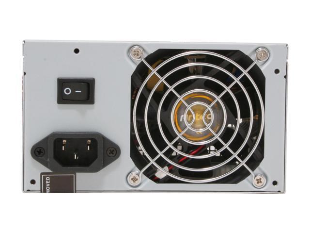

For the power supply looks like you will have to get one of the cases that NewEgg has for sale.  This one is for sale at $45.

Also, I don't need a case but is that the only way to get a power supply for one of these mini itx boards?  I assume it is removable...   :cheers:
I know that this may be a bit late but the power supply in that case is removable.  There are 4 screws on the back panel that hold the PS in place.  I can't tell by the pics if there are any on the bottom but probably not.  I did some comparison and found a power supply that should meet the needs for $17
http://www.newegg.com/Product/Product.aspx?Item=N82E16817104118
TTFN :cheers:

Anyway, here's another update!
Since the plexiglass was now glued to the front of the MDF template I was able to cut it to final size using my flush cutting bit and my router. The ball bearing on the bottom rides along the edges of the panel and the bit cuts through the plexiglass like butter. Here is a shot of how it works:
I had a harder time than I thought I would setting everything up and I had to switch bits in my router to cut out the interior areas (I tried starting with a drill bit and I chipped the plexi and almost had a heart attack!).
The front panel is looking pretty good now - the lines are clean and everything is symmetrical. The rounded corners are a nice touch too, IMO.
Next I'll show the always-exciting process of putting a 45 degree bevel on the edge. Too bad I can't remove the protective sticker until construction is finished - I'm anxious to see what it looks like!

The next thing I did was put a 45 degree bevel on the edges of the black Plexiglas. I used my router again and a chamfering bit and just ran the ball bearing around the interior openings. This is purely for decorative purposes. Eventually, I will have to sand and polish the beveled edge using some high grit sandpaper and the Novus 3 step polishing system to get rid of all the scuff marks left by the router bit.  I hope I can get it looking as nice as mountain does.
I really like how it came out and I'm starting to see what the finished product will look like even though I have a ton left to do.
Next up is the screen mount!  More later.   :cheers:

This is the part where things got interesting.... and tedious.  Since the front of the, um... front panel was more or less complete, I turned my attention to mounting everything to it from behind. This required a bit of routing on the back of the panel to allow everything to sit flush with the Plexiglas.
The first thing I did was build a jig to hold the panel in place and also give me more surface area to rest the base of the router on. I need to have a steady hand for this part because the cuts must be precise.
Once everything was set up I laid out the areas where I would be removing material. I want to be accurate but it is more important that the final depth of my router bit is set at exactly the thickness of the MDF (1/2"). I wanted to remove all of the material on top of the plexiglass but I do not want to chip it. The first area I decided to finish was the marquee opening. I busted out my trusty circle jig and carefully removed 1/8" of material around the top edge. The only thing I didn't get to right away was the area around the volume knob.
If you look close you can see the exposed Plexiglas area. I had to use a razor blade to scrape away a paper-thin layer of MDF and contact cement on top of the Plexiglas which took quite some time.
This was just the first of many steps to get this panel ready to be attached to the jukebox shell... stay tuned.    :cheers:

I started polishing the beveled edge on the Plexiglas last night and I'm really having a hard time with it.  I started with 600 grit sandpaper, moved to 1000 grit and then 1500 grit.  Then I tried the novus polish.  The polish works GREAT on the sections I was able to get very very smooth with the sandpaper but there are still small nicks/craters along the center of the bevel.
I think I need to go back over everything again - I might try starting with 400 or even 220 grit sandpaper and go from there.  Does anyone see a problem with this or should 600 grit be the roughest paper I use?  I spent about 4 hours on it last night - does it usually take this long?
Kaytrim
  • I'm too nice a guy
  • Posts: 2095
Re: Someone call the cops! I stole a Jukebox!! [09.29.08]
« Reply #109 on: September 30, 2008, 10:11:42 am »
To polish plexiglas after a scratch I will use MicroMesh followed with the Novus.  MicroMesh is a washable/reuseable sanding cloth/pad that runs from 1500 all the way up to 12,000 grit.  If the scratch is bad or deep I'll start with a coarser grit paper 220 - 600 then go to the MicroMesh.  For what you are working on use this set.  The real nice thing about these is that you can use them wet or dry and even wash them with a little dish soap in the sink.  If you take care of them and don't force things then these will last a long time so worth the $20 the set costs.
After I go through the grits there is still a haze in the plexi so following up with the novus or other polish gets that last bit taken care of.  One things to keep in mind is the the next higher grit is removing the scratches of the previous grit.  If you leave a few scratches from the previous grit you will more than likely not remove them on the finer grits.  I know that you are a perfectionist so expect this to take some time.  Don't try to rush it or push too hard as it will make matters worse instead of better.
TTFN
Kaytrim
« Reply #110 on: September 30, 2008, 10:18:05 am »
You can use 400 grit, just be careful. The 400 grit will round over your hard edges really easy and turn your 45 degree bevel into a 1/8" round over  ;D
If the pits aren't too deep, the 600 grit will do the job if you stay with it.

Thanks guys.  I guess I'll just stick with the 600 grit and go over everything again until I smooth it out.  I'm pretty patient when it comes to getting it right but it seems like it is taking longer than it should.  I want to finish this tonight or tomorrow at the latest so I'm going to try and make due with the supplies I already have.  I'll try and take a picture tonight so you can see what I'm talking about.  I think part of the problem lies in the crappy chamfer bit I used - I borrowed it from a friend and I don't think it was sharp enough or something.  Plus, it was quite a large bit and made for putting a 45 degree bevel on a piece of 3/4" plywood.  I'm mad at myself for not springing for the smaller $20 bit.

Looking good buddy. I just wanted to echo what Kaytrim said.

That is excellent advice.  I was definitely moving to a higher grit before removing ALL of the pits - I'm not sure what I was thinking.  *sigh*  I will start over tonight...  Also, mountain is right - it is starting to round over a little bit (the top and bottom edges look great).  I have to concentrate on applying pressure in the middle of the bevel.  It is pretty tiring though!  Maybe I'll wrap the sandpaper around a small block of wood to get a flat surface instead of using my fingers...

I posted this in my MAME cabinet thread. It looks like I may have left out the 1000/1500 grit steps but the basic idea is there; take your time and don't rush it.

Thanks for that.  I think I'm going to go down to 400 grit - carefully - and work up from there.  I have a lot of surface to cover since there are three openings.  Maybe I'll do one a night for the next 3 nights or something to have it finished by the end of the week.  At least I can do this in the TV room with the wife so we can spend time together.

OK, it was DEFINITELY the 400 grit sandpaper that did the trick.  There are absolutely no pits and the bevel really shines!  I did the monitor opening tonight in about an hour and a half.   I think I can do both the marquee and speaker openings tomorrow night.  It's amazing - I sanded like a mad man the other night and the sandpaper just wasn't rough enough to do the job.  Anyway, I'm really happy about the way it turned out.   ;D

The monitor mount continues!  Here are some more riveting shots after a few more hours of work.  I used my razor to clean up the contact cement and the thin layer of MDF that was left on the Plexiglas after routing around the monitor opening. It is obviously quite time consuming. The contact cement is kind of rubbery and didn't want to come off unless I painstakingly picked at it with the razor.
This barely scratches the surface of what it took to mount the monitor in place - it looks all nice and neat for now but I can assure you it turns into a gigantic mess back there once I start freehanding with the router.    ;D

Well, I'm getting there. I removed the MDF around the speaker opening and scraped down to the Plexiglas.  The next thing I did was remove quite a bit of material from the back of the front panel. This was done so the monitor will be able to sit almost flush with the Plexiglas. I say almost because of the 1/8" space needed for the "Transducer Wedge" on the front of the monitor.
This process was really no different than what I have been doing to remove the material behind the Plexiglas. I measured the distance from the edge of the monitor picture to the edge of the glass on all 4 sides (with the monitor on, of course). Then I laid out the lines, set up my router and a straight edge and cut out the rectangle so the glass would sit in the routed area.
Check it out - I am getting tired of photographing this thing!
These close-ups give you an idea of how I am setting the router at different depths to get the screen positioned as close to perfect as I can. I should also note that the cutouts here are not symmetrical. As you can see, I left 1/8" of material for the screen (glass) to rest on because I have to compensate for the "Transducer Wedge" located on the bottom left side of the monitor.
The red area I circled shows the Transducer Wedge - as many of you know, it sticks up approximately 1/8" from the glass. I had to route down to the Plexiglas in this corner in order for the monitor to sit as close to flush as possible. The wedge is against the Plexiglas and the 1/8" of MDF remaining provides support.
Finally, even though at this point the monitor is not completely mounted in place, I couldn't resist placing the screen behind the front panel and putting the volume knob in place for a quick picture.
I think I need to start thinking about artwork for the marquee area above the volume knob... and start trying to find a Photoshop expert to help me out!  I really like the "Rock Band" tribal art that Harmonix uses in the game on loading screens and stuff.  I think it would look cool as a background with some font laid out on top - the problem is finding suitable hi-res pics of the stuff and getting everything to look just right...  Oh yeah, I also have to pick out a name!   :cheers:

It sure is.  As of my last post the monitor wasn't fit properly (I was almost there though).  If you look closely you can see the thickness of the MDF (1/2") between the Plexiglas and the screen.  I've got it sorted out now though.  I'm in the process of sanding the beveled edge (I should finish tonight) and then probably tomorrow night I'll glue the front panel to the jukebox shell - I'm nervous about that part!
The laminate I ordered last week should be arriving early next week and I hope to sort out the volume knob placement this weekend so I'll be ready for it.  I think I need to get it laminated before gluing the volume knob spacer in place otherwise it will be very difficult to cut the t-molding slot.  I'm hopeful that by the end of next week I'll actually be wiring and installing the various components...
Check out this post I made in my thread. You can see in the 3rd picture down that I glued a temporary spacer around the face to keep it level when routing the t-mold slots.
Lookin great by the way!  :cheers:
Thanks!  There is so much left to do I still can't believe how fast you built yours.
That's what I thought those things were (after the billionth time I've read through your thread).  To make it a little easier on myself I'm going to route the slot before attaching the spacer.  I'm a bit nervous about routing the slot in the back because of the removable panel.  I'm keeping it at 1/8" thick + 1mm for the laminate.  This should give me enough room but I won't know until I try...

  • Posts: 8001
Re: Someone call the cops! I stole a Jukebox!! [UPDATED 10.03.08]
« Reply #144 on: October 03, 2008, 09:09:16 am »
I finally finished polishing the bevel last night and I don't have time right now to do a proper write-up but here is a "before" and "after" comparison to show the results.
I'll probably go over it once more prior to securing the monitor in place just to get it perfect but it is looking pretty freaking sweet!   :cheers:

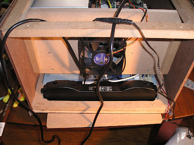

After countless hours of tedious work I finally finished the monitor mount! I was able to remove the remaining material behind the Plexiglas so the monitor would lie flush (well, offset by 1/8"). It is now ready to be installed!
This was by far the most complicated thing I've ever had to figure out on any project. After I finished routing out the material so the touchscreen glass would fit into the rectangular hole, I traced the irregular shape of the outside of the touchscreen. Then I had to freehand with the router to remove more material (leaving the 1/8" for the glass to sit on). Once that was done I had to roughly figure out where the Transducer Wedge would sit and remove additional material down to the Plexiglas.
Check it out:
The strip of exposed Plexiglas you can see on the side and bottom is where the Transducer Wedge will sit. Here are some rear shots of the monitor mounted into place. I had to remove 1/16" of additional material along the top and bottom for the mounting brackets to sit properly.
Yeah - it's kind of overkill but the more pictures the better I guess. It helps me to see things from all angles. Here is a closeup of the side with the wire sticking out. My wife thought I messed up the cut when I showed her the back panel without the monitor in there!
Here is a good shot so you can see just how thin the monitor is. There should be plenty of room in the jukebox shell for the computer components and adequate airflow/ventilation.
Finally, here are some shots of the screen installed! There is a 1/8" gap between the monitor glass and the Plexiglas which will be filled with some black foam weatherstripping when it comes time to install the monitor permanently.
I'm almost ready to glue the front panel to the shell!   :cheers:

Looking good JH!
Is that a powermate I see in the last pic? Are you having any problems getting it to boot up right?
  • Posts: 8001
Re: Someone call the cops! I stole a Jukebox!! [UPDATED 10.06.08]
« Reply #154 on: October 06, 2008, 08:31:18 pm »
Looking good JH!
I haven't really tried it yet but I am quite worried about getting it to work properly...

Well, I did it.  I'll take some pictures tomorrow when there is adequate light.  I just got finished removing the extra material on the shell and I glued the front panel in place.  To give you an idea of how slow I work, I spent about 3 hours doing this tonight.  Whew!
It was tough to line everything up - I think it will end up being OK but I might have to smooth the edges with some sandpaper or something.  I think over time there was a little spring back since I cut the shape of the front panel about 3 months ago(!).  I'm being anal though - you can really only tell if you rub your finger over the edge.  Now I'm worried about the laminate sticking to the edge of the front panel properly.  I have 2 band clamps... I may have to buy one more for the laminate glue up (now I REALLY want the laminate I ordered to come in).
I'm not sure why but my heart is racing right now like I just hope the glue dries OK and everything stays together.  I'm probably crazy... no, I definitely am.   ;D

I went to Home Depot a few weeks back and asked for a j-roller and the clerk told me there was no such thing and I made it up in my head.  "If it is not in aisle 10 with the paint rollers then it doesn't exist."  I was told the same thing about the knob I was looking for to make my circle cutting jig - it must be how they train their employees if they don't know where soemthing is located.  Anyway, I'm on the lookout for one.
Let's talk about the lamination process.  How do you guys think I should go about this?  I plan to cut the sheet of laminate a few inches oversize, apply glue to the mating surfaces, wait the 20 minutes for the glue to dry and then with the jukebox standing straight up I plan to apply the laminate in the center and work my way down both sides.  I will be adding a minimum of 2 band clamps around the thing because I'm paranoid.
Alternatively, I could try to apply the laminate on the bottom of one side and then come over the top and down the other side.  I would have to tip the jukebox shell on its side to do it this way, I think.
Thoughts?   :cheers:
I use non-flammable contact cement from DAP (see pic). Wait till both sides are clear and non-tacky. 20 minutes may not be too enough, or it could be too much. I've had it take up to 3 hours(!) on cool humid days.
That must have been the problem when I tried that stuff. I didn't have any luck and took it back half empty and got my money back  >:D I always use Weldwood original. I like the smell  ;D

I didn't have time before work this morning to check out my glue-up since I had to go to the city.  I'm probably not going to get home in time tonight to do any more work on it but I'll at least see how it dried and hopefully snap a few pics.

After finishing the monitor mount the last thing left to do on the front panel was to take care of the volume knob area. I cut the circle out behind the volume knob where the circuit board of the Griffin PowerMate will be installed using my drill and a foerstner bit. I also managed to remove 1/8" of material around the top of volume knob using my circle cutting jig.
I'm a little nervous about how everything is going to fit together. The cutout for the circuit board intrudes on where the monitor will sit as you can see. I cut the hole 1/8" oversized and the area for the monitor may be a bit oversized too so hopefully there is room for everything but it is going to be tight. I guess I'll know more when I actually try to stuff everything in there.
Next up is starting construction of the back panel. I've got a couple of cool ideas for it but it shouldn't take nearly as long as the front panel did (I hope)... The plan is to put a vent on the top with the power button placed just like mountain did.  I bought a stainless steel Belkin power button for $10 - it's pretty neat.  There are several ports I want on the bottom though and I'm not sure how to go about mounting them while allowing for the panel to be removed if I need to do some maintenance.  I want the plug to be in the bottom corner (and removable like the one on Bella's Arcade) and I've been thinking about incorporating some of the frontx ports along the bottom too - I just want it to look clean back there.

Here is a little more detail on the bevel polishing process even though everyone has seen the results already.  The goal was to get it to match the front surface once the protective paper was removed.  I think I got pretty close:
The first thing I did was cut all of the sandpaper into 1"x2" rectangles and put them in separate ziplock bags to keep things organized. I used 400 grit, 600 grit, 1000 grit and 1500 grit sandpaper for this process. Using the smaller pieces gives me better control and allows me to go slowly (thanks for the tip mountain!).
I started off with 400 grit sandpaper to smooth out the pits left behind by the chamfer bit (at first I tried 600 grit but it wasn't rough enough and I thought I'd never get it looking good).  I sanded pretty slowly and I tried the best could to keep the sandpaper flat against the beveled edge of the Plexiglas.  It was tricky but managable. Once I got it smooth and there were no visible pits left behind, I switched to the 600 grit sandpaper followed by the 1000 grit sandpaper and finally the 1500 grit sandpaper repeating the process each time. After the sanding was finished, I used the Novus 3-step polish system to really make it shine.
Here is an odd shot of the bottom of the monitor opening as well as the speaker opening:
Here again is the "before" and "after" shot of the bevel around the volume knob. You can really see here how much better it looks after sanding and polishing it:
This whole process was very time consuming but at least I was able to do it with the TV on in the background and not outside in the garage.

Does anyone know where I can get one of these:
but with an end like this that is meant to be mounted on a panel or something:
I'd really love to see one with a switch on there too... I'm trying to extend the plug from a power supply to an exterior panel.
Thanks!!!

Why not just chop a cord and wire it to a power inlet module?

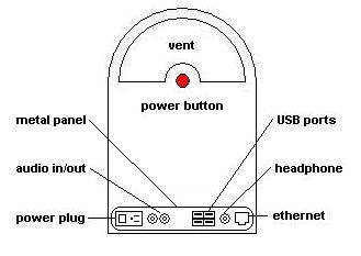

Couldn't I run the headphone jack from the jack on the speaker bar (or will having something plugged in there mute the speakers)?  I'm going to plan for the headphone jack but maybe I'll have to solve the problem at a later date or something...

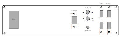

I've almost finalized the I/O panel that I'm thinking about.  If I can get it made it should look pretty nice.  We shall see...

I see... so you have the RCA connectors and speaker bar wired in parallel to the same audio port on the back of your motherboard and you switch between the two using the DPDT switch, correct?  If I wanted to wire them in parallel but without the switch I presume it would still work except when I plug it into an external receiver or something sound would still come out of the speaker bar as well as the RCA cables, right?
Also, how does this affect headphone use?  I think the headphones are a separate port on the back of the motherboard.  I guess the concern is that by installing the extender cable from frontx (linked in a previous post) it would somehow mute the audio out port (to the RCA ports and speaker bar) at all times?  Could I wire all three in parallel to the same audio out port on the motherboard?
I've attached a pic to show the two scenarios I'm considering.  In each one I could set up a switch to toggle between everything circled in red or leave the switch out and just have them all working at once, I guess.  Any thoughts?   :cheers:

Anyway, some more minor progress but hey at least it's something.  I'm a bit stuck until the laminate arrives but there are a few little things I can do in the meantime...
Before gluing the front panel to the shell I made the template for the marquee.  It wasn't too bad but it definitely didn't come out perfect - good thing it doesn't have to be.
I measured the opening behind the black Plexiglas the best I could and cut out the shape with my router and circle cutting jig. I had to do quite a bit of sanding to get it to fit properly which is why I said it's not perfect.
I added the pencil line after putting the template in place and tracing around the opening. This is the outline of the visible part of the artwork - the only concern is making sure that the artwork is lined up before installing it.

I am going to be using a Griffin PowerMate USB knob to control the volume on the jukebox (I know people have been having lots of problems from what I read).   I hope I can get it to work every time on bootup otherwise my wife will never use this thing.  I plan to mount it on the center of the front face in between the touchscreen and the marquee - shocker!
I am really only interested in the aluminum knob (and not the base where the blue LED is located) as well as the circuit board on the inside. As you can see from this picture, there is not much to the volume knob and it is actually quite small without the casing:
In order to remove the guts I had to kind of rip apart the knob and I'm going to have to solder a new USB cable to the 4 connector points on the circuit board. I've never soldered anything in my life but I guess I'll cross that bridge when I get to it.
The circuit board is going to fit in the hole I drilled out behind the Plexiglas (as shown in a previous post). I am going to have to drill out the Plexiglas a little more for the axle to fit through. In addition, in order to get the knob to lay properly I had to create a 1/8" spacer which I made out of some scrap black Plexiglas.
The first thing I did was find a spare washer that was slightly smaller than the diameter of the volume knob and glue it to some scrap Plexiglas (with the protective paper still on) using some contact cement. Next, I used a saw to cut the Plexiglas as close to the washer as I could and then I sanded it down with some 100 grit sandpaper until the Plexiglas was the same size as the washer.  I'm just following mountain's lead here.
Once I was finished sanding, I was able to remove the washer from the Plexiglas with a utility knife. The protective paper came right off. Before calling the spacer "finished" I had to drill a small hole for the volume knob's keyway to fit in otherwise the bottom of the spacer would not be able to lie flush with the top of the circuit board.
You can see why I had to drill the second hole in the next shot. It was easy to lay out following mountain's instructions - I put the spacer in place before drilling the second hole and then rubbed it back and forth against the keyway - then I just centered my drill bit where the scratch was made and the hole came out perfect.
The next step will be drilling out the Plexiglas on the front panel and using some acrylic glue to bond the spacer to the front. I am going to do a few other things in the mean time though - I need the front of the jukebox to remain flat in order to cut the t-molding slots (among other things). This is what is will look like once it is installed though:
As you can see in the final shot below, once the volume knob is in place, it will be raised by about 1/16" off of the Plexiglas on the front panel which will allow it to turn without rubbing. Perfect!
I don't know what I'm going to do if I can't get the powermate to operate properly.  Maybe the solution is to put the computer to sleep instead of turning it off when it isn't in use.  I really don't know.  The whole design is based on being able to use this knob.  I'm also a bit nervous that I left enough room for the circuit board and the monitor to sit in place properly.  It is a tight fit in there!

i can see you are still wearing the ring , so things are still at piece at home with the project  ;D
Was it not possible to extend the volume knob of the speaker set you intergrate into the juke? then you would not have the volume problem and no problem with the print circuit
  • Posts: 8001
Re: Someone call the cops! I stole a Jukebox!! [UPDATED OCT.17.08]
« Reply #195 on: October 18, 2008, 12:12:18 pm »
You know, I was wondering if that was a possibility.  I don't know much about wiring/electronics.  I'm still up in the air but I am committed to using the knob of the powermate and anything I end up using has to fit in the area I've cut out.
Things are good with this project - I think the wife has an actual interest in this one!
Martijn
  • Posts: 822
  • Akira!
    • ModMyBox
« Reply #196 on: October 18, 2008, 02:29:14 pm »
look @ my last update, its simpel to extend the knob
and 100% always working result..
and makes your design a little different then mountains  ;)
the knob of the powermate can be easy adjusted to fit it  :applaud:

Today I am trying to make the back panel and I laminated some 1/8" MDF.  What a pain.  I'm not sure how it is going to turn out (it's drying) but I have a few questions:
1.  Can I remove contact cement from the laminate?  I accidentally got some on the panel after glue-up.
2.  Will a flush cutting bit and my router make a clean edge?  When rough cutting the laminate it chipped apart like crazy (I was using a jigsaw though).
Spreading the glue was very difficult.  I tried using plastic and then a foam brush - I couldn't get it evenly spread out.  I'll know more tonight when I go to cut the panel to size with the router and jukebox shell as the template...  I'm REALLY not feeling good about laminating the curve/shell.   :-\
mountain
  • Posts: 1205
Re: Someone call the cops! I stole a Jukebox!! [Marquee Art - HELP WANTED!!]
« Reply #201 on: October 25, 2008, 02:04:24 pm »
To clean off the glue, use "Goof-Off". Goo Gone will not work because it doesn't have Xylene in it.
Use a roller to apply the glue. It will give you a more even spread of glue.
I always use a pair of tin snips to rough cut laminate. It is not as good as laminate shears, but it does work well.
The flush cutting bit is how cabinet makers do it. Trust me, I have worked with laminate alot. Go out and invest in a nice large metal file like this one.
You will need it to clean up the edges after routing. It will give the edges a nice smooth black finish.

So can I remove scratches from laminate?  My router base created a few lines in the back panel as I was routing it to size... I put some painter's tape on the base and that fixed the problem but not before I put a few scratches in the right side.  Otherwise it came out great - I might redo it if I have some more laminate after covering the sides/top but I won't know until I get there.

OK, a bit more progress... after about 3 months of working on the front panel off an on it was finally time to glue it to the shell. This took much longer than I thought it would since I had to remove some extra material around where the monitor opening was so that the monitor would be able to fit in there.
I placed the panel on top and then just used a pencil to outline where I needed to cut. You can see the pencil marks in the next two pictures. I wasn't too worried about making a nice straight line or the cleanest cut since it will all be hidden.
Once I had everything laid out I just used my jigsaw and router (freehand!) to cut as close to the line as possible. The one thing I definitely didn't want to do was cut through the side or something and ruin the shell!
Once the shell was cut properly, I carefully lined everything up and then actually tried installing the monitor. It was a good thing that I did. There were two metal brackets which did not affect the installation into the front panel (I didn't have to account for them) but they would definitely be in the way once the front panel was glued to the shell. I measured the brackets and removed a little bit more material.
Finally, using some wood glue, some clamps and a cinder block I attached the front panel to the shell and let it dry overnight. There's no turning back now!
Lining everything up was tricky. Since there was about 3(!) months between making the shell and cutting the front panel to actually gluing the front panel in place it didn't line up perfect. I think I am splitting hairs though because you can only notice when you rub your finger over the edge. The laminate should go on evenly though (I hope!).
Here are a couple of interior shots so you can see what a mess it is in there. In the bottom left hand corner of the second picture you can see the additional notch I had to cut for the monitor's mounting bracket. I'm really glad I checked before gluing!
Finally, here are some shots of the front panel glued to the shell. It's funny - this thing looks almost exactly like it did 2 months ago!
I picked up the laminate from Home Depot and I am planning to glue it to the top/sides this week/weekend.  In the mean time I am going to start setting up the computer and configuring the software.

I would sand that edge javeryh.  It may translate through the laminate or make it stick up at the edge.  I don't know if it will even be an issue but from what I know of you it'll bother you to no end.  Maybe mountian can chime in here on the issue as he works with laminate for a living.
TTFN
Kaytrim
mountain
  • Posts: 1205
Re: Someone call the cops! I stole a Jukebox!! [UPDATED 10.28.08!!]
« Reply #206 on: October 28, 2008, 11:26:59 am »
No, not for a living. I have worked with it a lot though. I used to build homebrew speaker enclosures back in the day plus my three projects listed on this site.
You definitely want the surface to be totally flat. I used a palm sander to remove any high spots including excess glue.
Thanks guys - I was debating whether to sand but now I definitely will.  I think I'll be OK even if there is a rough spot or two that doesn't line up *perfectly* (it's really really close now even before sanding) because the lip of the t-molding will cover the edge of the laminate even if it is raised a hair at the edge... I think.
Any tips for removing scratches in the laminate or do I need to make another back panel?  It was simple to make since I have a template but I might not have enough laminate left after I laminate the curved sides/top...  I might go with what I have for now and then if it annoys me as the project gets closer to completion I can order some more laminate and make another panel...   THe scratches aren't deep but they are long.  :banghead:
mountain
  • Posts: 1205
« Reply #208 on: October 28, 2008, 12:05:01 pm »
I would remake the panel. I imagine trying to buff the scratch out would make it glossy.
How much laminate did you buy? Seams like you should have plenty to spare unless to bought less than 1/2 sheet.
  • Posts: 8001
« Reply #209 on: October 28, 2008, 12:11:43 pm »
I bought a 1/2 sheet (2' x 8').  I need 57" for the curved panel (so ~60" to be safe) which leaves 3' for the back panel which I've already wasted about 18".  I need to measure everything out and try to get as close as possible so I don't waste anything else.  My fear is that I end up a couple of inches short...
You can see the scratch on the right in the pic (there are several more down the right side of the panel).
:banghead: :banghead: :banghead:

It sounds to me by reading your post that you may not have let the glue dry enough before joining the laminate to the wood. You don't need weights or straps, just pressure from a j-roller and you're done. I typically used my laminate bit immediately after gluing it down.
If you messed up the laminate, it can be fixed by removing the bad, cleaning off the glue and starting over. Hang in there Bud, you will chuckle about this later. You will also learn from it.

You said a mouthful there. As someone who's had to remove glue, I can tell you it's not a fun task. Is there a shortcut beyond friction, elbow grease and a palm sander?
Mountains right though. I didn't notice the glue drying/weights part of your post Javery. When I laminate, it's a quick process.
  • Apply glue to cut laminate piece and wood
  • Once ready, apply laminate to wood. Use J-roller.
  • Trim
That all happens in a span of 30minutes (sometimes more depending on the cure time of the glue). As soon as the 2 pieces touch each other... their stuck. What happened over there?

I guess I'm just really inexperienced with laminate.  I used a roller to apply the glue and it seemed to go on nice and even.  I thought I let it dry enough (30 minutes) - it was barely tacky to the touch.  I started on one end (not in the middle) and as I rolled the shell over the laminate stuck with no trouble so I thought I was OK.  I applied pressure as I went from the inside and then with the j roller from the outside once I made my way around.  After that, I noticed the laminate wanting to separate at the edges so I tipped the thing on its side, put an MDF panel on top and then 2 cinder blocks for pressure.  Everything looks OK right now but I'm afraid when I remove the cinder blocks it will want to spring back into place (away from the shell).  I'm going to let it dry until at least tomorrow night and then see where I'm at.  It is encouraging to know there may be a way to remove the laminate and try again.

javeryh,
Chances are that the surface is slightly bowed up in the center (from from to back) where the laminate appeared to be pulling up at the edges. On mine, I saw this a little in a few spots. I think it is from gluing the two 1/8" pieces together. The glue between these two 1/8" MDF pieces gets trapped towards the center creating a slight hump. The good news is that since you will be applying the t-molding in this area, it will hide it.
If I were you, I would wait until you install the t-molding to before you decide it was a failure. Chance are, if you are like me, you are being a little too anal. I am sure it will be fine.
Go grab a cold beer, always helps me in these situations.  :cheers:

I sure hope that is it.  I'm also really really hoping the t-molding hides the edge.  I definitely think you are right about the shell being a little deformed - the front and back templates I made do not line up at all.  They are off by as much as 1/16" in some spots even though the panels I used to initially form the shell were identical.  You obviously can't tell with the naked eye.
Tomorrow assuming the glue dries fully I'm going to route the laminate to final size, cut the slots and install the t-molding.

OK, I managed to finish the lamination process today (trimming it to size) and it dried pretty nice.  There is only one spot on the right side that separated from the shell.  I'm going to use a razor to get some glue in there and clamp it overnight.  I was quite relieved.
Unfortunately, during the trimming process I nicked the front panel with the flush bit.   :banghead: :banghead: :banghead:
I shaved off the protective paper and the thin layer of shiny on the Plexiglas - the scrape is about an inch long so I am definitely going to have to try and sand and polish that area and blend it in to the rest of the front panel.  It sucks.  I was being careful with the router but I guess I tipped it into the piece instead of away from it and I effed it up. If anyone has any other suggestions on a fix I'd love to hear it.  I'm going to start with the Novus 2 and work backwards to the Novus 3 and then 1500 grit sandpaper until I feel like it is blending in and then move forward from there until I finish it with the Novus 1... oh well, nothing I can do but try and fix it.  You can see it in the attached picture... which actually makes it look horribly bad.   :(
Tomorrow I'll route the slots for the t-molding and then it's just a matter of installing everything... easier said than done, I'm sure.
« Last Edit: November 02, 2008, 09:53:21 pm by javeryh »

« Reply #228 on: November 02, 2008, 09:57:58 pm »
That sucks. It happened on mine also, at the very bottom. I had to carefully cut the film off the entire width of the face about 1/4" up and polish it all. I figured it would blend better. I started with 600 grit, went to 1000, 1500, and then 2000 (wet) I finished it off with the Novus system and you can't even tell.
Why are you going to polish it out of sequence?

It's is a huge relief knowing that it can be fixed.  I haven't even been able to enjoy the Giants win since it's all I can think about.  This is definitely a learning experience.
I was going to sand and polish out of order because I don't want to go down too far grit-wise and scuff it up further unnecessarily - my thinking is that I'll hope the Novus 2 can polish it out and if not I''l try the Novus 3 and then the 1500 grit sandpaper, etc.  I don't know... maybe I'll just start at 600...

As regards to your I/O panel I'm picking up another copy of AutoCAD this afternoon so Ill get on it ASAP, It wont be today though as I need to work on Pinky whilst the GF is out. Ill definitely have it done in a day or two (your job too mountain if you are reading)

Thanks for the help with the I/O panel!  :cheers:

Looking at the pic, would it not be possible (if you can't remove the scratch) to bevel the external edge too? Then normal polishing procedure would apply.
I luckily don't have this issue as the front of mine is wood - and my dad keeps telling me that the odd ding or knock = character. I would be gutted if it was acrylic. Good luck  :cheers:
Thanks.  The more I think about it (which is all the time) I think I'll be able to fix it.  It is just a paper-thin scratch so not deep at all - the trick will be getting it to blend in with the surrounding area.  Hopefully when I'm finished I'll be the only one who notices.
As for beveling the edge, it is an interesting idea for sure but I only have 1/8" to work with if I went that route (the thickness of the acrylic) and the scratch is thicker than that.  I'm also hoping to cover some of it with the lip of the t-molding but that's probably wishful thinking on my part - at best I'm hoping to cover the thickness of the laminate with it.

- cables from frontx for the I/O panel
- power module from mouser for the I/O panel

OK here's a bit of an update not related to the acrylic - I figured how I am going to cover the speaker opening. I didn't take any specific set of speakers into consideration when I was laying out the front panel - I was more concerned with aesthetics and an overall uniform look.  I just thought I'd figure it out when I got that far....
I decided to use some speaker cloth (available at partsexpress) and some perforated aluminum (available at mcmastercarr - thanks mountain!) to hide the speaker. The aluminum should tie in nicely to the volume knob and the chrome t-molding I will be wrapping the edges of the case with.
The first thing I did was buy some 1/4" square dowels from Home Depot - I wanted 1/8" but this was the smallest they had. I used the dowels to make a frame slightly smaller than the area routed out behind the speaker opening.
I clamped the cut pieces for about an hour until the glue felt like it would hold.
Once that was finished I sprayed it black just to make sure it wouldn't show at all through the speaker cloth and perforated metal.
Next, I cut out a piece of perforated aluminum to cover the frame.
Finally, I cut out a piece of speaker cloth a bit oversized to wrap the frame. This was a bit tough to figure out but maybe I'm slow. I got some white Elmer's Glue and put a bead around the frame. Then I laid the frame on top of the cloth on a flat surface with a piece of saran wrap underneath so the glue wouldn't stick to the table.
After the glue dried I used a razor to remove the excess material around the edges and I ended up with something like this:
The final step is going to be securing everything behind the Plexiglas in the cabinet. I have a bit more to do before I'm ready to permanently install it but here are a few pictures of what it is going to look like:
I am pretty happy with how this part came out. This was kind of a pain to do - I was expecting it to be an hour tops but I had trouble cutting the perforated metal accurately (third time was a charm).

OK, I'm taking a break from this project for at least a week.  I tried cutting the slots for the t-molding tonight and my slot cutter broke in the middle of the cut.  All three tips came off and it took me a while to realize it.  The slot was two different thicknesses and I couldn't figure out why.  It also started smoking towards the end of the cut which I knew was bad since it usually cuts through like butter.  It feels like everything is going wrong this week and I've been so careful.
I think I need to get away from this thing for a few days before I mess anything else up so I'm on hold until the new slot cutter arrives at least.   :banghead: :banghead: :banghead: :banghead:

Did you have the slot cutter on the right way around? I've put mine on the wrong way before and it does (kinda) cut but it smokes too. I was only cutting plain MDF and mine didn't break but if you did have yours on the wrong way around I guess the toughness of the laminate may have caused the tips to come off.

I think I had it on the right way (I should know since I've done this a bunch) and it cut just fine on the test run through some scrap MDF when I was setting the depth.  The the three "wings" spin counterclockwise into what I am cutting.  It was a very old bit (4 years) and I store it in my garage which has some pretty wild temperature swings... maybe the bit had just had enough.  I ordered another one and it should be here soon.  At least all of this mess will get covered by the t-molding - the laminate chipped along the groove pretty good.
It has been a rough week with this project.  I'm trying to finish by Christmas just so I have an end date in mind to work towards.  Next week the wife and kids are going to be away so I'm hoping to get the majority of the thing finished then.
DaOld Man - I haven't really thought about securing the speaker bar in place yet but I do know it has an odd shape.  For the interior, I am planning on installing a shelf that will sit above the speaker bar.  The computer will be installed on this shelf and the speaker bar and case fan will be installed below this shelf (there will be a 120mm hole in the center of the shelf and the case fan mounted directly underneath blowing air upward).  The I/O extensions will also run from the motherboard above the shelf to the I/O panel below the shelf... if that makes any sense.  Basically, I am not going to be adding a "bottom panel" that will cover everything - I want there to be adequate ventilation underneath flowing up through the body and out the vent on top.
EDIT: I snapped a few pics of the router and t-molding on a piece of scrap MDF.  I only cut the slot around the back and I made the cut with the back panel secured in place (so the t-molding will cover it).

The Back Panel
The back panel of the jukebox will incorporate the following:
    * Power button (Vandal)
    * Ventilation
    * 4 USB ports
    * Power cord for power supply
    * Ethernet port (for going online)
    * Headphone jack
    * Audio out ports (for connecting to home theater)
The trickiest part about this panel is that it has to be removable... or at least I need to be able to access the inside for maintenance. I do not want there to be any visible screws on the back panel so I am planning on using some rare earth magnets to hold the panel in place.
The panel is made out of 1/8" hardboard and covered with Formica laminate. The back panel cannot be any thicker than this or else I will not be able to add t-molding around the top edge while still allowing for the panel to be removed. The layout will mirror the front panel with the power button going where the volume knob is and the vent being where the marquee is. This should give you an idea of how it will look (not even close to scale):
Franco graciously agreed to layout the I/O panel in CAD and I'm really hoping I can have it laser cut out of some 1mm thick metal.  This is what I've come up with (again, not to scale):
The ports on the motherboard are going to be extended to these holes using some cables from frontx.com.
I will start explaining the construction in the next post.

Now that I had a good idea of what I want the back panel to look like, it was time to start construction. I picked up the laminate from Home Depot (Formica brand) and was happy to see it rolled up in a tube. It shouldn't be a problem to laminate the curved panel! Check it out:
The first thing I did was trace the back of the jukebox shell on to some 1/8" thick MDF and cut out the rough shape. Then, using the rough shape as a template I traced it out on to the laminate and cut it out. Initially, I used my jigsaw and it was a mistake - it chipped the laminate like crazy - I probably should have tried scoring it with a utility knife or using some tin snips or something else. After cutting it out I wasn't sure if I left enough overhang around the edges because it was so badly chipped.
Here are the rough panels I cut (MDF and laminate):
I applied a thin coat of contact cement to the MDF and the back of the laminate panel, waited 30 minutes for the glue to dry and then bonded the two surfaces together.
I actually let this cure over night underneath a 3/4" MDF panel and a cinder block.
You can see how imprecise and rough everything is. I also got some contact cement on the good side of the laminate and I was a little worried about getting it off.
What a mess!!! You can see the chipped laminate, the spilled glue and even the permanent marker I used to trace out the shape! Is this going to work out?

More progress! After getting the 1/8" MDF laminated and rough cut to size I didn't think there was any way that it would turn out nice considering it was chipped and there was glue everywhere. The next step was cutting the panel to its proper size with my router and flush cutting bit.
First, I put some double sided tape around the perimeter of the jukebox shell:
Then, I carefully placed the rough panel on top of the tape making sure that when the overhanging material was removed that there wouldn't be any chip marks showing. The clamps were for added support although they definitely weren't needed - the double stick tape is pretty strong:
Next, I just went around the outside with the router and ended up with the exact shape I wanted! After I had the proper shape, I used a template I had made way back in the beginning of the project for the front panel to cut out the opening for the vent on the top of the back panel (I used double stick tape again). It was easy - the router cuts through the laminate like butter!
You can still see the glob of glue on top that would have to be removed. After that was finished the last thing I did for the night was drill out the hole for the power button in the center of the small semi-circle. I used my step drill bit and widened the hole to 3/4" diameter.
The button looks great and should match the other aluminum accents on the jukebox (speaker grill, t-molding, etc.). Oh, yeah - I was able to remove the glue using my fingers quite easily. I just rubbed it until it came off from the friction. Check it out (don't mind the dust):
I still need to cut the hole for the I/O panel along the bottom which will mirror the speaker grill on the front panel and install the washers for the magnets on the inside so the panel will stay in place but remain removable in case I need to get in there for maintenance.
More later!   :cheers:

I'm totally unmotivated right now.  I'm still pissed about the scratch.  It is up and running though.  Here's a shot of the guts being put together.  I'll get around to an update one of these days...

Forget that darn scratch javeryh.  It is on the back and it will not be seen.  I haven't started yet and I'll end up beating you to the finish line.
I wish it was on the back!  It is on the top of the front panel and is going to require some serious sandpaper kung-fu to blend that area into the rest of the black plexi.

Then let me put it this way.  Over time there will be more scratches I can almost guarantee it.  btw This is why I am going with veneer. ;D

Hey, is there anyway you can cover the scratch? Like maybe some edge trim?
Or cut another piece of trim laminate to go around the perimeter?
That would be pretty cool, if you havent cut your T-molding slot yet.
It would be like a frame around the face of the juke.

The scratch pic isn't showing for me, so I can't see how bad it is but I'm sure you'll work something out. The laminated pieces look great, don't lose motivation!!
edited as I think I am being stupid, but I still can't find a pic with a scratch
Thanks!  I've been ripping my CD collection over the past few weeks (I'm up to the letter "e" - at the pace I'm going it will take months before I rip them all!).  I'm also trying to sort out a few things I need to finish that are out of my hands.
Check out pic #227 for the horrible horrible scratch.   :'(

Computer Installation
The first thing I did was build a "shelf" above where the speaker bar will go as a starting point for the installation. The plan was to cut a 120mm hole in the middle and mount a computer fan underneath to push air up through the shell and eventually out the vent on top of the back panel. I also wanted to build a vertical shelf to mount the motherboard and hard drive to which will straddle the fan (exactly like mountain did).
This is the vertical shelf - really simple. It is made up of three MDF panels and I cut a semicircle cut out of the bottom:
The next thing I did was install the monitor in place. I used a few screws to secure it to the frame. Space was VERY tight here and I noticed the MDF pulling apart where the screws are so I added a few extra screws for added support (more than shown in the picture).  I also have to keep in mind that I'll be removing everything when it comes time to work on the volume knob.  For now I just wanted to be sure everything fits.
Also, before attaching the monitor, I installed the black weatherstripping around the monitor opening. This was tricky and ultimately didn't come out as precise as I wanted it to but it is barely noticeable. If I ever build something like this again I'm definitely going to use 1/4" Plexiglas for the front panel so I can route out the channel for the transducer wedge and everything will sit nice and flush. No big deal but since I'm mostly building this on the fly there are a few things I would do differently next time...
The shelf is secured to two 3/4" dowels I glued to the inside of the shell. The vertical shelf will be positioned directly above the fan so the hard drive and motherboard will remain cool while the jukebox is on. Everything else I cram in there will be based off of the placement of these major components.
More later.

    * drill out plexiglass in volume knob area
    * bond spacer to front panel and install knob

I also need to finalize my I/O panel and get someone to cut it for me out of 1mm aluminum or something silver to match the grills and t-molding.

Does anyone know if I can bond metal to MDF?  I bought some magnets to attach the back panel but the only way to attach the round catches is to use glue (it is 1/16" so way too thin to screw into).  Will this work or will this fail over time (asuming I remove the back panel to work on the guts from time to time)?

Good to see you back at it buddy.  I would suggest using epoxy to glue the catches.  Take a file and score some groves into the back of the catches to give a tooth for the epoxy to grab onto.

Thanks Michael - that's a good idea about scuffing the back of the catches.  I did a little measuring and they are exactly 1/16" thick which is the same thickness of the back panel (which is then covered in 1mm laminate).  I'm now thinking I could use a razor or something and pick at the back panel and get it down to the laminate and install the catches flush.  This would eliminate the 10 catches sticking up on the inside of the back panel and I'd be bonding the metal catch to the plastic laminate... I don't know.  I'm overthinking it for sure.

i also got the back removable without bolts or screws
i placed the backside in the correct position, the mdf back moves into the laminate of the outside and i removed the t-molding mid section material and just glued it onto the side and held it down with stickytape
now i can just pull out the back and insert it again without screwing and its very tight

I used my sheet of mdf as a table and I noticed some bending in the center.
I would turn it over a day or two before cutting a new piece out.
The stuff does bend when pressure is applied to the sides.
But if you stand the sheet on one edge, it doesnt seem to bend. (The strength is in the edge run, same as a 2 X 4).

Well, I shouldn't have opened my mouth.  The laminated back panel that I made ages ago has now warped (probably due to temperature changes).  I don't have any laminate leftover to make another one so I'm just trying to flatten it out.  Hopefully the 10 rare earth magnets that I am planning to use to secure it in place will work, otherwise I'll just have to screw it in place.
Anyway, tomorrow (for the first time since November) I'll be without the wife and kids for the morning into the early afternoon so I hope to get the majority of the remaining work completed on this thing...

More progress... I've done quite a bit but I don't know how much time I'll have today to organize my thoughts and pictures - here's some kind of old news:
After installing the monitor and shelf in place, I made sure to get the computer up and running before putting the rest of the components inside.
After that was finished (and I played around for a while), the next step was making sure the motherboard and power supply fit properly. I placed the motherboard on one side (using PCB feet) and the hard drive on the other (using velcro) and tried installing the vertical shelf.
I was worried initially that since the ports were facing down and the whole thing was off-center that the fan underneath wouldn't keep things cool but boy was I wrong. After leaving it on for at least 6 hours it was cool as the other side of the pillow in there.
Here is the power supply in place:
More later!
  • Posts: 8001
After getting the motherboard and power supply in place, the rest of the components just kind of worked themselves out. This is just a test run (since at this point I still had to cut the hole for the volume knob) but I will use some velcro to secure the speakers in place behind the speaker grill and I wired the power button to the pins on the motherboard (temporarily since it will ultimately be installed in the back panel).
This is a shot of the speaker bar in place from the bottom. You can get a good look here at the support for the shelf as well as the computer fan mounted underneath.

There will be plenty of time for beer when the power tools are put away!  I FINALLY cut the hole for the volume knob and got everything installed.
I used a step drill bit and cut out a 7/8" hole where the volume knob goes. All that I had to do was drill a hole big enough so the guts of the knob would fit through but I had to be sure it was smaller than the spacer I created. I also had to worry about the knob being dead center (which is harder than it sounds) because this would be the focal point of the entire juke.
Here is a shot of the hole completely drilled out:
After drilling out the hole I had to use a file to remove a little more material to get the guts of the knob to fit properly - ideally my step drill bit would have been able to cut a 1" hole but oh well. The next step was to put the spacer in place and trace it with a pencil so I would know how much of the protective paper I could remove. Once that was done, I used a two part epoxy for plastic to bond the spacer to the front panel.
The epoxy I used set in 6 minutes (less actually) and I was able to remove the clamp fairly quick and install everything. here are some shots without the knob in place:
This is what it looks like with the knob installed.
This last shot I tried to get head on so you could see how I managed to get the knob dead center but the flash was messing everything up. Oh well.
I can't wait to remove the brown protective paper but you should be able to tell what it will look like when I finally do.

Looking real good. Another way to do it would be to use a forstner bit from the back side using the original pilot hole as a guide. Then, I whip out the router and flush trim bit to cut the accrylic from the front.
I have an idea what it may look like  :cheers:
  • Posts: 8001
I thought of that but the original hole in the MDF was the same size as the spacer so I wasn't able to use it as a guide with the router - of course I had to do it the hard way - I ended up stacking three 3/4" sheets of MDF to drill through for the step bit.  I had to stop every time I went to a new diameter to vacuum out the dust and scrap - it took forever!
I forgot to mention a huge thanks to you Mike for soldering the volume knob for me.  I am not sure how to get it working though - I plugged it to the USB pins on my motherboard (assuming that the red wire was for the +5V (does it matter?).  The computer didn't recognize that a USB device had been plugged in (it typically makes a noise when I plug in a mouse or external hard drive or whatever).  Is there something I need to activate to get the motherboard to recognize it?  I haven't installed the Griffin drivers yet (that hopefully would take care of it) but I thought the computer would at least tell me something was plugged in.
Oh yeah, there are lots of people here who can tell what it looks like - we are building an army!  :cheers:

why do you people make a spacer? i just drilled a hole the size of the pin+screw part to go throught the plexi and placed the bolt on it
i think you soldered wrong because it should  be detected
make a pic of the soldering then i can compare
  • Posts: 8001
The spacer allows the knob to sit about 1/32" off of the front panel.  Without it the knob would press too hard against the front (I think).
I doubt the soldering is wrong - mountain did it himself.  I'm sure I'm not installing it properly or maybe the drivers need to be installed to be recognized.  I'm going to get it working over the weekend.  I'll snap a few pics.

This next part is kind of tricky and I don't even know if it worked yet. I wanted to connect the back panel to the jukebox shell without any visible screws. I'm not even exactly sure why since screws would have made everything much easier. Anyway, I ordered some rare earth magnets from Rockler. They are strong!
I measured around the outside frame of the back of the jukebox shell and laid out 10 points where I would install magnets. Here is a shot sort of showing how I laid them out:
Here's a close-up of the magnet casing:
I needed to use a 1/2" forstner bit and drill down to precisely the depth of the magnets in order to make them flush. Easier said than done - once you put the magnet in place there is virtually no way to remove it. I ended up drilling down a little too far in some spots - hopefully the magnets will be strong enough anyway.
Each magnet cup (holder?) has a hole in the bottom so it can be screwed into place.
Here is what one of them looks like:
Here is what all of them look like when put in place:
Finally, I put the magnets in there. I cannot get them out so there is no turning back now.
The magnets are a cool idea (at least I think so) but I just hope they end up working like I think they will. It should be easy to remove the back panel by tipping the jukebox forward and going up from underneath assuming the panel locks into place. We shall see...

What kind of material are you using around the monitor opening? I assume this is to close the 1/8" gap between the monitor and the plexi?
  • Posts: 8001
Re: Someone call the cops! I stole a Jukebox!! MAGNETS??? [03.05.2009]
« Reply #312 on: March 05, 2009, 04:55:57 pm »
Black foam weatherstripping.  The pics show the protective paper still on the back.  It's not a *perfect* solution since I'm so anal but it does the job I guess.  If I had to do this all over again I would make the front out of 1/4" acrylic and then route a 1/8" channel for the wires on the front of the monitor so everything would be nice and flush.

« Reply #313 on: March 06, 2009, 02:20:55 am »
i also tried this weatherstripping but the touchscreen part became unstable
  • Posts: 5202
  • Last login:Yesterday at 08:45:33 pm
« Reply #314 on: March 06, 2009, 07:01:23 am »
Your right marti..
The foam weatherstripping on my juke has made the lower right corner of the screen unstable. For some reason the foam in that area appears to have grown, it is much tighter against the screen in that corner than elsewhere. Or maybe the plastic front has warped??
You have to "touch" that part pretty hard to get a response.
I plan to fix that by shimming the monitor a little farther away from the front.
If I could only find the time.

Interesting idea with 1/4" plexi. Keep in mind, 45 degree bevel would be around 0.7" long on a 1/4".  I thought about it, but will probably stick with 1/8" especially since it is already ordered and received. Perhaps foam is not the best material. If not for anything else, I would expect it to change thickness with age and humidity variation.  Anybody has a close up of how the gap between the mon and the plexi looks? Regards.
  • Posts: 8001
« Reply #316 on: March 06, 2009, 09:00:03 am »
Edit: BTW james, great work !!!
I wouldn't do a full bevel.  I didn't even do one on the 1/8" plexi I used.  It looks more like this"
if that makes any sense.  Also, the foam I'm using does not appear to have moved in the 4 months since I installed it nor does it have any effect (as far as I can tell) on the usability of the touch screen.  I'd love to hear some other ideas though...
I do have a tough time getting touching the edge of the screen all the way around but that is due to the thickness of my finger and not any malfunction.   :cheers:

I posted a nice illustration from ELO a while back, here. It gives a good visual of the many ways to approach the problem of the transducers.
Jav,
Not sure what's up with the Powermate. These thing are a little flakey. I think the key to getting a good one is to buy the original (rev. 1?) My Dad's juke has not had one issue with the Powermate. I know Knievel used one on his Metal Station and reported that he never had any issues either. Weird. I would be more than happy to look at it again if you like.

I'm going to play with the Powermate this weekend - if I have any troubles I'll let you know.  I've honestly only spent 10 minutes with it (I just tried plugging it in and when it didn't get recognized by the computer I moved on to something else).  Worst case scenario is I'll actually buy one from the manufacturer instead of eBay so I know what I'm getting.
What I am going to definitely need help with is wiring the power.  I have three plugs (as shown in the attached picture) that I want to wire to this thing:
Is it as simple as splicing all of the wires together or do I need to worry about voltage and other issues?  The power brick can be disconnected from the Dell speaker bar (as you know) but I'm guessing I still have to crack the brick open like you did.  Is this doable for someone who has very little experience with this stuff?  Any help would be great.   :cheers:
reko19
  • Posts: 220
  • Last login:September 21, 2026, 07:47:22 am
« Reply #320 on: March 06, 2009, 10:04:14 am »
in US wiring is color coded: white is neutral, black is phase (hot), green is ground. On the cord there are two flat prongs one is larger and one is smaller and a semi-round prong. Cut the plug off the cord, note which wire is connected to which prong.  Larger flat prong is neutral, smaller is phase, semi-round is ground. Connect accordingly to your power entry module. When the switch is off you want the hot wire to be interrupted, this is why it is important to notice how it is connected before cutting it off. Hope this helps.
« Last Edit: March 06, 2009, 10:24:12 am by reko19 »
  • Posts: 8001
« Reply #321 on: March 06, 2009, 10:43:45 am »
Excellent.  Thanks.  Do I need to worry about voltage or anything or does splicing everything together have the same effect as using a power strip or plugging multiple plugs into one outlet?
Also, is twisting the wires and covering with electrical tape OK or is there a more secure solution that I should try?
reko19
  • Posts: 220
« Reply #322 on: March 06, 2009, 10:53:11 am »
pretty much same effect as using a plug strip. I would recommend using a wirenut or a terminal block for splicing
  • Posts: 8001
« Reply #323 on: March 06, 2009, 11:35:48 am »
OK another good idea.  I will use a terminal block assuming I can get one from Home Depot.  Can I wire all three devices to the same screws on one side (like wiring 2 buttons to the same place on an iPac)?  I assume so since I don't see how it would work otherwise...
Thanks!   :cheers:

one for line, one for neutral, possibly one for ground

The next thing I had to do was attach the metal to the inside of the back panel for the magnets to catch on to. This was fairly easy - I laid out corresponding holes to the magnets I installed on the back of the jukebox shell and then used my plunge router to remove some material in the back panel so the metal catches could sit flush. Then I used some two-part epoxy to glue the metal catches in place.
This is what it looked like all clamped up:
I still haven't tested it yet to see if the panel stays in place like I'm hoping but I will this weekend.  I've been working like CRAZY for about 2 months straight (I'm posting from work).  I really want to finish this thing...
More later.

Here's an updated "punch list" for this project:
Front Panel:
    * polish out scratch (I'm saving this for last)
Back Panel:
    * Cut hole for I/O panel on bottom
    * Laminate inside of panel to try and fix warping
Case:
    * block out marquee area with black posterboard or matteboard so light won't escape
    * figure out volume knob (I'll probably order a new one directly from Griffin)
I/O Panel:
    * Finalize design
    * Cut I/O Panel out of 1mm thick metal
Computer:
    * rip all CDs to hard drive (I'm up to the Ls with 407 CDs ripped)
    * tag all music using mp3tag (I'm up to the Ls)
    * normalize volume across all files
    * install freebox or xlobby (I wish they had iPod Touch software available for the computer)
    * wire computer, speakers and monitor to external plug (will need help)
Marquee:
    * send file to mamemarquees.com to print
    * cut to final size and install
That's about it - not much but a lot of little things.  I'm also going to install a few touchscreen games.  I attached a pic of one up and running to motivate me...

Javeryh, you used the 1/8" hard board for the frame: since my local lumber store doesn't have the 1/8" MDF, I'm considering using the 1/8" hardboard as well. How did you find the bending/shaping process? Was there any special technique to getting the hardboard to bend without breaking? It didn't seem that flexible when I was playing with it at the store.
  • Posts: 8001
« Reply #329 on: June 18, 2009, 10:38:16 am »
It actually bent no problem.  I had similar concerns in the store but when I got home and clamped it up (without glue) everything held in place real nice.  I went overboard on clamps though:
I started at one end and then worked the clamps around the frame.  I also used two band clamps in the middle during the glue-up but I'm not convinced they really did anything...   :cheers:

I wouldn't stress to much about the scratch in the plexi glass, it polishes up easier than you think it does, it just takes some time and patience. I have shaved the lenses on half the cars I have owned and I always start by removing the raised lettering with 80 grit sandpaper... which as you can imagine puts some serious scratches in the plastic. I generally start polishing with the wet and dry 1500 grit sandpaper (depending on how deep the scratches are) The trick (and I can't stress this enough) is to use plenty of water, keeping the plastic and sandpaper wet at all times and just keep sanding with the 1500 grit wet and dry paper. I usually just sand under running water at the kitchen sink. It takes some doing (a few hours sometimes). I always finish things off by applying some 3M scratch remover compound (instead of the nuvous only because its available almost anywhere) Using this method I have restored the finish on everything from Ipod's (taken apart so as not to soak them in the sink) to sunglasses.  It's not bad at all, once you get the hang of it, its quite easy really. Oh and your jukebox is looking really good!
http://www.shop3m.com/60455033070.html?utm_term=3m+scratch+remover&WT.medium=cpc&utm_campaign=1272&WT.term=3m+scratch+remover&utm_content=504593139&utm_source=google&WT.mc_id=shop3m-ppc-google-1272-Cleaners&WT.campaign=1272&utm_medium=cpc&WT.content=text&WT.source=google&cshift_ck=1323092386cs504593139&WT.srch=1

I looked through all the pictures and read the whole thread, and I couldn't find the scratch he was talking about, so I figured it was builder's anguish. I am fully expecting this project to come out as kick ass as Bella's Arcade; that one is still bookmarked as one of my favorite all time projects.
