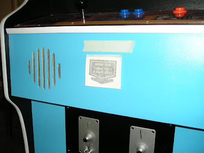

Finally - the moment everyone has been waiting for is here - LOL. I applied the coin door decal to the front of the control panel!! Before attempting this, I bought a plastic squeegee off of eBay for $3 (search "vinyl squeegee") - this really helps in applying the decals and it eliminates any air bubbles.
The first thing I did was put a piece of masking tape in the center of the panel. The tape lets me draw on the cab lightly with a pencil without leaving a mark. It makes it really easy to line up the decal. The decal is centered and the top edge of the decal is 2-1/4" from the top of the panel.

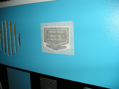

Next, I peeled the back of the decal off just a little along the top to expose the sticky surface and cut the back off with some scissors. This allowed me to line up the decal and stick the top down. Then using the vinyl squeegee from top to bottom while removing the rest of the paper backing I pressed the decal into place.

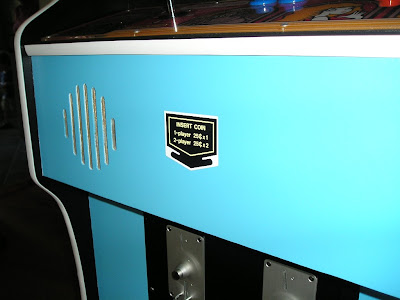

Looking good - all that's left is to peel away the top layer of paper. Man, you should have seen the smile on my face as I was peeling this off.
It looks pretty sweet! Next up will be the side art - same process just on a much larger scale and way more nerve-wracking!   :cheers:

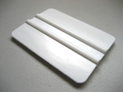

Then, very carefully and using my vinyl squeegee, I applied pressure to the top portion of the decal where I removed the paper backing. No turning back now! The decal is in place!

Thanks!  I do have the decal for the bar above the CP.  I haven't put it on yet because I think I want to laminate the bar with some of the black ABS plastic.  I put 4 coats of black paint on the bar but the wood grain still shows through and it looks pretty bad.  I probably should have used bondo on it to seal it in but at that point it was too late and I didn't want to make a mess.  I've got about an afternoon's worth of stuff left to do and that's on the list.   :cheers:

OK, time for some good pics!  Here are some shots of the cab with the side art and bezel installed.  It's about 95% finished.  The only thing left cosmetically is the decal above the CP on the black bar otherwise what you see is what you get.  I still have to post pics of the insides which I'll get around to later.
