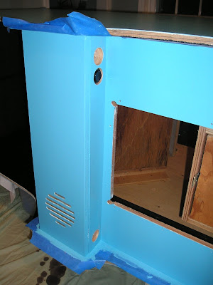

OK, here's a real shot of the control panel.  I've got a TON of construction pics which I'll start posting soon.
More later.   :cheers:

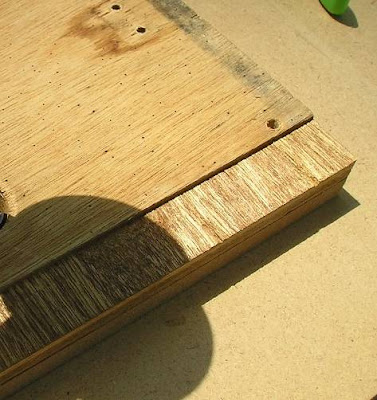

I had to sand the laminate into oblivion - there was no repairing it.  The pictures actually make it look way better than it was when I got it.  There were dings and dents all over the place and sections where the laminate was chipping.
I mean the actual layers in the plywood are coming apart around the edges in my cabinet. I think some wood glue and clamps could fix it though.
As for the 2 monitors, I would have liked to have seen that too.  There were 6 mounting bracket holes on each side of the cabinet and I can only guess they were from the original vertical monitor  and then the two horizontal monitors for the Vs. configuration.
Vs. machines only had one monitor, except for the "Vs. DualSystems"; but those had a separate control panel for each monitor; like two machines melded into one. Maybe it was set up for Playchoice? It would have been interesting to see Punch-Out, Super Punch-Out or Arm Wresting running on such a machine too.
I'm still amazed that someone managed to fit two monitors into a classic Nintendo cabinet. Even the taller Punch-Out machines which were designed for two monitors; are a tight fit for the monitors.
Hmmm.... maybe I am wrong then.  It was just a guess based on all of the monitor support holes in the side of the cabinet and the Nintendo Vs. side art.  Maybe it was converted into something else in between the DK and the Vs.?

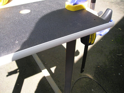

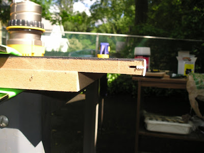

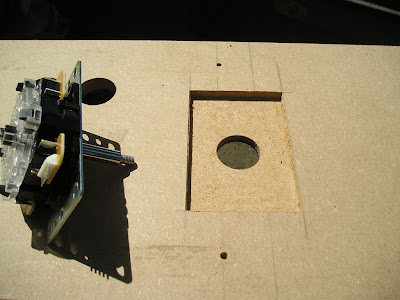

Making the control panel should have been very very easy but of course, the old control panel was made out of 9/16" plywood which Home Depot doesn't carry.  In order to get the required 9/16" thickness I decided to use 1/2" MDF as the base and then laminate the top with 1/16" black ABS plastic.
The first thing I did was trace the outer shape of the control panel onto the sheet of MDF.  Then I cut it out with the jigsaw leaving about 1/8" around the edges.
After that was finished I used some double sided tape to secure the old control panel to the MDF and then cut the exact shape out using my router and a pattern cutting bit.
Next up - laminating the MDF panel I just cut out, mounting the joystick and a bunch of other fun stuff!

Next, I had to lay out the button locations and the holes for the control panel bolts which hold down the plastic control panel overlay. This part was simple. Using the old control panel as a guide, I placed a 1-1/8" Forstner bit in each hole and gave it a light tap with my rubber mallet to mark the center point of each button and the joystick hole.
Then, I used my drill to bore out the holes I just marked.
Once that was finished I installed the buttons I ordered in the holes I just drilled with the control panel overlay in place. I wanted to make sure the art would line up with the button holes and...
... this allowed me to layout the holes for the 8 control panel bolts that will secure the plastic overlay in place.
Finally, I removed the plastic overlay from the MDF and drilled out all the holes I just marked.

Next up was the lamination process.  As I mentioned earlier, the original Donkey Kong control panel is 9/16" thick to accommodate the t-molding which goes on the front edge.  In order to get this thickness I decided to use a 1/2" piece of MDF and laminate it with a 1/16" piece of ABS plastic. This stuff is available in lots of different places (eBay and Amazon have it) and isn't too expensive.
The first thing I did was cut out a piece of the ABS plastic about 1/2" oversized all the way around:
I used my trusty contact cement to bond the plastic to the MDF:
I used a foam brush to apply the contact cement to both mating surfaces. I probably went a little overboard but it didn't make a difference - the MDF is porous so I wanted to be sure I had enough on there.
After waiting 20 minutes for the glue to dry I placed a scrap piece of MDF on top and used a cinder block to apply pressure in order to achieve a tight bond.
It worked! After about 10 more minutes I used my router (with the pattern bit again) to trim the ABS plastic flush with the panel. You can see what a clean job the router does - it came out perfect.
The next thing I had to do was trim around the button holes. I used a drill and a step bit to start and then when the hole was big enough I stuck the pattern bit in there and flush trimmed the button holes just like I did around the outside.
After that was finished I used my drill bit to drill out the 8 holes in the ABS plastic for the control panel overlay.
We are almost there. Next up is routing the recess in the back for the joystick and routing the groove for the front latch to rest in.

Almost there with the CP - the next thing I did was line up the joystick in the hole I had cut out. I just eyeballed it but I have a good eye and it looks like I got it dead-center. To help out with the process I installed the control panel overlay and sandwiched the joystick dustwasher in between the MDF/ABS panel and the overlay. All I had to do was center the dustwasher hole in the overlay.
Once it was lined up I flipped everything over, made sure the joystick was square to the panel and then traced it with a pencil. Then, using my router set to a 1/4" depth I freehanded out the rectangle I just drew.
Not bad, eh? It will take some fine tuning with the 4 corner bolts in order to secure it and make sure it is perfectly centered in the plastic control panel overlay.  Oh yeah, I'm using a Sanwa JLF in 4-way mode instead of the Nintendo original - I just like the feel.
More later.
jmike
  • Posts: 1018
Re: javeryh's Donkey Kong +
« Reply #43 on: July 30, 2009, 08:32:00 am »
That's looks great! Can't wait to see how it turns out. Please keep the pics coming.
The joystick dust washer you sandwiched between the overlay and MDF, was this how the original DK was or is it just a personal choice? If I had artwork on my CP, I guess I wouldn't want to cover it up with a washer.

Thanks!  I put the dustwasher in between the overlay and the MDF just to center the joystick in the panel.  As of right now it is on top of the overlay (but I think the originals had it under the panel).  I'm not sure what I'm going to do yet (although I'm leaning towards leaving it on top).   :cheers:

The next thing I did was route out some material on the bottom of the control panel in two places. First I cut the groove/slot for the metal plate/catch thing to sit in so the control panel can lie flush when installed.
It was pretty easy to do. I used a 1/4" straight cutting bit with my plunge router positioned against a straight edge. I marked off the end points and made the cut in two passes.
Here is the finished groove:
And this is what the setup looked like with the straight edge for the router to run along:
To set it up perfectly I just lowered the router to zero level and lined up the edge of the bit with my layout line. Then I just played with the straight edge and the clamps until I could run the router bit exactly along the layout line. Then I adjusted the depth of the bit and made the cut in one fairly smooth motion.
Second, I removed the material along the back edge so the control panel would fit in the cabinet properly. For whatever reason, the cabinet was designed so the back edge of the control panel sits in between the block of wood where the instruction card will eventually go and the control panel supports on the sides. I have no idea why they couldn't make this "slot" 9/16" and then not require the back edge of the control panel to be cut.
No big deal though. I set up the straight edge and router exactly the same way as when I cut the groove and just slowly removed the material working back towards the straight edge. I don't have any pictures of this part but here is the back edge of the original control panel so you can see what I'm talking about:
Next up - cutting the t-molding slot and installing everything.

Alright - more progress...
The next thing I did was route the slot for the t-molding. There is no magic here - I just used my router and 1/16" slot cutting bit.  The slot is actually a little small but the t-molding fit in there nice and tight.
Here is a side profile of the t-molding as installed:
And here is what the finished edge looks like:
It looks nice!    :cheers:

One of the last things I had to do regarding construction was drill the holes to mount the joystick. This was a bit tricky since I was only leaving about 3/8" of material to screw into. This joystick needs to be secure because I imagine it will take a lot of abuse over the years. I was in the local Home Depot looking for a solution and I came across these:
They are perfect. There is a post that gets installed from the top and then the screw fits into the post from underneath. It makes things very secure. The only problem was getting the head of the post to be flush with the top of my control panel.
I eyeballed the placement of the stick, marked out the holes with a pencil and drilled them out. Next, I used some masking tape to cover each hole:
Then I placed the post in the hole (through the tape) and used a razor to trace the top and score the ABS plastic. The idea was to leave a circle made out of masking tape so I would know where to cut with the router but it didn't work as well as I had hoped. The bit caught onto the tape and removed it so all I had to go by was the score marks left by the razor. I'm sure a permanent marker or something could have done the job but oh well. Then I just used my 1/4" straight bit and my router set at the depth of the thickness of the head of the post and carefully removed enough ABS plastic so the head of the post would be flush. Like this:
Any imperfections here are hidden by the plastic control panel overlay. It worked great and the joystick is VERY secure.

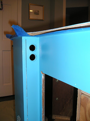

OK, next up - how I got the exterior looking all pretty and stuff...
Bondo is awesome.  First, I laid the cab down on its side to make it easier to work on. I sanded the entire surface using 100 grit sandpaper just to rough it up so the bondo would have something to stick to. Then I started patching the holes and dings. I had to work fast because after mixing the hardener there's only about 4-5 minutes before it sets.
Here are a couple of close-ups so you can see how sloppy I was. The edges were a mess in some spots but it all just sanded smooth and (hopefully) no one will ever know.
If anyone is interested, I used this type of bondo (there are several different brands/types to choose from):
It was easy enough to work with - the real challenge in making it look nice was in the sanding and painting.
  • Posts: 7996
  • Last login:March 05, 2026, 12:10:15 pm
« Reply #82 on: August 03, 2009, 10:15:00 am »
After sanding all of that bondo nice and smooth I enlisted the help of my daughter who has really taken an interest in arcade machines (I think she just likes hanging out with her dad).  She inspected the sides and noticed several imperfections by running her fingers over the surface which she circled with a pencil (thanks Bella!). Then I applied some additional bondo in those spots and sanded everything smooth again.
As you can see in some of the pictures there were several spots along the back edge that needed to be filled in so I clamped a piece of scrap wood behind the panel in order to apply the bondo. Before applying the bondo I wrapped the scrap wood (which was actually fireplace kindling) in plastic so the bondo wouldn't stick to it.
It worked great - I'm not sure how strong it will be but I don't envision that area taking a beating or anything so I think I'll be OK. The tricky part was getting a nice clean edge along the back.
Getting closer...   :cheers:

Next up was applying the powder blue paint on the sides and front of the cabinet. The goal here was to apply several thin coats in order to achieve as flat of a finish as possible. The smoother the finish, the nicer it looks and the better chance I have of actually putting this thing somewhere in my house.
I went to Sherwin-Williams to get some high quality paint and I think I got some good stuff. You can get the formula off of the picture.
I was going to get an oil-based product but due to environmental laws in my area they could only sell me a quart and on top of that they didn't have the right base for the color codes I had so I ended up going with latex. The guy assured me that it was their flagship product and it would dry nice and even (which it did).
  • Posts: 7996
« Reply #90 on: August 04, 2009, 09:54:03 am »
And here are some decent shots of what the cabinet looks like after applying two coats of the powder blue paint.
It's funny how the color looks different depending on the lighting but it all looks real even in person. Hopefully the sideart will go on nice and smooth - I'm nervous just thinking about it.

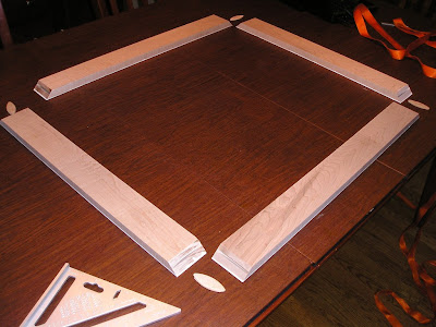

OK, I'm getting behind with updating this thread with pics and junk.  Next up was recreating the base of the cabinet (the first post in this thread is finally revealed!!!).
First off, I have to say that I'm an idiot.  When I measured the base I didn't account for the overlap from the side panels so it is actually an inch taller than I thought.  Initially I made the base out of a 1" x 3" piece of maple but I actually should have been using a 1" x 4" (3/4" x 3-1/2" actual).  It was easy enough and only took about an hour but I did have to spend an extra $16 on the maple and since I was annoyed I didn't take any pictures.  So everything is the same except the size wood you see in the pics is off by an inch to what I actually used.
After years and years of sitting on the ground and being moved around the original base started to splinter and generally looks horrible.  It was easy to duplicate. I started out with an 8' long piece of maple from Home Depot. I chose maple because it was harder than pine (the only other choice in the store).
The dimensions of the base are 22" x 24-7/8" x 2-1/2". I cut up the maple accordingly with my chop saw and put a 45 degree cut on the ends so the corners would join together nicely. I also used my trusty biscuit cutter to cut some slots on the ends for some #10 biscuits. This will create a VERY strong joint when it is glued up. There is more surface area for the glue and the biscuit expands in the slot.
Before gluing everything together I applied 3 coats of the BIN Zinsser primer to hide the wood grain. I will paint it black once the pieces are glued together. I love this stuff.
I laid out everything on my dining room table (with some wax paper underneath in case of glue spillage).
I used two band clamps and 4 regular clamps to hold everything together. The joints are nice and tight and I checked it for squareness and it is pretty good.
I also installed some small rubber feet for the base to sit on.
More later.

OK, don't kill me for this next part...
Since I have decided to put a computer inside of this cabinet which will run MAME I need some admin buttons in order to work the front-end and MAME itself. The goal of this project is to keep the cabinet as authentic as possible and only make deviations from the original design when I feel it is an improvement or out of necessity. Admin buttons ruin the illusion that this is an actual Donkey Kong cabinet so I have to hide them. Fortunately there is a lip underneath the control panel area with plenty of room:
The cabinet is tipped on its side here and you can see the area I'm talking about. Man it drives me nuts the way this thing was originally put together - look at the gap between the speaker panel on the front and the panel underneath! Thankfully no one will ever see this mess.
I decided on three admin buttons - Exit (which will allow the player to exit the current game back to the list of games on the front end), Pause (because I have kids and rarely get 10 consecutive minutes to do anything) and Coin (the coin door will be fully functional but this will make it a bit easier). The Pause and Coin buttons are also going to double as Volume Up and Volume Down when shifted by pressing the Player 2 Start Button on the control panel if I can figure it out.  I think someone around here made an app for that.
Since I don't want these buttons to ever be seen I decided to countersink them into the wood panel so the top of the button is flush with the panel. It was easy enough to do. I used a 1-3/8" forstner bit to countersink the buttons and when I got about 1/4" down I switched to a 1-1/8" forstner bit to finish the job.
It was tough to get the drill in there just right - the plywood was not even close to square so the lip in the front is actually a little deeper than in the back for each button. Here is how the buttons will sit in the holes I drilled:
The last thing I did was take some powder blue paint and paint the exposed wood to match the cabinet exterior. Even though no one will ever see this I wanted to make it look somewhat neat even though it is kind of a mess. If I was building this from scratch I would have pre-drilled all of these holes prior to assembly and I would have rounded over the edges of the recessed holes. Oh well. It came out OK but most importantly it is going to work great.
I should also note that I drilled a hole to the far left for the Exit button (it would be on the bottom of the picture above - it isn't shown) and I drilled two holes to the far right for the Pause and Coin buttons. I don't want anyone to accidentally hit Exit in the middle of a game when they were only reaching for the Pause button!
« Last Edit: August 11, 2009, 09:45:00 am by javeryh »

« Reply #111 on: August 11, 2009, 09:49:09 am »
excellent way to add functionality, while keeping the original look of the cabinet.  very nice

« Reply #113 on: August 11, 2009, 11:00:53 am »
For exit you can just press and hold P1 then press P2. That's built into Mame as standard.
For coins you just press and hold P1 then press Button #1 (which is your "Jump" button). That's also standard in Mame.
Pause is the only thing you may need a separate button for. And even then you can program a shifted button if you are using an encoder like an Ipac or Minipac.
Unless of course I'm completely misunderstanding why you need these admin buttons. If so then please forgive me.

« Reply #114 on: August 11, 2009, 01:46:15 pm »
this is not true.  those button combos are not standard in MAME, they are shifted functions of the IPAC controller.  also, having both start buttons together function as Exit is just a horrible idea...two players hitting the start button at the same time is a pretty common occurance...i think that just about everyone here would agree that is a bad combo.
also, while shifted commands are OK, it is sometimes too much to ask of guests to remember all of the shifted commands.  it is much easier for other people to play the cabinet if there are dedicated buttons for coins, exit and pause.

« Reply #115 on: August 11, 2009, 02:13:35 pm »
This is exactly my thinking.  I've built several cabs now and even with clear "idiot-proof" labeling and instruction cards I always get tons and tons of questions - "How do I change games?", "What do I do about quarters?", etc.  I just don't like shifted buttons for things that will get a lot of use.  It's fine for accessing the TAB menu in MAME or something else though.  I'm not sure how things will go with the DK+ though since all the admin buttons will be hidden - hopefully one quick explanation and everyone will be good to go.   :cheers:

Time for the t-molding!  I always think this stuff is kind of a pain but it is easy enough to install I guess. I used a rubber mallet to tap the t-molding into the slot. The only tricky part was going around the bends but all I had to do was use a razor to remove small sections of the spine of the t-molding so it had room to bend.
In order to finish the installation I tipped the cabinet on its back so I could wrap it underneath. It is a weird design but the original cabinets only wrap the t-molding about 1/3 of the way underneath the base. If I was the original designer of these things I would have gone all the way to the back but I guess it saves money in the long run when you build 65,000 of these things or whatever the number was.
It is amazing the difference that it makes. The clean lines around the outside of the cabinet really give it a factory-fresh appearance.
The entire installation took about an hour.

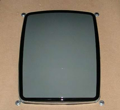

Anyway, next up for this thread is the monitor mount - this was so difficult and I definitely could not have done it without the help of my dad (and mom!). From the start of this project I knew the monitor mount would be tricky because I was going to deviate a bit from the original design. I did not want to put bolts through the side of the cabinet in order to support the monitor.
I don't know why... maybe I just didn't like the thought of poking holes in the side art. The problem with wanting to do this is that the sides are only 9/16" thick which isn't nearly enough material to screw into to support a ~50 lb. monitor so I had to think of a way to get the monitor at the proper angle and supported from the bottom.
Another problem was that the monitor had triangular brackets on each side which supported the monitor in a horizontal position. When placing the monitor vertically in the Donkey Kong cabinet these brackets stuck out the back - this is obviously unacceptable so they had to be removed. Compounding the issue was that these brackets also held the electronics of the monitor in place! See:
The final problem was making a frame for the monitor. After removing the triangular brackets there was no way to actually mount the monitor!

Bear with me on the next few posts - in all the excitement and since my dad was helping me out I didn't take as many pictures as I would have liked but I will do my best to explain exactly what I did.
The first thing I had to do was cut a piece of MDF exactly the width of the inside of the cabinet with a hole in the middle for the monitor to poke through. Getting the dimensions of the hole was difficult because all of the sides are curved and I had to make sure not to remove too much material. I came up with a method that ended up working but took way longer than it should have. If I ever have to do this again I think I could make it pretty quick.
Anyway, I cut some poster board into some long strips and taped them together end to end. Then I wrapped the poster board around the outside of the monitor. This was done in order to trace the shape onto a piece of cardboard. I figured if I could make a hole in some cardboard that would fit exactly around the monitor I'd be able to use it as a pattern to place it in the MDF.
I ended up using a pizza box held up against the front of the monitor/blue poster board and traced the shape. Then I cut out the hole and tried fitting the frame around the monitor. It wasn't perfect on the first try but what this allowed me to do was refine the cutout. After fitting the pizza box around the monitor there were tons of gaps and nothing fit quite right so while the pizza box was in place I covered the gaps with strips of blue painter's tape. Once I was satisfied with the coverage I removed the pizza box (with the tape still in place) and had a template for the shape of the monitor which I traced onto pizza box #2.
Next I cut out the shape I just traced onto pizza box #2 and fit it around the monitor - much better! I ended up having to make a few tweaks with some more blue painter's tape because I was cutting the cardboard freehand but I eventually got a really nice pattern. Then I centered it onto the MDF panel that will hold the monitor and I cut it out (free hand with my router after rough cutting with my jigsaw). It worked!
The next thing I had to do was remove the triangular brackets from the sides of the monitor (remember, the whole point of this exercise is to remove those things because they stick out of the back of the cabinet). Once that was done, the monitor cannot be put down! I quickly positioned the MDF panel I had just cut out around the monitor and located the holes for the bolts in each corner. I drilled out the holes and bolted the monitor in place - success!
These aren't the best pictures of the panel but you get the idea - the pizza box pattern was for placing the monitor in the MDF and then I had to drill a hole in each corner for the bolts - I had to be precise with everything because the bolt holes are so close to the monitor cutout but you can see on the bottom that my freehand skills with the router aren't the best.
Whew! This was the easy part...

The monitor is mounted (well, it's actually been mounted for a week and a half but here are some more pics):
There was one more small problem after getting everything ready for the monitor - since we removed those triangular mounting brackets that came with the monitor, the electronics which operate everything were loose and hanging by the connecting wires - not good. This is actually where my mother came in very handy. Every time my father and I lifted the monitor to move it around she had to hold the electronics so there was no tension on any wires - not easy - it was like a game of Twister or something. Thanks mom!
Once the frame was ready, we slid the monitor into its final resting position and stood there holding the electronics. We were tired at this point and I made the executive decision to just screw the panel into the 2x4s with two 3" screws. It worked great. The electronics are at an angle inside of the cabinet but there is no tension in any of the wires:
You can see the screw in the upper corner going right through the metal - there is another on the opposite corner and it is very secure. Here are some more shots from behind showing how the monitor is mounted inside of the cabinet:
I don't know if you can tell but getting the monitor in the cabinet was by far the toughest part of the project. We spent 2 full days getting this thing in place just right. I'm glad that's over!
