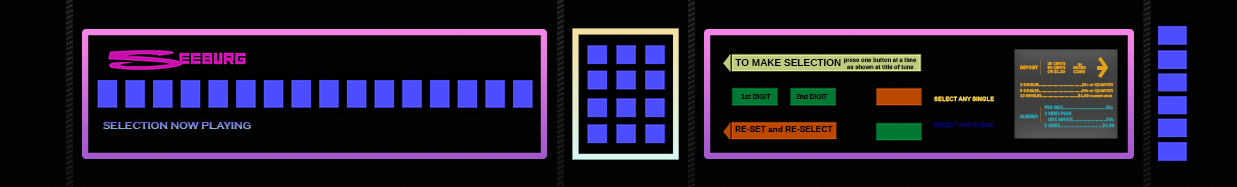

Re: Greenman's Jukebox Build
« Reply #42 on: April 10, 2020, 02:51:46 am »
I know this build is taking a while, but I'm trying to stay productive....honest.
I freely admit my photoshop skills suck.  Anyway, here is the first draft of the translite for the control panel.  Obviously the buttons won't be printed as they will be real push buttons.  Light will shine from behind the translite to make it all stand out.  Again, first draft...not finished.
The toughest part of this build is not seeing the original jukebox in person.  I don't think one ever made it out to Australia.  I am having to work off low res google images and youtube videos.
I scrapped the original idea of the control panel with the VU's etc and decided to replicate the original as best as my skills allow...
I have about 8,000 songs now.  I make regular trips to the thrift shops (Salvo's etc.) and buy CD's for $1 each.  I actually managed to pick up an original AC/DC Albert Productions CD this way which I note someone has on ebay for $150.
Get the CD's while you can.  Once it's all on cloud, you no longer own the music.

A little more done.
I cut a hole.
I used the router.
Perspex fits.
This is the colour.  I will diffuse the light coming through the hole with some lightbox perspex on the inside.
So the job I was dreading and putting off only took an hour or two and was fairly straight forward.  Onward and upward.

Control panel is coming together.  Not an exact replica, however that is not really the intention.  The buttons on the right will be for volume control, random play and to scroll through the various pages of songs.
And this is with the control panel backlight on....

« Reply #78 on: December 10, 2020, 03:31:02 am »
Thanks everyone.
I'm getting on with it now.  Control panel wiring....
To be honest, the biggest slowdown has been deciding on a graphic for the front.  Any ideas, suggestions would be much appreciated.  Any help getting something slightly original via photoshop would be even more appreciated (1000mm x 365mm).  I've been stuck on this for about 6 months!!!!
This is what the original looked like:
Paul.
