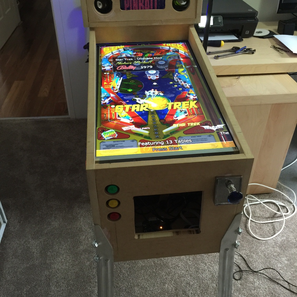

Bit of an update on the build.
Some general build notes from the photos in my first post...
* For cutting out the sides an other panels, I whipped up a saw board. Highly recommend this - it improved my cutting with a circular saw by a mile.
* With the two sides cut, I clamped them toghether with the factory cut edges lined. I then ran the router around the edge with a flush cut bit. Result = two sides exactlly the same size  ;D
* Temporarily assembled the panels with wood screws and brackets. The brackets are ok, but the panels don't always line up perfect. Might have to clamp and glue as well when I am happy with the cab assembly.
Now for the new stuff..
Routed a slot in each of the side panels so that the playfield monitor can slide in without any of the case showing. Was a bit tricky, because of a tiny cable that runs to one corner of the screen. To accommodate this I had to put a tiny step inside the slot.
Test fitted the playfied monitor.
Repeated the same process to make the back box and fitted the screen. It's pretty rough right now, but I want to see if it looks and feels right.
Hooked it all up to the computer for a test run  ;D
Good fun so far! Now if only I had some more free time  ::)

Also, I got my PC up and running again. It's surprising how much of the software setup I had forgotten in such a short space of time  :dizzy:
I gave the three monitor setup a go using one of these:
I am happy to say that these usb to vga adaptors seem to work just fine. It saved me having to find another video card or change my motherboard to get the 3rd vga/dvi out. There is one catch with these though - if you want higher resolutions you must connect it up to a USB 3.0. On USB2.0 the adaptor can only display 800x600, which is fine for me as it will be the DMD :)
Lastly, my plunger kit arrived from virtua pin. I gave it a quick test run in Future Pinball and it works fine. I think it auto calibrates every time it is turned on, so there shouldn't be any issues. Also, the PCB it connects to has a joypad encoder built in which will handle input from the cab's buttons, and an accelerometer to detect table nudging.
More progress to follow soon...

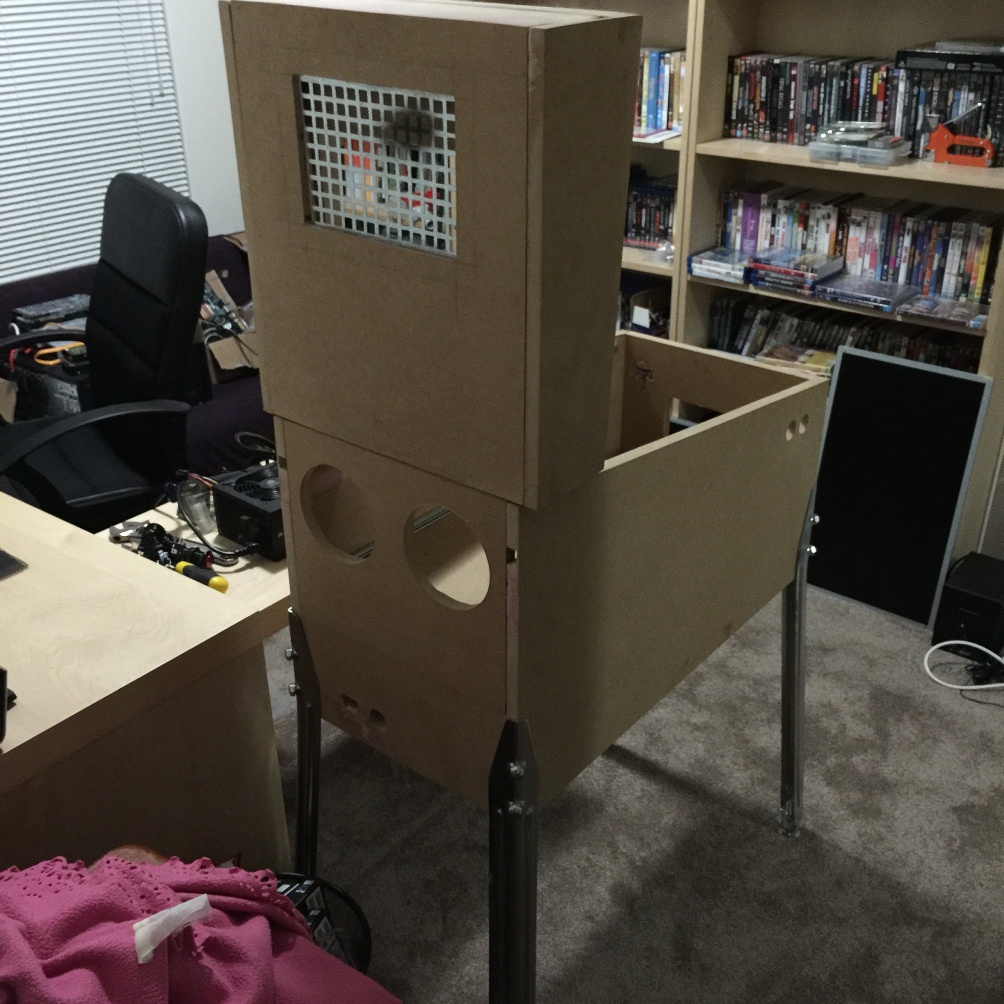

And now for the rest of the update...
Originally I decided to mount the playfield screen horizontally like so many other virtual pinball cabs have done before. However after a bit of testing I feel mounting the screen on an angle is the way to go. I didn't really feel like cutting out new side panels so I started by filling the slots for the monitor with "builder's bog".
After sanding the filler flush, I routed new slots for the monitor at a slight angle. I kept it neat at the front end since that will be visible above the playfield. The back end is a bit rough because it will be out of sight.
Next up I am going to cut holes in the front panel for the coin door, plunger and buttons.

First up, I've partially cut out the front panel. It now has holes for the coin door and the plunger, but I've still got to figure out what I am going to do with start, exit and coin buttons. I also unscrewed the cabinet panels because the alignment was quite bad. Have now clamped and glued them with (most of) the edges lining up good enough to be sanded flush later.
I've also added a drawer shelf with the back panel attached to it. I've used "push to open" drawer slides which work ok. I'm not 100% convinced I want to use these over regular drawer slides.
For mounting the motherboard on the shelf I have taken the mounting screws out of an computer case. With a small pilot hole they easily screwed into the MDF. It won't be super strong but is fine for this purpose.
and up close...
Lastly, I removed the back panel to cut some holes and route a recess for some cooling fans. I'm using just a couple of regular 120mm PC fans. I will place another 2 on the underside of the cab to promote airflow in to the cabinet and then out through the back.
That's all for now. I'm really enjoying the build process, even though it's hard to find the time and my skills could be better!
Next update - should have some significant progress on the rebuilt back box - with added monitor for DMD ;D

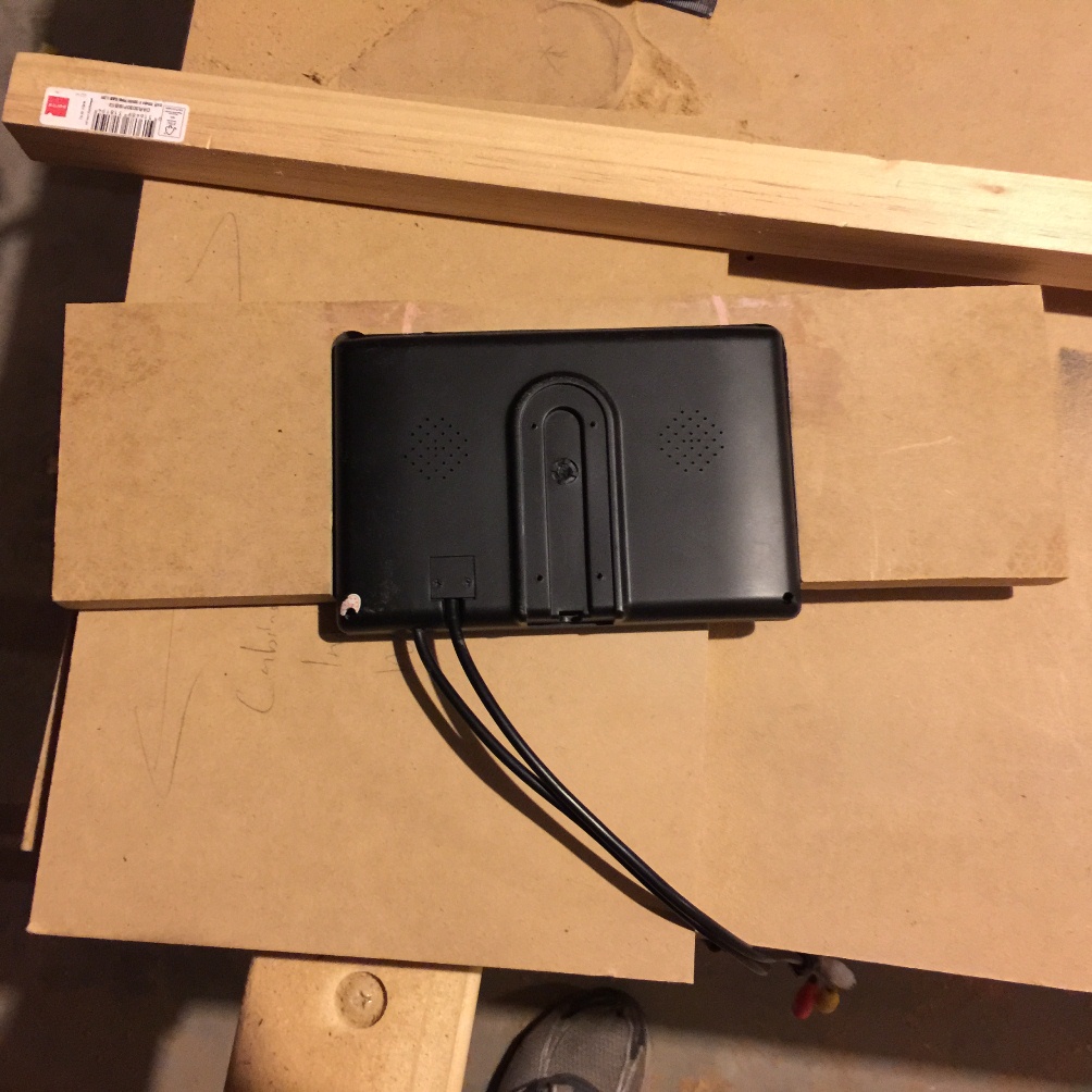

The backbox has been completed, but not after some pain. I had it mostly done when I accidentally knocked it off the work bench  :cry: :hissy: All the joints came apart and I had to rebuild it, doing the best I could to smooth out anywhere it had become uneven. It will never be quite the same as before, but overall I’m happy with the outcome.
Since I decided to go for a dedicated monitor for the DMD, I had to make a panel to house it at the front of the backbox. I will also fit the speakers in this panel. I started by routing out a space for the monitor.
I rounded the top edge of the panel, and cut a DMD aspect ratio size hole where the monitor sits. A lot of the small 7”monitor will not be seen, so that the correct aspect ratio can be kept. I also cut out some round holes for the speakers and routed a square cavity behind them where I will eventually put some speaker mesh.
Here is the mostly complete backbox, and a view from the top showing the hinged back panel and where the monitor slides in. That grill at the back should look better once I paint it black.
And here it is with the rest of the cab. I got some authentic pinball cabinet legs – these make the cab look a whole lot more legit.
Some photos from the back showing the slide out drawer for the PC and the backbox access.
I put all the guts inside for a sanity check and to see if I have to make any adjustments to the cab before I start prepping for painting. Everything fits ok but I will have to make some extra holes to run some cables to slightly different places. Lastly I gave it a test run. I think it looks a lot better than my original 2 monitor setup.
So I'm happy with the build so far. I think it is time to start getting some coats of paint on this thing. My plan at this stage is to throw on a few undercoats first, inside and out. The outside sides and front surfaces I am planning to cover with printed vinyl, so I will spray these with gloss black (I read a smooth gloss surface is best for adhesive vinyl). All other visible exterior surfaces will get a few coats of satin black.
