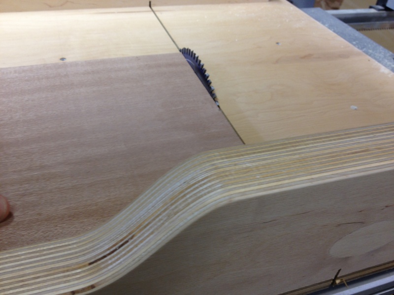

« Reply #9 on: June 01, 2013, 09:15:05 pm »
Thanks everyone!
I was able to get on this for a couple of hours last night and tonight, so I figured I would post some progress pictures. The bent panel is made up of 3 different pieces of plywood and 2 pieces of ribboned Sapele wood veneer. The core is a piece of 3/8" Bendy MDF, sandwiched by two pieces of 1/8 plywood. The Sapele veneer is on the inside and outside. These all add up to a total thickness of .65".
Here it is all clamped down.
The first two layers are wider in order to make trimming the part easier on the table saw. The black and clear mesh pieces are to allow the air to flow out evenly across the part to avoid air pockets.
Out of the bag prior to trimming.
The sides are trimmed and looking good. With so much time reading about this technique (and money) it's a relief to know that it works very well.

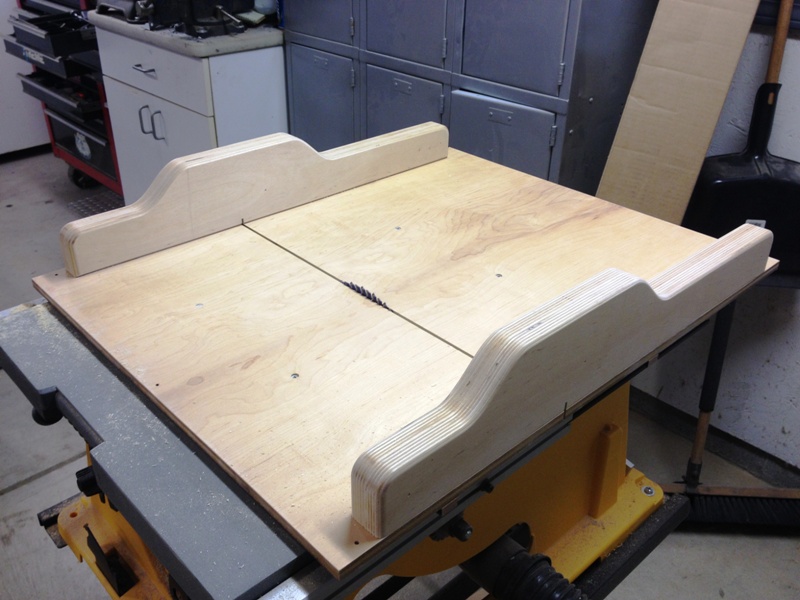

Next up is to make a jig for the table saw that will act like a sled and allow me to clamp the part down and square up the bottom. stay tuned...

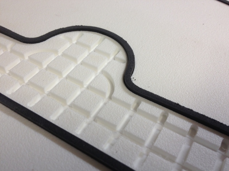

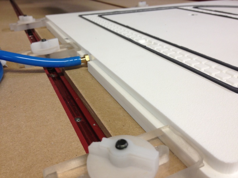

Finally able to post some progress, at least on the fixturing.

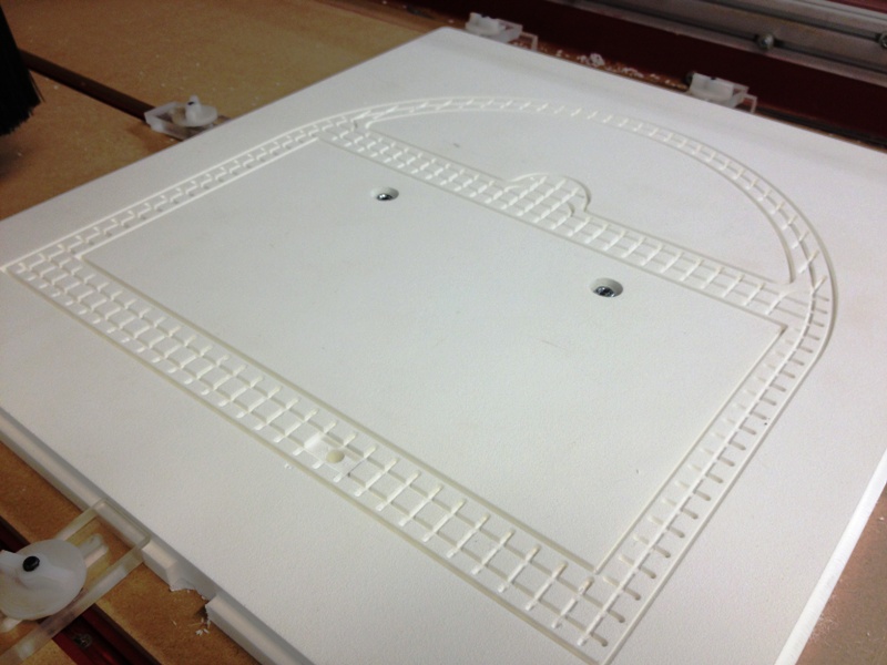

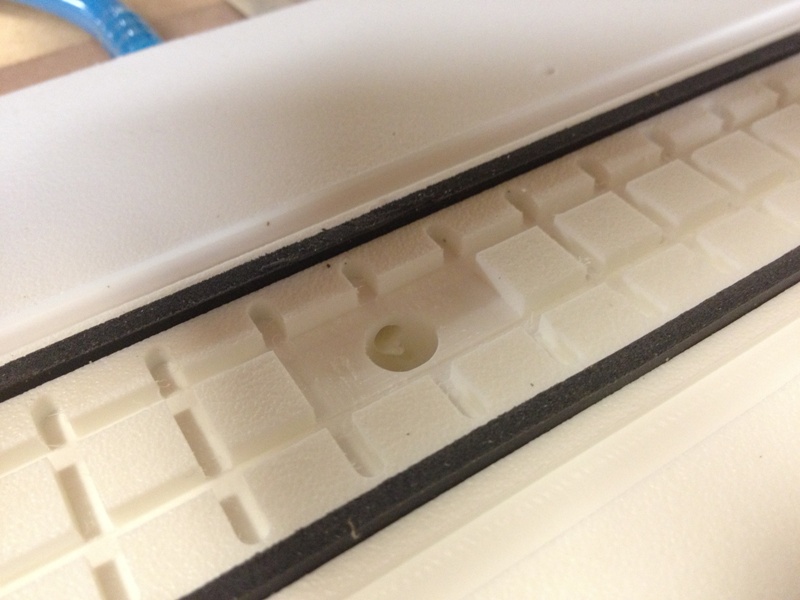

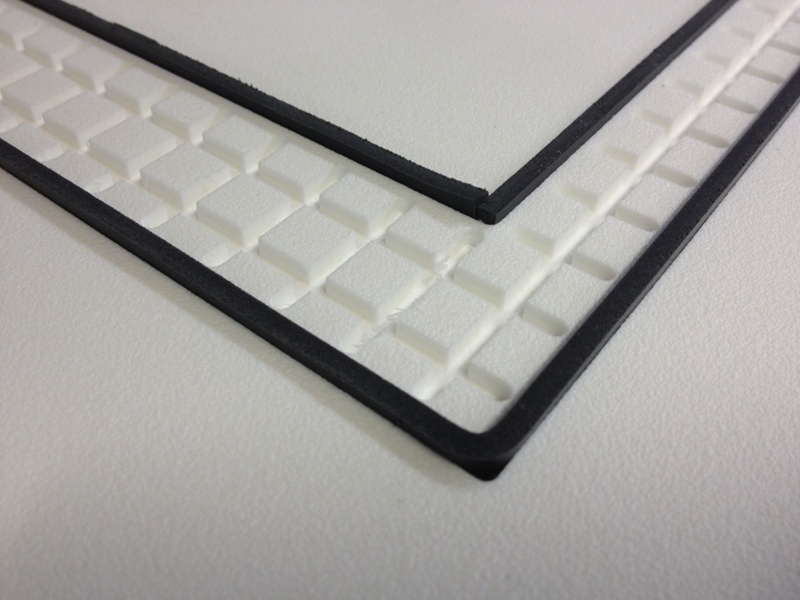

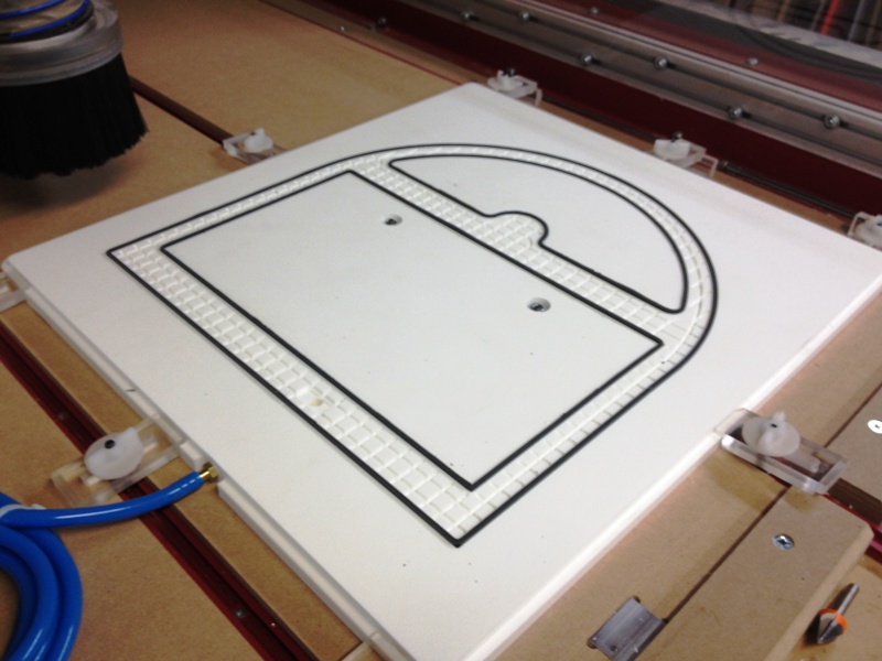

I needed an easy and efficient way of trimming up the bottom edges of the curved piece. At first I was trying to come up with a clever jig to do the job. I soon realized I was making such a simple task way too complicated. The table saw sled would do just fine. I bought a new table saw recently and had wanted to make one for it anyway. They are extremely helpful and can make several tasks much safer.
One of the biggest challenges when using a CNC is holding the the work piece down. Clamps are the most popular choice in the DIY world because they are cheap, but they are usually clumsy and time consuming to setup. It can also be challenging when two sided machining is necessary. Indexing the part from one side to the other is much easier with a dedicated vacuum fixture. Once the front machining operations are complete, the part will be released and flipped over. With the X and Y reference stops in place, the vacuum pedal is pushed and its ready to go.
Channels for the vacuum and foam gasket cut into a 3/4" piece of HDPE.
The gasket installed.

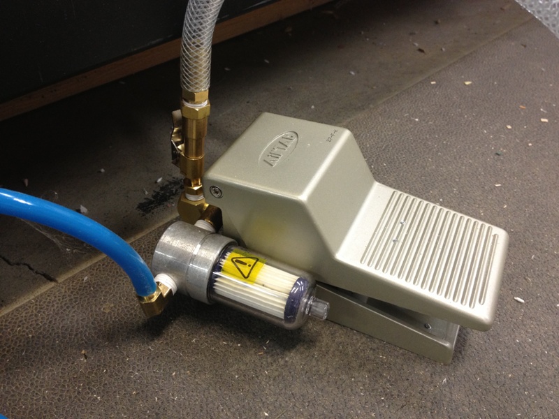

Here is the inlet for the vacuum.
This foot switch allows me to position the part just right before turning the vacuum on.
Here is a short video of everything in action. As the foot switch is activated, the part is drawn down to the fixture, the pump refills the reservoirs and shuts off.

Here are some more progress shots.
I glued up the first unit over the weekend. I went with a black top since these are ones that most people will buy. The first step was to glue and clamp the bottom to the bent frame. Once that was dry I moved on to gluing the front and back to it. Most builders probably wont have this many clamps available to them so I will be offering this service as well.
Once the unit was glued up, I trimmed the edges. I intentionally made the front and back edges a little oversized for trimming later. This is to give a little bit of wiggle room when clamping. This ensures that once it is built and trimmed, the front and back panels are flush to the bent frame. This is important as the t-molding will be overlapping the bent frame structure about 1/8'. If it was off a little, it would stick out like a sore thumb.
