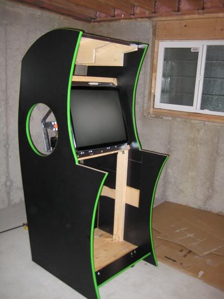

Thanks Pixel. Ya, Im definitely happy with how it turned out. So far no popping after about 3 weeks, so feel confident it will be fine. The back will be similarly curved but I will do that in 2 parts...a permanent top half and a removable bottom half for the computer.  The top half will have an opening but only for a UV Green 120mm fan.  The back straightens out at the midway mark going down so the removable bottom panel will not be curved, making it easier to remove etc.
So picture a similar curve extending from where the top ends down to the midway point where the back straightens, with a green UV fan. I want to get a custom Aliens picture laser cut for it.
Oh and to get the curved shape, same idea that worked well for me for the top...curved ribs that I have already put aside for the sides and some mid structure to attach the curve to.  All of them were template routed based on the back curve. so it will be a flush mount riding just shy of the t molding.

From you pics it looks like the top stayed pretty rigid when not attached.
I have been using threaded inserts. So each side rib has a three threaded inserts. The outermost ribs on the roof itself have lined up threaded inserts...then I just screw the bolt in to join them together.
It is completely solid and won't move on its own or when joined to the cab.  I did the top and bottom first for this very reason...my first cab different parts of the cab weren't the same width...this time I wanted 26.5" from top to bottom with not even 1/16" variance...so far so good ;)

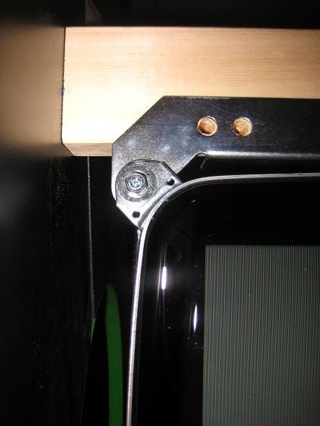

« Reply #221 on: November 07, 2009, 07:40:16 pm »
Today I installed the upper monitor brace and test fitted my WG D9800 monitor.  I have included some pictures of the bolt holes and placement on the beams. I ended up cutting 4 notches to clear the bolts.  Tomorrow the fun begins, cutting the various panels for the front, the bezel, speaker and bottomr marquee retainer shelf and the coin door, CP and piece that joins the two.  I will also close in the light chamber of the marquee area.
The width of the bezel area is 26.5", leaving 2-5/8" from edge of viewable screen to side of cab on each side.
« Last Edit: November 07, 2009, 07:46:50 pm by Epyx »

You can beat a nice big monitor, there is nothing worse than seeing a lovely cab with a ---smurfy--- 17" CRT in it IMO.
Completely agree, I have about 2.5" (from viewable screen, 1.5" from edge of monitor) on each side. That will be enough for the bezel and give me a nice big screen.

Look for a massive update this weekend.  All the final pieces have been cut for the front of the cabinet and the next two weeks should see things get finalized. Although a massive IT project at work is preventing weekday work..the weekends are all clear for me to build and unwind.
Cool Epyx!  Looks like you and I are on a similar time line for completion.  My goal is to be able to spend the U.S. Thanksgiving holiday (in about 2 weeks) PLAYING a finished cab!
Can't wait to see yours finished!   :cheers:
