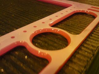

Thanks drawfull, that means a lot coming from you! If I end up developing a quarter of you and your dads skills I will be more then happy!  :)
Got a fair bit more done yesterday.
I'm using those touch sensitive PCBs on the front of the cab for volume up, volume down, LED sequence change and exit. I tested the PCBs with +5v from a PSU and a multimeter. I found that the PCBs will work through around 1.5mm of acrylic. Obviously my front panel is 5mm thick so they wont work through that. I was going to route some of the front of so It was only 1.5mm think but I didn't want to risk scrapping the whole thing without having a 1/4" pattern bit.
Instead I have decided to route out a relief for the buttons completely and then mount them to lozenge shape pieces of 1.5mm acrylic that is larger than the relief. Ill get some stickers made to stick to the acrylic to denote what they are and match the panels with the cab.
With that in mind I made a template to route out the reliefs for the buttons:
You can see the PCBs are not central to speaker vent, this is because the touch sensor part is at the top of the PCB so I cut the reliefs so that the touch sensor part is central to the speaker vent. The lozenge shaped acrylic will be almost twice the size of the PCBs so the touch part will be in the center of the button. Hope that makes sense  :P
The buttons should look something like this shape wise, excuse the paint edit:
I had to do some further work to the bezel to aid the LED mounting. I decided to make a inner bezel to mount on the back of the front piece. I needed to do this to give some room for the LEDs and wiring.
This is the spacer bezel I made:
I used some contract adhesive to stick it to the front section, I don't think it will move under this lot :)
I only gave it about 30 mins to stick but it turned out pretty well. This is a picture of the back:
I used some 120 grit to bland the two pieces, it looks like I may have a slight white line where the adhesive is but its no big deal, it will give a little contrast on the bezel. It may come out when i polish the bezel but I'm not fussed if It doest. You can see the white line here.
You can also see where I polished the speaker vents a couple of days ago. I used P320, P600, P800 and P1200 grades before using the Novus polishing kit I got from the states, it works so well!  :)
Final shot of the bezel/front piece on the monitor:
I also started wiring up some of the LEDs, I think I may have to turn the intensity's down a little in LEDBlinky!

Thatittallian sent my GP-Wiz, LED Wiz and a few other goodies through today so Ive been able to test the touch PCBs. I was a bit apprehensive about how well they would work but I'm pleased to say they work brilliantly!  ;D
There are three wires coming from the touch PCBs, one goes to the GP-Wiz ground, one goes to the GP-Wiz input terminal and the other requires 5v. Luckily the GP-Wiz has a 5v tap so I hooked the wires up that.
When the switch is open the PCBs give out 5v. When you touch the sensor it drops the voltage to nearly 0v. The GP-Wiz then reads this as the circuit being completed (i.e. pressing a normal button) and then sends out the appropriate joystick command.
I'm using a program called [Volume Tray] as you can configure it to use any keyboard key/combo to use as a hotkey to control the system volume. As the GP-Wiz is a gamepad interface I used [JoyToKey] to change the gamepad commands into keystokes.
I configured all of the keys etc and ghetto mounted the PCBs to the inside of a CD case to test them, here is the result:
Each touch of the PCB raises/lowers the volume by 5% (also configurable with Volume Tray)
Its only a little update but I wanted to share :)

Ive been working on a platform to mount the LED Wiz, GP Wiz and a piece of acrylic to mount some d-subs in. I wanted to do this as once I have the bezel all wired up and I attach it to the cab, there will be very little room to screw the wires into the Wiz's terminals. Using this method, all I have to do is plug the mating d-subs from the bezels LEDs and I/O panel into the platform. If an LED ever goes or I have other problems it will be much easier to remove and troubleshoot/fix.
I made a platform out of some sheet metal to hold the LED Wiz, GP Wiz and the acrylic mount:
I soldered all the d-subs up to connect to the boards. There are four 15 pin dubs for the LED Wiz (using 8 pins each), two for the GP Wiz (using 13 pins each, U,D,L,R, eight action/admin buttons and one ground) and one 9 pin d-sub for the touch sensitive buttons (using 6 pins, four button outputs, +5v and ground)
I forgot to take my 3rd hands to work so I improvised with some plasticine  :laugh:
The d-subs were mounted in a piece of routed pink 5mm acrylic I had spare and the wires were cut to the approx lengths:
I'm using one of the new LED Wiz's with the voltage bank selects. After reading the [documentation] I took it that I needed to daisy chain the banks to the USB 5v output but after reading one of Randy's comments in another thread I'm not sure if this is correct and/or necessary.
Anyone have any ideas about this? I may PM/email Randy if not.
The last step was to terminate the wire into the boards. Damn it was fiddly! I JUST had enough slack in the wires to get it all in. I didn't want to have really long wires and have it look too messy.
Final money shot:
Ive tested the continuity from the d-subs to the top of each screw terminal and all seem good! Phew!
You can see some nylon standoffs I made that screw onto the bottom machine screws, this will allow it to straddle the HDD in the bottom on the case.

I brought the bezel in to work this evening to finish blending the inner bezel and polish the rest of the cut outs. I only have my camera phone but you get the idea:
You can still see a slight whitish line where the two pieces meet but at least its uniform and doesn't look too bad.
I'm hoping to get the rest of the LEDs wired up tomorrow and pretty much have the thing finished bar the artwork by the end of the week. Things always seem to take about four times longer than they should though so I'm not going to hold my breath!  :laugh:
