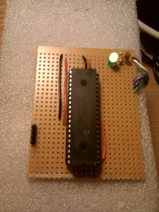

Whilst I'm sanding parts and wating for various layers of oil to cure, my mind has turned to the admin buttons.
I'm aiming to embed capacative touch buttons below the veneer and acrylic top - in the bezel. This obviously wont work for buttons used during play, for the same reason iMame sucks without a proper controller.
For infrequently used buttons though, it should be a nice convenient way of accessing functions without cluttering up the control panel.
The idea is to have a grid of metal areas to represent the buttons, with some sort of visual but non functional panel on top.
The metal functions as a capacitor, that is charged/discharged frequently and the average charge time is measured. When your finger is nearby - it changes the capacitance and therefore the charge time, which is detected and counts as a button press.
Thats the concept. In practice, I'll be ordering a microcontroller this weekend (probably in the PIC 18 family) that has a CTMU (charge time measurement unit) built in.
The metal plates will be either an etched pcb, and the button images above could be marquetry icons in the veneer, or possibly I could etch some brass (laser cut would be nice - but cant find anwhere that would be cheap enough) in the shape of the icons and put them on top of the veneer, but under the acrylic top.
With a bit of coding on the microcontroller, I should be able to get a button press to send a signal to the iPac to represent a keypress.
I'd like to incorporate some feedback if possible. I've already ordered a small electro luminescent sheet to see if it will show through the veneer in the same way I did the LED matrix, so the button could light up on a press. Not sure if it would introduce electrical noise and screw up the capacitance etc though. I'll have a play and see. Alternatively, I could embed one of the tiny vibrator motors like those in phones.
Trying to post my thoughts in detail (and any progress I make) - in case any of you guys with CP art could make use of the idea - some kind of subtle indication on the image to indicate the button location might be fun to try and incorporate. If it's on the CP you would have to have some kind of shifted setup though I guess.

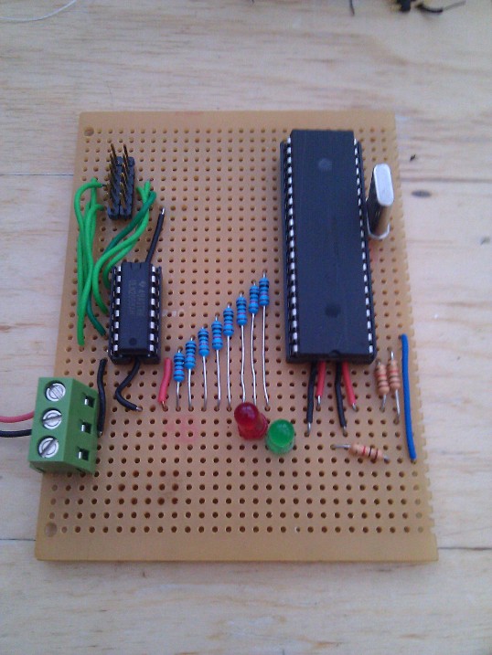

Anyway - onto the update. I got a test circuit working with touch areas below the acrylic and took a video. I needed to do this to make sure the electrical noise from the monitor/speakers/etc didn't interfere with it.
Here is a video of it working:
I realised later that iPaq signals need to go low to register a key press  :banghead: and I'll have to prevent multitouch, which will cause all sorts of issues.

So to implement the touch pads, I made this:
The 'leg' goes through a hole drilled in the bezel to connect to the touch circuit below the monitor.
Here is a vid of it working - just the pause button so far.
The sensitivity needs to be turned down a bit, which is a parameter tweak in the firmware. It's actually quite cool as at the moment you dont actually have to touch it. You can pause the game by just passing your hand over it. Not so useful when the other buttons (exit!) are implemented though  ::)
