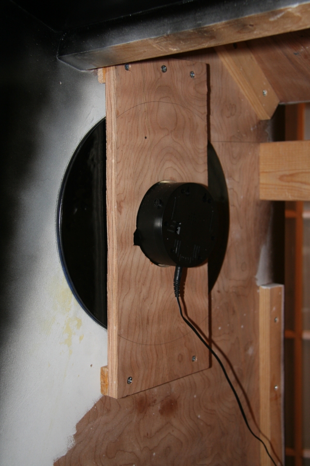

Mounted the Lumindiscs.  There were multiple ways I could have done it, but I chose to just cut a strip of my scrap ply, cut a hole and screw it in.  Worked great.

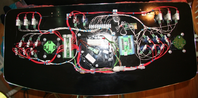

Finished the control panel wiring, finally...

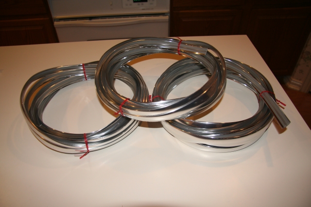

Received a couple of important goodies in the mail...

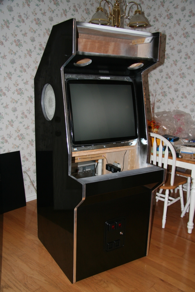

Then promptly went to work on installing the monitor and T-Molding.  MISTAKE: I totally underestimated how much force was going to be required to install the T-Molding.  I had to use a rubber mallet (with a towel wrapped around it).  In order to install the molding on the bottom edge, the cabinet had to be laid on its side.  Well, I wasn't going to try to lay this baby down with that 100LB monitor weighing it down, sooo, I had to take the monitor and plasma discs BACK OUT again to install the molding.  Nothing like doing tasks twice.   :banghead:
And here's the molding and monitor installed:

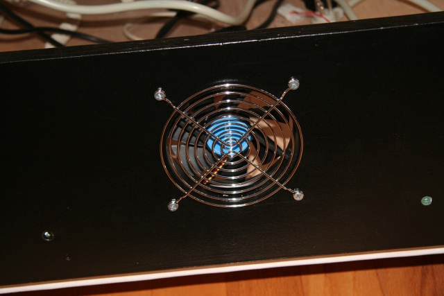

Next got the fans installed.  Nice little fans.  No bling to them, but they should last a good long time.  They have magnetic bearings, and a thermostatic switch so they adjust their speed automatically according to the temps inside the cab.  They seem to be pretty quiet too.

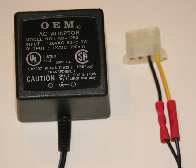

I was starting to get worried about the load on the power supply, with all the stuff hanging off of it (it's only a 450W supply).  I decided that I would run the two ventilation fans off of a small "wall wart" power supply.  I simply found an extra one lying around the house that was rated to handle the power needs of the fans. Then I just spliced in a molex connector.  Worked great!

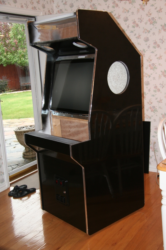

.....and *drumroll* here's how it looks now...

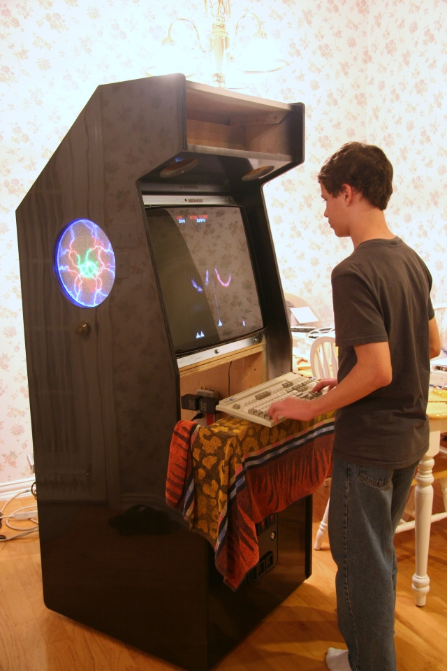

And of course, this is what it's all about...  grooming a new generation of classic arcade lovers!   ;D
Still have a few loose ends to take care of.  The most glaring of which is my speakers.  My car speaker idea flopped.  The magnets are just too strong to use near a CRT, and I wasn't able to shield them sufficiently to allow them to work.  This puts me in a bit of a bind, because I already have the holes cut for a 5.25" speaker, and I'm having a hard time finding shielded full range drivers that will fit.  The closest I've found is some 4" ones from Parts Express.  I may just have to get those and figure out a way to mount them inside the larger holes.
Also need to order some monitor glass.  Haven't decided yet whether I want to just do clear glass or tinted.  There are pros and cons both ways.
The other issues are mainly just software related quirks, which I'm slowly working through.
