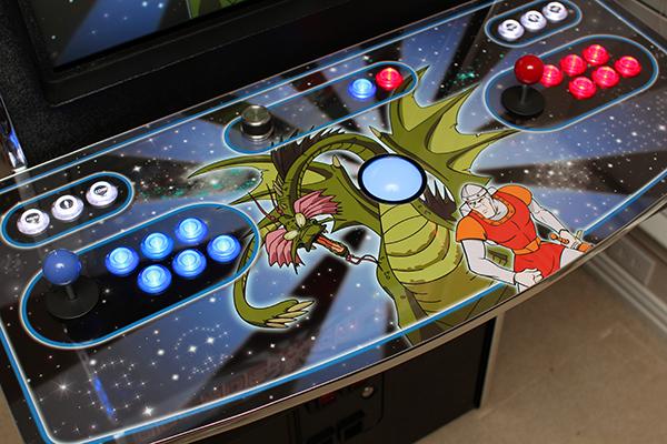

The controller that comes with the TT2 also has jumpers to connect mouse buttons.  The two buttons you see on my panel next to the spinner are wired as the mouse buttons.
When you connect both a trackball and the spinner to the board, the spinner is on the 'Z' axis.  The problem I'm having is that the newer versions of MAME do not play nice with a spinner on the Z axis.  There were some software 'hacks' that could be done on previous versions of MAME to fix this, but I didn't have any luck making those work with my version of MAME (v134)
I *think* the easiest solution for me is going to be to just purchase another Opti-Wiz so I can separate the trackball and spinner.  For $20, it's worth it, as I'm tired of fiddling with MAME, and I'm not interested in dropping back to an older version.  If I remember right, the problem was introduced around v115 or so.

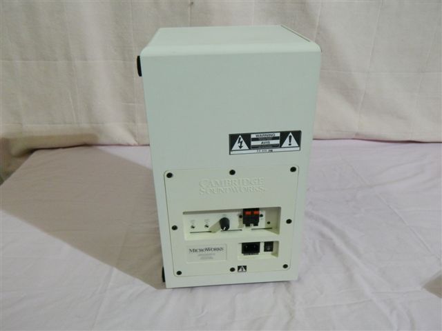

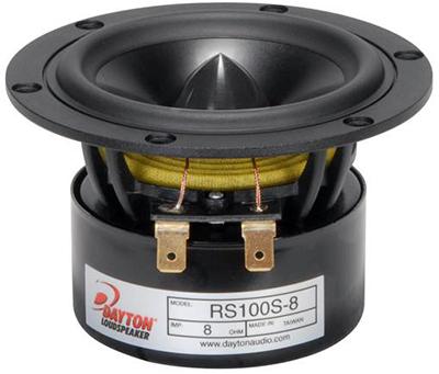

Almost embarrassed to resurrect this thread after being away so long, but wanted to try to tie up a couple loose ends and throw up a couple newer (better) pics of the cab.  :)

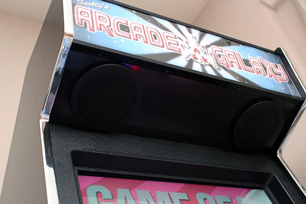

One the major issues left unsolved in the thread was my audio/speaker situation. As mentioned previously, I had originally purchased some nice Infinity car speakers to use, along with an amplifier. Well, as it turned out they didn't play nice with the CRT monitor and attempts to shield them myself failed.  So, for a long time I was left with empty holes in my cab and speakers sitting on the floor behind the cab.  Lame!
So eventually, after the burnout from the project subsided, I decided to tackle the problem.  The challenge was I needed a high quality shielded speaker that wouldn't negatively impact the marquee lighting (i.e. cause shadows).  This meant I couldn't really use computer speakers as they were all too bulky in their enclosure and most are too small -- or have poor acoustical characteristics -- out of them.  So after some searching I ran across Dayton Audio RS100S-8 full range speakers. The key for me being that they are magnetically shielded, by all accounts good sounding, and relatively low profile.  Bingo!
They are a bit smaller in diameter than the holes I had cut, so I had to improvise and built some plywood mounting 'plates' which I painted black and installed on the back side of the speaker panel.  Once I installed speaker grills over the holes, it all blended in perfectly.
To power them, I found a Cambridge Soundworks Microworks system with subwoofer I had sitting around. This turned out to be a perfect solution and saved me some time because it has a remote (wired) volume control, which I was able to run up through the cab and mount on the back side of my control panel for easy access.
This solution sounds great, and in the end I'm honestly glad it worked out this way. I had not planned a subwoofer before, but it turned out to be a nice addition.  Really gives the audio a nice full sound.

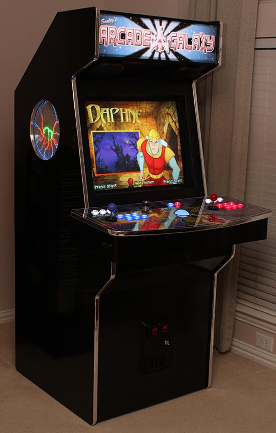

And a couple updated pics of the final product:
