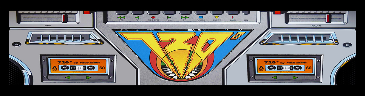

At this point, I'm modifying the artwork for the control panel and the marquee.  The hardest part of the marquee is that the aspect ratio of the real 720 cabinet boombox isn't an easy transition to the longer aspect ratio.  I thought instead that I should make it into an image of a 2 deck boombox so that it stretches out the image more while maintaining the large 720 logo in the middle.  Here's what I got so far.  Would love some feedback or other ideas on this!

That ply will scratch and gouge really easily, save yourself a lot of work by avoiding this. Working on the bench lay down clean towels first, and keep them clean cause they will load up with chips, bits of wire and garbage.
Re: 720 Atari Cabaret
« Reply #3 on: January 31, 2019, 07:51:59 pm »
It’s too squished. Sorry, I don’t like it.
« Reply #4 on: January 31, 2019, 07:52:43 pm »
Although I think you’re on the right track, but the way you stretched out the cassettes already is a turn off.
processedmeat
How's this?
Drnick
  • Posts: 1642
  • Plodding Through Life
« Reply #7 on: February 01, 2019, 02:27:08 pm »
Make the Right hand tape Side B :)  Definitely heading in the right direction.
« Reply #8 on: February 01, 2019, 03:22:46 pm »
I think drnick has a good idea. It could look like the attached!
Thanks.  Made the changes on my original!
Any other thoughts?
« Reply #10 on: February 01, 2019, 04:24:21 pm »
Getting better!!! Getting the tapes in the right aspect ratio is key. Keep it up!!

For the marquee, I ended up going with this.  I printed out two copies of it and for one of them I cut out the cassette section and the 720 logo so that when placed back to back, the light shines through the cassettes and the 720 logo more than the other parts of the marquee.  Kinda similar to how the boombox marquee is lit.
When looking at the digdug and centipede cabaret, they have some graphics between the glass and the black cardboard monitor bezel.  Here's something that replicates that using the 720 glass retainer sticker as inspiration.
Not sure why my cellphone can't pick up my screen properly and the marquee is blown out.
