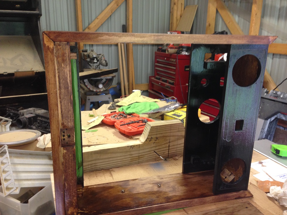

I then cut a speaker panel out of 1/2" plywood. The microphone is in the center.
I then used my router to cut a recess for the speakers. And painted it black.
I decided to mount the speakers on the inside, so I flipped the board around. I cant remember why i did that, maybe it was because of the grill that covers the speakers, but this move cost me a 1/2" of real estate on the inside. Oh well, hind sight again.

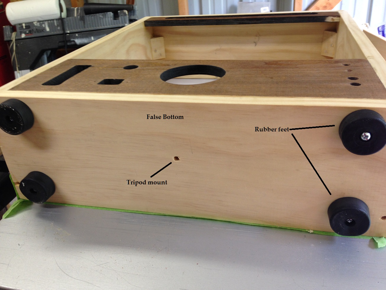

Here I am test fitting the rubber feet, which also holds the removable (false) bottom.
This panel has to be removable to allow the plexi to be inserted or removed. On the first photo booth I cut the bottom in half, the rear part was glue din while the front part was removable to allow plexi access.
I like the false bottom better I think.
I put a hole right in the center to allow tripod mounting. This box is too heavy for most tripods, but it could still be used to fasten the box to a table or platform. I used a 1/4 X 20 T nut on the inside of the false bottom.
I inserted plexi glass, laid the box on its front, with a spacer between plexi and table to keep plexi from bowing outwards. Then I laid the monitor inside the box, with plate and L brackets installed.
This gave me exactly where I needed to mount the L brackets. Marked the 2 holes in each bracket onto the inside wood sides, and removed everything.
I then drilled and inserted 4 threaded inserts. I think they were 10/32.

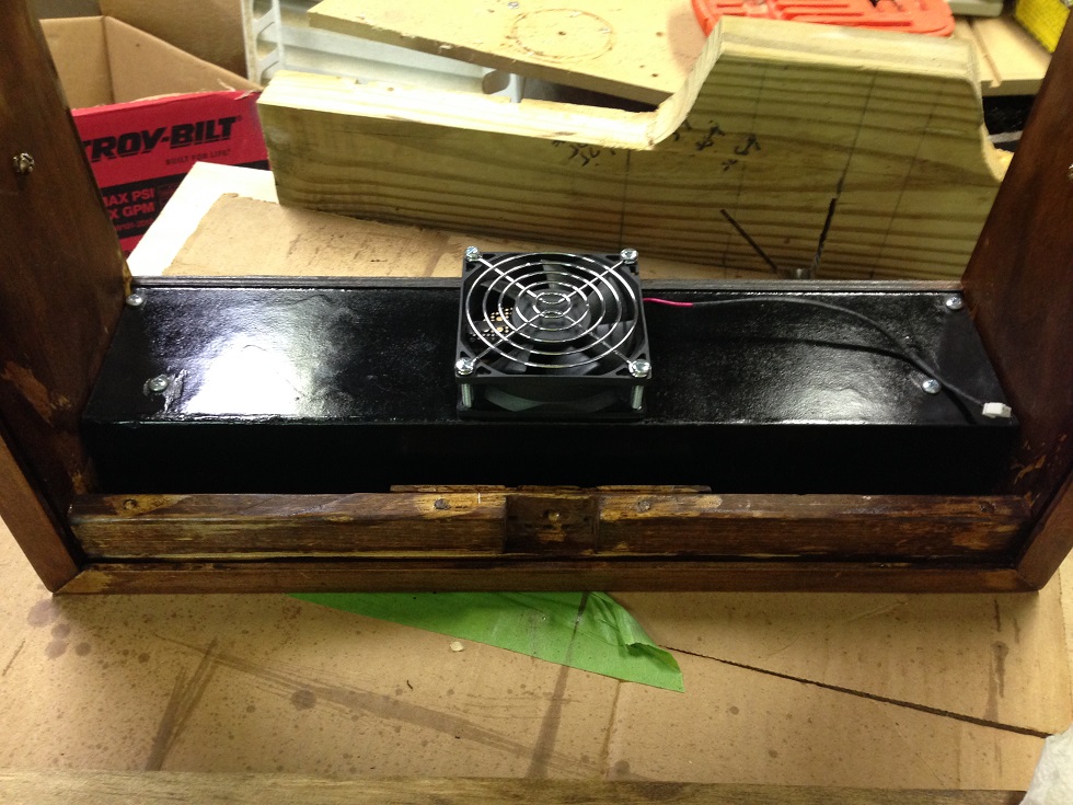

I didnt think I was going to have enough room for the arcade power supply I was going to use, so I decided to mount the fan at the top.
I made a box out of fiber board and mounted the fan to that. I had to glue some posts for the box to mount to.
I inserted and glued wood dowels into these also. (As I also did on the camera mount block, you can see those here.)
I like the wooden dowels as fasteners. I first used them on A Little Rage, it works our good and I think is much stronger than screws. Just have to be very careful when drilling the depth for them.
And here is the fan box mounted. fan mounted to box and box spray painted black.

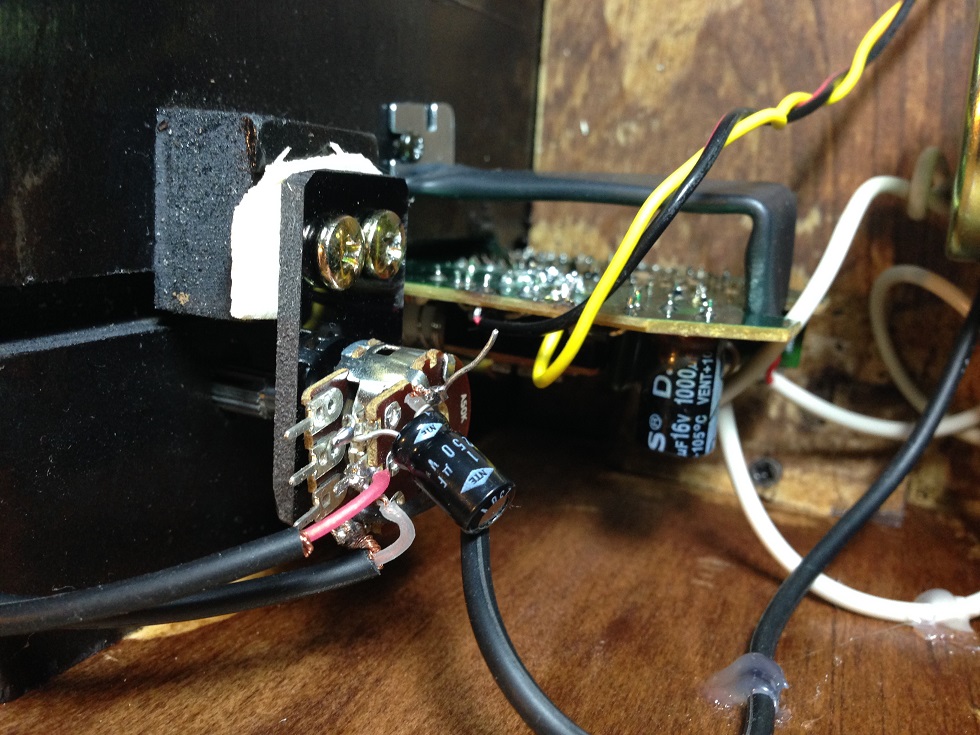

Now I was ready to install guts. I mounted the microphone gain pot on a block and a piece of lexan. I wanted the gain pot to not be easily accessible, so I mounted it so the pot shaft is pretty well flush with the outside of the back panel. You need a small screwdriver to adjust the gain.
You can see a bracket I made for the speaker amp to keep it tight. i made that out of a blank PC case expansion slot cover.
I also shimmed up the mic gain pot to get the edge of the shaft slightly below the surface of the panel. (white plastic between lexan and wood block).
The 1 uf capacitor goes between the pot and the microphone output, to block DC. I tied the two inputs going to the USB sound card together, cause this aint stereo with only one microphone, but I did want sound on both of the stereo channels.
I also mounted a small switch to the right of the speaker amp. This switch is so I can re-boot the Rpi, if it hangs up or something. I have a small hole drilled through the panel. To re-boot, inset a straightened paper clip into the hole and press the switch. (I had this on the first photo booth too, plus another one to stop the program if I need to. I didnt include the stop button on this one, i can insert a keyboard and press ESC to stop the program. I figured you need a keyboard anyway after stopping the program and exiting to the GUI.)

I first planned to mount the USB hub by tie wrapping it to a block I glued on the inside.
This didnt work very good, when unplugging something from outside, it would pull out of the tie wrap. I couldnt get tie wrap tight enough to hold it, so i wound up hot-gluing the USB hub case to the block.
That fixed her.
This pic is before the hot glue.
While in the test rig,  this hub would supply +5 vdc back to the RPi through the usb, so RPi would not shut completely down. I didnt like this, so I removed the back cover of the hub and started to cut the trace that connects to the red wire in the usb supply port (the one that connects to the RPi usb.) Then I thought, "hang on you big dummy." there was no need to cut anything on the circuit board. I just cut the cable that connects the hub to the RPi, I then soldered the wires back together, all except the red one. That one I folded back.
Anyway I broke a clip that held the cover on, so now it wont stay. But thats ok, since I had to remove that cover anyway for the hub to go into the hole I cut for it. The open end will be inside anyway.
Now even though I glued the hub case to the wood block, now when I unplugged a usb device, it would try to pull out the circuit board through the front.
So I removed teh hub and put 3 or four hot glue blotches on the back of the circuit board, to the hub case. That worked like a charm.
I somehow screwed up my micro usb connector on the RPi and had to solder in a connector.
I have the full story of that escapade posted in a thread on the RPi section:  http://forum.arcadecontrols.com/index.php/topic,157569.0.html
Remember how I said that the program turns off the fan while recording audio?
I made a little circuit with an opto-isolator to do that.
And here is the schematic:
I originally hooked the fan to 12 volts, since that is what its rated at. But it was really loud, plus it induced a buzzing noise into the speakers. Very annoying.
I added a capacitor on the fan leads, and that cut way down on the speaker noise, but it still sounded like the space shuttle taking off in the back.
So I tried hooking the fan to 5 volts. That almost cut the fan noise down completely and the speaker noise is not there at all, that my old ears can tell anyway.
It still seems to be moving enough air so I think I will stay with the 5 volts.

I painted the inside of the plexi glass black. I put one of those round color coded labels where the camera is, did want to paint over the camera area.
I tested those labels on a piece of scrap first and they were kind of a pain to get back off, so I coated the one I used with a thin coat of Vaseline.
It was easy to remove after the paint dried.
I then cut out for the monitor and the speakers.
Heres some eye candy:
It turned out pretty nice, but I do have a slight problem with the piece between the speakers and the monitor, its kind of "flappy", easy to pull away from the monitor, just bugs the tee total heck out of me.
Anyone got any ideas how to neatly fasten it down?
I still need to remove the protective film from the camera lens. And will probably put a couple more coats of black spray paint on the inside of the Plexi, I can see the bright light from the USB hub shining through the paint, its not real bright, but I know its there.

The part Im referring to a s"flappy" (probably not a good choice of words), is on the plexi glass, the strip that runs horizontal between the speaker grill and the bottom of the monitor.
I dont have any double side tape, but I did roll up a couple of pieces of frog tape, with sticking side out, and wedge those between the plexi and the speaker panel at the bottom and a piece between the speaker and the monitor frame at the top.
This helped a lot. I need a solution that is fairly easy to un-do, in case I ever need to remove the plexi. I plan to pick up some double sided tape and try that.
It will have to be easy to remove if the camera goes bad, or the plexi gets scratched real bad and needs to be replaced.
Heres more hind sight again, but I wish now I had made the camera removable from the iinside of the box.
Guess I was thinking the plexi would be easily removable, and a lot more access from the front once the plexi is out of the way. The flappiness (LOL) never occurred to me.
