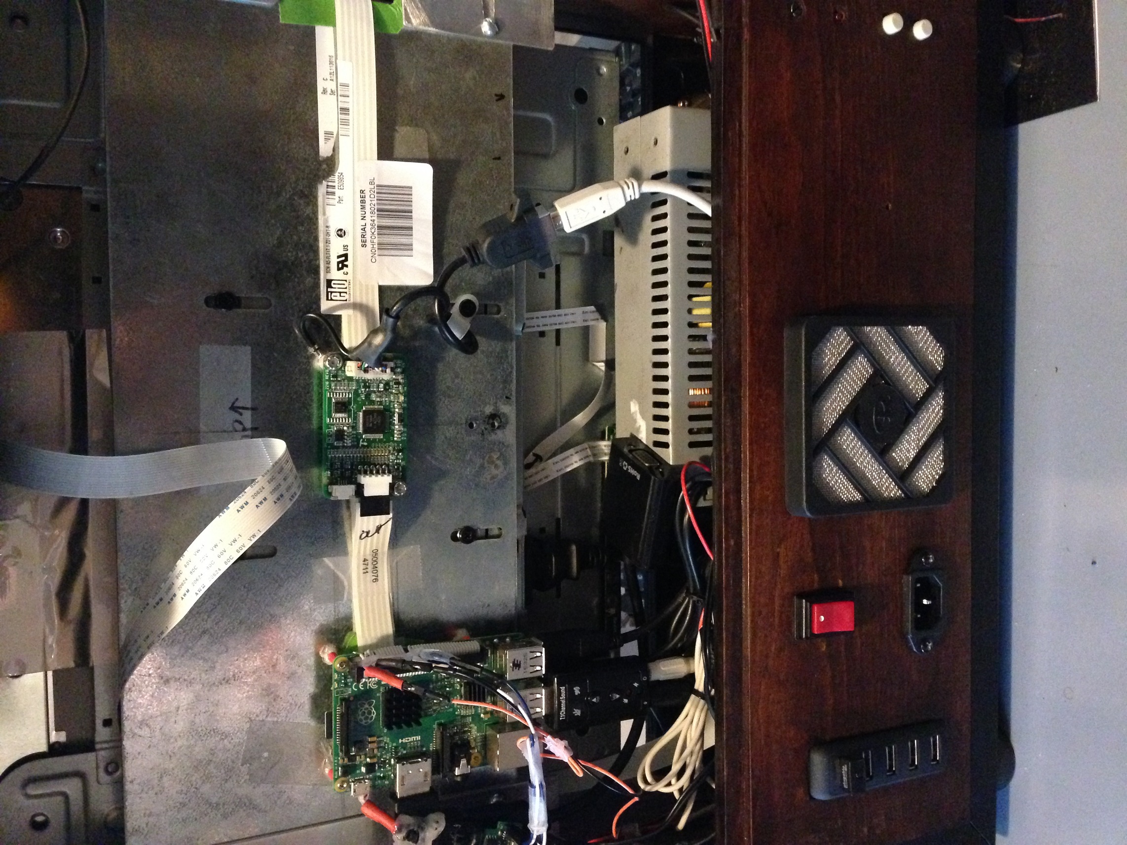

Now I was ready to install guts. I mounted the microphone gain pot on a block and a piece of lexan. I wanted the gain pot to not be easily accessible, so I mounted it so the pot shaft is pretty well flush with the outside of the back panel. You need a small screwdriver to adjust the gain.
You can see a bracket I made for the speaker amp to keep it tight. i made that out of a blank PC case expansion slot cover.
I also shimmed up the mic gain pot to get the edge of the shaft slightly below the surface of the panel. (white plastic between lexan and wood block).
The 1 uf capacitor goes between the pot and the microphone output, to block DC. I tied the two inputs going to the USB sound card together, cause this aint stereo with only one microphone, but I did want sound on both of the stereo channels.
I also mounted a small switch to the right of the speaker amp. This switch is so I can re-boot the Rpi, if it hangs up or something. I have a small hole drilled through the panel. To re-boot, inset a straightened paper clip into the hole and press the switch. (I had this on the first photo booth too, plus another one to stop the program if I need to. I didnt include the stop button on this one, i can insert a keyboard and press ESC to stop the program. I figured you need a keyboard anyway after stopping the program and exiting to the GUI.)
Heres the guts all crammed in. I used an arcade power supply because I needed 5 volts for the RPi and USB hub, and also 12 volts for the speaker amp and fan. This power supply has plenty of both kinds of juice.
You can see there is not a lot of space. I also have a 12 volt relay hidden in there. The relay kills power to everything else when the RPi shuts down.
You can see the USB hub, power inlet, power switch, air inlet filter, mic gain pot, and speaker controls. i have a wifi module plugged into the USB hub. I later moved it to the top inside the fan box to get better reception. I had to use a long camera ribbon cable to reach the RPi. Its not plugged into the RPi yet. I also used a plug cut from a IDE cable to plug into the GPIO header. This gives me connection points for the mausberry switch and the 12 volt relay.  More on that later. You can also see the HDMI to VGA converter laying on top of power supply. The vga cable between this and the monitor is not plugged in yet.
On the RPi usb, I have the USB sound card, touch screen control, and USB hub plugged in. The USB sound card is so fat that i cant plug anything else into the socket beside it, so I had to plug the wifi adapter into the usb hub. Probably better to get its power from the hub instead of the Rpi anyway. Side note: i left the admin and air vent panels stained, cause they looked pretty good.

Ok more pics.
I first planned to mount the USB hub by tie wrapping it to a block I glued on the inside.
This didnt work very good, when unplugging something from outside, it would pull out of the tie wrap. I couldnt get tie wrap tight enough to hold it, so i wound up hot-gluing the USB hub case to the block.
That fixed her.
This pic is before the hot glue.
While in the test rig,  this hub would supply +5 vdc back to the RPi through the usb, so RPi would not shut completely down. I didnt like this, so I removed the back cover of the hub and started to cut the trace that connects to the red wire in the usb supply port (the one that connects to the RPi usb.) Then I thought, "hang on you big dummy." there was no need to cut anything on the circuit board. I just cut the cable that connects the hub to the RPi, I then soldered the wires back together, all except the red one. That one I folded back.
Anyway I broke a clip that held the cover on, so now it wont stay. But thats ok, since I had to remove that cover anyway for the hub to go into the hole I cut for it. The open end will be inside anyway.
Now even though I glued the hub case to the wood block, now when I unplugged a usb device, it would try to pull out the circuit board through the front.
So I removed teh hub and put 3 or four hot glue blotches on the back of the circuit board, to the hub case. That worked like a charm.
I somehow screwed up my micro usb connector on the RPi and had to solder in a connector.
I have the full story of that escapade posted in a thread on the RPi section:  http://forum.arcadecontrols.com/index.php/topic,157569.0.html
Remember how I said that the program turns off the fan while recording audio?
I made a little circuit with an opto-isolator to do that.
And here is the schematic:
I originally hooked the fan to 12 volts, since that is what its rated at. But it was really loud, plus it induced a buzzing noise into the speakers. Very annoying.
I added a capacitor on the fan leads, and that cut way down on the speaker noise, but it still sounded like the space shuttle taking off in the back.
So I tried hooking the fan to 5 volts. That almost cut the fan noise down completely and the speaker noise is not there at all, that my old ears can tell anyway.
It still seems to be moving enough air so I think I will stay with the 5 volts.
Next up: how I control the 12 volt switch relay.
Sounds like a thunderstorm coming in, plus I been getting server errors on this site, so I better quit for now.
Got this post copied to a text file so I wont have to retype it all if the system crashes.
« Last Edit: July 03, 2018, 03:42:48 pm by DaOld Man »
  • Posts: 5178
Re: Photo Booth (Box)
« Reply #19 on: July 03, 2018, 04:09:43 pm »
On the relay, I basically did the same circuit as the fan.
I used another TIL119 opto-isolator but wired it's input to Pin 1 (3.3v) and Pin 6 (GND) of the RPi GPIO header.
The output of the opto-isolator supplied 12 volts to an "ice cube" plug in relay. 3PDT
The relay switches 120 volts AC to the monitor, 5 volts to the USB hub and fan, and 12 volts to the speaker amp.
The RPi is powered on and off by a mausberry switch, and that is supplied by 5 volts on all the time.
If RPi is on, relay is on.
If relay is on everything else is on.
