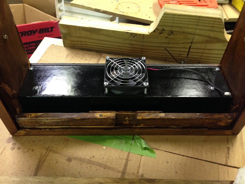

I didnt think I was going to have enough room for the arcade power supply I was going to use, so I decided to mount the fan at the top.
I made a box out of fiber board and mounted the fan to that. I had to glue some posts for the box to mount to.
I inserted and glued wood dowels into these also. (As I also did on the camera mount block, you can see those here.)
I like the wooden dowels as fasteners. I first used them on A Little Rage, it works our good and I think is much stronger than screws. Just have to be very careful when drilling the depth for them.
And here is the fan box mounted. fan mounted to box and box spray painted black.

Remember how I said that the program turns off the fan while recording audio?
I made a little circuit with an opto-isolator to do that.
And here is the schematic:
I originally hooked the fan to 12 volts, since that is what its rated at. But it was really loud, plus it induced a buzzing noise into the speakers. Very annoying.
I added a capacitor on the fan leads, and that cut way down on the speaker noise, but it still sounded like the space shuttle taking off in the back.
So I tried hooking the fan to 5 volts. That almost cut the fan noise down completely and the speaker noise is not there at all, that my old ears can tell anyway.
It still seems to be moving enough air so I think I will stay with the 5 volts.
