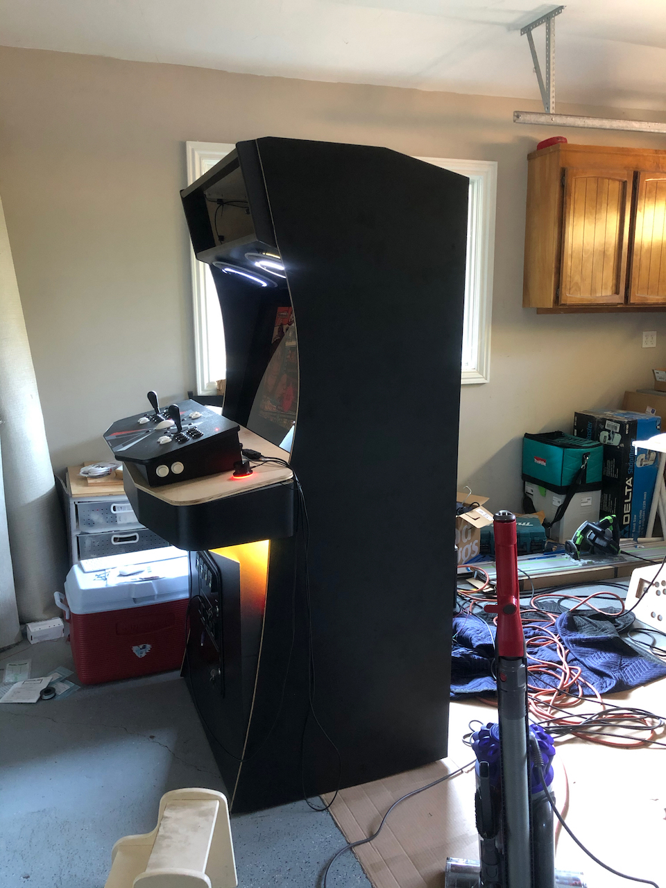

BTW, close up of the top marquee lighting:
I hope you have an audio file of K.I.T.T. playing when this is moving back and forth!

« Reply #647 on: October 14, 2020, 12:18:58 pm »

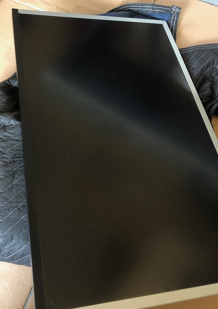

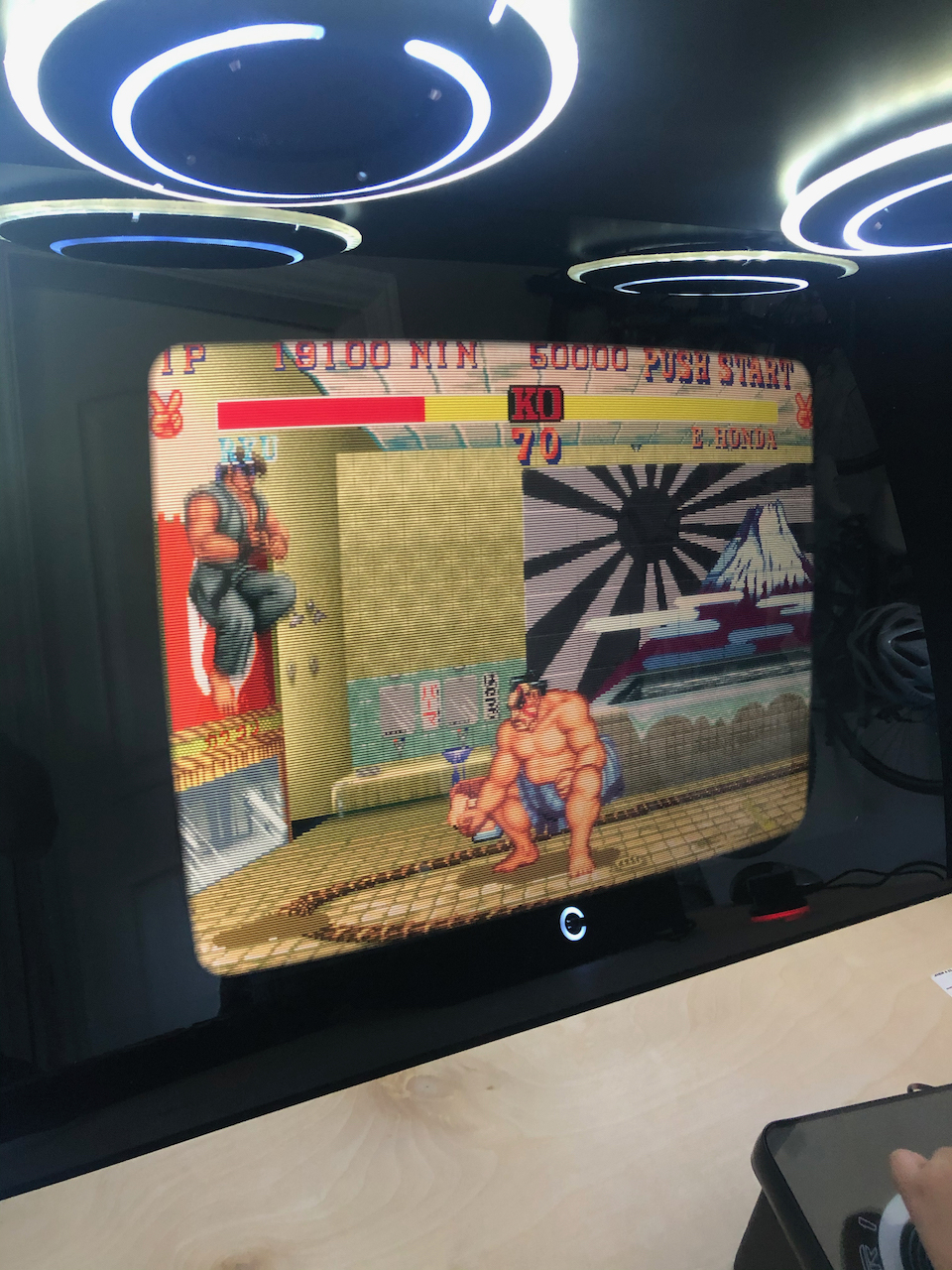

Been fussing about with many other things, and had hit a road block in decision making on the project, but finally overcame some hurdles.
First off is I got the Acrylic installed in front of the monitor and pulled off the paper.  I also blacked out the metal frame of the monitor with Vinyl:
It does a nice job of making the monitor look like it’s floating:
(BTW - if you don't know about HLSL or GLSL and you have an LCD do yourself a favor and look into it.  Makes a world of difference in the look of the games to get them to look as they did on a CRT)

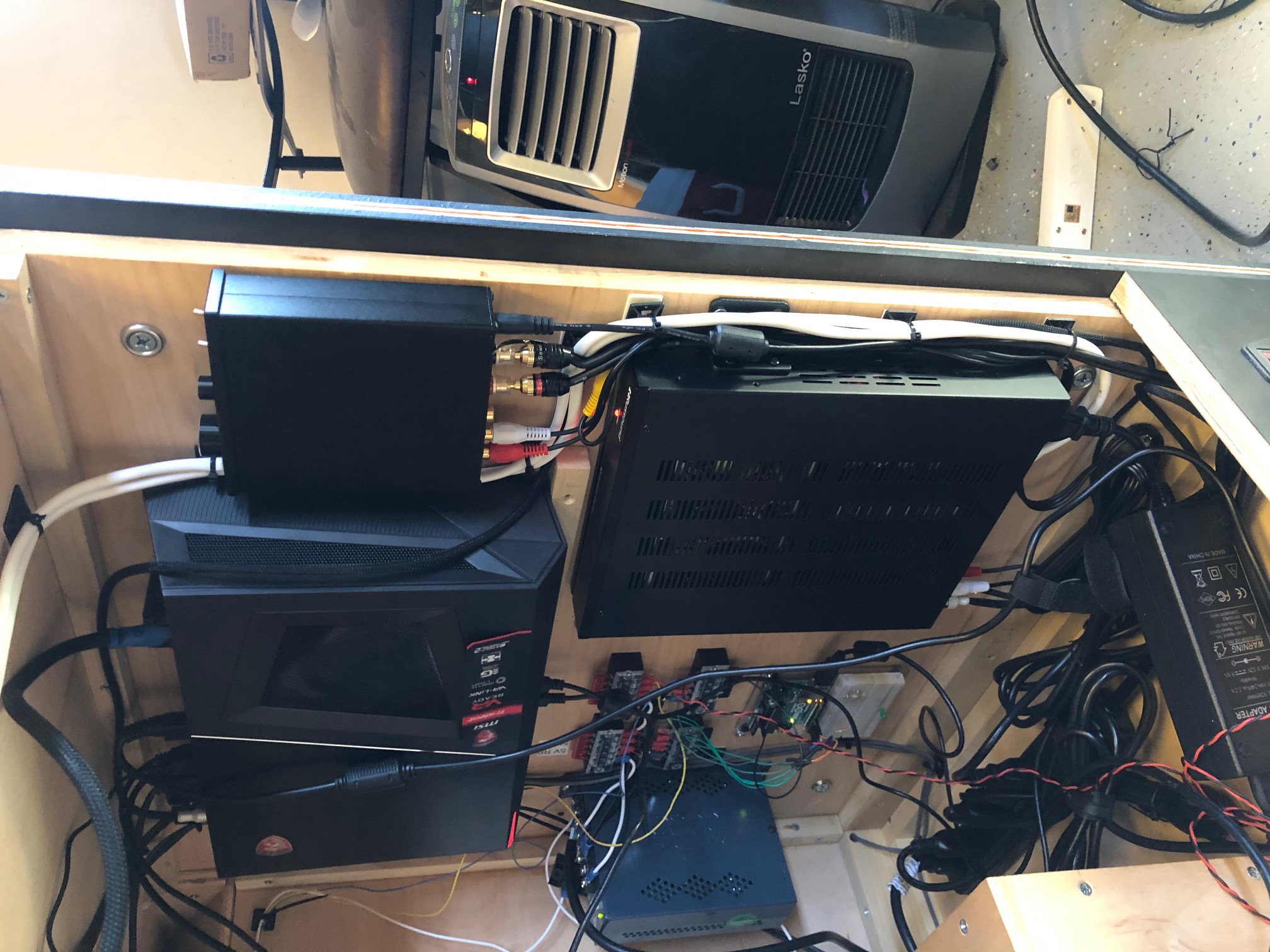

I also installed the amplifiers for the two speakers and sub woofer.  The amp turns on and off when a signal is detected and puts out the proper amount of wattage to match the speakers.  The smaller sub amp is connected off of the larger.  It was tough to find amplifiers that would meet the 4 ohm requirement without getting into car amps, but then those run on 12V and need a ton of amperage so you end up having to buy an expensive power supply.  This was the happy medium as there aren’t many options:
As you can see I’ve mounted them (had to get creative on the smaller one):
Still a mess, but I will get it cleaned up.
Still working on learning programming for the Arduino and the relay switch for it….that’s slow progress.
Here’s kind of a current state of things shot:
Here’s a quick video showing the rotation in action behind the Acrylic:

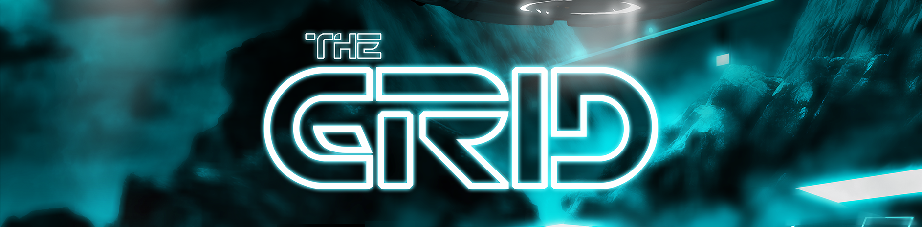

Lastly I have been struggling with moving forward on the Marquee until now.  The artist rendition was kinda funky with the name off to the side and this large light cycle that always felt too literal to the movie for my taste.  So I put on my big boy pants, dusted off the Photoshop and took a crack at the art.  Pretty settled on it unless someone wants to point out a glaring oversight.
Working on getting the control panel acrylic laser etched so hopefully should have a lot of this done soon.

« Reply #650 on: October 14, 2020, 02:06:28 pm »
Hey bud - looks great.  I love the rotating monitor and the CRT shaders you are using really make it look authentic.  Well done.
As for your marquee... there is a lot of dead space to the left and right of the lettering.  I would start by moving the word "The" to be to the left of the word "Grid" and both aligned at the top and then I would make the "Grid" lettering as big as possible.  Another suggestion would be to make it say "The Grid" all in large lettering to fill that space but I get that you wouldn't want to emphasize the "The" part of the design.
Boy howdy!  A couple of those pictures had me thinking I missed you switching to a CRT for a second or two.  Nicely done.   :cheers:
That video of the monitor rotating is something else.  Those discs look amazing too.  I'm going to go throw some rocks at my Tron cabinet when I get home.   >:D
Like this?
Dude without yours as an example I wouldn't have tried mine.  Love that build, especially the CRT!
The shaders can be pretty convincing, particularly behind tinted glass/acrylic because then you don't notice the frame of the LCD which is the dead giveaway.

Like this?
Yeah - it's subtle but I think the larger lettering fills the space better.  I think you want to accent the name and have the background... in the background... instead of taking up most of the real estate.
  • Posts: 6173
Re: The Grid....
« Reply #654 on: October 14, 2020, 05:07:19 pm »
Ah crap, I was supposed to get back to you on the marquee.  I'm sorry man, I've been really busy and it slipped my mind.
Your revision doesn't have any glaring oversights, but I do have an opinion on the content.
Like Javeryh said, the title should be bigger.  I would fill up the space with GRID even more than you have it here.  I'd also align the top of THE to the top of GRID.  Also close the gap more between the two words so the bottom of E is a thick hairline in distance from the G of GRID.
For the background, it's a muddy mess. I wouldn't use that background because it's so blurred and has the same tone throughout.
If I were you, I'd create a grid pattern of thin orange lines, deform it so it looks like it's in perspective, then put the title on top of it as if it's resting on the grid.  Then duplicate and mirror the title, blur it out a bit, and deform it so it looks like a reflection off the grid floor.

Thanks for all the suggestions.  Gonna work on this with an old friend who is more of an artist than me and run with these ideas.

Cheers fellas.  Big shout out to Opt2not for giving me the ideas on the design, it’s always better when you consult a talented artist.
Nice!  The marquee looks great!  Who did you end up going with to print the art?
For the sides and front panel I went with Szabo’s Arcades.  I’ve been impressed with the quality of Vinyl print that he does.
For the Control Panel and Marquee I went with Blue River Digital:
https://blueriverdigital.com/duratrans
They specialize in backlit prints, and in my testing, hands down produced the best color reproduction and contrast when being lit.  Other prints I had done the colors were washed out when light was applied and the resolution of the print wasn’t as good either (pixelated even in some areas).
The type of print material that I used is their Duratrans.

 :cheers: you're welcome, friendo! Any time.
Good call on Szabo's Arcades for the side-art. He's the best in the business right now for quality prints, whether  reproduction art, or custom.
I have never heard of blueriverdigital , but this is good to know. Interested in seeing how the marquee turns out.

Too long.  Time to get back on track:
Still two more panels to get laser etched.
Hope to pick these up soon and get back to work.
